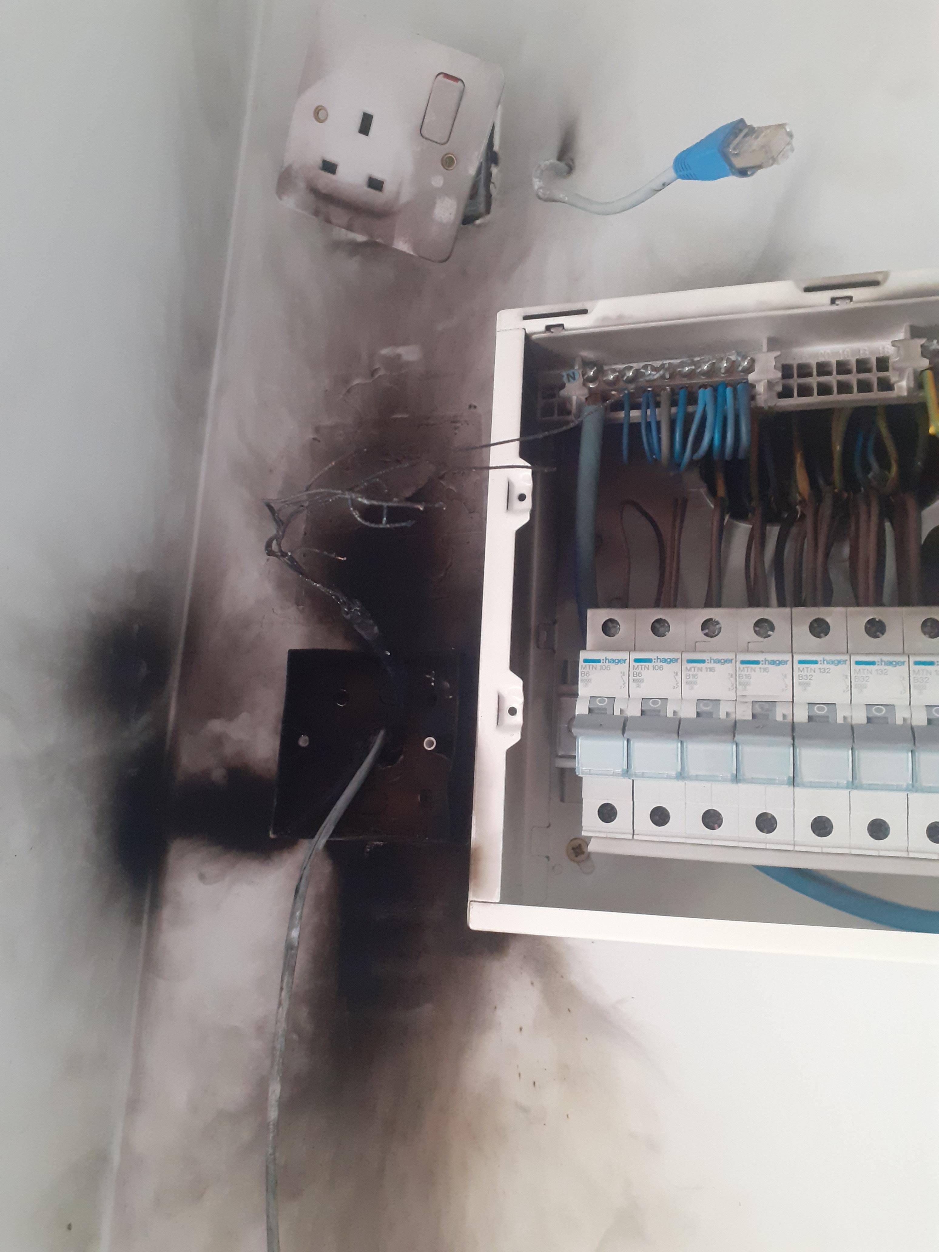

jamieled Posted April 7, 2022 Posted April 7, 2022 It is something I would definitely consider, especially after this... (though I don't know for sure surge protection would have worked). Knackd a few electrical items but luckily anything expensive wasn't plugged in.
ProDave Posted April 7, 2022 Posted April 7, 2022 Just what was it that went bang rather spectacularly? Any "before" photo? Was it something plugged into that now rather sorry looking socket?

jamieled Posted April 7, 2022 Posted April 7, 2022 55 minutes ago, ProDave said: Just what was it that went bang rather spectacularly? Any "before" photo? Was it something plugged into that now rather sorry looking socket? Don't have the before photie unfortunately. It was a bt socket that went bang. You can see the remains of it with the wire sticking out. A router was plugged in above. It was also beyond repair. The CU was remarkably intact inside - everything checked post bang. It did melt and warp adjacent to the bt socket so we had it replaced. This was not from a standard power cut/storm though. Buzzard flew into the transformer that serves the house from the overhead line. It was mostly stuff attached to bt sockets that got fried, according to the guy the DNO sent out he's seen a few similar instances.
ProDave Posted April 7, 2022 Posted April 7, 2022 1 hour ago, jamieled said: Don't have the before photie unfortunately. It was a bt socket that went bang. You can see the remains of it with the wire sticking out. A router was plugged in above. It was also beyond repair. The CU was remarkably intact inside - everything checked post bang. It did melt and warp adjacent to the bt socket so we had it replaced. This was not from a standard power cut/storm though. Buzzard flew into the transformer that serves the house from the overhead line. It was mostly stuff attached to bt sockets that got fried, according to the guy the DNO sent out he's seen a few similar instances. I guess the buzzard formed a circuit from the HV primary to the LV secondary. I very very much doubt any surge protection devices would have helped there.
