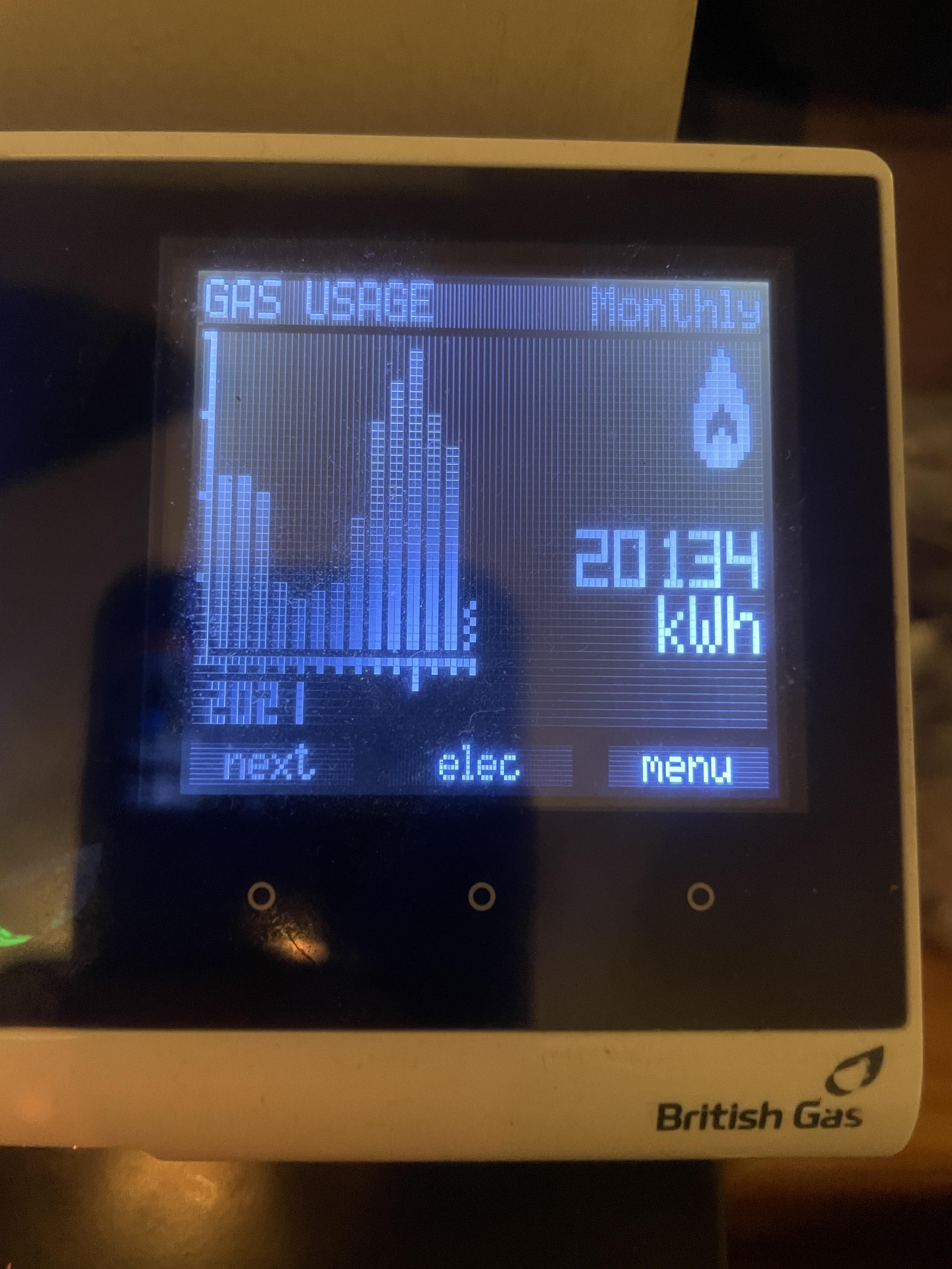

HughF Posted April 20, 2022 Author Share Posted April 20, 2022 Can someone check my maths: As per the attached, 20134kWh of gas through the smart meter for 14 months of usage 20134/17 = 1438 1438 * 12 = 17257 kWh/12 months In our current non-condensing baxi back boiler on a Y plan, assuming 75% efficiency: 17257*0.75 = 12942 kWh of heat energy delivered to the property. To generate that with an ASHP with an SCOP of 3.5: 12942/3.5 = 3697kWh of electricity required, at current prices for the year - 3697 * 0.28 = £1035.42 Compared to buying 17257kWh of natural gas at the new rate of 7.9p/kWh = 17257*0.079 = £1363.30 So, a £330 saving per annum (not including the gas standing charge, which can go as we cook on electricity). Obviously there is the capital investment, but the boiler dates from the mid 80's and the rads are all in need of replacement anyway, so that needs to be done regardless. Seems like a no-brainer... Link to comment Share on other sites More sharing options...
IanR Posted April 20, 2022 Share Posted April 20, 2022 (edited) I can't see anything fundamentally wrong with your working, but... Shouldn't you compare to a replacement condensing gas boiler at circa 90% efficient, rather than your existing non-condensing boiler? 26 minutes ago, HughF said: In our current non-condensing baxi back boiler on a Y plan, assuming 75% efficiency: 75% efficient non-condensing gas boiler v. 350% efficient ASHP = 466.7% efficiency improvement 90% efficient condensing gas boiler v. 350% efficient ASHP = 388.9% efficiency improvement 7.9p per kWh Gas v. 28p per kWh electricity = 354% higher cost Condensing gas boiler is still higher day to day running costs, but closer. If you already plan to replace the rads and cylinder, I'd go with ASHP as I view electricity costs to be more stable in the future. But if you only have to replace the rads for an ASHP install, and they will last 10 years, then perhaps another gas boiler is the better cost option. Edited April 20, 2022 by IanR Link to comment Share on other sites More sharing options...
SteamyTea Posted April 20, 2022 Share Posted April 20, 2022 25 minutes ago, HughF said: 20134/17 = 1438 Should that be /14 Only got as far as that. Link to comment Share on other sites More sharing options...
HughF Posted April 20, 2022 Author Share Posted April 20, 2022 (edited) 10 minutes ago, IanR said: I can't see anything fundamentally wrong with your working, but... Shouldn't you compare to a replacement condensing gas boiler at circa 90% efficient, rather than your existing non-condensing boiler? 75% efficient non-condensing gas boiler v. 350% efficient ASHP = 466.7% efficiency improvement 90% efficient condensing gas boiler v. 350% efficient ASHP = 388.9% efficiency improvement 7.9p per kWh Gas v. 28p per kWh electricity = 354% higher cost Condensing gas boiler still higher day to day running costs, but closer. If you already plan to replace the rads and cylinder, I'd go with ASHP as I view electricity costs to be more stable in the future. But if you only have to replace the rads for an ASHP install, and they will last 10 years, then perhaps another gas boiler is the better cost option. I'd need to up-size the rads anyway if I was replacing the current boiler with a new condensing one, to get advantage of the lower loop temps to push the boiler into condensing mode. The current rads/cylinder are in a bad shape anyway, so they would be replaced regardless of what heat source I used. I'm planning more investment in the property in the shape of as much solar as I can fit onto the south facing roof, so that sways in in the direction of ashp+uvc vs combi (which would be the gas option). Capital cost is less of a concern than running costs, the house is paid for, we're never moving and I make good coin. I think I could DIY the ASHP + UVC + rad upgrade for about £5k, vs probably 2-2.5k for a full combi swap, which I'd have to find a gas safe engineer to do, and takes up space in the bathroom. Edited April 20, 2022 by HughF Link to comment Share on other sites More sharing options...
HughF Posted April 20, 2022 Author Share Posted April 20, 2022 4 minutes ago, SteamyTea said: Should that be /14 Only got as far as that. Yes it should... well spotted Link to comment Share on other sites More sharing options...
