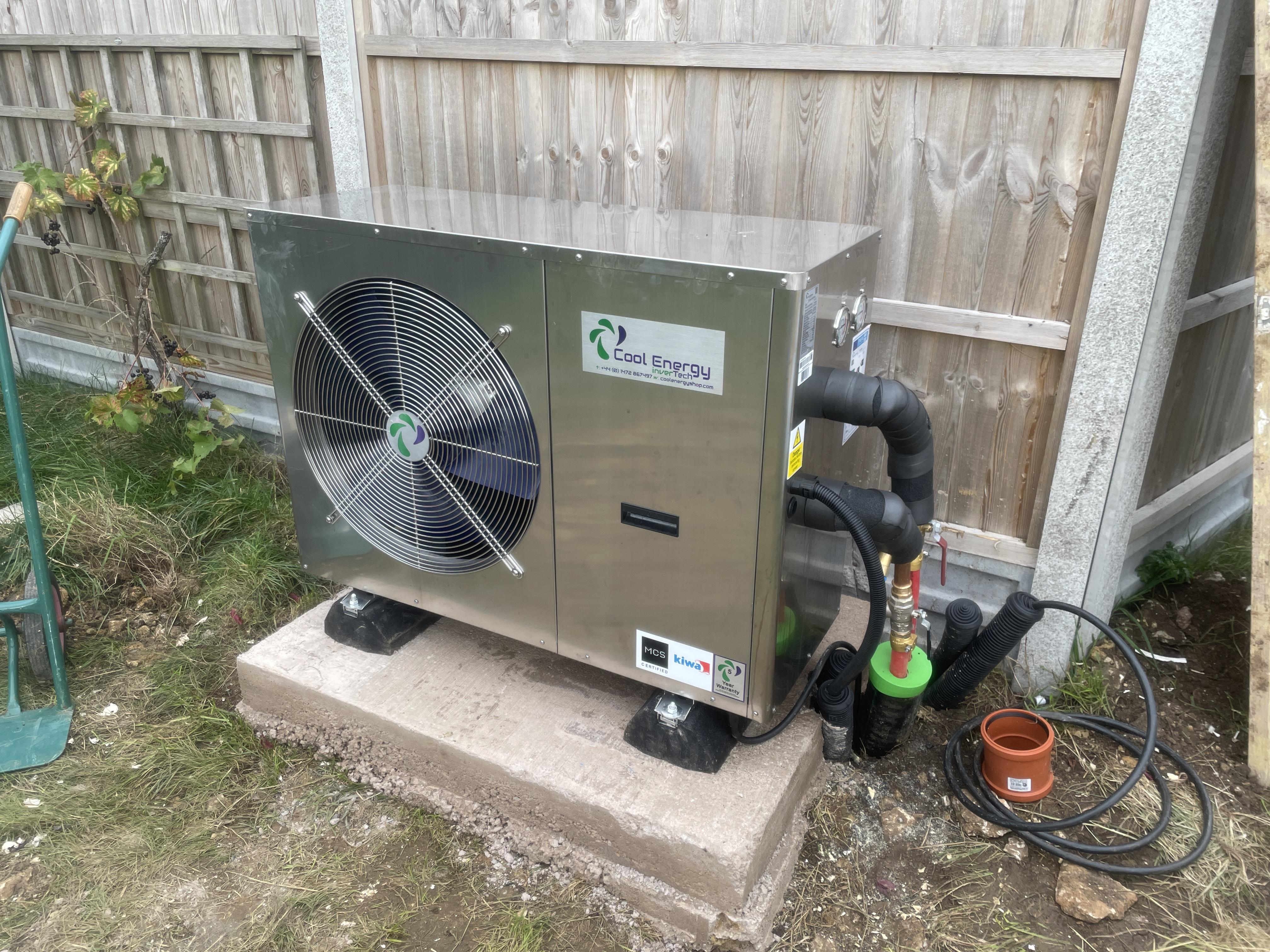

Had to condemn the back boiler due to a ventilation issue….
Just had a week off the day job getting it installed with my builder. Been a long week of self doubt (will this keep us warm?) and sleepless nights but I think we’re over that now.
All new pipework throughout, rads sized for 45 deg at -4, three Smiths Ecovector fan coils where we didn’t have space on walls for larger radiators.
I did heat loss calcs in two separate packages, the freedom toolkit and heat engineer. They both came out around 6.8-7kW at -4, with the old double glazing (we’re replacing that at the moment) and the uninsulated timber floors (which we start on on Monday).
Lagging, thermostat, and some more lagging to do tomorrow.
All parts and my builder for a weeks day rate, just got change out of £12k. More than I thought, but the rads came to £1200 and the ecovectors were £1400….
I haven’t bothered to calculate a payback period, we needed a new heating system, and if these rads and pipework last as long as the last system (installed in ‘86 by the council, after the previous coal fired boiler had done 40yrs) then I’ll be happy. At least that’s 18-19000kWh of gas (our average annual consumption) that we can leave to be burnt in a ccgt. I’m thinking we’ll swap an £1800 gas bill for £1200 ish uplift in the electric bill, before we even consider solar and battery.
Oh and to anyone thinking that hi-line eFlex underground pipe is flexible, it isn’t….. what a sod to install.
Would you be willing to share more about your experience with this stuff?  It (or something similar) remains an option for me if I can't convince myself that the more obvious location next to the house won't annoy the neighbours.
All I will say is that when you cut the straps off the coil, it doesn’t uncoil. It took three of us to unravel it and get it into the trench. Very difficult thing to do. I think it’s because the pex pipes are bonded to the pir insulation, and that’s then bonded to the outer casing.
I dug 900 down, and it still came out the ground at 45 degrees at one end). The good news is that 32mm mlcp press adapters will fit onto the end just fine, although the kit comes with compression BSP tails that you can assemble with hand tools.
Edited by HughF
