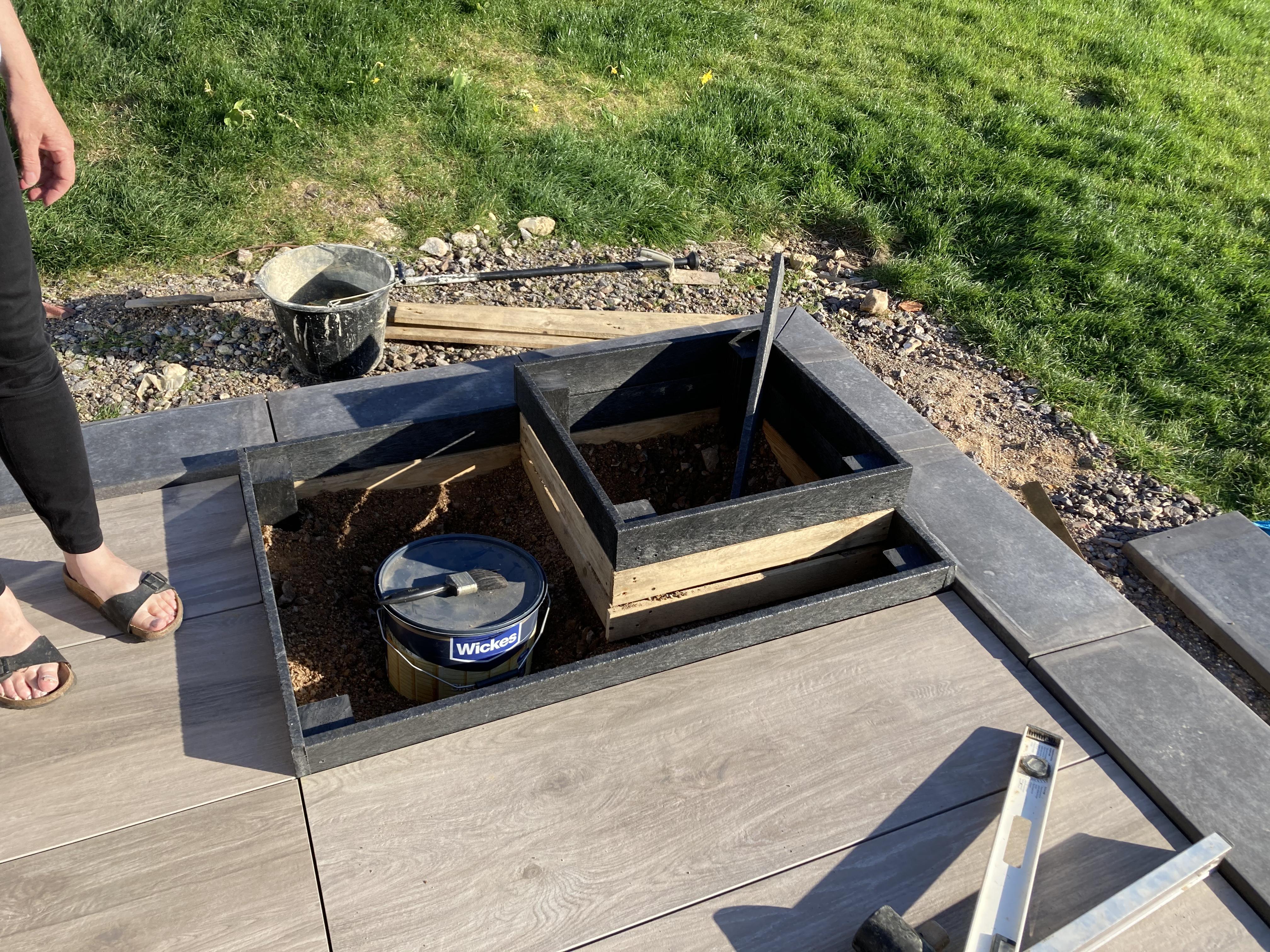

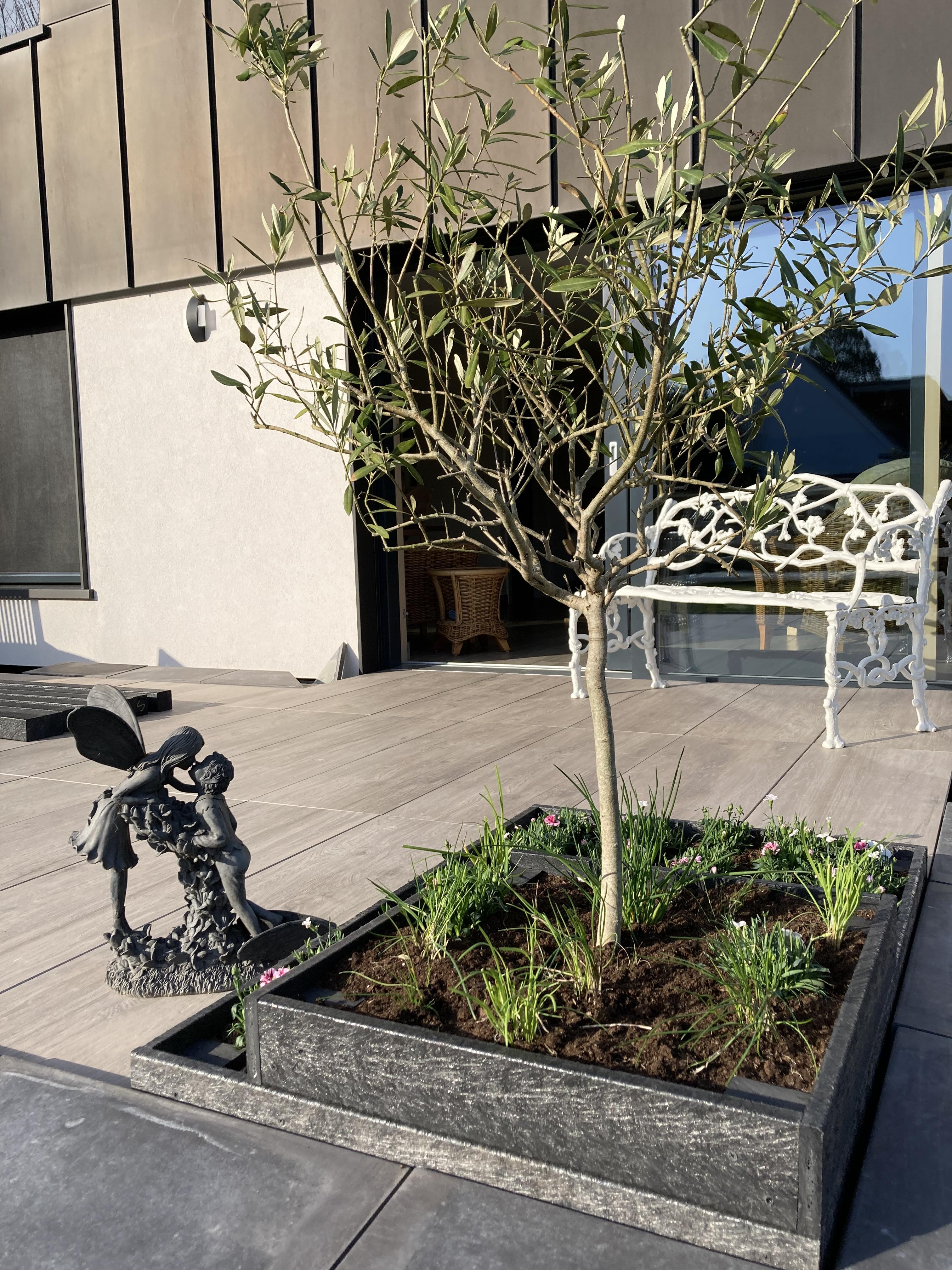

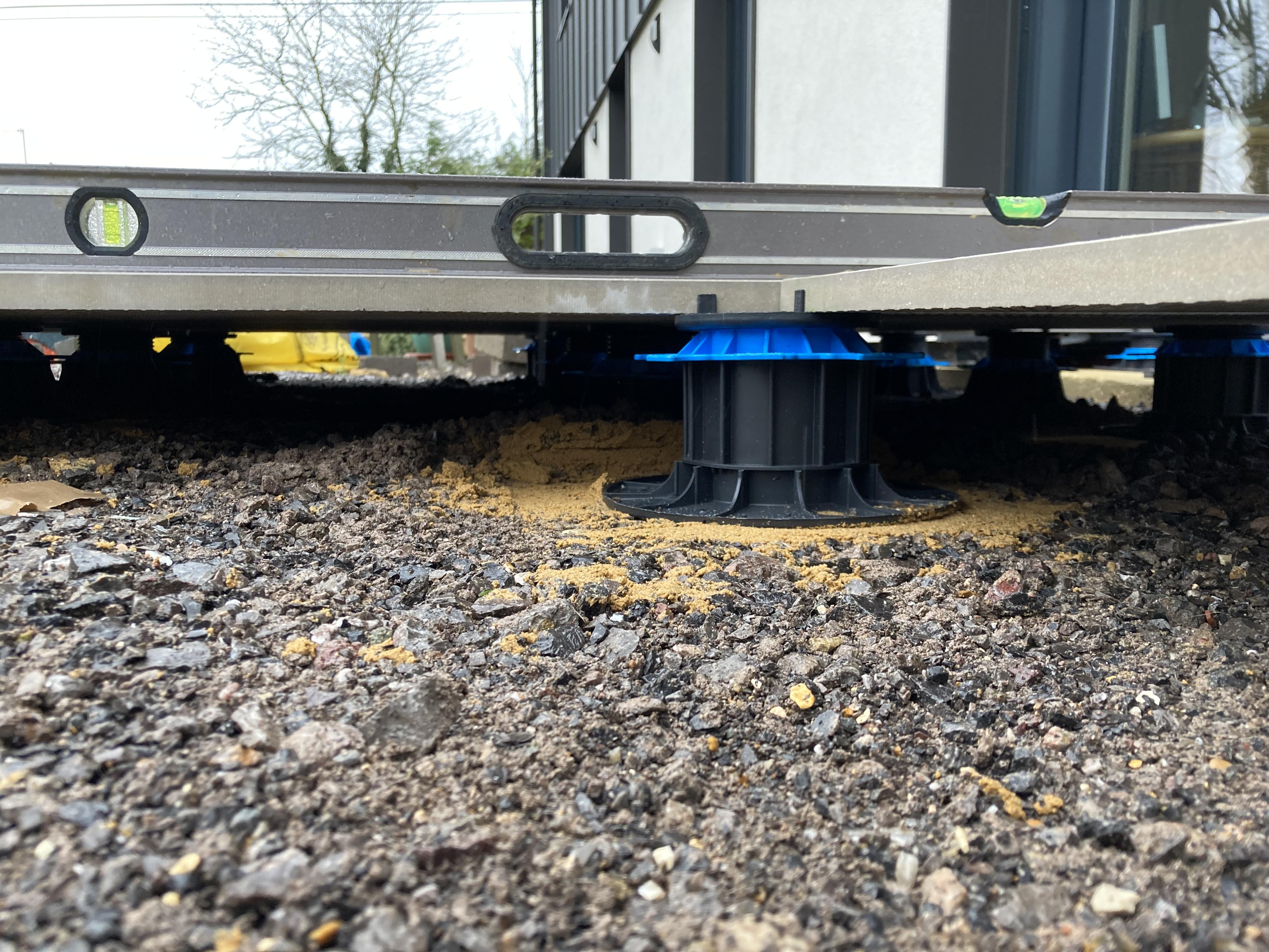

Russdl Posted April 5, 2022 Share Posted April 5, 2022 1 hour ago, Mr Punter said: Another option is the pedestals but they may be more problematic / expensive. Pedestals would definitely do it, and on a concrete slab I wouldn’t have thought it would be too problematic. I’ve used pedestals on a compacted base of type 1 and a bit of sand to level than as we didn’t have the articulated pedestals. Whilst it’s taken me an age, problems haven’t been too many. They’re not cheap, but not massively expensive either, however if you change your mind about any aspect of your patio (which we have) it’s really easy to start over, for example we decided to remove two tiles and put plants there instead, we dug out the type one to make a hole, lined it with some leftover geo textile membrane and planted away. Really easy to do with pedestals and equally easy to reverse. (It’s still a work in progress, but the olive tree has been pruned!) 3 Link to comment Share on other sites More sharing options...

Adam2 Posted April 7, 2022 Share Posted April 7, 2022 pedestals - need to watch tile size and thickness. Largest I could see were 600x600 x 20 thick to use on pedestals - @Russdl your look bigger which is nice:-) concrete base - we found the void filler (Cemex but I guess they all do it) was good to work with in filling err voids but has a C20 rating I think so plenty for paving and was quite cost effective if you don't need a pump to get it where you need it. Think maybe of drainage under the raised deck if using concrete - maybe a few holes or do it to a slight fall? Link to comment Share on other sites More sharing options...

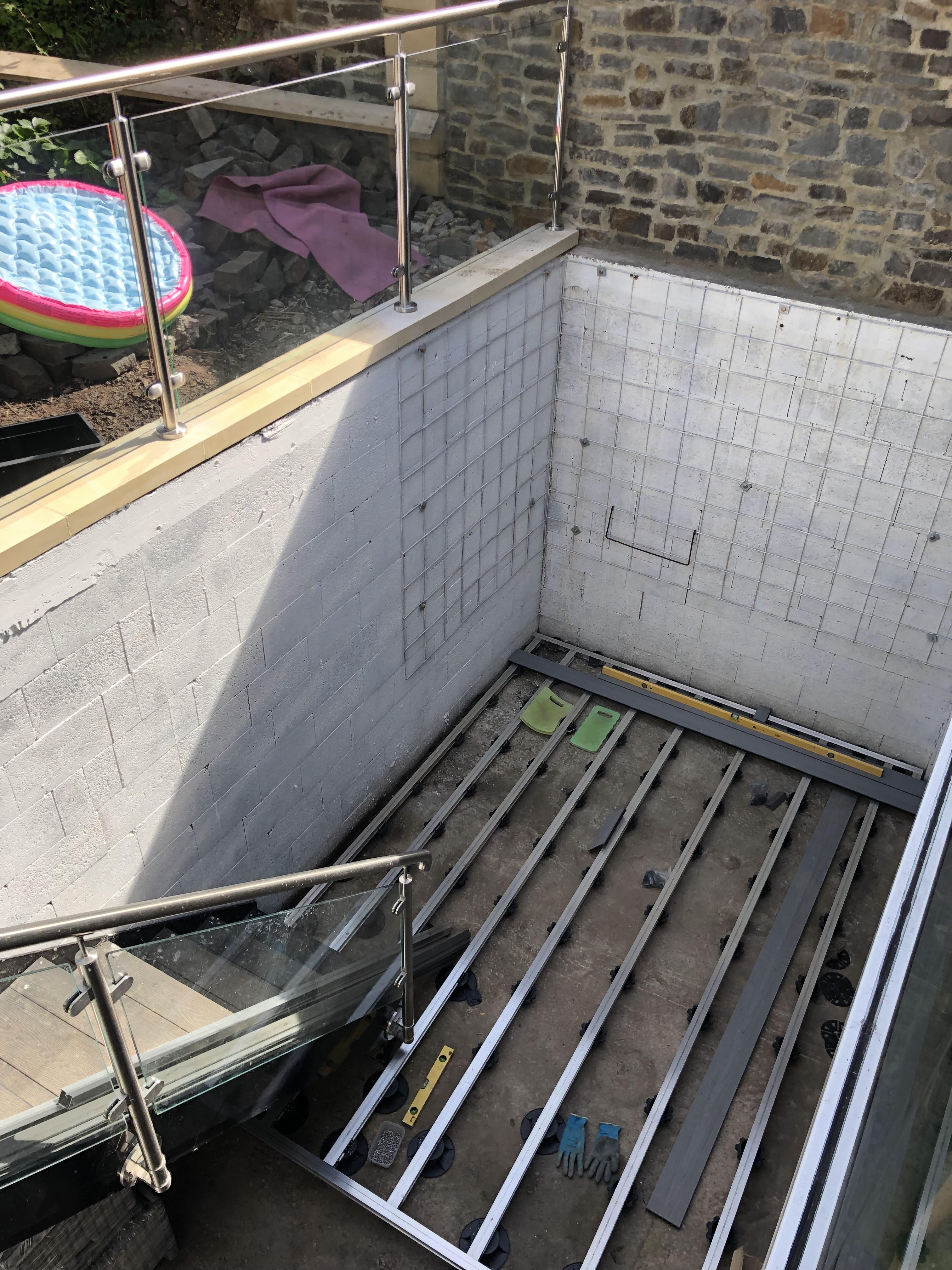

Pocster Posted April 8, 2022 Share Posted April 8, 2022 I need to do this also and was initially going down the pedestal and tile route . Thickness of tiles required and lots of cuts make it a pita for me . Decided instead on pedestals with engineered decking . Link to comment Share on other sites More sharing options...

Pocster Posted June 15, 2022 Share Posted June 15, 2022 It’s a surprising amount of work to get the frame level with pedestals ! Link to comment Share on other sites More sharing options...
Pocster Posted June 15, 2022 Share Posted June 15, 2022 Yes it’s my paddling pool Link to comment Share on other sites More sharing options...
