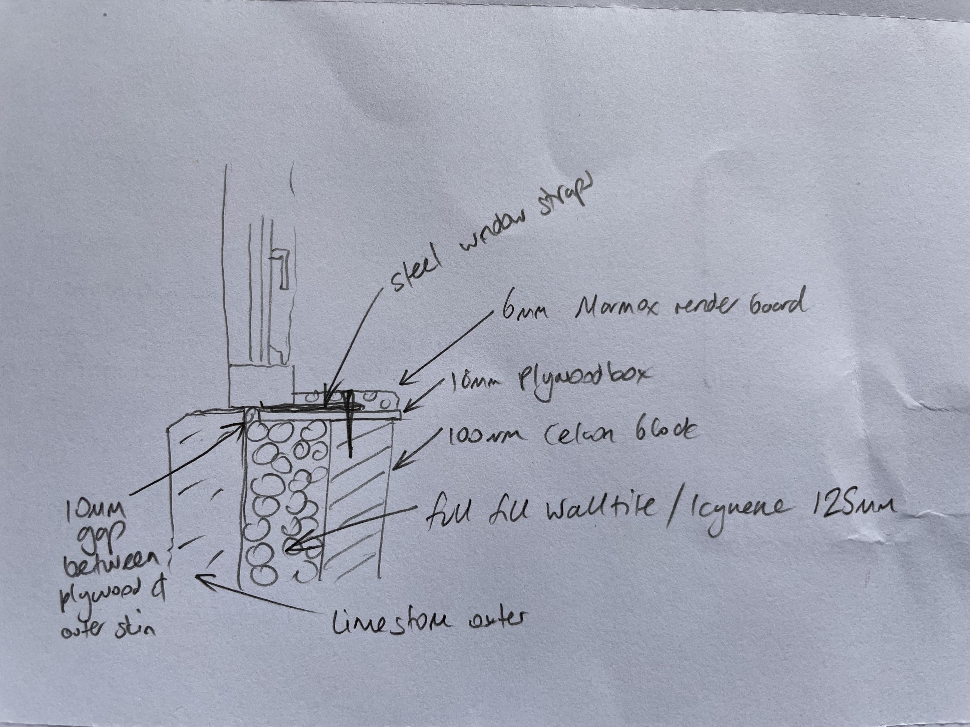

I don't like the cavity closers as they're difficult to fix to. Also, in the past I've had just as much success of cutting and wedging a piece of 50mm Celotex between the leaves and foaming it to create a much more sealed cavity closer. You still can't fix to it so need to take the fixings back to the inner skin via straps. I've also found you need to use insulated plasterboard on the reveals, as it's more rigid (and you can only fix to the inner leaf really).
Below is what we did on the current build (essentially built a plywood box BEHIND the outer leaf with a 10mm gap).  Unfortunately this only works easily if you aren't tied to matching course heights between the outer and inner leaf (in our case the outer is cropped stone, inner is blockwork).
Our cavity is fully foam filled, but I don't see why this sort of setup wouldn't work with other insulation.
@SuperPav Thanks for the sketch.  When using this method, do you wedge the cut insulation between the outer leaf and the cavity insulation, or between the outer leaf and the inner leaf? I've used closers on my current home years ago but the window was fixed to the outer, then i used 15mm plasterboard to close the reveal off. Cant remember if i used d&d or mechanical fixing into the inner leaf with some adhesive behind.
My course heights need to be the same throughout but inner reveals could be set back the thickness of ply board if needed.

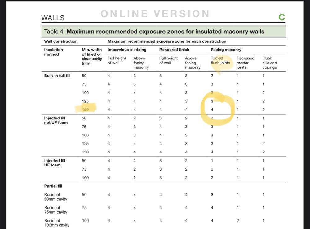

Posted
On 04/04/2022 at 16:47, ruggers said:

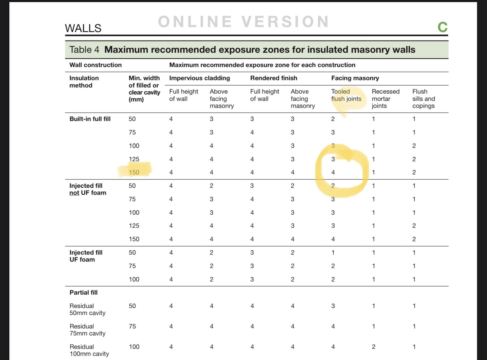

Weather zone is severe 4 for NW England so blown bead isn't an option.
You can fill your cavity according to Bregs.

I will look into the blown bead again, I spoke to a firm called Koresystem who supply blown bead who provided a lot of good info. but they weren't pushing it so much once they realised the exposure zone. It's looks a great way to do it, but it makes me nervous, if it goes wrong it's disastrous. wrong as in causing damp or water to track towards the inside somehow. There must be a reason it's not recommended in zone 4 and if it comes down to the type of pointing, flush joints zone 4 but recessed is zone 1 that doesn't sound right the mortar being the decision maker.
There also seems to be a lot of cowboys installing it who just wanted the government grants for retrofits so it would need to be a reputable company.
Posted
https://www.nhbcfoundation.org/wp-content/uploads/2016/05/RR10-Full-fill-cavity-wall-insulation.pdf
Worth a read.
Kore is a reputable manufacturer. They make the MBC insulated raft. We bought our floor EPS from them.
Install is very straightforward with a wide cavity. Problems more likely with narrow cavities. Make sure the installer uses enough PVA glue.

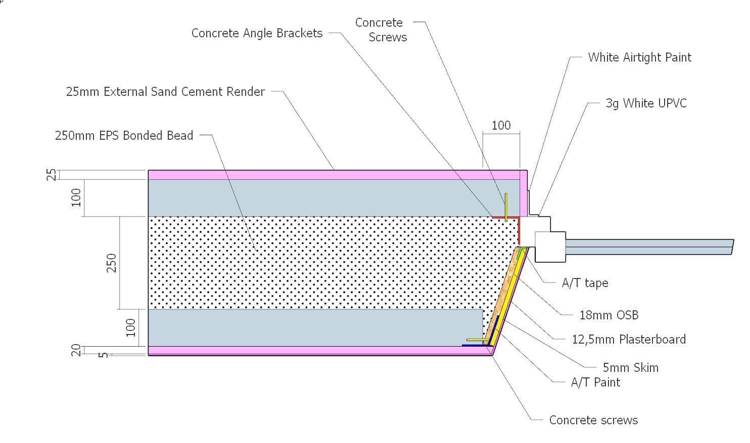

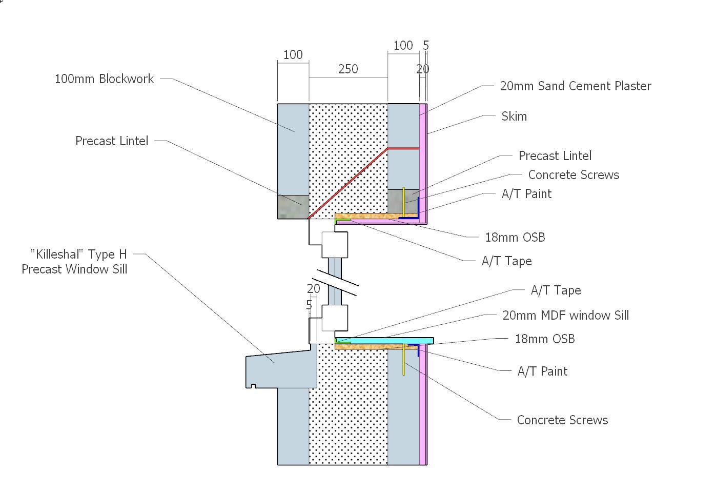

Posted

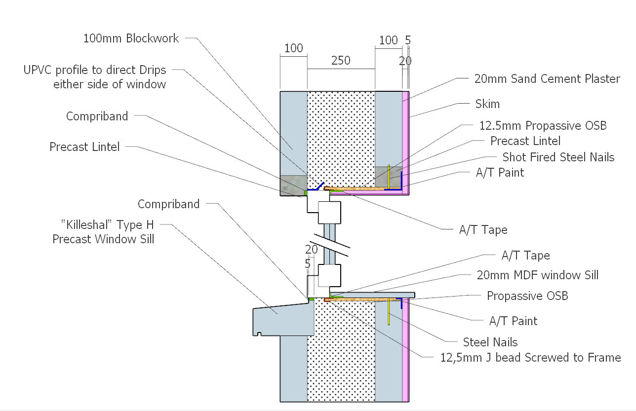

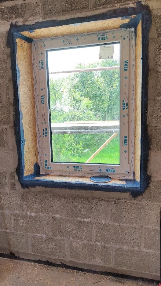

Here is the plan view of what we actually built
Here is the section. I've omitted the external render and external airtight paint here to show the overlap of the window bottom on the sill.
391295947_SectionViewofwindowDetailing.thumb.JPG.6185b519cf8d52a3ba05d35525183671.JPG

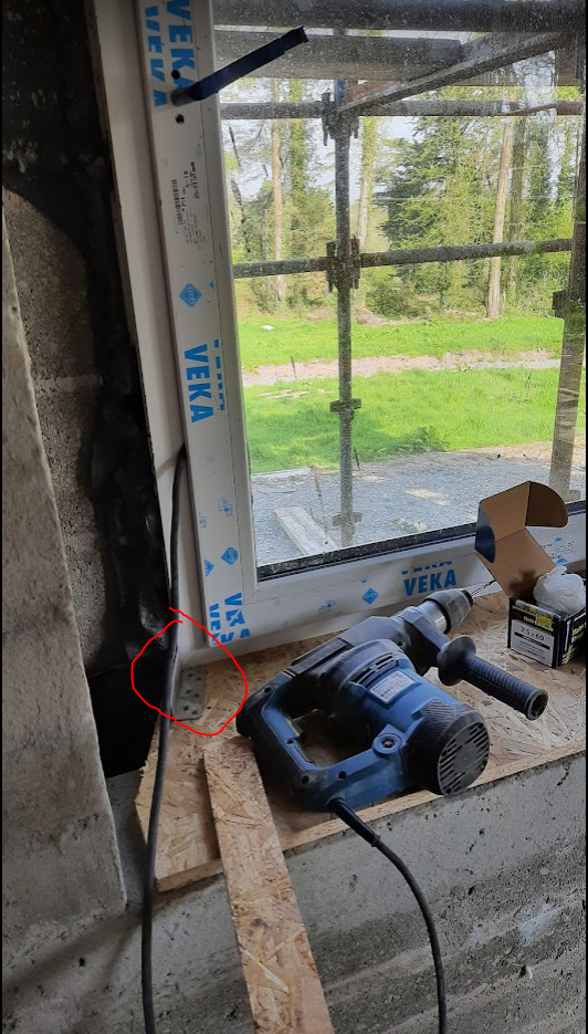

The windows were installed bolted to the outer leaf first. No connection to the internal leaf. I later cut out and threw away the vertical DPM as I have no idea what purpose it serves in a wide full fill cavity
YNd8c1iAjdICtnhDx20m5M2SU-zYOEGJ3z2lFnxyPXgywlrPUJ96ejPHov8CWG3WsffKqbpcVlBgoR8xhAUZraPeehQVfwOoz1FL7WYtwyynEbDznut8lx8v22fYTSZoRKNmIBnMVTMeb3QYlSHZ-BlyQ3XWN6S-LHEJaWug4SsDPn3h-CR7rpLFJSLmxcnGmag0DisBPTjZgaA6Ju9-vKmoYPK5j_Mb4JN8vPXg8lrolzI6Ve7yAuS-4fTwukJjM1mUMGXRWT5xFBRQPd4KJY_Z0VYOYTPQIx7EeYlIaabNDa4pXiuqBf2A-faZi1cPSQAlYhr76p0hY5EjITIx5P5wUZiZ5JDgNuIgxRV8wyTua5xjntP9YBKeF96oF6KDI-B_WNgkURHPYGerjdAJVuR2gtv-7k0j3VkdDBTewDqFQN59fGq9IPTI-3dWYWkbIlQqblf3O6iDNLdlnfs6xK_oBlEGocOCP6V5FOtudtiRYerBZfxC1ijbJaaJnVip_uFHuVUWWyAn1H2U1Wt8P6OkwgOldVPM2So5D6jrjHwhTvYynCrJm5FI7hA8sQaqC2NCY4Mk49rkEYwxnKCpqUYMzquoI7lmN3xJaVCsHovZJCSUO_FDgHFH1_8QVP08vlot465hSA9bSqxRVgjL7D78F8yK77EOnvMx_BBcEWFuEwA_ULCmDEKKl0whebFpnB08BuKeltOGSiDolQzhO9Y0_Oj3jh0mP_6eO9k45tdbJgkuApSk=w1666-h937-no?authuser=0

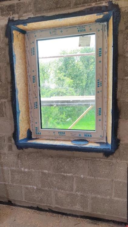

To make the OSB window boxes  we first made the base and the top. and bolted them with concrete screws to the lintel and blockwork. Note the angled brackets used to fix the side panels afterwards.
nm-YIyU-xJG0tsz9bIhALUF5AKABp6pb_BJaKMA-u5_bcHLbCVKZbMTZbfQNlRGzRdmSiiH3bFAhl_42ke5hZAjGEXH7kgbPg3JHJbdevk_aKxAXXnZUG9YRBfYOrn6xgT2SDPUFRG1EwQwLEZJUyPBJWsxeAUDC3oH9F3ucCVHkp8ajZlSiZlYzji913s8p2FrwFNpuvkPlGg1pgkJ2e5AqAIaMYi--SzVe219ZtxT0CCYRMQGc-ISLr5qeJKbuh-rY11x093XgQoNUxQaBsUscAZJCyC2yTVivLq6HA9lUQZjQ1e8Z6Db9d7GU_tvKXg3XVdOpiRCNMW7AetEZAtZrWZTSMv-sBepVCkQxTYOC1qaU_QX2SBwc4PL6KTILYl6mRi3Chh5NA3gmRgLuLcwKvV26qu28nYyItMAZg7XS9p491-gt-hdAcbzFY74dtwK7p9kMqLKcVW2dZ8_D99KQWPFjw5Klj_8pPZjbQmfY_uxBSKmBbVRjNB1NKo4vokLcChigMABT2i3bfHVdM-vXDcRdYOqwz_bli1SDmE6klGvSUnGUvJ0RyENB-xq70wiveRHVnyWSsGt22nFa9lne-lSbQRam4JEXtt28lKoUtUnVxoq2WLSgZLdKwemy7kwrNUlSMIoRg9E2VkU0PrnECbgeyY8gAdO4SWVJz0bsl4Zmh1wcsQLGFVfNrCBDN-60tE-TtiH2vG8BvDrAbGtzkbtcP0Yyk2no-pEshHJaD-7DcRUN=w528-h937-no?authuser=0
The sides were fixed using galvanised angle brackets afterwards.  In doing do the whole OSB box became quite rigid despite only being connected to the inner leaf. It was simply floating against the window.  As we have quite deep windows I wanted to make sure that a child (or adult!!) jumping on the interior window sill would not collapse it. This was a fear if it was only cantilevered from the inner leaf.
Sha
Delete
j_gZGuQJB47um43Mqv9kXgstxpjIdIoOd0bRHp1I2doUqxlpp_W4vYrXV3QVuaZdYQaZx9mA4_WFjtVdodYM95rwLVM-BFeR0SClf7DBEay1-twQi8PQXhdmkQDy3Ps1MKsUbGZD5Web9TUH4PBOEz0nrBjDRI-etHy_1EAbOQ_jMhEE3HXnNryRVbs0HQNnGn7HoXoSfj6WPI7ciCn0Wb4HYTd8QzM1LXxWlE77iIkp3AT7PfGo9c7jsTBlurAHo2UL03TlbI4db_RbIF1aQAkX5H3GNC-Rj1eLrWoj7_geDu5n4Gz1Bqh3Mc5Lr--_RHYhXk3V7UuV3oJyMEt34gD_CCUfLK2MqhRloklpLAiy5-bsEsdwFiYe4GRSiwSb4hRbsGHEXeNdMwZFlEIFHJBy0vodYu92tduFyumjfq8Oae0RbeITs6DXKTTAm--BItxRXIcxaVAOjveVLWsElsj8DPBYwULoGIhLW4VlTnWbb33T4mcw4_D15MRK5h1cipx3y2YV5rNJ_rLbwdzQBQSZX_29m7bSRqO-vsI30V22EOZ6tK7khsTlP-qu0lBON4L8jwWpxpK6jeCAJXBaQ64WFlrNxJF7xVtIQxl9ThEkvP83WyBU0bdvhAPCLpHRthvMqVnGD_DiW_ZkRRV9-c8CMY-zyylRyedaF2UHruApUXqUvGF_tUwJLlyS4sYVuLUFvxNDJR8Ff9SXvXGVN-pQ-VJ6qrPbLPLd1ZIEWbr2074BbO5z=w528-h937-no?authuser=0
plQgG5sBfliz8G-4LwnkWIxTZZkK1fB-LMokMrIy_MawjC3VU6u16o2yEKOk3O6dtqMtXMz8EtcRDNVnV9pzZPTKnvg95yruUnsBbJy2Z7Xg42V4xUWgPVX-LH_6fft4QdPVD-99loisrf-Z-yAyIpYOW39JlO1fonBKDd594pHod-V3JGyyNz30ldbqpb_2iOMGy8CB1bpEx6FXo0SOpPxvGqiH6yG205z8PxNUmKjlpBWMxETMZit6jnwdJ76WTj47qd22PRK42YwMX_0uXfKl7HzZHG7aaFzYIFkpOXXhkU-EelBEPG0qT0J8eaFdbZfbv2CaZQeyeva01jf4UaOm2HhmbRCKei5ereTgS2EIN7C0ucDOlacCb_CDAz58jEylbbvjT7TSpzuBVvu3vUVULttYCiIBxGo6MGKlH7tzyMqNnJmRMjiV9dyLOOZHu70lhVLDNb9JOCTXZ5-uA8QWnRddtoIgr9hn_3vQyGV4zzlj1vV6mp3_iekyyO5tWFIzA0dTXvyJPkgubxoMZZeJODonECCmEcPCa59q4bkRlp19n5Y-NvbqJrvaWKARtQYwNovhkvwW0S4xQQWxTr0SvR8qE6EVooLsQlGiP-b9FEdtjvsPsYVjK0bX1nDFSaLPkzn4MBZ18S34Q-X-UTPOFsauM-X6XVEKxOKfiFnHXINQiSYYaImd0_hZQQmwbvT2TQCrvabQ22SyzQsiC-QJ8XVqeQ38EhcHTD-5VM381GQ5mC7m=w528-h937-no?authuser=0
From there the Airtightness process was straightforward.
A/T tape from the window to the OSB.
A/T paint from the OSB to the blocks.
Wet plaster over the A/T paint.
Plasterboard to the OSB and skim.
I used A/T paint to seal the external to the external render for wind tightness. White paint on white windows is a bit of a mess but nobody notices unless they're fussy.
Overall we had an excellent blowerdoor (0.31ACH) and the splayed windows are nice. The Sills are solid and perform thermally very well.  I had a THERM model somewhere but I can't find it. A 25mm hole drilled in the OSB head and sill allowed EPS blown beads to completely pack out below and above the window.  I drilled test holes to check in what I considered the hardest to get to locations and I was impressed.
PROBLEMS encountered.
1. The window fitters measured the windows when I wasn't there. I wanted them to get the outer blocks to overlap the frame by 10-20 mm. It would have made the frames appeared slimmer and we'd have had more glass. Moreover we'd have been able to use compriband or similar to seal the outer blocks to the frames. As it was the blocks and the frames met with two opposing 90deg corners ( angle to angle) whick meant that gap was very annoying to fill. In the end a mixture of expanding foam(yuck), plaster and silicone got it done but it was very tedious.  I had to seal the frames to the outer leaf for our wind tight layer with airtight paint which was a bodge. It would be awful on coloured frames.
2. Plastic DPC/DPM used as cavity trays and vertical DPM's. What a terrible way of building in the 21st century.  They catch all the mortar droppings (sometimes bridging the cavity), often get torn. Prevent a good seal from the window frames to the outer blocks. Generally blow about and slap you in the face in the wind. Total RUBBISH.  If I had my way again I'd put an angled PVC profile just over the window head and leave it at that. I cannot see how vertical DPM's prevent water making its way inside in a wide cavity with the inner totally isolated from the outer.
3. The OSB window boxes were very time consuming to make. Maybe premaking them and building them into the blocks would be better. A solution to prevent them degrading in the weather would need to be found.
4. A few hours spent pretaping the windows before install would have saved many hours later on.
5. When screwing the angled OSB reveals to the blocks I was a little over zealous and put a bend into a couple of them.
6. As the OSB was only "floating" against the window some of the gaps around different windows are inconsistent. I don't think anyone else has noticed but me however.
I'll add another post about what I'd do differently the next time as this one is getting a little long.

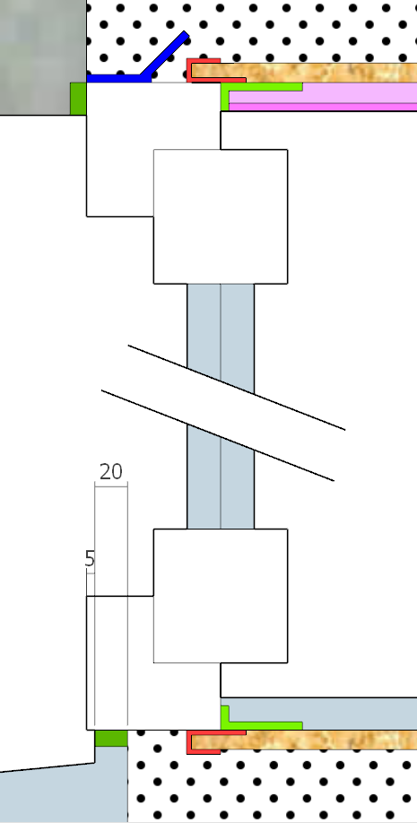

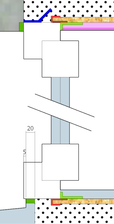

Posted
Improved UPVC window installation. I didn't bother drawing the horizontal section as most of the changes are the same.
Points to Note
1. The useless cavity tray is gone. A small UPVC profile pre screwed to the frame will now direct any drips/condensation that run down the inside of the outer leaf sideways and harmlessly away.
2. Compriband is pre installed to the frames allowing tidy and quick expansion to seal the window to the outer blockwork at all sides.
3. 12.5mm J beads are screwed to all 4 sides of the window. This will allow an airtight 12.5mm OSB to be slotted in and then shot nailed to the inner leaf for speed. The block layer should leave the  upper lintel maybe 30-50 mm higher than the outer one and packers can make up the difference. Similar story with the sill.
4. Pre install the A/T tape to the windows to all for very speedy taping later to the OSB.
5. The OSB to Block junction may be better dealt with with fleece A/T tape and plastered over.
You would need a little time with the window frames before the fitters returned to pre install all the bits and bobs.  Also cowboy window installers would be no good. The J beads should be screwed securely into the window frames, especially at the base.  Some accuracy would be needed from the mason but not enormous. The windows would need to be accurately measured. No rocket science but everyone would need to understand.
Its a no mess install, no expanding foam or A/T paint or silicone.  Very quick to windtight and airtight. All materials readily available and pretty cheap.
If only we could all build 100 houses. We'd get it right eventually!
Next task, Incorporate external foam filled PVC electric roller shutters which I would very much like.
  • Like 1
  • Thanks 1

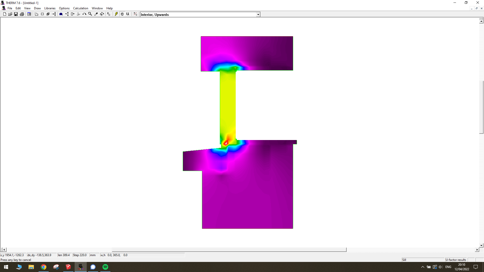

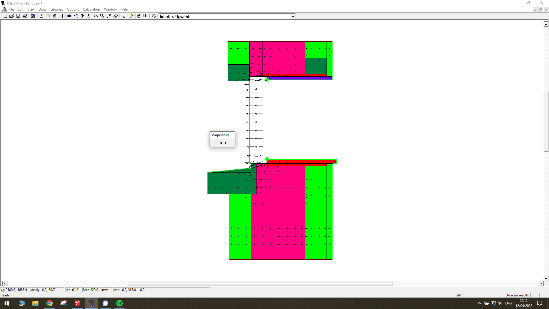

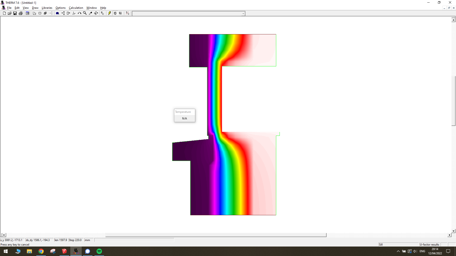

To finish this off.
I modelled my revised detail in THERM. Overall a negative external thermal bridge so satisfies the passivhaus criteria AFAIK. This only applies for insulated frames/ UPVC.
For simplicity I just used a window that was all "frame". U value of 1.2W/m2K
Posted
Sorry but that THERM model is wrong. The lintel, jambs and cill should be modelled separately effectively ignoring the window. I've not used THERM for some time but in the past it did not give the psi-value directly - the output needed more number crunching to arrive at the psi-value. Whilst the psi-value may be low in this instance I doubt that it would be negative.
