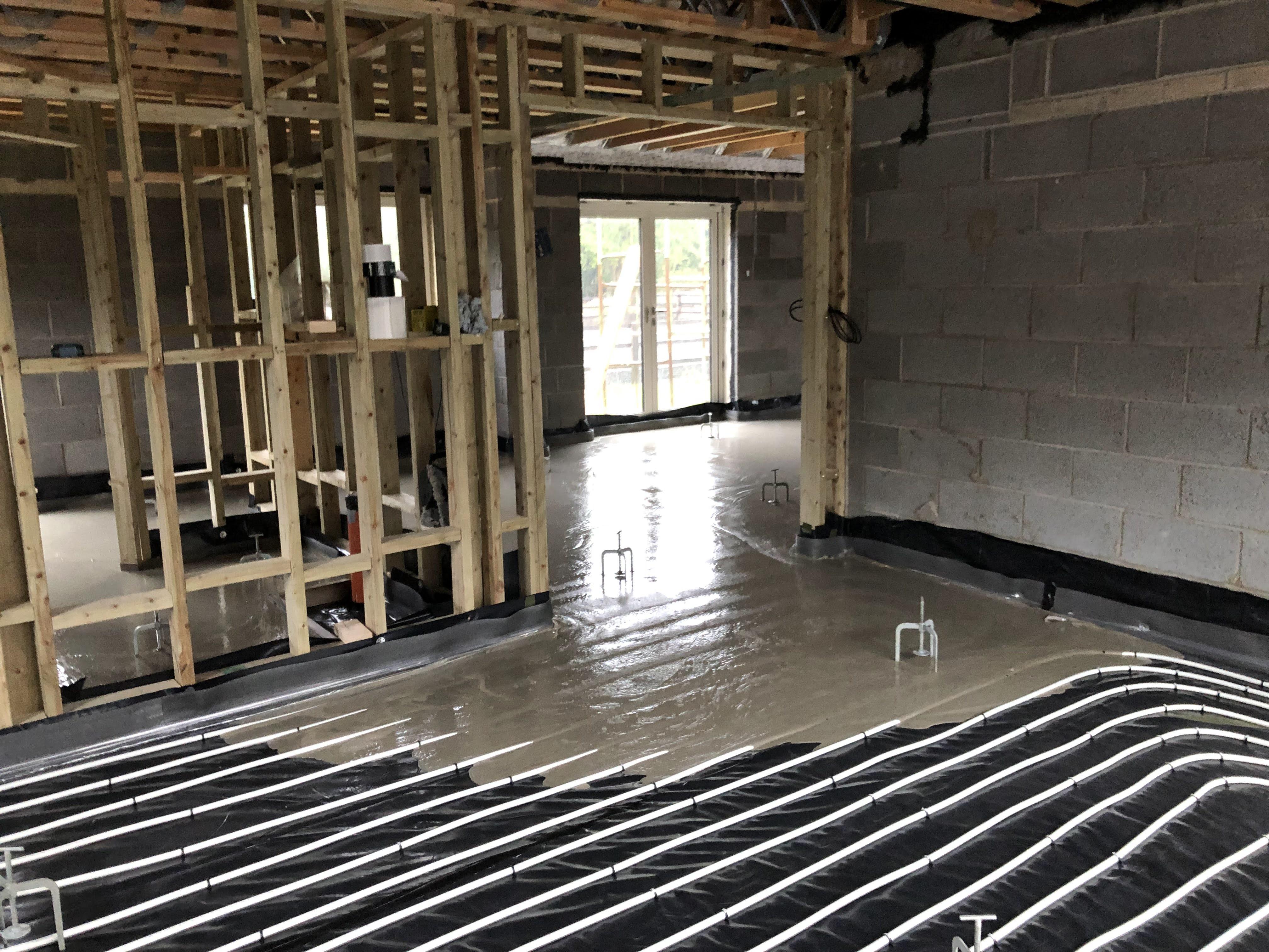

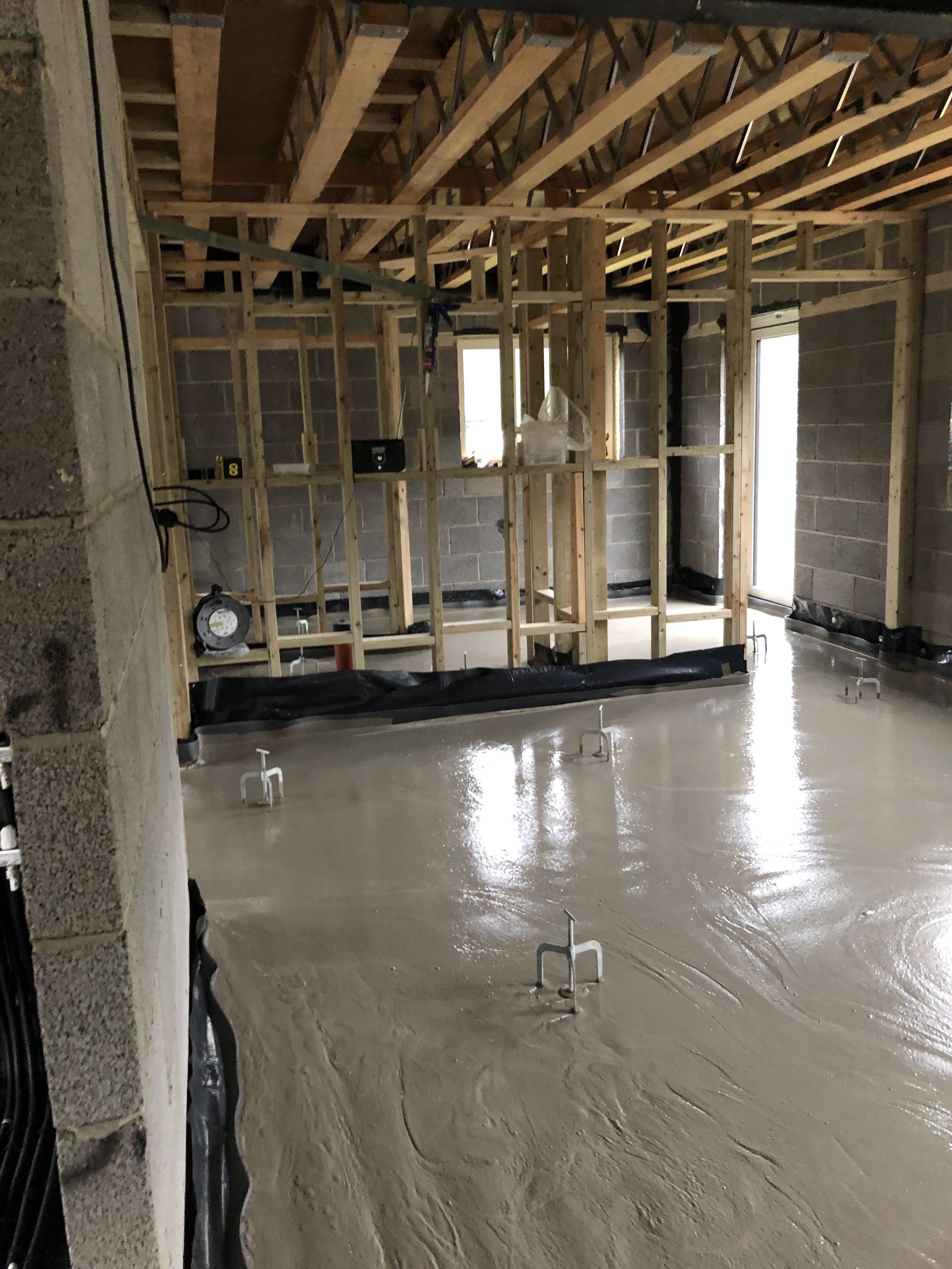

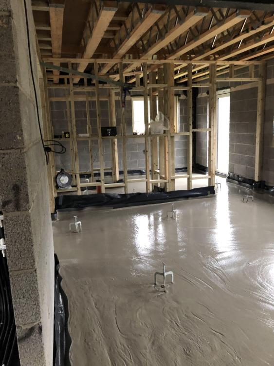

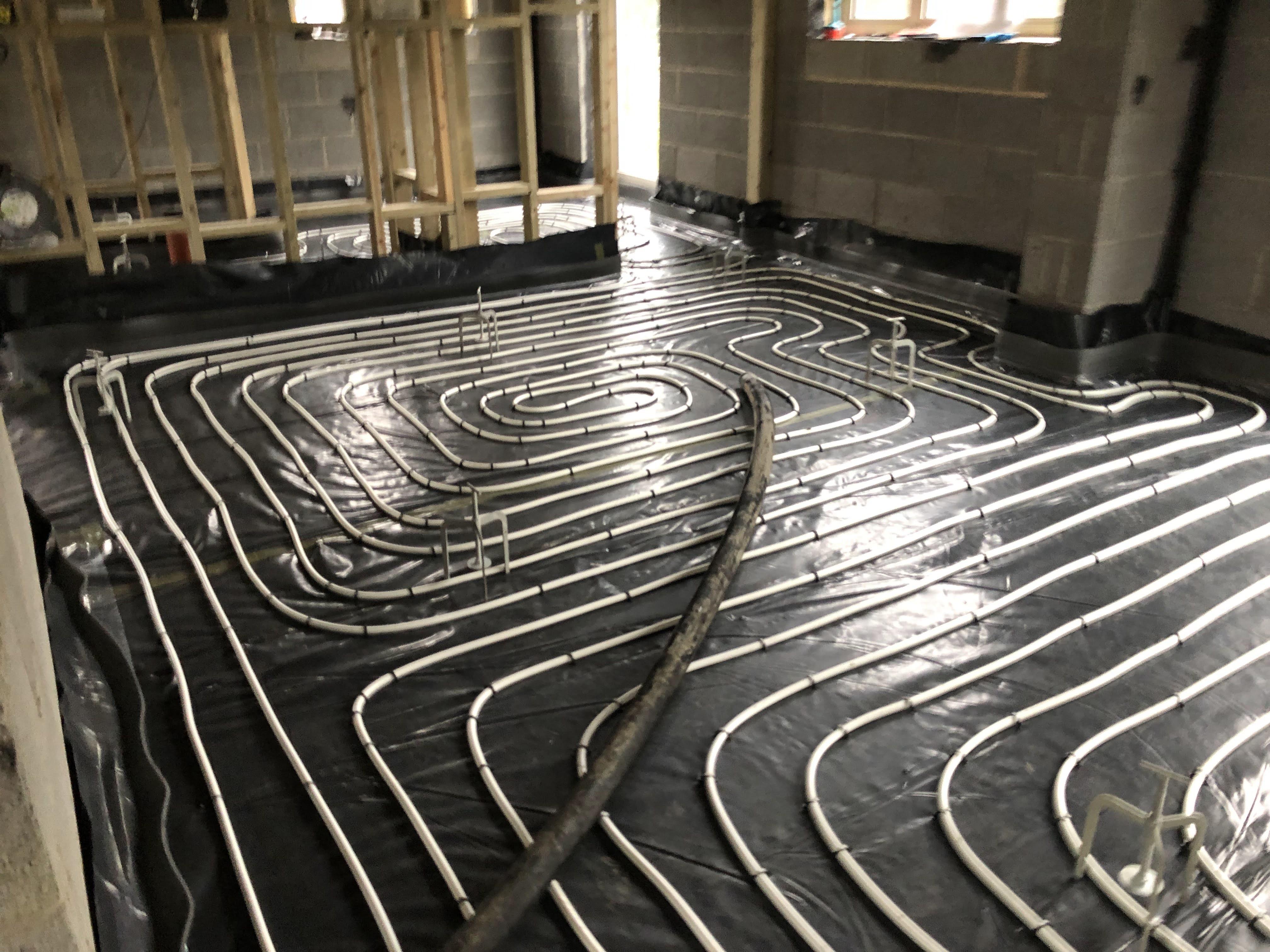

I've put it off for as long as I could really, I put the UFH down last week, pressurised it overnight.  No pipe leaks, Just a slight weep at the pressure test gauge so bitten the bullet and ordered the screed in, then I can get the Staircase sorted and that will be me done spending money till next year, will give everything time to dry out (my excuse!)...
  • Like 2
Posted (edited)

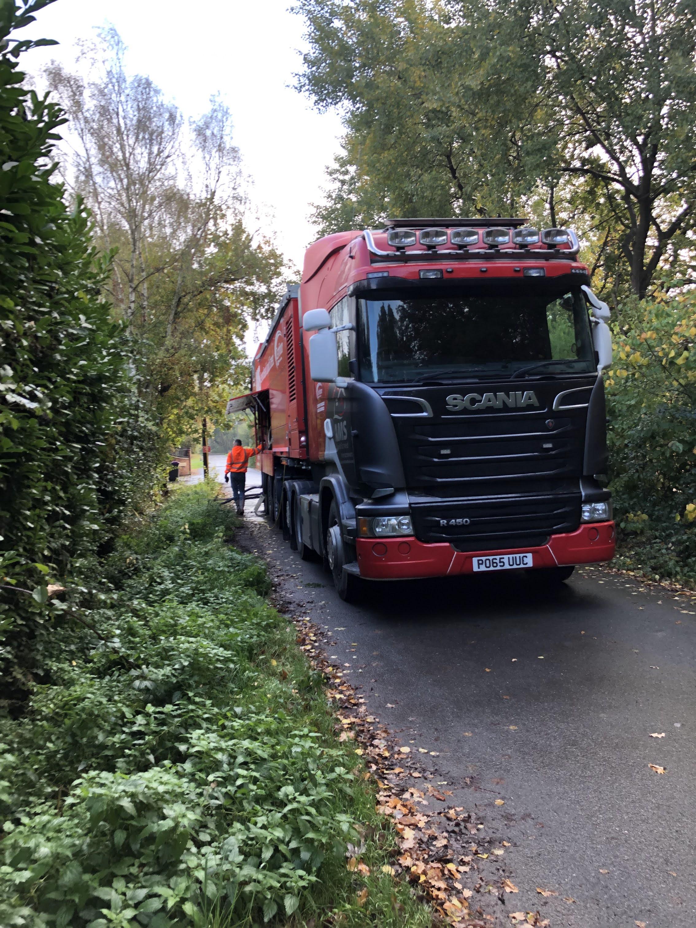

Screed is in courtesy of the mother of all screed wagons, my boy loved wading through the muck as it was being poured in, not sure if it's good practice to advertise the company or not, but if anyone needs a recommendation for a volumetric supplier in the lincoln area just ask.
