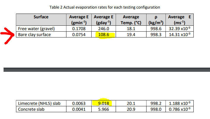

jayc89 Posted March 23, 2022 Author Posted March 23, 2022 (edited) 9 hours ago, Iceverge said: I suspect that that moisture is being pushed up due to the fact it's below external ground level ( correct me if I'm wrong but I seem to remember steps below your stairs leading down? ) Either way I would do absolutly nothing to trap moisture there for the time being, including laying any kind of floor on top. Water has a way of appearing one way or the other. At the moment I think it may be acting as a drying sump for the soil beneath your house. That's right, where the wall steps out is ground level. It's probably 0.5m below ground level at its lowest. Other than in the hight of summer the floor's never dry there. Would you avoid even breathable floors inc. Limecrete? If so, why? Edited March 23, 2022 by jayc89
Iceverge Posted March 23, 2022 Posted March 23, 2022 Any increase to the floor's permeability will push more moisture up through the structure. Limecrete is more vapour open than Concrete but nowhere as near as much as soil. It is not a solve all solution. I certainly I wouldn't put it over damp soil and expect the permeability change not to cause any issues elsewhere. Instead of a damp floor, you'll get damp walls. A table from the below shows my thinking . https://purehost.bath.ac.uk/ws/portalfiles/portal/203983214/Phillips_et_al_2019.pdf I think a french drain dug around the perimeter of the house well below the level of the floor in the cupboard and always drained to a lower plain would solve the issue. Alternatively just put 100mm of gravel in the floor or make some kind of slatted base to keep your goods dry and leave the floor alone. You'll still need to remove the moisture through heat and ventilation. The elephant in the room here is of course the house design being tweaked and bent around a vintage staircase and now a damp 3m2 cupboard. I would fill in the cupboard, and knock the stairs, add some EPS and limecrete over. Expecting a sunken room, often below the (localised) water table in an old house made from nice permeable materials to ever be dry is optimistic at best.
