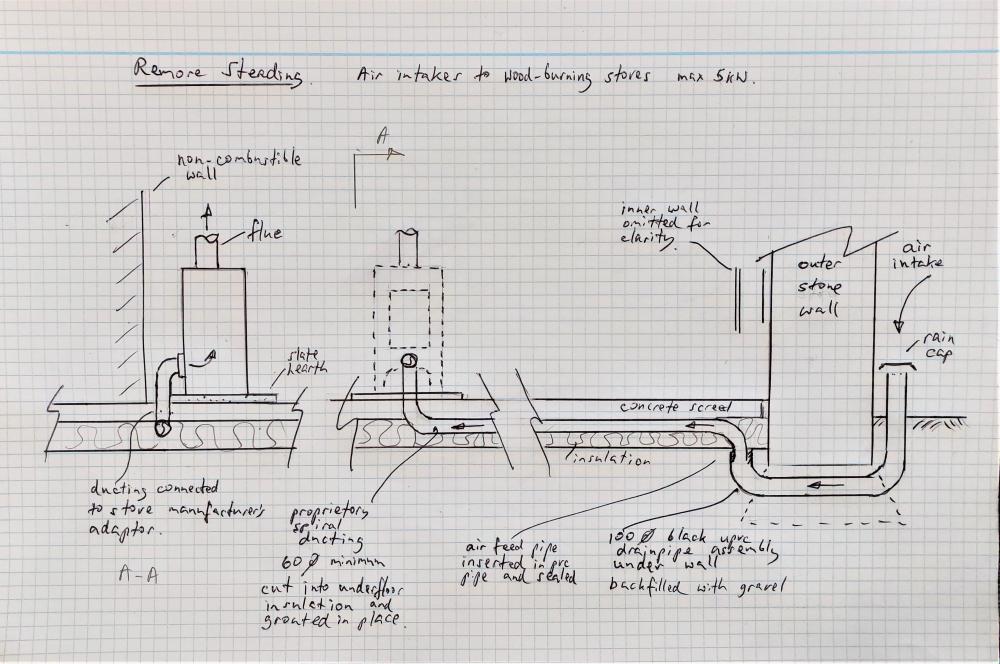

Thedreamer Posted March 22, 2022 Share Posted March 22, 2022 13 minutes ago, Nickfromwales said: Block & beam atop those piers? Timber joists. Block and beam is less common here. Link to comment Share on other sites More sharing options...
Nickfromwales Posted March 22, 2022 Share Posted March 22, 2022 1 minute ago, Thedreamer said: Timber joists. Block and beam is less common here. Ah. So deffo "combustible" sub-floor then. Did you take the blockwork 'square' all the way up to the stove? Link to comment Share on other sites More sharing options...

Thedreamer Posted March 22, 2022 Share Posted March 22, 2022 10 minutes ago, Nickfromwales said: Ah. So deffo "combustible" sub-floor then. Did you take the blockwork 'square' all the way up to the stove? Above the stove. I wanted the builder to go further to ceiling height but he didn't, instead stud and plasterboard after that. No queries from Building control, quantity surveyor, or HETAS stove installer regarding the duct. 1 Link to comment Share on other sites More sharing options...
