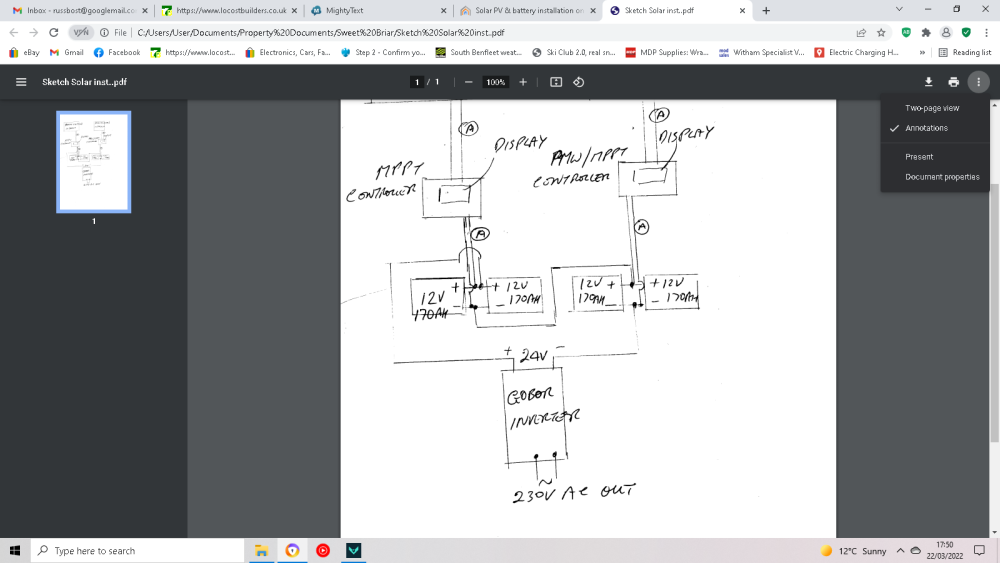

Solarexploits Posted March 22, 2022 Author Share Posted March 22, 2022 Ok, got some slightly odd stuff going on with the controllers, appreciate any advice. I have a simple clip on inductive ammeter which I use to check what's going into the controllers. Once properly sunny on the panels, the 4 controlled by the MPPT controller have around 20 A & the 2 with the Giant of sun controller around 10A, but as the voltage stored builds up, to around the 28V or a little above, the MPPT controller starts to cut in & out, roughly once a second, so, ammeter will jump from zero to 10+ then back to zero, once voltage achieves around 28.5 the controller on the 2 panels, appears to cut out completely, ie not recording any amps on the meter, tho' still showing around 27.5V+ on the display & the display shows it to be working, ie showing flow from panels to battery Is the above normal? The MPPT controller cutting in & out suggests it's registering over voltage or current, but display never showing above 28,5V & both controllers are supposed to be rated at 100A, I've never seen more than around 20 on the meter. I'm guessing the 2nd controller cutting out once volatages are high could be simply that it's registering no further top up to float voltage required & therefore cuts out until voltage drops back a little? Just had a look at some of the Pi stuff - I think that may have to wait a while!!! Apologies for numpty questions, like I said this is all new to me & whilst I have good engineering & general electrical knowledge, intricacies of controllers & the like are outside my experience Link to comment Share on other sites More sharing options...
Marvin Posted March 22, 2022 Share Posted March 22, 2022 (edited) 1 hour ago, Solarexploits said: Apologies for numpty questions, like I said this is all new to me & whilst I have good engineering & general electrical knowledge, intricacies of controllers & the like are outside my experience Hi @SolarexploitsNo apologies required. we are all searching for understanding. The good thing with so many people is someone will have knowledge of either there experiences or ways to obtain the info. We have 5.12kW tied to the grid and we are just about to start wiring up the 12V off grid battery set up which is designed to run the MVHR, Grey water system, garden watering and household lights. However the system here will be all mechanical relays and timers. We have set the panels vertical on the wall of a shed as we need as much power as possible over the winter months, and summer we will have excess so we don't need to set them at 35 degrees. For us, our aim is to reduce the amount we buy from the grid. Over the last 4 days we have purchased 30kWh. We are working on how we can reduce this to zero as much of the time as possible. Obviously: no bright days - no way, but we could probably achieve some days. We have calculated using the European solar calculator that panels produce more power than we need over the course of the year, its just the wise use and storage that's the challenge. Good luck M Edited March 22, 2022 by Marvin Spelling! Link to comment Share on other sites More sharing options...
SteamyTea Posted March 22, 2022 Share Posted March 22, 2022 1 hour ago, Solarexploits said: Ok, got some slightly odd stuff going on with the controllers, appreciate any advice. Can you do a sketch of the wiring, and where/how, you are testing it. I am wondering if, when the amps go to zero, the voltage showing is the battery voltage, rather than the charge controller voltage. Link to comment Share on other sites More sharing options...

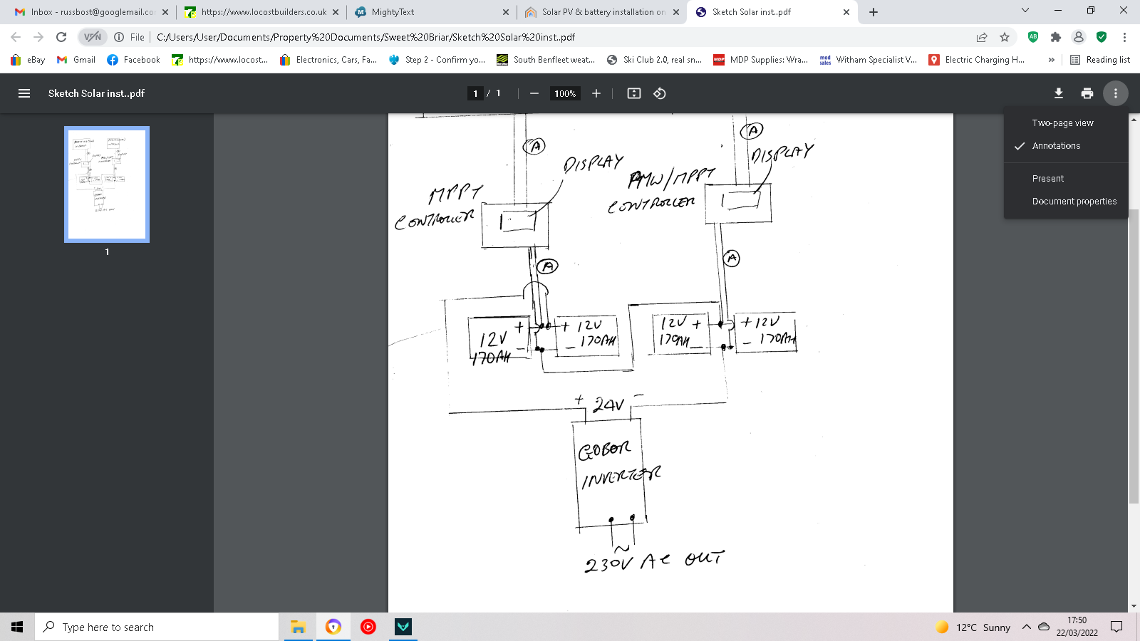

Solarexploits Posted March 22, 2022 Author Share Posted March 22, 2022 I had no idea how to upload a file to here, so see screengrab below! I'm measuring amps in any one of the 4 positions shown, simple clip on inductive ammeter. The voltages I've been giving are those shown on the display screens of the 2 controllers. When first connecting up those screens show battery voltage of whatever you're powering them with, once panels are connectedvoltage rises to, I assume, whatever it is charfing the batteries at. I have now checked the Giant of Sun controller & that has float voltage set at 27.4V (seems a little low?) factory default, the other MPPT controller, which I've now discovered is an MCU unit, I think float voltage is 28.5V, but can't find the instructions to confirm - I've definitely seen at least 28.4V on that one. If float voltage is set at 27.4V on the other unit would it then stop making an output if it sees a voltage of over that?I believe I can adjust that higher to make it match the other unit Still doesn't explain why the MPPT unit kicks in & out when at high voltages, could that simply also be maintaining a float voltage? In which case I can draw substantially more from the batteries than I currently am Link to comment Share on other sites More sharing options...
SteamyTea Posted March 22, 2022 Share Posted March 22, 2022 (edited) Bit hard to tell what is going on. Can you discharge the batteries tonight and see what happens when they start charging up. I think it may just be fooling itself into thinking the batteries are full because if the voltage and the MPPT is just checking to see if there is any room for a bit of charge. To attach files Edited March 22, 2022 by SteamyTea Link to comment Share on other sites More sharing options...
Solarexploits Posted March 22, 2022 Author Share Posted March 22, 2022 When they are charging, say voltage is down at 24 or 25V, both of the controllers are working & I'm getting around 20A on one string & around 10-12A on the other, so, thinking about it, it would make sense oif the MPPT unit has 28.4V set as the float voltage, then if it achieves that charge would kick in & out at lower level simply to maintain that float voltage? & the other unit would drop out as it "sees" a voltage above it's float voltage? I'll try & get a look tomorrow or Thursday & reset the float voltage of the lower unit, see what happens then - I'll report back in case it helps anyone else in future! Link to comment Share on other sites More sharing options...

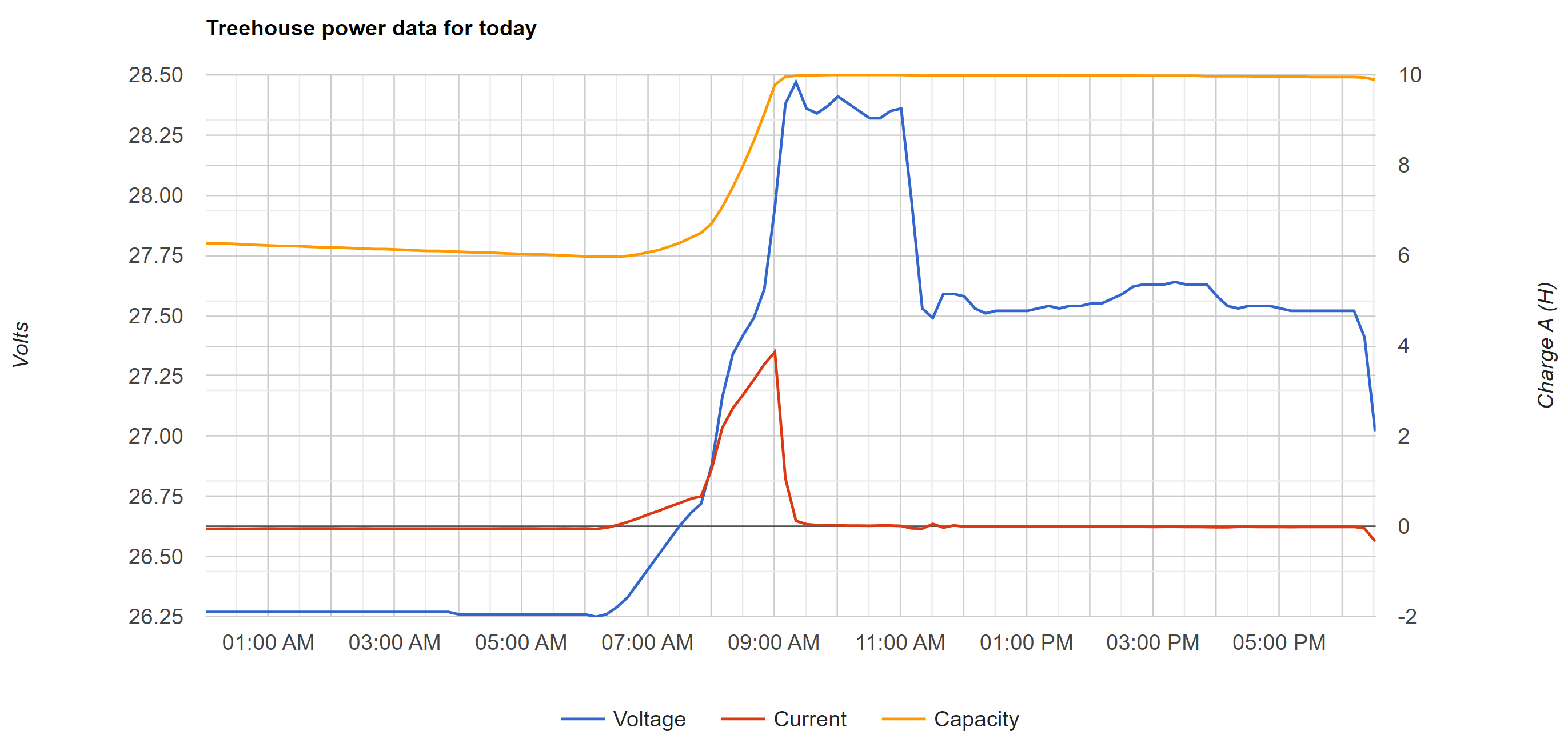

Radian Posted March 22, 2022 Share Posted March 22, 2022 Once the controllers see the batteries are full, they will shut off all charging current. Here's a plot from a single 250W module, 24V LiFePO4 battery PV setup I have for my garden lighting: Once charged, absolutely no current goes into the batteries until dawn (just started to discharge at dusk as I grabbed this plot). Link to comment Share on other sites More sharing options...
Radian Posted March 22, 2022 Share Posted March 22, 2022 Hold on a minute... 4 hours ago, Solarexploits said: I have now checked the Giant of Sun controller & that has float voltage set at 27.4V (seems a little low?) factory default, the other MPPT controller, which I've now discovered is an MCU unit, I think float voltage is 28.5V, but can't find the instructions to confirm - I've definitely seen at least 28.4V on that one. Your schematic shows the two solar battery charger units connected to their own pair of paralleled 12V batteries. Those, in turn, are series connected to provide 24V to your inverter. For a start, the 310W panels would probably deliver peak power at around 37V so would not be a good match for 12V whatever the chargers do. But then you say the (charge) controllers show 27.4V/28.4V why would they when connected to 12V? So did you draw it wrong, and in reality have two controllers (with >40V input capability) wired in parallel across your series connected battery pairs? Link to comment Share on other sites More sharing options...
Solarexploits Posted March 23, 2022 Author Share Posted March 23, 2022 You're quite right, I have drawn it wrong! That's what happens when you rush things! The 2 charge controllers are in parallel with one another charging the batteries at 24V. I'll redraw later & repost it The panels have a max o/c voltage of 44, opt. op. volts of 36V, both controllers have max input voltage of 50V, so everything should work fine together at 24V, which it seems to. I think basically I have a lot more available power than I'm using, at present, recent sunny weather, I'm not using the overnight charger which is available for 4 hours at 5p/unit, at all, so there is also spare capacity there My initial idea was to get it all working & see what I'd got in terms of operating capacity, I had already worked it out very approximately, but there are sooooo many variables involved, particularly with whether the sun is shining or not, that I was trying to overallow. As I still have 4 more panels to go up, & at present none of them are permanently fixed & are at too shallow an angle &/or not ideally placed it looks as though I should have a lot more capacity to come I want to keep the fridge & fridge/freezer on grid at present certainly at least until such time as I feel the system is 100% reliable & I'm keeping the large (but relatively temporary) draws from stuff like cooker/kettle & my garage with compressor & welder on grid as a lot of that usage is already covered by power from the existing MCS grid tied array & I didn't want to get into the realms of needing a huge, expensive inverter to handle high loads that are, by their nature not drawn for that long Link to comment Share on other sites More sharing options...
