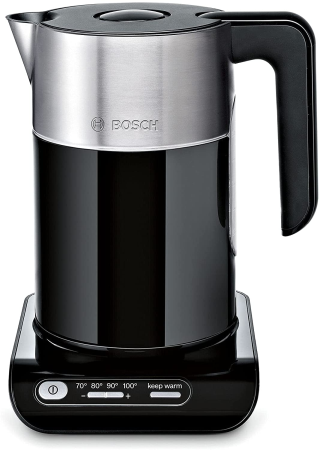

Ferdinand Posted March 15, 2022 Posted March 15, 2022 You also have the option of a thermostatic kettle, at the cost of about £70, or 3-4% of a Quooker. I have had one of these for about 8 years, and it is great at doing water for coffee at 90C. It is a Bosch TWK8633GB Styline. eg Argos https://www.argos.co.uk/product/4239712 I'm going th eother way and thinking about a boiling water tap and water softener as part of a kitchen refresh. (Checking the latest, I see you are already in this camp!) F 1
SteamyTea Posted March 15, 2022 Posted March 15, 2022 9 minutes ago, Ferdinand said: I have had one of these for about 8 years, and it is great at doing water for coffee at 90C. Do you now what has actually gone wrong with it. It may be repairable.
SimonD Posted March 15, 2022 Author Posted March 15, 2022 1 hour ago, Ferdinand said: You also have the option of a thermostatic kettle, at the cost of about £70, or 3-4% of a Quooker. I have had one of these for about 8 years, and it is great at doing water for coffee at 90C. It is a Bosch TWK8633GB Styline. eg Argos https://www.argos.co.uk/product/4239712 I'm going th eother way and thinking about a boiling water tap and water softener as part of a kitchen refresh. (Checking the latest, I see you are already in this camp!) F Thanks, yes I have one of those Bosch kettles that's been doing great service for a few years now. It's a good bit of kit. 1

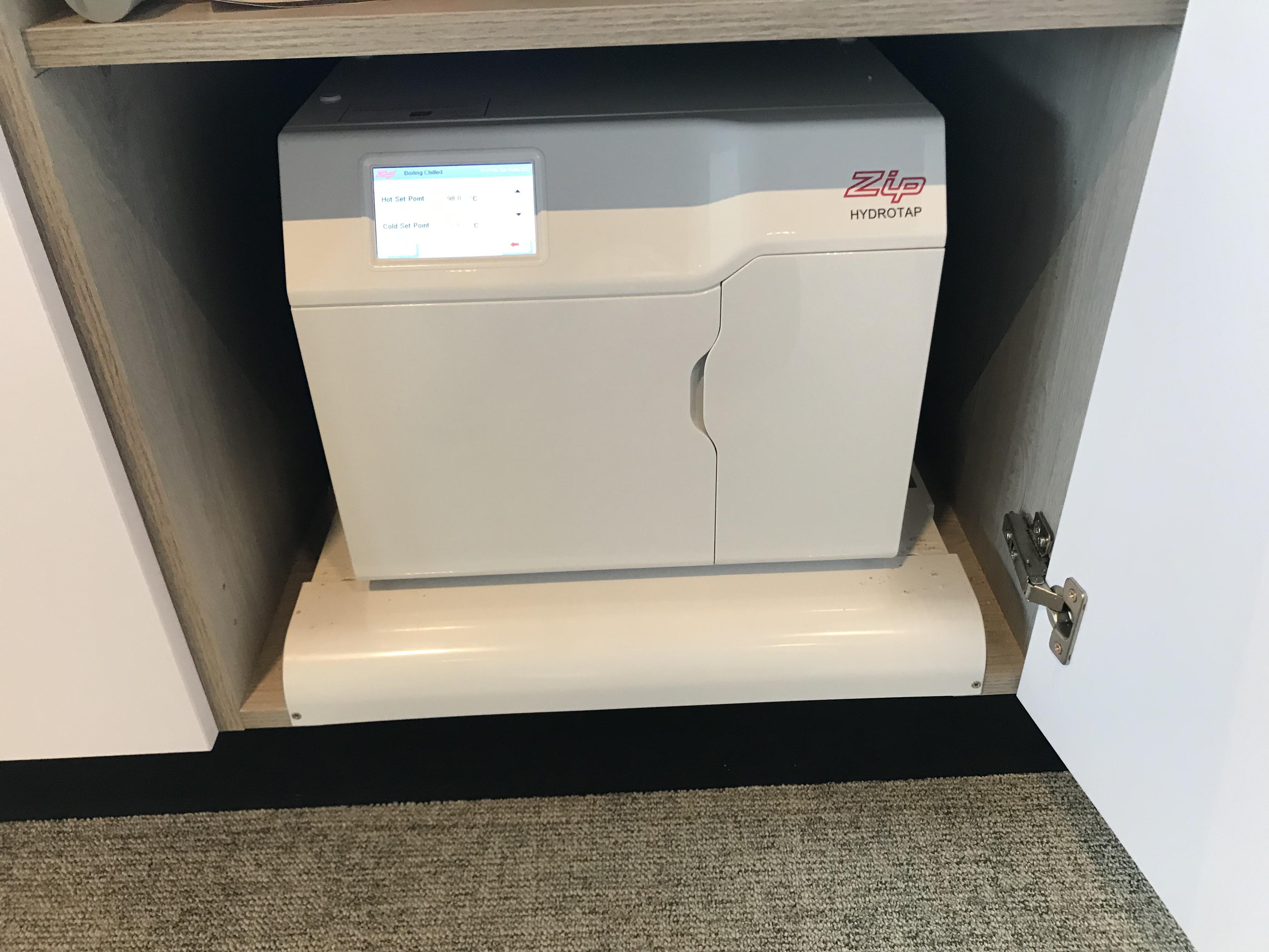

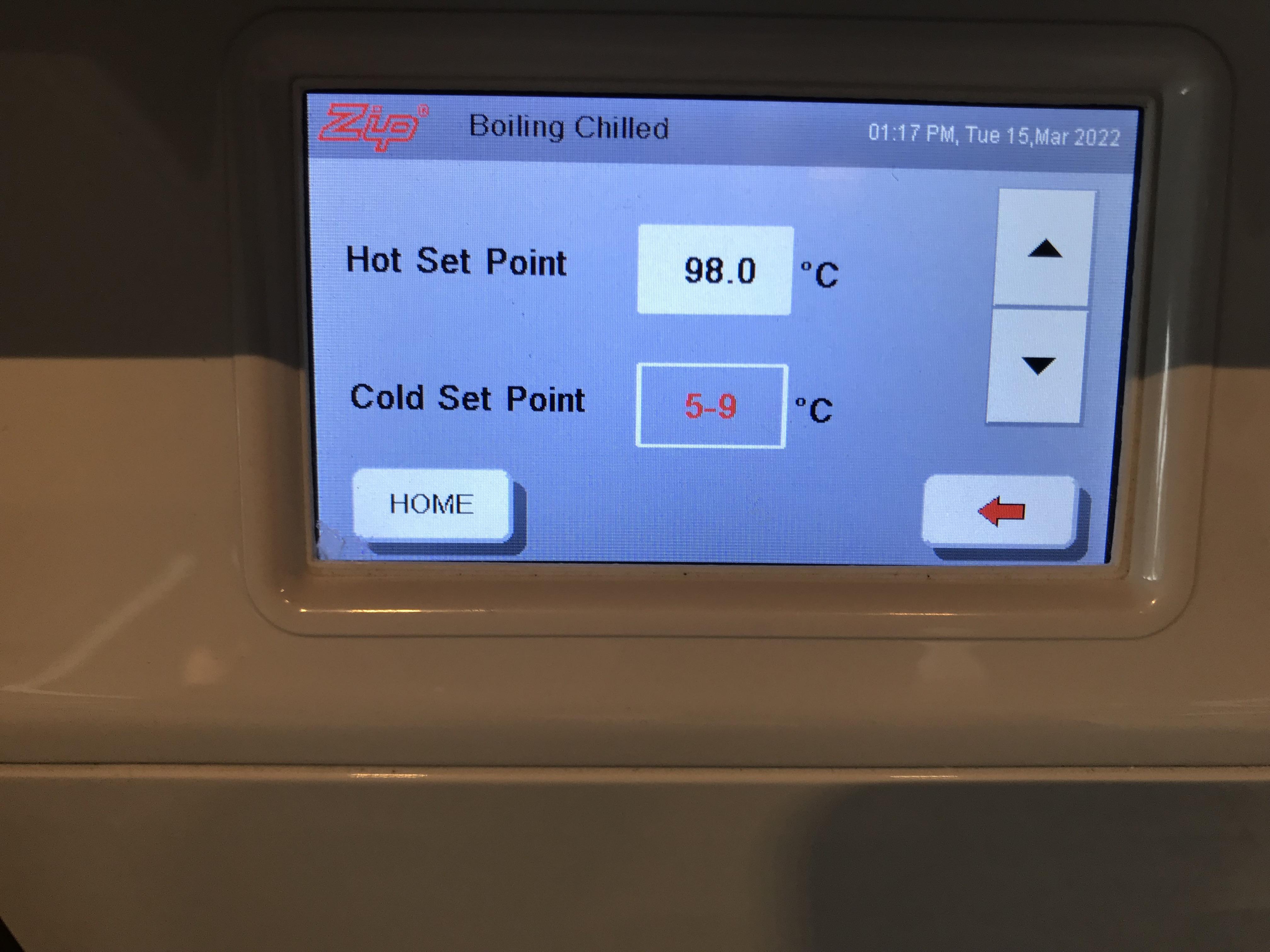

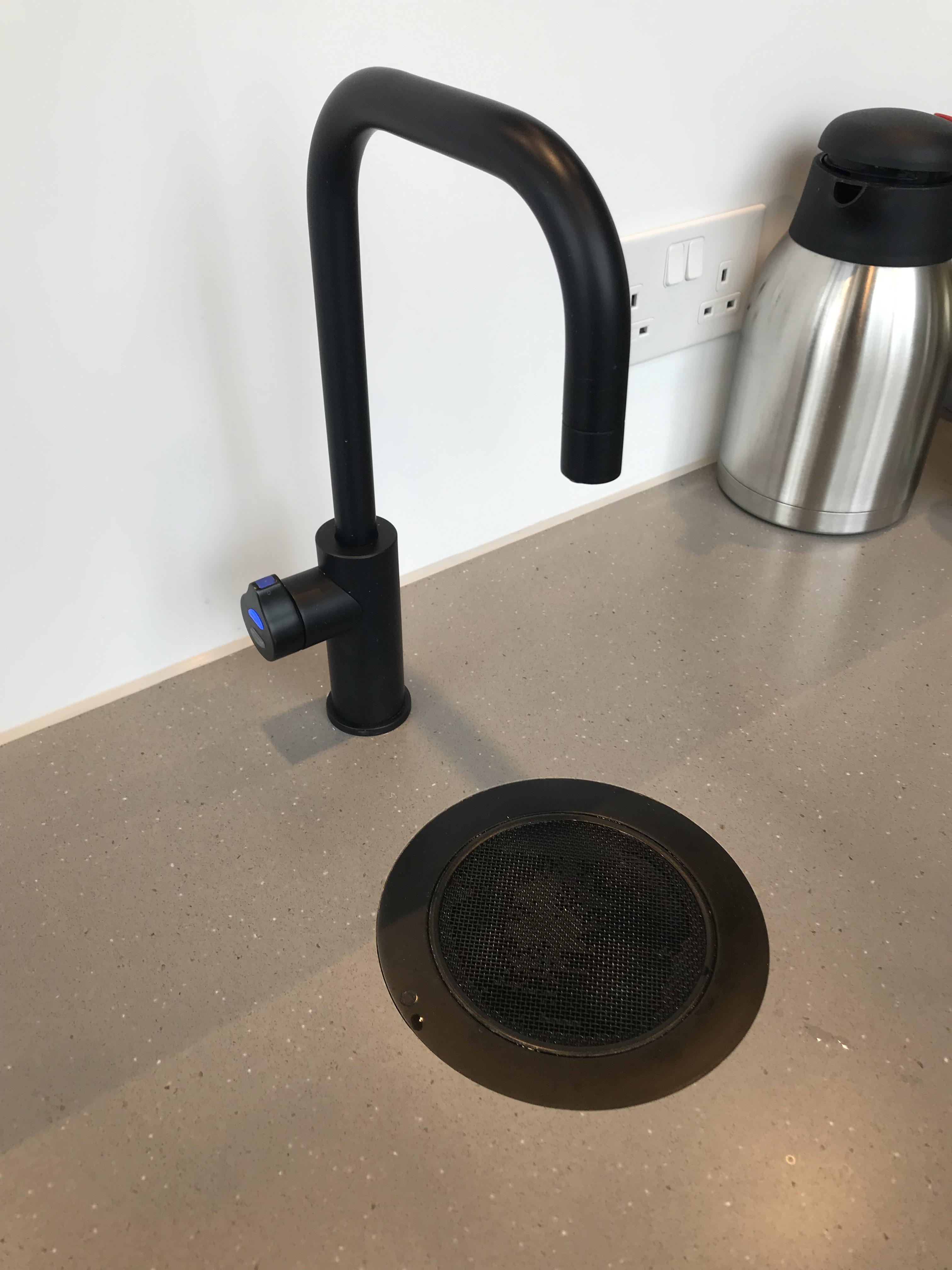

TonyT Posted March 15, 2022 Posted March 15, 2022 You can make the zip 100 deg but you get pump issues, so ours are always set just below. 1
SteamyTea Posted March 16, 2022 Posted March 16, 2022 7 hours ago, TonyT said: I always like to see an electrical outlet close to a tap.
ProDave Posted March 16, 2022 Posted March 16, 2022 2 hours ago, SteamyTea said: I always like to see an electrical outlet close to a tap. Yep. You need it to plug in the emergency kettle when the boiling tap fails. Good planning. 1

TonyT Posted March 16, 2022 Posted March 16, 2022 8 hours ago, ProDave said: Yep. You need it to plug in the emergency kettle when the boiling tap fails. Good planning. Definitely, it’s an office so got to have a back up
