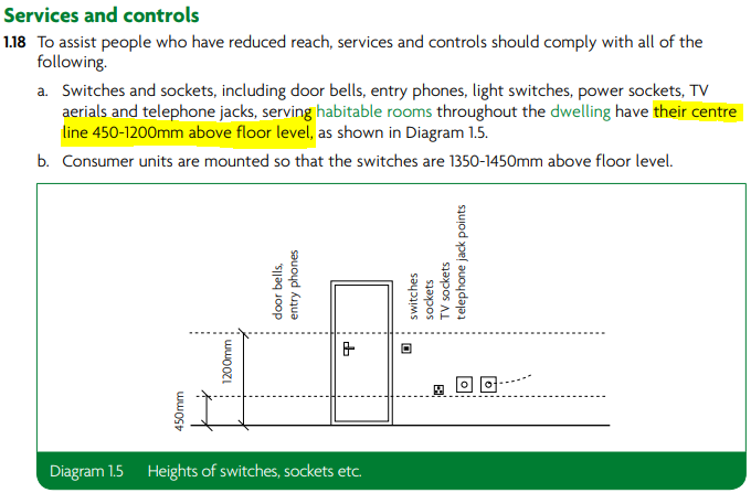

The regulations vary across the UK, so this is relevant to the English Regs (Part M).
Most commentary I can see on the English regs potentially seem to make a subtle mistake.

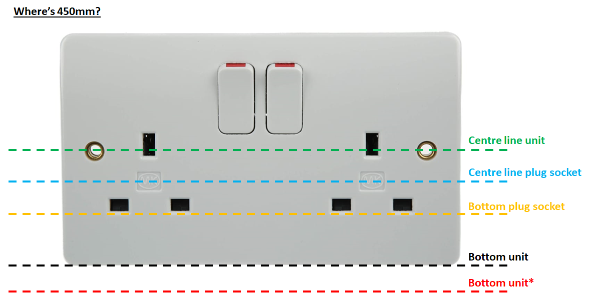

Where do you measure the 450mm to? Clause 1.18 of Part M says "their centre line". But then it references a slightly unrealistic drawing. Both copied below.
Whether you applaud the regulations intent aside, it needs to be understood as many want to put the sockets as low as 'allowed'. I would read 1.18 to mean the Green line below, or perhaps the Blue at a stretch though that's going to vary by socket manufacturer. I see lots or commentary referencing the Black line or perhaps even the Red line where people have added a little extra for carpet thickness etc.
Where have people gone with this in their own builds? Personally, I've always lived in older heights and would prefer the sockets lower upstairs in bedrooms (NB: logically the NI regs don't mandate a height here as in most dwellings there is no wheelchair access to the first floor, but that's irrelevant in England).
I have wondered about this before, my lecky said he mounts stuff between the 450-1200, not centre line in case some jobs worth challenges him!
I have always regarded the 1200 as the top of the switch plate for example.  I have never known A BC inspector actually measure them.  They would have to be a long way off the regs for that to happen I think.
I would talk to your bc, I spoke to mine about it and he just said as long as it looks right he won’t be measuring them.
Remember this only applies to general use sockets.  So a socket dedicated to a particular function can be any height, e.g high up the wall for a tv, very low down a wall for a built in appliance etc.

Chances are BC won't see most of the socket heights until final inspection.  He is not going to make you drag the washing machine out to check the socket behind it is at regulation height.  And if you have a tv mounted high on a wall, is he really going to argue that the cable should be hanging down from it and plugged into a 1200mm high socket rather than a socket hidden behind the tv?
If he was going to be that stupid, I would remove the tv, fit a blank plate in place of the socket and invite him back.  There is no cure for stupid.

An older topic that came across to me due to Google. I've always understood the centre to mean the green line, and I guess that is what my father (retired Scottish spark) did as well, as all the sockets in his house were 300mm up the wall to that green line.
I've continued that trend because I think 450mm up the wall looks stupid as hell. I like them nice and low, 300mm to centre green line is good.

I agree, 450mm looks too high but dems da rules. Unless you are renovation or extending as I understand it.
What is the green line you mention? Is it the level of the screws?

id have thought centreline is the switch which is the highest part a disabled person would need to access ?
