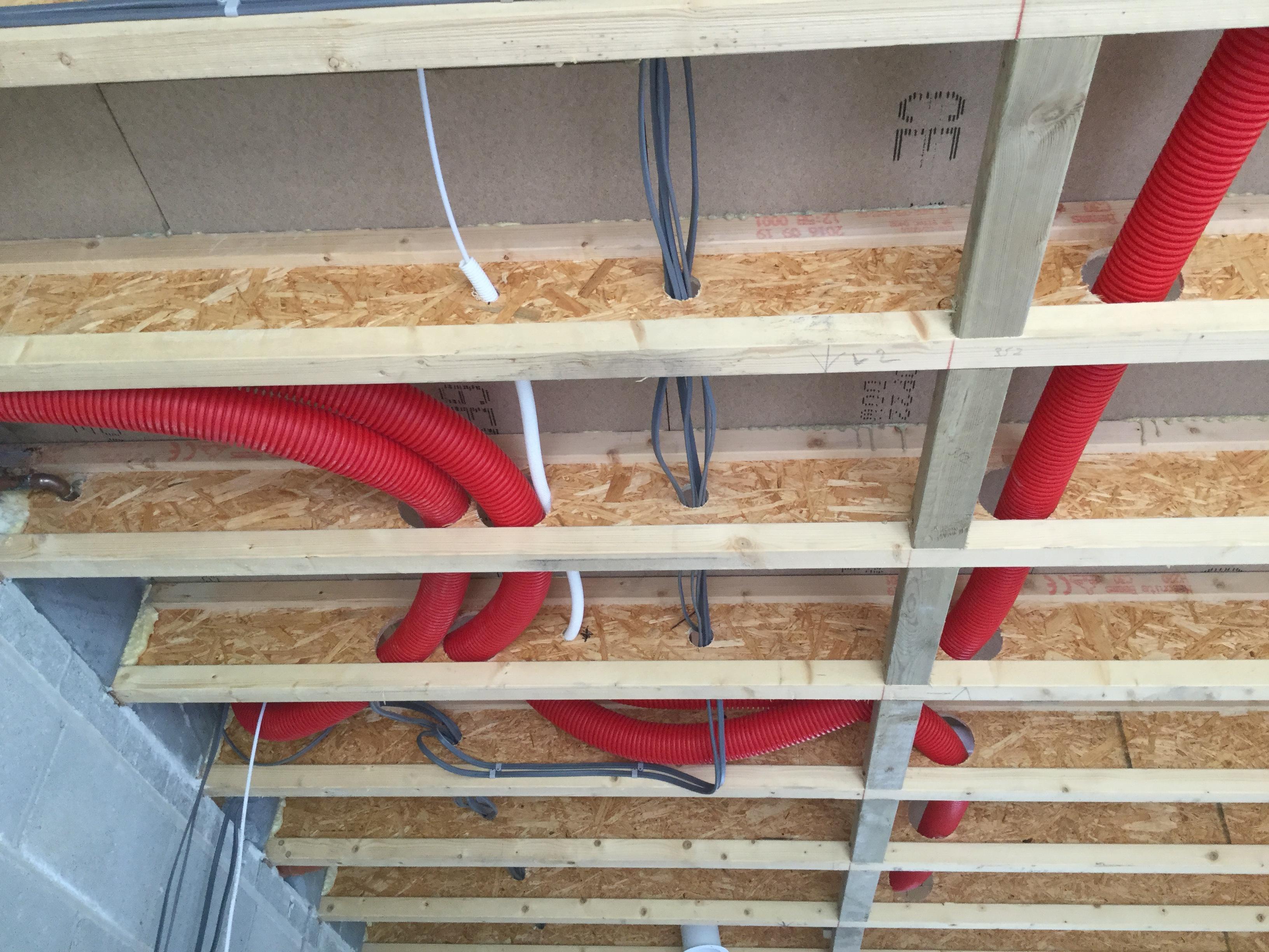

joe90 Posted March 17, 2022 Share Posted March 17, 2022 15 minutes ago, SteamyTea said: Why we should use large diameter pipe for MVHR, I discounted using larger pipe due to its inflexibility and not being able to feed the pipe through holes between joists š¤ 1 Link to comment Share on other sites More sharing options...
AccidentalSkydiver Posted March 17, 2022 Author Share Posted March 17, 2022 (edited) 48 minutes ago, joe90 said: I discounted using larger pipe due to its inflexibility and not being able to feed the pipe through holes between joists š¤ I know lots of American homes run like HUGE insulated piping, but their homes are usually huge to boot- think 75mm radial is standard here isn't it? planned on the MHVR going in the utility at the back of the workshop with the boiler and media closet... can't be a techie without a house full of tech šĀ this would give us direct access to the ground floor through the wall to the living space and then also to the WC/utility space Edited March 17, 2022 by AccidentalSkydiver Link to comment Share on other sites More sharing options...
SteamyTea Posted March 17, 2022 Share Posted March 17, 2022 1 hour ago, joe90 said: I discounted using larger pipe due to its inflexibility and not being able to feed the pipe through holes between joists That is why initial design is so important. Heating, plumbing, MVHR and wiring are often considered second, and you can tell because the design and positioning is often compromised. 1 Link to comment Share on other sites More sharing options...
joe90 Posted March 17, 2022 Share Posted March 17, 2022 29 minutes ago, AccidentalSkydiver said: I know lots of American homes run like HUGE insulated piping, Usually for warm air heating which needs a lot of air. I also ran all water pipework in plastic (I am a late convert from copper), dead easy to feed through without loads of sharp bends and joins. Ā 1 Link to comment Share on other sites More sharing options...
joe90 Posted March 17, 2022 Share Posted March 17, 2022 2 minutes ago, SteamyTea said: That is why initial design is so important. I agree BUT, you still cannot feed a stiff (non flexible) Ā pipe through holes in joists. My 110mm drainage pipe had to be installed as the i joists were installed, sooo much easier to use flexible pipe wherever possible. Link to comment Share on other sites More sharing options...
SteamyTea Posted March 17, 2022 Share Posted March 17, 2022 3 minutes ago, joe90 said: I agree BUT, you still cannot feed a stiff (non flexible) Ā pipe through holes in joists. My 110mm drainage pipe had to be installed as the i joists were installed, sooo much easier to use flexible pipe wherever possible. You have kind of argues against yourself there. Take my house.Ā It has 1 internal stud wall downstairs, and three upstairs.Ā For the sake of moving the downstairs wall 125mm, there would have been a clear drop from the loft to the ground floor.Ā All the bathroom pipework could have been fitted into that. As it is, there is a waste pipe boxed in, in the living room, no sockets on one wall (both sides), really a master class in how not to do it. Link to comment Share on other sites More sharing options...
joe90 Posted March 17, 2022 Share Posted March 17, 2022 (edited) 8 minutes ago, SteamyTea said: You have kind of argues against yourself there. I disagree 8 minutes ago, SteamyTea said: For the sake of moving the downstairs wall 125mm, there would have been a clear drop from the loft to the ground floor.Ā All the bathroom pipework could have been fitted into that. Yes, a good example of bad planning but here we are talking about ceiling joists, how are you going to feed non flexible larger diameter MVHR pipes through ceiling joists without leaving a hole in an outside wall š¤·āāļø Ā (My I joists allowed 100mm max holes in them and not near the ends.). I used my first floor airing cupboard as a riser to the loft which houses the MVHR. Edited March 17, 2022 by joe90 Link to comment Share on other sites More sharing options...
SteamyTea Posted March 17, 2022 Share Posted March 17, 2022 5 minutes ago, joe90 said: I used my first floor airing cupboard as a riser to the loft which houses the MVHR. By designing in more features like that if you can. 1 Link to comment Share on other sites More sharing options...
TerryE Posted March 17, 2022 Share Posted March 17, 2022 (edited) In terms of cost and simplicity using a distribution manifold and standard flexible ducting as @joe90Ā shows above is far more straightforward and easier to balance.Ā Ours is pretty much the same as his and @ProDaveĀ have shown.Ā We doubled up on 3 vents in our house: the LR inlet; and the inlet and outlet in our kitchen / dining room, because the required flow rate was higher that we could achieve with a single pipe when balancing the system: you can only throttle back an individual terminal manifold. Edited March 17, 2022 by TerryE Link to comment Share on other sites More sharing options...

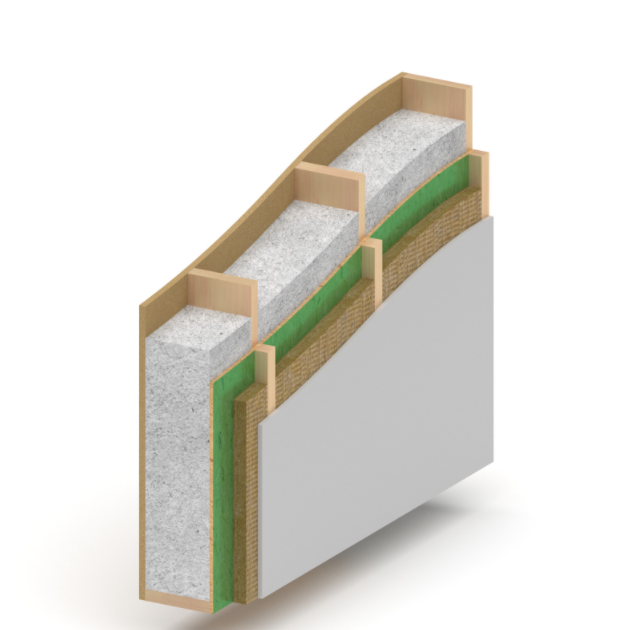

Iceverge Posted March 20, 2022 Share Posted March 20, 2022 Ā Ā Here's a pic of my favourite stick build as described previously.Ā Ā Cellulose, continuous external 22mm woodfiber insulation , robust osb airtightness layer, windtight by design, everything nailgun compatible, off the shelf timber sizes, generous service cavity, negative embodied energy, excellent decrement delay, completely moisture safe, U value 0.13 W/m2K.Ā Ā Yum Yum Yum!Ā Ā 2 Link to comment Share on other sites More sharing options...
AccidentalSkydiver Posted March 21, 2022 Author Share Posted March 21, 2022 On 20/03/2022 at 01:31, Iceverge said: Ā Ā Here's a pic of my favourite stick build as described previously.Ā Ā Cellulose, continuous external 22mm woodfiber insulation , robust osb airtightness layer, windtight by design, everything nailgun compatible, off the shelf timber sizes, generous service cavity, negative embodied energy, excellent decrement delay, completely moisture safe, U value 0.13 W/m2K.Ā Ā Yum Yum Yum!Ā Ā The right side actually looks very similar to my design, except I was having the insulation outboard of the OSB- however further reading, youĀ canĀ run into moisture retention and/our internal vapour and temps causing condensate to gather outside the vapour barrier but stuck in the outboard insulation which can lead to mould which is obviously not great. My order of sealing details are water, air, vapour, thermal... so if I can get the first 3 done- the last should be self supporting when the insulation is in, but running the vapour-open insulation before the main insulation with the service cavity is a nice touch, I'm going to revisit some of my modelling in the next coming weeks once the design of the house itself is done and signed off by an architect, then rest of the actual structural stuff comes after. Ā On another note, I just spent a small fortune on reading materials. I picked up the IBC 2021, Building Regs 2010 (2021 edition, with Part L for energy conservation), Scottish small dwellings guide, eurocode 5 and BSI BS-8103 all stacked up for reading materials for my next few weeksĀ š Link to comment Share on other sites More sharing options...

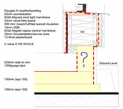

TerryE Posted March 21, 2022 Share Posted March 21, 2022 (edited) @AccidentalSkydiverĀ out of interest if you google youtube MBC timber, then you'll get lots of examples.Ā Ā HereĀ is one example which shows their warmslab and Larson struct cassette builds.Ā Ā In terms of your profile a few thoughts: You only need one racking layer and also a vapour barrier on theĀ innerĀ surface of the TF.Ā You can use something like 12 mm OSB3 for this.Ā If your verticals are at 40mm centres then you can join the OBS on every 3rd upright (or 2nd if you use 60mm centres).Ā (These would need tweaked so save a lot of OSB ripping, if you are buying in 1220 OSB rather than 1200s.)Ā Ā We then had 44Ć25 battens oner-pinned on the vertical upright lines after taping up the OSB butt joints, to create a service cavity.Ā This made first-fit a doddle.Ā (Your SE would need to sign-off on 40 vs 60, racking, etc.) I can't see any advantage in having an outer OSB layer between the main TF verticals and the standoff fill section. In terms of the stand-off, remember that you need to tie this structurally to the outer blockwork leaf.Ā The ties need to anchor to something in the TF.Ā This will require some decent uprights that are tied to the main TF uprights, sayĀ 38 x 63 CLS minimum and made up a frame to mirror the main TF.Ā You would need some structural spacer nogginsĀ to stand the outer TF from the inner say 60 Ć 89 Ć 38 if you want a 300mm fill void, but you could easily up the 60 to fit whatever you paln as the profile.Ā You'd want some form of through anchor to fix the two frame; probably the simplest method would be to use 200mm timber fixing to drive through the out CLS, the standoff and into the inner TF. The vapour breather (panelvent + membrane) layer goes on the outside of the outer TF.Ā Mark the upright lines so you know where to fix the ties.Ā Remember that you want the frame to breath outwards, not inwards.Ā Put in through-pipes for any services that you need to take through the frame.Ā These pipe exteriors can be sealed to the frame for air tightness and the the pipes themselves foamed and sealed once the services has been pulled. You can leave the cellulose blowing until before 1st fit.Ā (Our guys just cut a 100mm hole at the top of each panel section and pumped the stuff in section by section, then taped up the hole.)Ā Ā Ā Ā Edited March 21, 2022 by TerryE 1 Link to comment Share on other sites More sharing options...

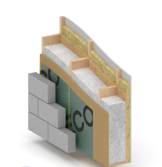

Iceverge Posted March 21, 2022 Share Posted March 21, 2022 6 hours ago, AccidentalSkydiver said: Ā I'm going to revisit some of my modelling in the next coming weeks once the design of the house itself is done and signed off by an architect Ā Make sure you have enough wall thickness in the plans, with a block exterior + stone I would be looking for an absolute minimum of 500mm. You could use a cement board over a cavity only as backing for the stone instead of block, It wouldn't be cheaper and may cost more in house insurance however.Ā Do PHPP before the signoff too.Ā Ā 5 hours ago, AccidentalSkydiver said: Here's a quick example I've got in my headĀ ...35mm stone slip, 100mm thermal blocks, 45mm gap, 18mm osb3, 180mm gaps for insulation, with side-blocked 37x37mm battens which are spaced 500mm OC, then the 18mm OSB, 2x6 600mm OC on a 2x6 sill. Ā The 37mm*37mm battens would be very bendy to try to work with. Typically people say unless it's at least 89*38 don't bother. OSB is not cheap.Ā You have 2 layers.Ā Also a lot of labour. As you plan on doing lots of the building yourself plan your time economically. It takes 3 times longer than you normally estimate in my experience.Ā Lots of the North American construction is a little bit one dimensional. Happily installing a single paned vinyl window with terrible air sealing in an r30 wall makes no sense or putting an 18 inch twinwall on a slab with 2 inch polyiso screams of designers who haven't bothered to so the calcs.Ā Ā Ā If you were set on the twin wall a double stud rather than Larsen truss could be easier to build on site as well as significantly cheaper.Ā Ā Here is an example.Ā https://passivehouseplus.ie/articles/renewable-energy/on-the-plus-side Ā With this you all but eliminate your wall-floor thermal bridge and the wall-ceiling. Your band joist area remains but this isn't as big as you think. You can drop to 1 layer of OSB externally for cost. I would still include an internal vapour barrier and service cavity. If you start playing with PHPP or even Jeremy's calculator here you'll see how much more important airtightness is than outright U values. Also thermal bridging is extremely important.Ā It can take a bit of setting up but the free software THERM is a great free tool if you have the patience.Ā Ā Ā On this also, an external layer of woodfiber will provide really terrific over insulation of window frames and is almost fool proof to get right unlike detailing internal thermal breaks in timber walls.Ā Ā Ā Ā Have you played withĀ https://www.ubakus.com/en/r-value-calculator/. Again looking at your sketchup drawings I think you'd enjoy it!Ā Ā Ā Ā Ā Ā Ā Link to comment Share on other sites More sharing options...
Simplysimon Posted March 21, 2022 Share Posted March 21, 2022 6 hours ago, AccidentalSkydiver said: Because I'm an awkward git? šĀ I'm 100% going to be framing traditionally, ok, a few of us here are as well, a 350mm I beam kit wall, 600mm c/c studs, mdf outer skin (breathable), osb internal with service cavity and blown cellulose is the way i've built as well as @Patrick and possibly a few others with variations and can be stick built on site. would seem to be a lot easier than your method. keep it simple 1 Link to comment Share on other sites More sharing options...
AccidentalSkydiver Posted March 21, 2022 Author Share Posted March 21, 2022 (edited) 58 minutes ago, Iceverge said: Ā Make sure you have enough wall thickness in the plans, with a block exterior + stone I would be looking for an absolute minimum of 500mm. You could use a cement board over a cavity only as backing for the stone instead of block, It wouldn't be cheaper and may cost more in house insurance however.Ā Do PHPP before the signoff too.Ā Ā Ā The 37mm*37mm battens would be very bendy to try to work with. Typically people say unless it's at least 89*38 don't bother. OSB is not cheap.Ā You have 2 layers.Ā Also a lot of labour. As you plan on doing lots of the building yourself plan your time economically. It takes 3 times longer than you normally estimate in my experience.Ā Lots of the North American construction is a little bit one dimensional. Happily installing a single paned vinyl window with terrible air sealing in an r30 wall makes no sense or putting an 18 inch twinwall on a slab with 2 inch polyiso screams of designers who haven't bothered to so the calcs.Ā Ā Ā If you were set on the twin wall a double stud rather than Larsen truss could be easier to build on site as well as significantly cheaper.Ā Ā Here is an example.Ā https://passivehouseplus.ie/articles/renewable-energy/on-the-plus-side Ā With this you all but eliminate your wall-floor thermal bridge and the wall-ceiling. Your band joist area remains but this isn't as big as you think. You can drop to 1 layer of OSB externally for cost. I would still include an internal vapour barrier and service cavity. If you start playing with PHPP or even Jeremy's calculator here you'll see how much more important airtightness is than outright U values. Also thermal bridging is extremely important.Ā It can take a bit of setting up but the free software THERM is a great free tool if you have the patience.Ā Ā Ā On this also, an external layer of woodfiber will provide really terrific over insulation of window frames and is almost fool proof to get right unlike detailing internal thermal breaks in timber walls.Ā Ā Ā Ā Have you played withĀ https://www.ubakus.com/en/r-value-calculator/. Again looking at your sketchup drawings I think you'd enjoy it!Ā Ā Ā Ā Ā Ā Ā I'd picked 37x37mm off top of my head without consulting my tape measure... things are always a bit bigger in your minds eye aren't they š¤£Ā but with the two layers, I'd expect plenty of shear strength with the cross sectional rigidity being created with the sheathing and then the actual main structure (since this would essentially be a stand off and run flat and perpendicular to the supporting wall.Ā You're probably correct though, they'd be a bit bendy - I suppose with a 3 / 3 layout at 400mm OC you'd have more strength if you put them on alternating sides... Quickly added a 400mm OC model into a setup in fusion, going to strength model this tomorrow when I have some more time! Yeah I've noticed the flange fit windows and then the super-raving about 'European style UPVC tilt turn' conventional windows here- it is a bit boggling you'd spend the time and money insulating to stick on flange fit which are so poorly sealed in the rough opening...Ā Did utility in 39x89 which is solid, but it was also a fairly small area and a single wall to enclose the flat roof+ an inside walls in the old coal house/pantry. I just did sill seal and a basic rock wool in that area though I understand wood and OSB especially are not cheap - just the few projects I've done in the past year for people have been a bit mad for the materials compared to even 18 months before, however, I've already got a costing sheet I'm using to add up the current expected cost of framing including joists, trusses, rim joists etc with an average of 10% over purchase and a contingency of another 3k - but that might change. Alot of my current plans I've sketched up (confusingly I've done a fair bit of it in Fusion) have an additional 18mm inboard for plasterboard + the external sheathing where needed, plus a 36mm layer in the garage dividing wall for fire insulation - however, I realised I can likely use a single fire-rated plasterboard - Cheers for the resources, I'm going to play withĀ ubakus now Edited March 21, 2022 by AccidentalSkydiver Link to comment Share on other sites More sharing options...
