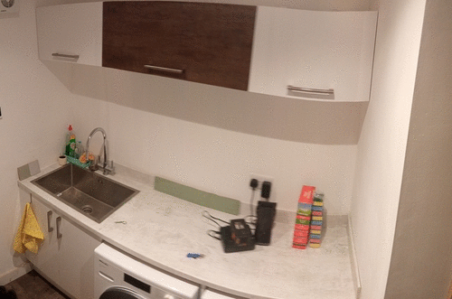

canalsiderenovation Posted March 9, 2022 Author Share Posted March 9, 2022 6 hours ago, Russell griffiths said: The easiest thing to do is forget metro tiles, they look naff unless very well planned out. Always look silly in a corner, again down to planning. Choose a better tile and your options will increase tenfold. Thanks @Temp I'll look into the links. I actually like them @Russell griffithsand we have a tiler to do them properly! We have been to quite a few tile places and looked at budget options as it's not a room we want to spend a lot to be honest! Trying to find the shade of green we liked (pale sage) was generally with the smaller tiles (we have found one similar to Topps but Johnson's outlet as they are half the price and offer Blue Light discount). The corner is more a side, I was probably unclear. It's more of two sides. At the back of the sink the tiles will go to the top of the wall units then come round the two sides so it will be the top of the sides that will need edging and the sides of the side tiles if that makes sense, excuse the mess. See pic (oh wow look at that I got it to flash don't ask me how)!! It's not a large room and more of a walk through, cleaning etc and not somewhere we spend lots of time if we can help it because I'd we are in there we are cleaning, handwashing stuff, cleaning grubby things in the big sink etc. It's more something practical. With pale sage colour I don't think a dark grout will go well, most pictures seem to have them with white grout but a protector definitely sounds like a good plan! Any particular recommendations of grout or adhesive and protector as I'll get them all from Screwfix/Toolstation. Link to comment Share on other sites More sharing options...

Bonner Posted March 10, 2022 Share Posted March 10, 2022 10 hours ago, canalsiderenovation said: See pic (oh wow look at that I got it to flash don't ask me how)!! Forget tiles, go for a wall panel here. Easy to fit yourself, no grout and easy to clean. I am sure you can get a shade of green to go with your flashing neon light strip Link to comment Share on other sites More sharing options...

canalsiderenovation Posted March 10, 2022 Author Share Posted March 10, 2022 10 hours ago, Bonner said: Forget tiles, go for a wall panel here. Easy to fit yourself, no grout and easy to clean. I am sure you can get a shade of green to go with your flashing neon light strip We have the showerwall panels in the bathrooms (the ones backed onto the wood) and like them but we disregarded them for two reasons - we couldn't find a colour we liked which went with the patterned worktop we have. The majority of panels we saw are patterned like marble or stone effect which we have which disguise any joins and the plain colour ones are awful and the joins are far more noticeable and secondly, they are so expensive especially if they were to go on the wall opposite floor to ceiling and we want the same thing behind the sink as we do on the wall opposite! I'm not a huge fan of grout but I've never had issues keeping it clean in the last house. Bit of bicarb works a treat 2 hours ago, Russell griffiths said: In that location I would look at a splash back designed for kitchens one piece, or in your case 3 pieces, no grout to get dirty. And you can probably fit it yourself with a tube of pu adhesive and a tube of silicon. 10 hours ago, dpmiller said: I'm not a fan of edging, I prefer just to wipe a fillet of grout around the periphery. That's a really good idea @dpmiller and @Tempand gets away from using edging. Link to comment Share on other sites More sharing options...
