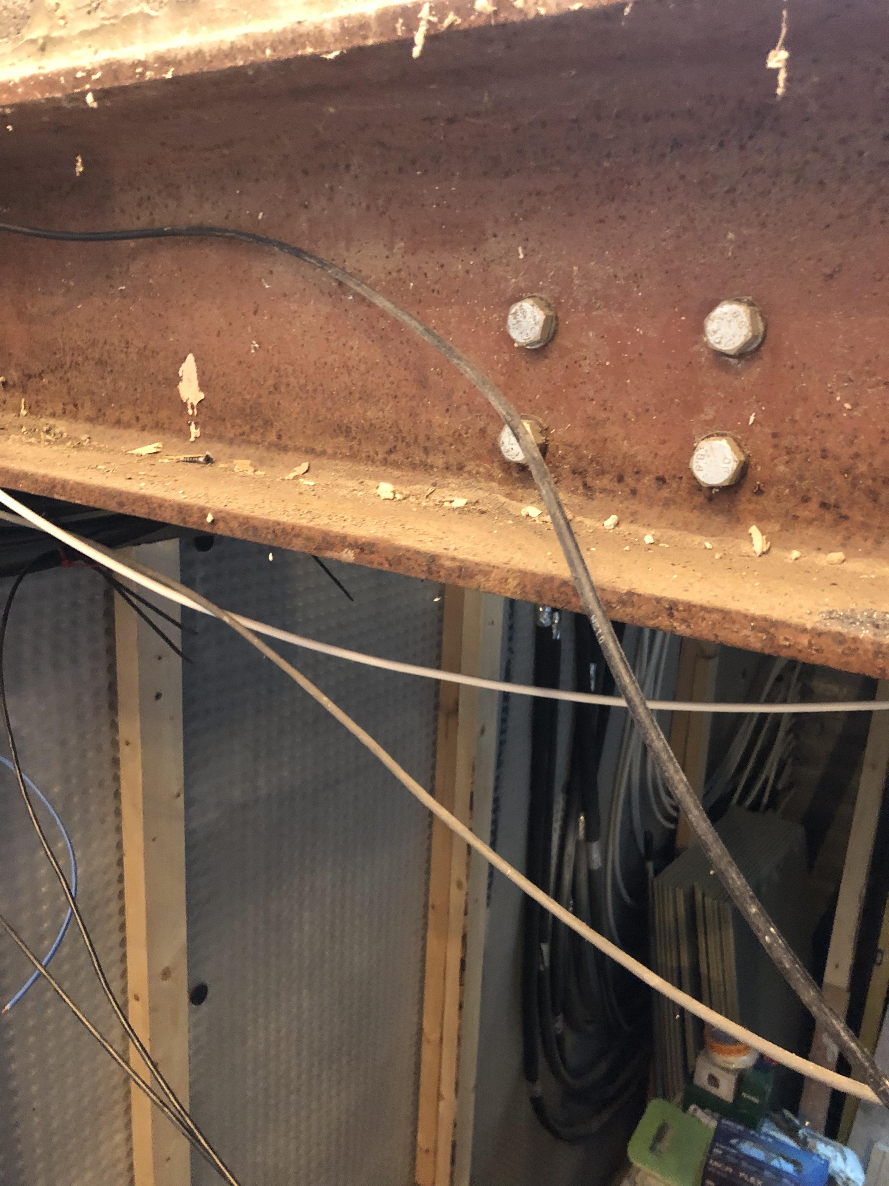

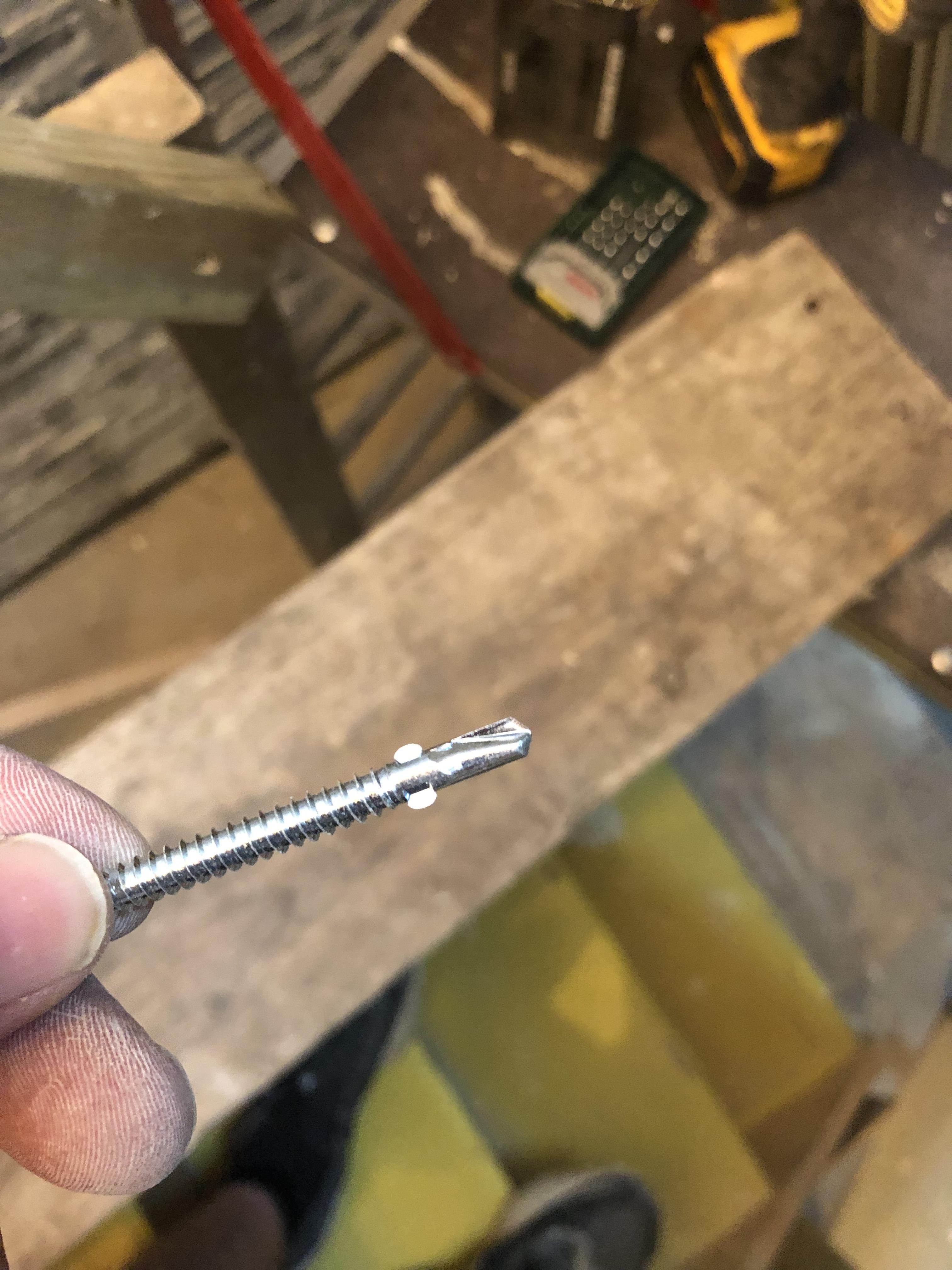

Pocster Posted March 2, 2022 Share Posted March 2, 2022 Apologies for starting a new thread on this again ! Steel around 15mm thick . Even with a pilot hole ( have to do from above as it’s the only way to get enough force to even start ) - this just ain’t happening. My assumption is if just 1 screw into the steel is a pita then I’m doing it wrong . Surely there must be a better way ? Link to comment Share on other sites More sharing options...
Pocster Posted March 2, 2022 Author Share Posted March 2, 2022 Right ! Annoyed at this . Need metal bits and drill from underneath I.e upwards just to make a hole so can bolt timber . These self drill screws just ain’t doing it Link to comment Share on other sites More sharing options...

saveasteading Posted March 2, 2022 Share Posted March 2, 2022 Probably the wrong screw. There are different heads for heavy steel, usually an inset tungsten blade that scratches a hole rather than pulls itself through. With the right screw and good drill it should cut through in 10 seconds or so. 1 Link to comment Share on other sites More sharing options...

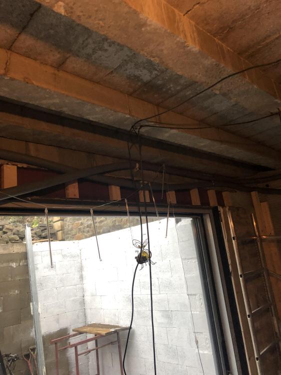

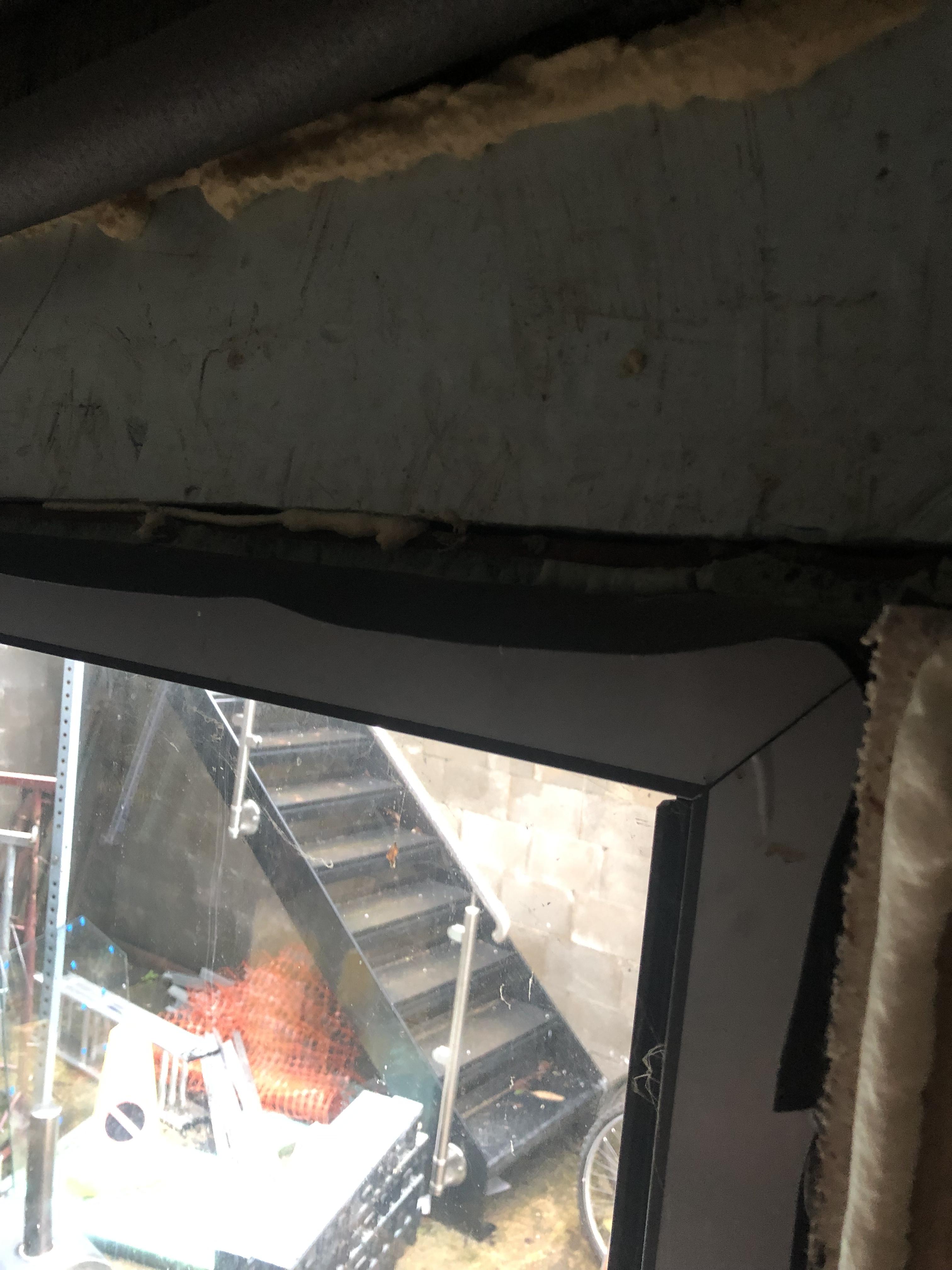

Pocster Posted March 2, 2022 Author Share Posted March 2, 2022 41 minutes ago, saveasteading said: Probably the wrong screw. There are different heads for heavy steel, usually an inset tungsten blade that scratches a hole rather than pulls itself through. With the right screw and good drill it should cut through in 10 seconds or so. Got this area aswell . I can’t drill up ; nor down ? The blue insulation I can rip out . But still need to fix timber to the steel so I can have a ceiling support . Unless I can glue timber in there ???? ( it’s a light weight suspended ceiling ) Link to comment Share on other sites More sharing options...
saveasteading Posted March 2, 2022 Share Posted March 2, 2022 (edited) Without any screws, insert timber noggins vertically between the flanges, then plate directly or overstud first. Or "no more nails" fix stud to inside of flanges. Then the construction effectively clips round the bottom flange and is secure. Edited March 2, 2022 by saveasteading 1 Link to comment Share on other sites More sharing options...
Pocster Posted March 2, 2022 Author Share Posted March 2, 2022 8 minutes ago, saveasteading said: Without any screws, insert timber noggins vertically between the flanges, then plate directly or overstud first. Or "no more nails" fix stud to inside of flanges. Then the construction effectively clips round the bottom flange and is secure. Think I've got it. Link to comment Share on other sites More sharing options...

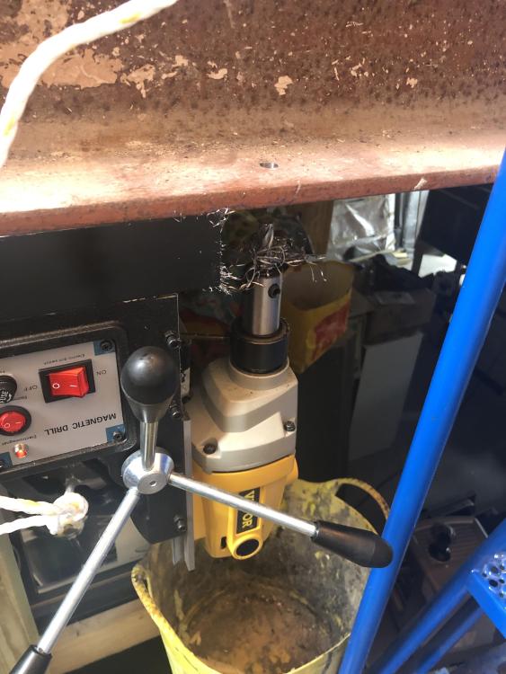

SimonD Posted March 2, 2022 Share Posted March 2, 2022 Or use a mag drill on the steels where you've got access. 1 Link to comment Share on other sites More sharing options...
Eric Posted March 2, 2022 Share Posted March 2, 2022 Not an expert but is that the correct screws for steel that thick? As above a mag drill will be your friend here. Have seen fixings fired into steel beams through wood with Hilti or equivalent. 1 Link to comment Share on other sites More sharing options...
Pocster Posted March 2, 2022 Author Share Posted March 2, 2022 13 minutes ago, SimonD said: Or use a mag drill on the steels where you've got access. Oooooooooo ! A new toy ! ( that’s unlikely to harm me ) . I’ll try that YouTube suggestion first . Probably got maybe 20 holes to do .. Link to comment Share on other sites More sharing options...

SimonD Posted March 2, 2022 Share Posted March 2, 2022 33 minutes ago, pocster said: Oooooooooo ! A new toy ! I just had to buy one. Surprisingly satisfying to use. 35 minutes ago, pocster said: that’s unlikely to harm me Well... unless you accidentally turn the mag off and it drops on your head. It has been known to happen ? There's a strap you're supposed to wrap around the steel to stop this happening... 1 Link to comment Share on other sites More sharing options...
markc Posted March 2, 2022 Share Posted March 2, 2022 3 minutes ago, SimonD said: I just had to buy one. Surprisingly satisfying to use. Well... unless you accidentally turn the mag off and it drops on your head. It has been known to happen ? There's a strap you're supposed to wrap around the steel to stop this happening... Or drilling the underside of a portal frame and some D&@k on the floor turns the generator off ! ? 1 3 Link to comment Share on other sites More sharing options...
