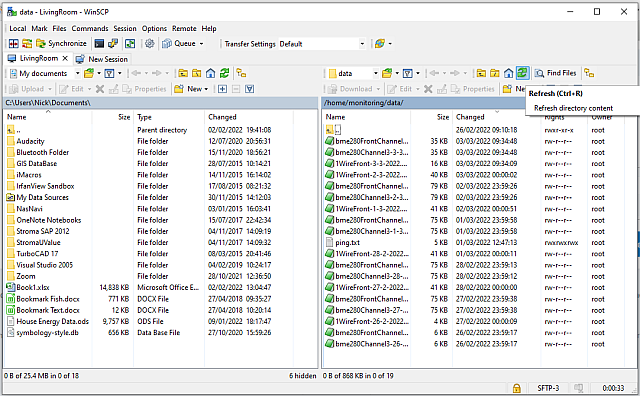

SteamyTea Posted March 1, 2022 Posted March 1, 2022 I have 3 RPi Zero W. Two happily connect, and stay connected to the wireless network, but one just keeps dropping out. The only way I can restart the WiFi is to reboot. This seems to be a known problem, but no definitive solution. I have tried a batch file that pings one of the good RPi's address, but it drops out. Tried a crontab command to stop and restart the wifi, if it has already dropped out, it don't reconnect. Even put a line it to stop the power management turning off WiFi. I have also tried most of the solutions online, and like most of the people that comment, it does not solve the problem. So it may be a hardware problem and just getting a few new ones may solve it, but was hoping someone with a lot more networking experience knows the answer.

SteamyTea Posted March 2, 2022 Author Posted March 2, 2022 8 hours ago, MJNewton said: Are there any clues reported in /var/log/syslog, /var/log/messages or /var/log/kern.log? Possibly, but there are so many words in them, I would need to print them out. 8 hours ago, Radian said: I think that the instabilities are arising from dynamic changes in clock speed Giving it a go now, it usually drops off the network within half an hour.
SteamyTea Posted March 2, 2022 Author Posted March 2, 2022 @Radian and @ProDave And anyone else that has had this problem. So far it has been stable. Just got to find the loose wire to the sensors now (but that is one the RPi that was stable). 1
ProDave Posted March 2, 2022 Posted March 2, 2022 1 hour ago, SteamyTea said: @Radian and @ProDave And anyone else that has had this problem. So far it has been stable. Just got to find the loose wire to the sensors now (but that is one the RPi that was stable). Mine usually works for a few hours before losing connection. If it lasts to the end of today then I will remove the "morning re boot" timer and see how long it holds up.
SteamyTea Posted March 2, 2022 Author Posted March 2, 2022 (edited) 17 minutes ago, ProDave said: Mine usually works for a few hours before losing connection. If it lasts to the end of today then I will remove the "morning re boot" timer and see how long it holds up. Mine is still going, 2 hours now. It was still logging the data OK, just the WiFi was dropping out. I made the same changes to the other logger I have, the one with the wobbly wire (though I could not see a problem and it was working fine before I moved it), and that seems to be logging OK now. Logging started at 02/03/2022 07:11:22, and now it is 02/03/2022 08:51:03. Purely for scientific interest, my wall probe has shown a rise in temperature from 9.9°C to 10.1°C, and the OAT is 9.5°C and 9.7°C. So the wall temp seems to be tracking the OAT temp nicely (a good thing). Off for a hunt for diesel now, I may be some time. Edited March 2, 2022 by SteamyTea

SteamyTea Posted March 2, 2022 Author Posted March 2, 2022 (edited) So 6 hours on, and still fine. When it stops raining, I shall fit the other logger to the front of the house. Edited March 2, 2022 by SteamyTea
SteamyTea Posted March 2, 2022 Author Posted March 2, 2022 I have fitted the unit now, but have just tried to remotely log in, after an hour of it being in place, and it has not done it. A proper reboot (pulling the plug) has allowed me to connect, and the data was still being collected. Shall look at it later as there will be nothing else to do tonight.
SteamyTea Posted March 3, 2022 Author Posted March 3, 2022 Well I managed to log in this morning no problems, so maybe just a glitch. If it happens again, I shall up the voltage 1 unit (0.025V). I am not hoping to get some weather to see what is happening, though this is a long term project.
