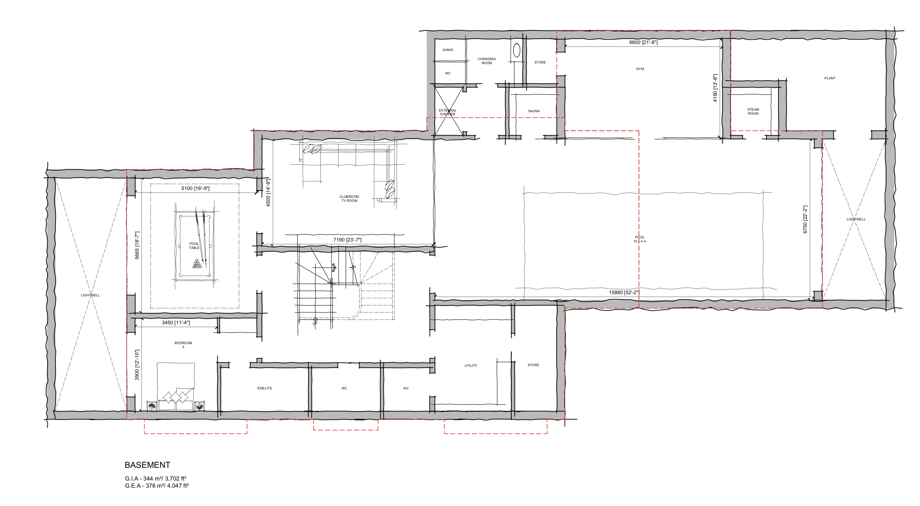

Would really appreciate any advice on building a big basement with indoor pool (400sqm, 3m high ceilings, 10m*4m pool)
The swimming pool would have 1m below ground and 50cm above ground level
Early considerations include:
  • the plot is a 1.1acre and luckily there are no considerations of neighbouring boundaries etc
  • access is good
Ground investigations have been completed for my house, and the house next door, they show the same thing more or less, these can be uploaded as requested
Without going into loads of detail, summary:
  • Windlesham formation units: silty glauconitic sand to around 4.5m, then clay
  • Encountered water around 2-2.5mbgl in areas (not everywhere)
On the basis of the above
  • shoring recommended, perhaps sheet piling needed (ground collapses around the dig quite fast in areas)
  • dewatering needed (it looks like there is perched water around 2-2.5mbgl)
We (the groundworks team and my appointed SE) have concluded so far that:
We dig out 1.5mbgl - this area would be stable.  Then dewater and pile below this (keeps piling cost down).
We need to get to around 4.5-5.5mbgl for the basement (to include services etc and headlight approx 3m and 1m for the pool)
Main areas of advice please to relate to potential costs of:
  1. Potential Piling needed
  2. Basement construction
Also any recommendations of contractors around the Windlesham, Surrey area?
I have received a quote from Glatharr prefabricated basements at around £500K (10 week build time)
Other traditional builds are running at around £400K-£1mill! (4-6months build time)
Prices include waterproofing and 10 year warranties etc
Everyone so far has recommended against ICF, although the nudura rep seems to think its totally possible :/
I think I want to go with the germans - because:
  • They are German
  • This is specialised work
  • Basements leak in our area :(
  • The house on top will only be as good as the basement below etc
  • Much quicker build and I want to get on with the rest of the house
BUT Is £500K a crazy price?
Many thanks in advance for any help/advice

Did your quotes include for excavation and piling if so I'd say 500k was very cheap.
If you going sheetpile route, you will want to lower the ground to withing 3 to 3.5 meters in order to allow the sheets to work in cantilever to avoid any bracing which adds big moneys as not only is there the hire and install but it can affect the excavation sequence along with the construction sequence.

Was hoping 6m sheets will work, 3m in, 3m out
Any idea how much this will cost?

You might struggle with 3 in and 3 out, it'll depends on the calcs on the ground, you may be pushed to 3.5m or 4m in for 3m in cantilever.
Sorry I am too long gone out of the UK to be able to give any idea on the price now, however make sure you look at the time frame and ask for a price to buy the sheets along with hire them as if they are going to be in a while it may work out cheaper and most companies will offer you a buyback price too especially the way steel is at the minute.
Also especially if go the hire route make sure your SE designs your basement walls as un propped so you don't need to wait for transition slab (if you have one) to hit strength before you can backfill your walls.

ok, then I'd say it is on the expensive side! as those things not included will be quite a hefty chunk of cash.
we hired a local groundworks company who did the digging and insulation under the slab and they then subcontracted the basement build to another company who came in and put up the formwork, steel, waterproofing membrane and poured the waterproof concrete. then when they left the groundworkers built the internal walls and put on the block and beam top. it worked out a very cost effective way of doing it. you can view how we did it on our blog:

We built a 120m2 basement in Berkshire clay/gravel/chalk.
Ground conditions were good so no de-watering required, was able to just batter back sides of excavation. Went down 3.5m and ffl was about 750mm above that.
We looked at Glatthar, friends of ours building in the water near the thames used them, very happy, but they are not cheap. You're paying for pre-cast concrete panels to be shipped from Germany to UK vs pouring them in situ using concrete from a plant a few miles away from you.
We just used a local groundworker firm who did sub-surface structures like parking garages etc. They did shuttered concrete with a warrantied SIKA waterproofing system - we did not require external tanking or internal membrane. That whole package - demo & removal of existing, excavation & muck away, casting of basement, backfill and in ground services (fouls, rainwater, water & ducts for gas) came to £120k back in 2016. Glatthar wanted more than that just for the basement itself.
A basement is just an underground concrete box at the end of the day, the SE will design it and any number of firms can construct it to the required standard.
If you have good access and are not tunnelling under an existing building then that simplifies life. The dewatering will be expensive, as will the piling and shuttering though.
I'd echo Bitpipe re the need for a expensive precast solution.it may seem a "specialist " job to you but to a formwork company it's a pretty simple job.
 But I'd say if you have to sheetpile the whole lot (which looks North of 100meters) when you step back 1.5m for working room would come in at or above bitpipes total cost
