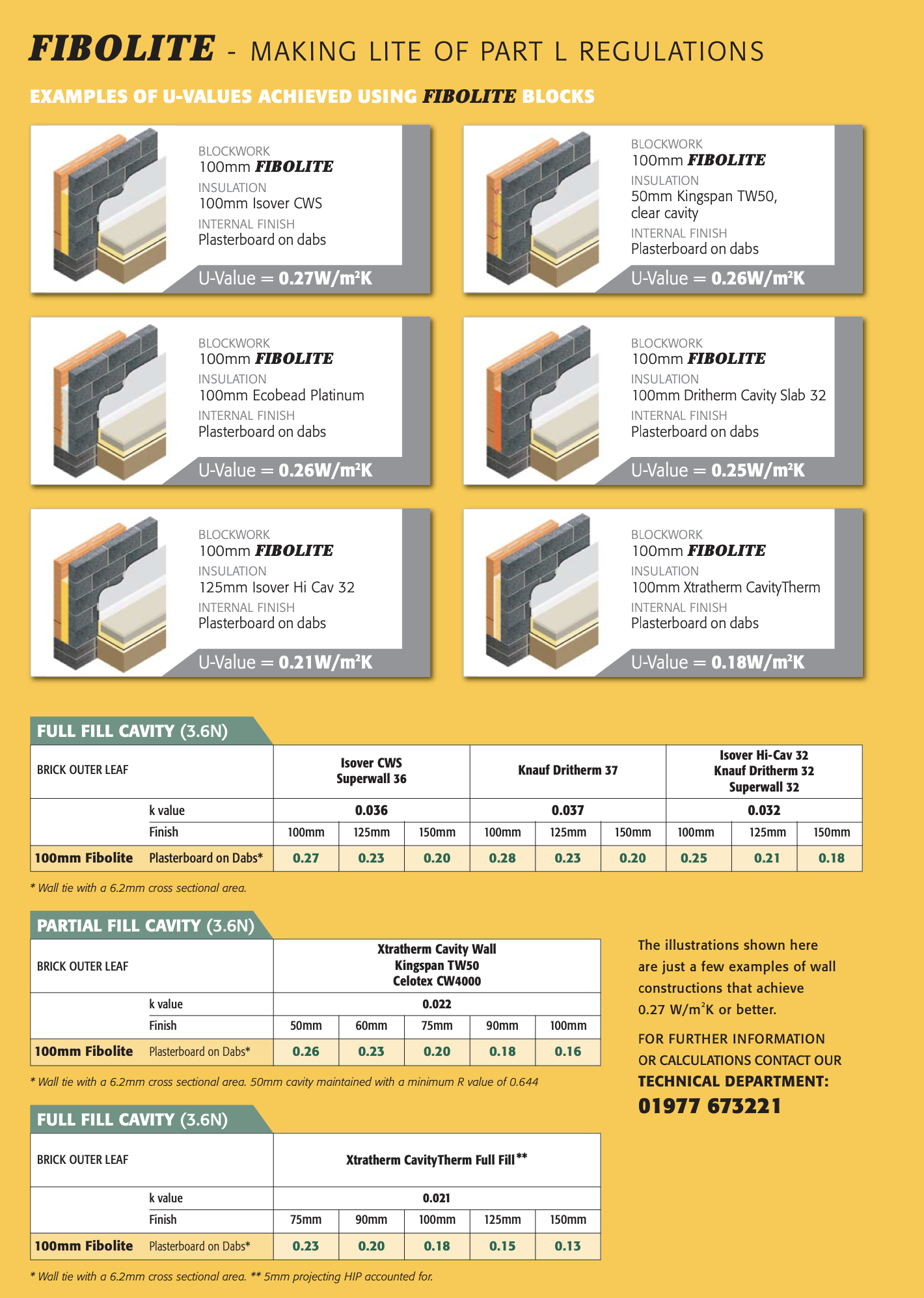

DerbyLad Posted August 20, 2020 Share Posted August 20, 2020 Thank you every one for your input, it's great to read so many suggestions. I would, if possible, prefer not to change the construction. The drawings have been passed by building control and I've had the structural calcs done. I would assume I would have to have these all done again if I went for 150mm wall insulation!? If needs must then I well. Just feel like I'm going backwards with every step forward at the moment Ok, Information taken from the building reg drawings The roof has 100mm mineral wool laid between joists with 2 layers of 150mm laid over The walls are 100mm Knauf Dritherm 32 Inner walls are 100mm plasmor fibolite 3.6n block Flooring is 150mm Kingspan or similar grade insulation I did wonder if the wall insulation could be a material with a lower u value - better insulation- which would help? Or perhaps insulated plasterboard as has been suggested. My rooms are quite generous so could stand it. Link to comment Share on other sites More sharing options...

PeterW Posted August 20, 2020 Share Posted August 20, 2020 1 hour ago, DerbyLad said: The walls are 100mm Knauf Dritherm 32 Inner walls are 100mm plasmor fibolite 3.6n block That is your SAP issue - that’s barely inside regs. Wall is 0.27 based on that build up, limiting factor is 0.30. You can get to 0.18 just by using a 50mm additional cavity which is far more cost effective than adding insulated plasterboard. Reducing the cavity really doesn’t affect all of your structural calcs as 100mm is negligible in terms of spans etc. Lintels are £5-10 more expensive for the wider cavity so that adds nothing. I would speak to Building Control and ask their advice if they want it completely redrawn - standard founds can cope with a 50mm variation as can most other structural elements. Floors and roof components should always be as built measurements anyway as you will find the brickies will adjust your layouts to meet the standard block and brick sizings so they aren’t cutting slips to make sizes work. Link to comment Share on other sites More sharing options...
AliG Posted August 20, 2020 Share Posted August 20, 2020 @PeterW is correct. A wider cavity is probably the cheapest solution, if you used 37.5mm insulated plasterboard on the inside you would also get the U-Value down to 0.2 or thereabouts. This is simple if you already plan to use plasterboard but more expensive. I don't know why most houses in England still seem to be built this way, it would fail the minimum regs in Scotland Link to comment Share on other sites More sharing options...

DerbyLad Posted August 22, 2020 Share Posted August 22, 2020 Still looking at options to insulate the 100mm gap. Is dritherm 32 the best to use or are there any better products with higher r values? Link to comment Share on other sites More sharing options...
joe90 Posted August 22, 2020 Share Posted August 22, 2020 dritherm is not the best for 100mm, I would consider blown in poly beads. Link to comment Share on other sites More sharing options...
PeterW Posted August 22, 2020 Share Posted August 22, 2020 Beads don’t do much better - seriously change the cavity now whilst you can. Link to comment Share on other sites More sharing options...
AliG Posted August 22, 2020 Share Posted August 22, 2020 I found this on the Plasmor website - A couple of things - 1. It looks like your build up has a U-Value of 0.25, I would check the SAP calculation has this data and not generic data. 2. You can get that down to 0.18 using Xtratherm CavityTherm but it costs £26ish a square metre compared to about £6 for the Dritherm. The uplift for using insulated plasterboard would be more like £8 a square metre compared to £20 here. 1 Link to comment Share on other sites More sharing options...

DerbyLad Posted September 1, 2020 Share Posted September 1, 2020 Hi All, Had a thermal mass calculation done, changed the roof lantern to 1.2 u-value, increased loft insulation to 500mm and I now pass the SAP with a gas boiler! Yes, door D3 has an assumed u-value. It's a fire door. Getting an insulated fire door is quite tricky. Link to comment Share on other sites More sharing options...
