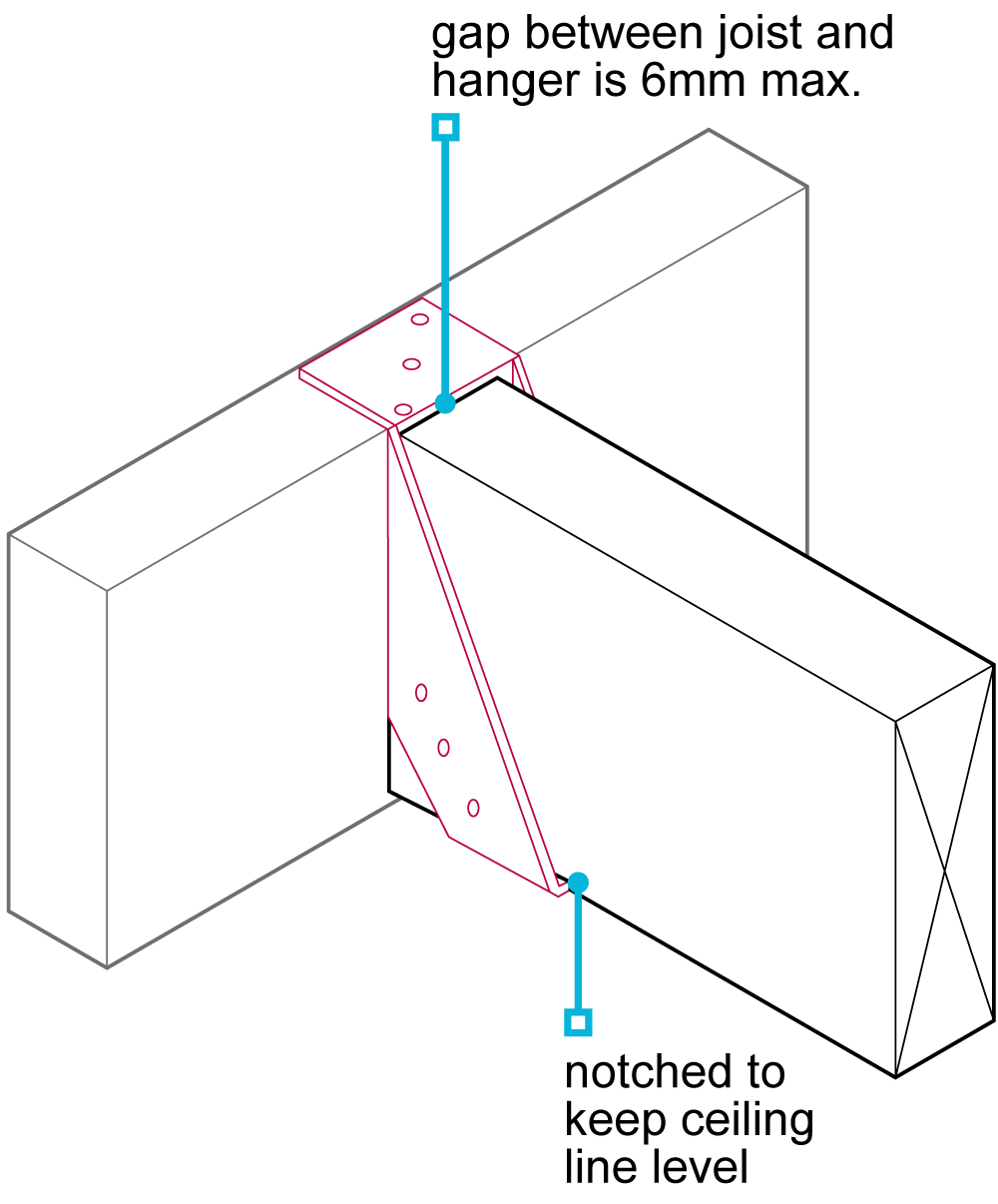

Moonshine Posted February 16, 2022 Share Posted February 16, 2022 (edited) I am about to fit joists into built in wall hangers. If my brickies have got the levels out is there anything I can use at a shim to jack the joist up a bit to get it level? I am thinking something like these Edited February 16, 2022 by Moonshine Link to comment Share on other sites More sharing options...

nod Posted February 16, 2022 Share Posted February 16, 2022 The joists will have to sit tight in the hangers Definitely don’t pack The blocks should be pretty neat if they are building hangers into the Link to comment Share on other sites More sharing options...
Temp Posted February 16, 2022 Share Posted February 16, 2022 (edited) I believe you can notch the bottom of the joist so start with the lowest hanger.. or is this only to stop the hanger making the plasterboard dip at the edges? https://nhbc-standards.co.uk/6-superstructure-excluding-roofs/6-4-timber-and-concrete-upper-floors/6-4-13-joists-into-hangers/ Edited February 16, 2022 by Temp Link to comment Share on other sites More sharing options...
redtop Posted February 16, 2022 Share Posted February 16, 2022 I had to pack some and just used plastic packers. Given the amount timber expands and shrinks i cant see a problem and it passed BC checks Link to comment Share on other sites More sharing options...
markc Posted February 16, 2022 Share Posted February 16, 2022 You shouldn’t shim but it often happens. If these are not ground floor then packing puts the tops level but makes boarding the underside a real P.I.T.A. Link to comment Share on other sites More sharing options...
redtop Posted February 16, 2022 Share Posted February 16, 2022 Just now, markc said: You shouldn’t shim but it often happens. If these are not ground floor then packing puts the tops level but makes boarding the underside a real P.I.T.A. I had to after we kicked Builders off site and took it on myself. I had to get tops level. Used plastic packers and nail through bottom hole to keep em in 1 Link to comment Share on other sites More sharing options...

FrankHouse Posted May 9, 2022 Share Posted May 9, 2022 I know this is probably sorted but my bc rejected the brick and slate packers that had been put in as he said the can crumble and we needed to use metal or timber shims. May just be his opinion but what they say goes! Link to comment Share on other sites More sharing options...
