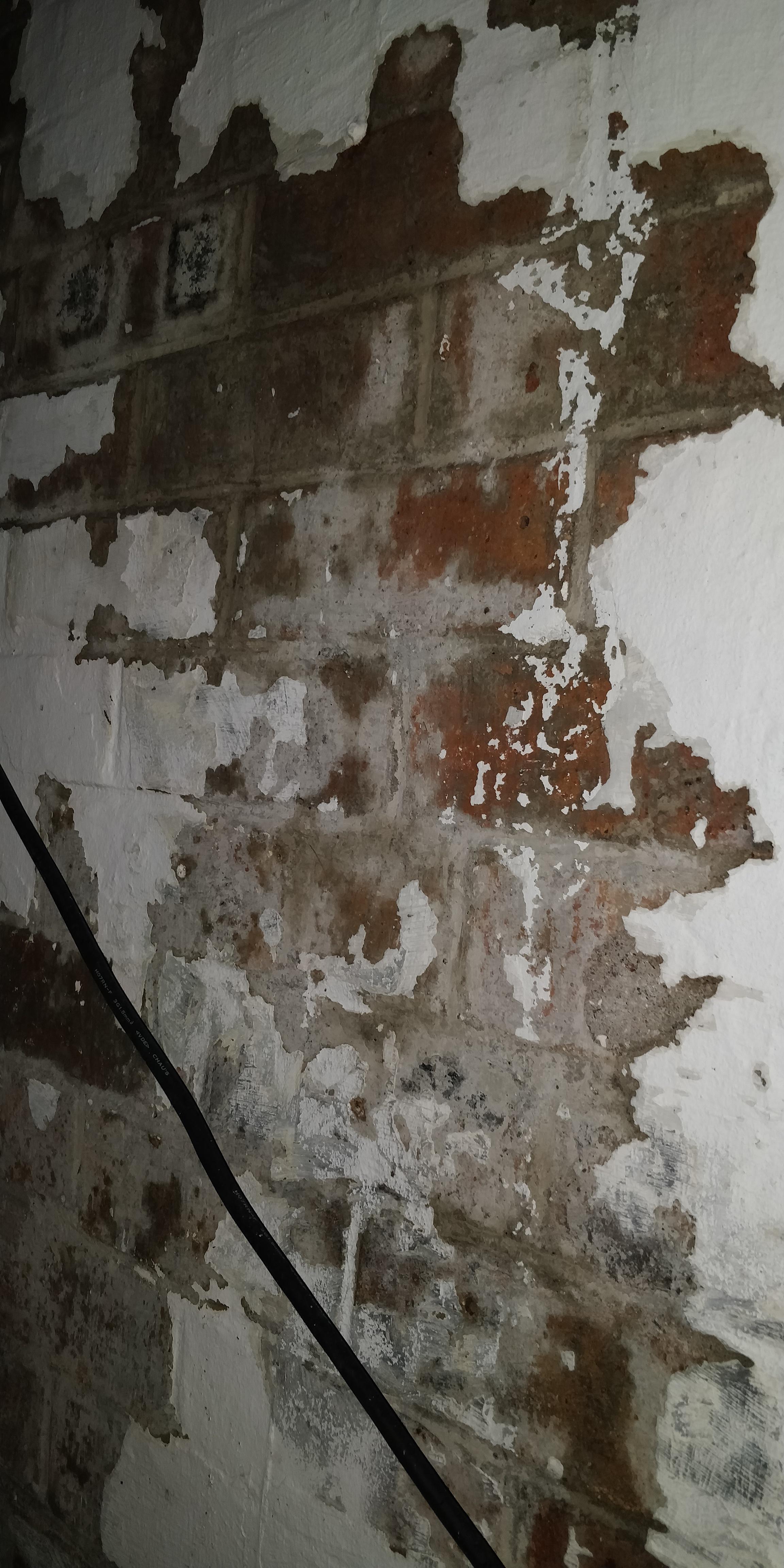

bighouseproblems Posted February 16, 2022 Author Share Posted February 16, 2022 Outside wall after a massive amount of rainfall and driving rain today. My hope is it will still dry out and I can monitor it once the insulation is installed. Link to comment Share on other sites More sharing options...
SteamyTea Posted February 16, 2022 Share Posted February 16, 2022 49 minutes ago, bighouseproblems said: Outside wall after a massive amount of rainfall and driving rain today No amount of lime is going to help there. 1 Link to comment Share on other sites More sharing options...
bighouseproblems Posted February 16, 2022 Author Share Posted February 16, 2022 4 minutes ago, SteamyTea said: No amount of lime is going to help there. Can you see a problem I cannot? The wall has dried out almost immediately it was all soaking wet only a few hours earlier? Link to comment Share on other sites More sharing options...
Adsibob Posted February 16, 2022 Share Posted February 16, 2022 Knock the house down and start again. That’s what I often wish I had done with my 1930s semi… 3 Link to comment Share on other sites More sharing options...
SteamyTea Posted February 16, 2022 Share Posted February 16, 2022 49 minutes ago, bighouseproblems said: Can you see a problem I cannot? You got to stop the water getting though, not just thinking that a lime finish will let it dry out faster. Do you have a gutter/downpipe leaking onto it? 25 minutes ago, Adsibob said: Knock the house down and start again. With your builder, there is still time. 2 Link to comment Share on other sites More sharing options...
bighouseproblems Posted February 16, 2022 Author Share Posted February 16, 2022 6 minutes ago, SteamyTea said: You got to stop the water getting though, not just thinking that a lime finish will let it dry out faster. Do you have a gutter/downpipe leaking onto it? With your builder, there is still time. I don't think a lime finish will help anything to be fair. That is an external wall which was covered in some paint which I have started to remove. Plan is remove it back to bare brick and see how it goes. Guttering is ok but was put up quickly when we moved in. Eventually the roof will get completely redone. That's if I don't knock it down before like Bob suggests ha. But all jokes aside I am happy with the building as it stands I have belief it will perform fine once we start upping the insulation inside but you never know. Link to comment Share on other sites More sharing options...
