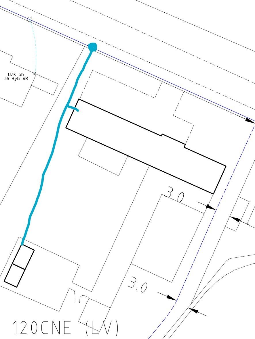

thefoxesmaltings Posted February 11, 2022 Share Posted February 11, 2022 Anglian water have been paid to create the new connection from boundary and so we just need to carry out the works on our land to make the new connection. Been quoted £2100 fully inclusive of parts and labour from a plumber, for the following work: Install 45 metres of supply with 3 capped off tails for dwelling, outbuildings and for the new connection being carried out by Anglian water. A certificate of compliance is also issued as per water regs 1999 and local water authority specifications. Naturally, waiting for a few other quotes to come back, but does this sound reasonable? Link to comment Share on other sites More sharing options...

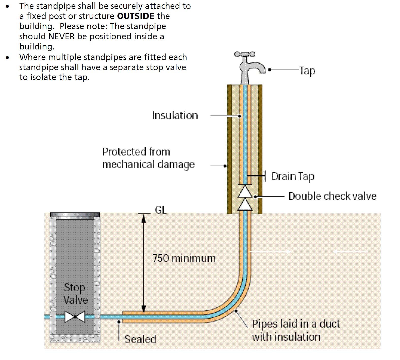

thefoxesmaltings Posted February 11, 2022 Author Share Posted February 11, 2022 14 minutes ago, Bonner said: About £300 materials, two men and mini digger for a day. Should be nearer to £1000! Get Anglian to connect temporary building supply to a standpipe, then run supplies to buildings with other works. That's what we're trying to do - get a temporary building supply set up. Anglian water want us to get this set up on our land first before they make the water connection. Does that sound right and how much should we expect to pay for that? Link to comment Share on other sites More sharing options...
Simplysimon Posted February 11, 2022 Share Posted February 11, 2022 do as they ask, put a post in on the boudary with pipe and double check valve. they can then only inspect that. we put in all ext pipe work and they wanted to inspect all that before they would make a connection. i stated that if i had put a standpipe in they could inspect that i could do whatever i wanted afterwards, they agreed but stated that as i had put the pipe in prior to connection they would need to inspect that as well. Link to comment Share on other sites More sharing options...
Bonner Posted February 11, 2022 Share Posted February 11, 2022 28 minutes ago, thefoxesmaltings said: That's what we're trying to do - get a temporary building supply set up. Anglian water want us to get this set up on our land first before they make the water connection. Does that sound right and how much should we expect to pay for that? I did it myself, exactly according to the drawing (about £80 materials). Biggest job was digging a short trench under the hedge by hand! I did it myself because I couldn’t find someone to do such a small job. 1 Link to comment Share on other sites More sharing options...
