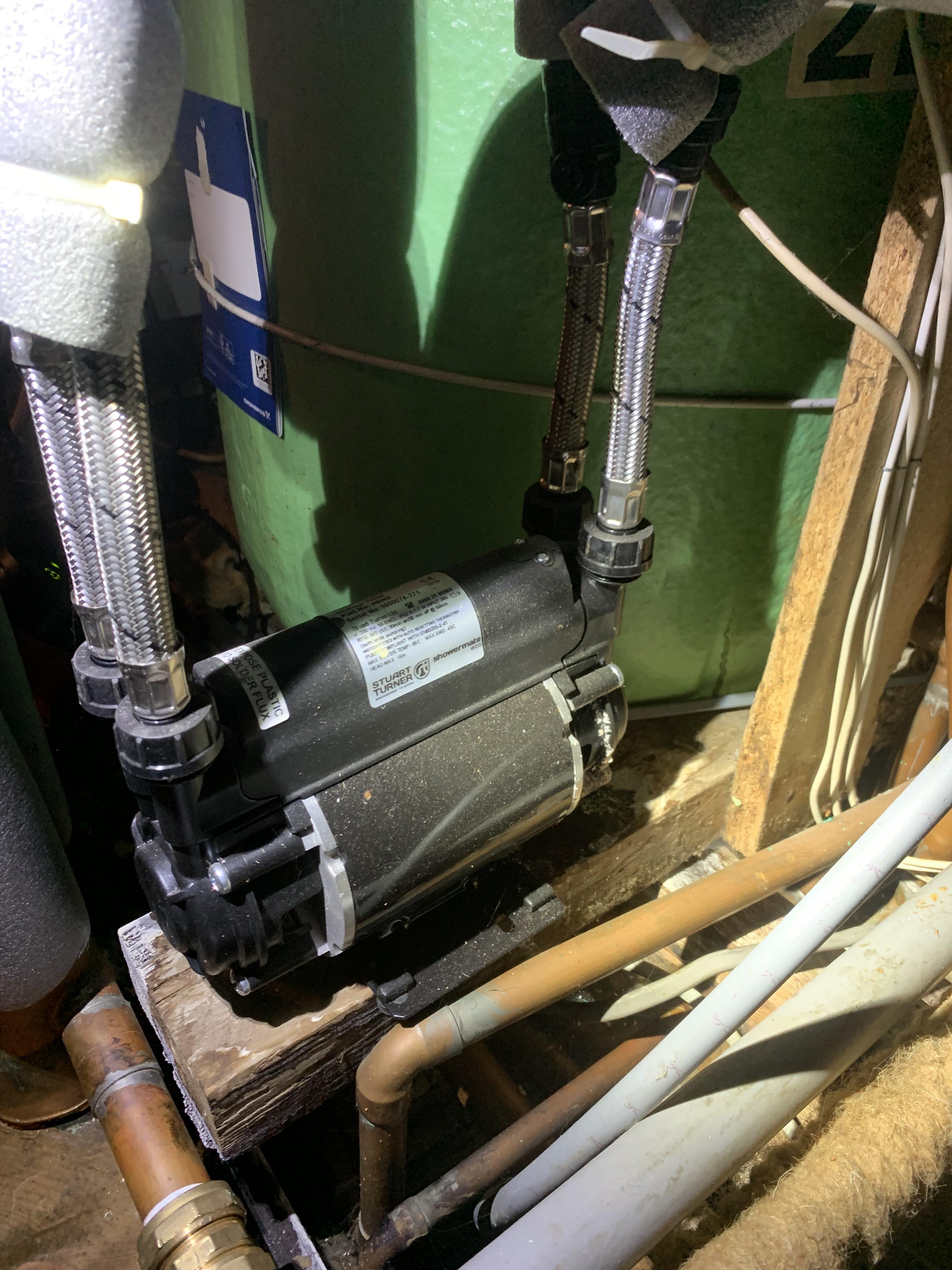

James94 Posted February 11, 2022 Posted February 11, 2022 The grandparents have this pump in the loft and it’s leaking, it’s been in about to three years now and not under warranty. They have had the people who originally fitted the pump and they say that this pump is now obsolete it there are alternatives. She spoke to them today and they have told her mid March and will cost £193.( I’ve seen a few on Screwfix 1.5 bar) Would it be easy enough to replace myself? At the moment I have tuned both inlet isolators and switched it off at the spur. I think they have an vented system and this pump feeds hot and cold supply to a single bathroom . Regards. James
Radian Posted February 11, 2022 Posted February 11, 2022 Those things often leak at the motor shaft seals. Almost guaranteed. I was replacing mine every 5 years on average until I fitted a Stuart Turner pump (about 6 years ago ?) so hard to recommend. Easy enough if the tails end up in roughly the same place. What I would strongly advise is placing the new one in a suitably deep tray (I used a plastic cheese biscuit box) and putting a leak detector alarm in with it. Don't just put it in a tray without the alarm - otherwise it will fill up until the electrics trip!
ProDave Posted February 11, 2022 Posted February 11, 2022 Where is it leaking? A replacement does not need to be identical so the fact it is obsolete now does not matter.
Mr Punter Posted February 11, 2022 Posted February 11, 2022 11 minutes ago, Radian said: I was replacing mine every 5 years on average until I fitted a Stuart Turner pump That is the brand in the picture. 1
James94 Posted February 12, 2022 Author Posted February 12, 2022 Thanks for the replies, it’s leaking from the seal, was just a little worried about buying a replacement and it not fitting. they still do Stuart turner pumps but there are so many to choose from and I’d hate to help them out and get it wrong. I like the idea of putting it in something to catch any leaks with a leak alarm. Would this be a retro fit or do they come built in ? Regards. James

Pocster Posted February 12, 2022 Posted February 12, 2022 Things like this I stick in a tray and if possible runs straight solid pipe out the property or down into a shower tray . Then you’ll see if it’s leaking rather than rely on an alarm ( which may fail ) . This ‘method ‘ avoided a messy leak once as tenant informed me water was coming out the pipe into the shower tray .
SteamyTea Posted February 12, 2022 Posted February 12, 2022 (edited) Looks similar to this one: https://www.screwfix.com/p/stuart-turner-showermate-standard-regenerative-twin-shower-pump-1-5bar/543pg Screwfix would probably let you take it back if it was the wrong size. I fitted the cheapest one from Screwfix in 2008 I think, it has run faultlessly. Pumps my shower and bath a treat. Pipework needs lagging, your inheritance is being lost. Edited February 12, 2022 by SteamyTea
James94 Posted February 12, 2022 Author Posted February 12, 2022 Have been looking at this one and yeah hope it will fit but if any issues hopefully they would take it back, there not usually to bad. I’ll see them tomorrow and ask for some money to get it. regards. James And pipes not lagged I’m not even going to go there, loft is a maze with pipes and wasps, so I only go in there if a have to.
