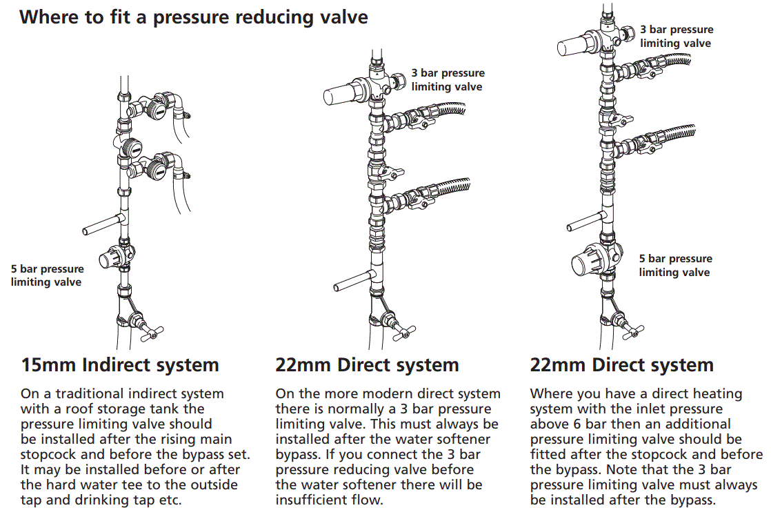

Be careful to note your unit's installation details.
I didn't check ours until long after the plumber had left, and his team didn't follow the instructions.
If you have high incoming water pressure, then the trick is to put a first PRV before the softener to bring the pressure below the softener's maximum operating pressure, and then a further one after it to bring the pressure down to what the house is designed to operate at.
For example, we have nearly 6 bar incoming. We should have a ~5 bar (6 bar being the max the softener runs at) PRV on the incoming main, and then a 3 bar PRV after the softener.
Even if your pressure isn't that high, you should still put the main PRV after the softener, not before.
Here's the picture from the manual:
Unfortunately, we have only a 2(!) bar PRV on the incoming before the softener, which does leave us with sub-optimal water pressure if there's a shower on, the washing machine is refilling, and the water softener decides to regenerate at the same time.
When I asked why they installed such a low bar PRV, I was told that they wanted to make sure the water pressure didn't look too powerful if the building control guy turned the taps on!
  • Like 1

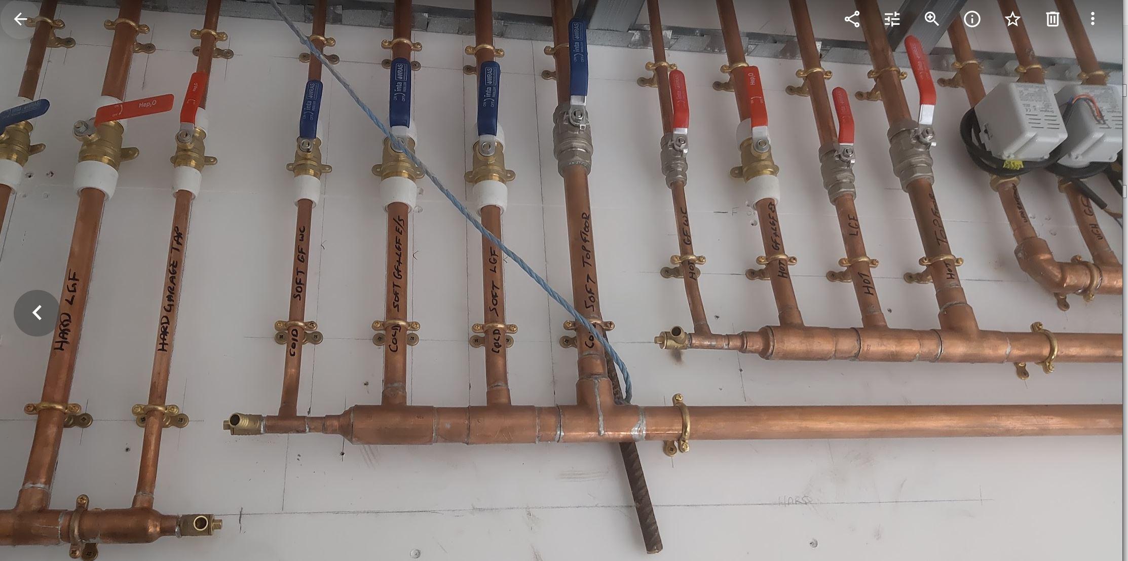

From the street meter it's about 25m to the plant room - gentle curve in the pipe downhill where we end up with 3bar static pressure
Good idea now to do the flow rate test and I guess we could easily enough do a dynamic pressure test as well - plumber is back in tomorrow.
I saw on the GreatWater website that they claim 31 l/min at 1bar on the 1400 model and 45l/min at 1 bar on the 2300 model - see what pricing is like for them, looks like electric operated so can get recharge outside of normal shower times.
@jack thanks for that - yes that sucks. As we have 3 bar and the softener we're looking at (probably like others) is OK with 5bar incoming I'll see what the plumber says- either no PRV or just a 3bar one after the softener. Actually having said that we have our hard water supplies of course before that so may be useful to have a PRV on the incoming or on the hard water manifold.
The plumber enjoyed making my manifolds - he didn't like my Hep2O idea in the plant room and wanted it to look sharper - above ceiling level copper transitions to plastic so we can have nice ceiling cut-outs around the straight pipes.
What is the advantage in doing this? I'm not trying to be facetious here - but based on my understanding, having 2 PRV's like this is pretty pointless, and in fact detrimental because the pressure drop across the PRV itself is significant, so you're compounding that by having two of them.
Taking your example of 6 bar incoming (I assume this is static?) with a 5 bar PRV before the water softener. When you open outlets, the dynamic pressure will reduce as the flow rate increases, depending on pipe size. Let's say it drops to 4 bar (which would be significant at > 20 L/min, but for arguments sake). The pressure drop across your water softener takes this down to 3.5 bar. Your second PRV at 3 bar after the water softener would reduce this down to 3 bar. So you have 3 bar going to your outlets at 20 L/min.
Now let's remove your 6 bar incoming PRV and replace it with a single 3 bar PRV (remove the PRV after your softener). At 20L/min, your incoming pressure is 4 bar. The 3 bar PRV will reduce this down to 3 bar. You have a 0.5 bar loss through your water softener, but the 3 bar PRV will maintain 3 bar, because you have sufficient pressure behind it to do so. So you have 3 bar going to your outlets at 20 L/min.
The end result is the same - except you're not losing additional pressure through a second (unnecessary, highly restrictive) PRV.
Of course, the PRV itself, in either scenario, should be as large bore as possible to maintain adequate flow rates.
Yes.

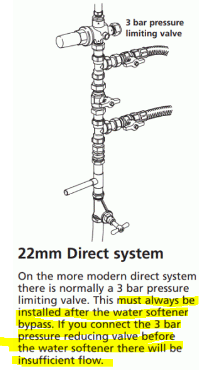

The manufacturer is pretty clear about positioning the 3 bar PRV after the softener, even if you don't have 6 bar incoming:
My understanding is that if you have a 3 bar PRV on the incoming, then it's trying to maintain a maximum of 3 bar at its output - that is, between it and whatever restriction is downstream of it.
In the scenario you set out above, the 3 bar provided by the PRV will be reduced at the softener's output, rather than maintained as you suggest. Assuming a nominal 0.5 bar loss through the softener, then the most you'll get at its output is 2.5 bar.
My understanding could well be wrong though.
The PRV will try and maintain 3 bar regardless. The pressure at any given point in the system with water flowing through it (notwithstanding pressure loss due to change in height), should be the same. So in your example, if there is 0.5 bar pressure loss due to the softener, but the incoming mains can provide 3.5 bar, then the PRV will open to maintain 3 bar downstream of it.
It is odd, though, that the manufacturer instructions say otherwise.
