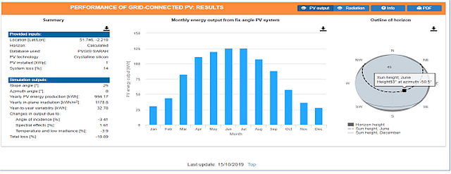

SteamyTea Posted February 4, 2022 Posted February 4, 2022 (edited) Have you run it through PVGIS to see how it compares to putting modules flat on the roof? You may be better off with an East West fence with modules on either side. Edited February 4, 2022 by SteamyTea

Stones Posted February 5, 2022 Posted February 5, 2022 20 hours ago, ProDave said: @Stones fitted some vertically at the same time as I did my ground mount system. Perhaps he will come along and say how they are doing. They have performed as PVGIS suggested, lower output compared to mounting on the roof, but reasonable none the less. The array I have produces circa 20% less compared to being roof mounted at 45 degree pitch. Mine are fixed to the garage wall so no issues with wind (which can get quite brisk here!) 1

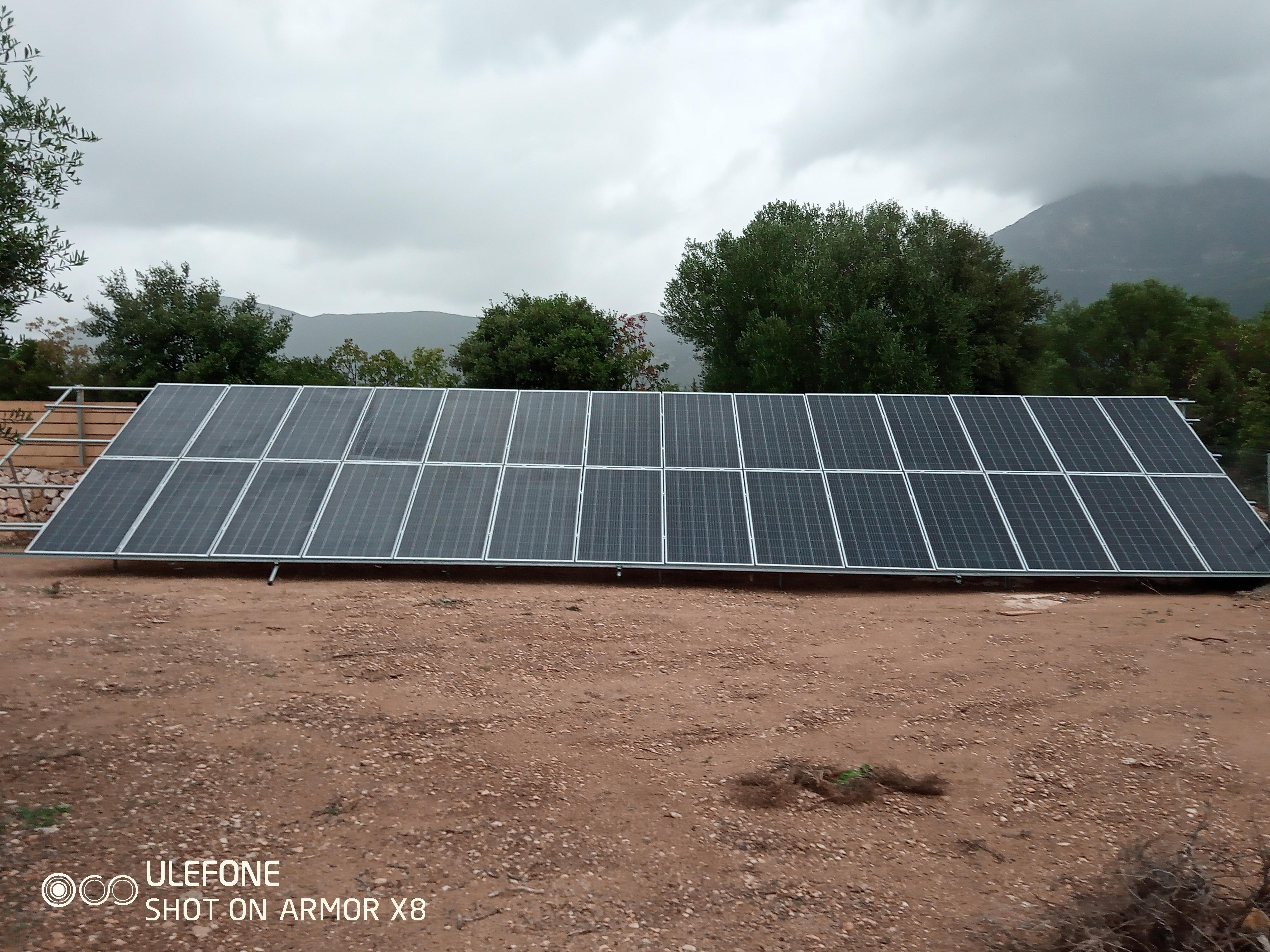

gramos Posted February 6, 2022 Posted February 6, 2022 I used a wall and put a fence on top which gave the perfect angle to mount the panels . Locally @ 37 degrees 1
DamonHD Posted February 7, 2022 Posted February 7, 2022 That's good for maximising summer (and overall) generation in the UK with south-facing panels. If you want to have the least short-fall / best putput in winter then the optimum angle is much nearer vertical as described above for south facing, or likely much nearer horizontal if facing other than fairly south. Rgds Damon
gravelrash Posted February 10, 2022 Author Posted February 10, 2022 On 06/02/2022 at 20:41, gramos said: I used a wall and put a fence on top which gave the perfect angle to mount the panels . Locally @ 37 degrees Did you have to get planning permission?
SteamyTea Posted February 10, 2022 Posted February 10, 2022 Don't get power (kW) and energy (kWh) mixed up with changing module angles. Energy yield was good when you got paid for generation and a deemed export, but now power may be more useful, even if only for a limited time during the winter.

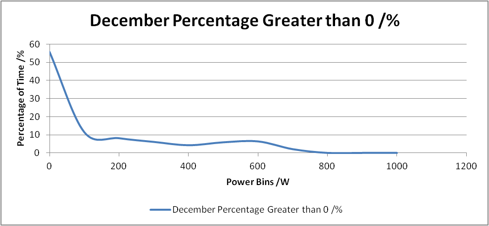

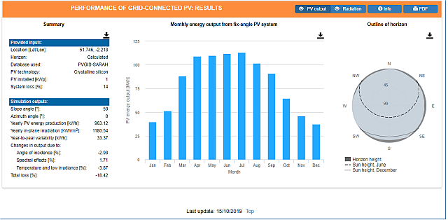

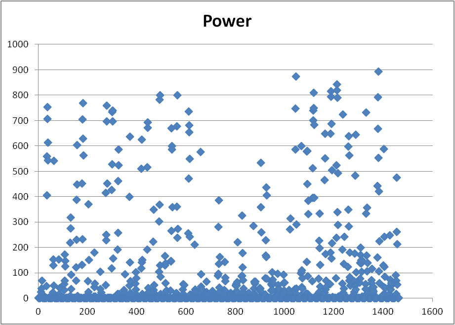

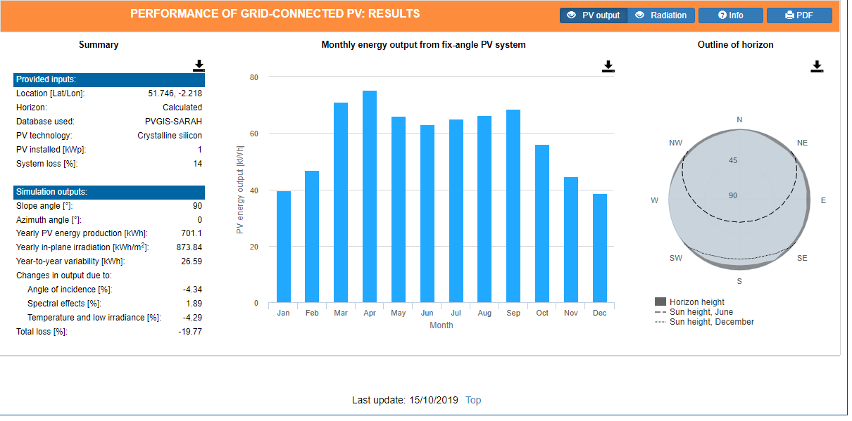

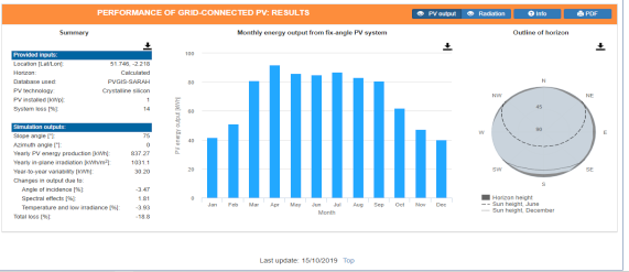

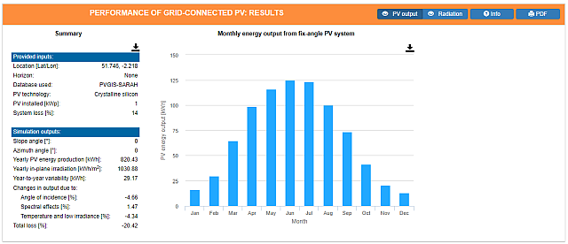

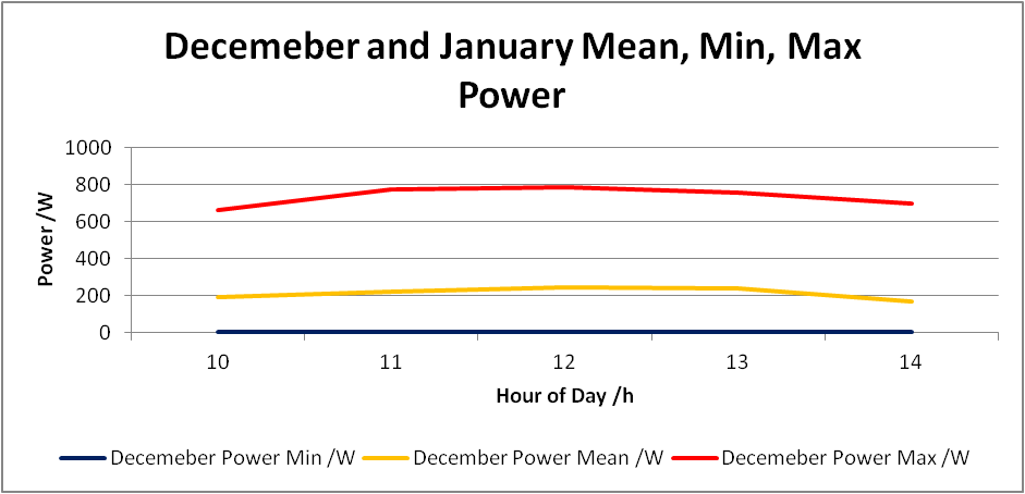

SteamyTea Posted February 10, 2022 Posted February 10, 2022 (edited) 1 hour ago, CotswoldDoItUpper said: This is interesting, how would you recommend siting the panels? I’m trying to work out (sear Stroud) what angle would be best for all year round use (4kW array, 3.6kW inverter). Assuming no shading, I would just run the angles though PVGIS and initially see which gives the best energy yield. So something like this: 00 250 500 750 900 Then decide when I need the energy most i.e. 750 gives best yield in winter. Then I would look at the hourly data for that month i.e. December. Initially the mean, min and max by hour of day. Chart title is wrong, it is just showing December data. Then the percentage frequency that those powers (W) actually happen. Then decide if I can find a use for those power levels. (I based this on Stroud and a 1 kWp grid tied system for simplicity) Edited February 10, 2022 by SteamyTea
CotswoldDoItUpper Posted February 10, 2022 Posted February 10, 2022 I guess we would look at maximum yearly usage. We have an annual use of around 20,000kWh (2 x EV) so will easily self use. I’ll have a look at PVGIS and work done things out. Didn’t realise it could do hourly data too! Does it take into account average sunny/cloudy days?
SteamyTea Posted February 11, 2022 Posted February 11, 2022 8 hours ago, CotswoldDoItUpper said: Does it take into account average sunny/cloudy days Yes.
