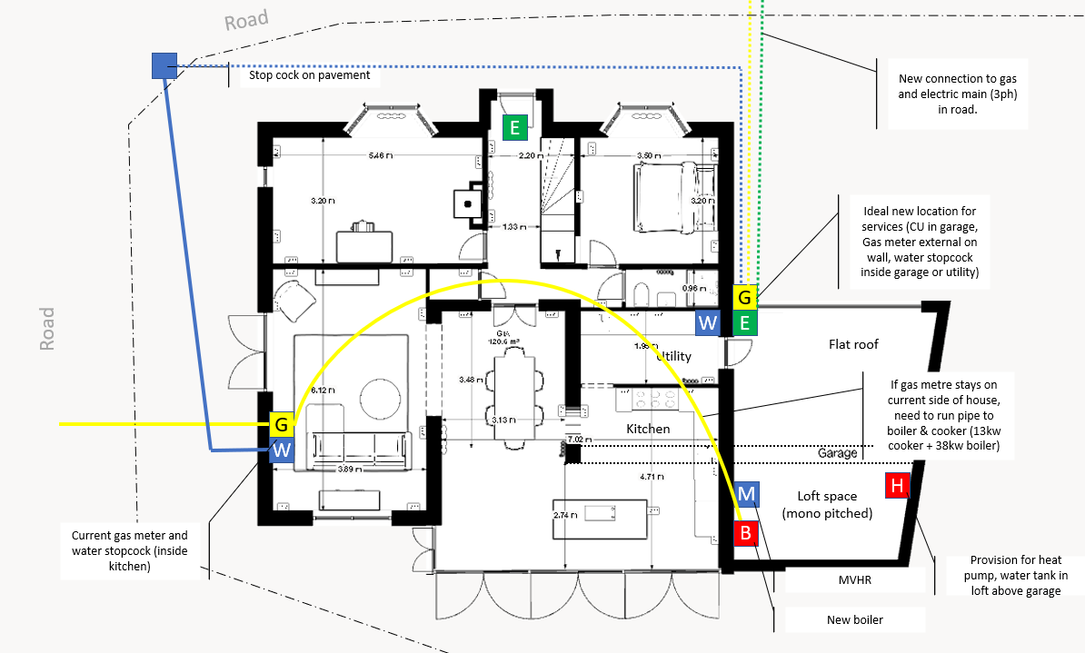

SuperPav Posted January 20, 2022 Share Posted January 20, 2022 (edited) Right, the other half and I are going round and round in circles on this to the point where any sanity has left the building... The builders are about to start the roof on the bungalow second storey, as soon as they've sheathed it, we're in digging up the old floors for insulation/screed/UFH and running 1st fix. One thing we still haven't decided on is what to do with the bl**dy heating! The property has gas, currently a meter inside on a wall that will be in the living room, so the meter has to go. The other complication is that we've bought a gas range cooker, and that is a non-negotiable with the boss, so need some form of gas for cooking. It's a 50's solid wall bungalow, new second storey will have insulated cavity walls. All floors (suspended timber and loosefill screed) dug up and UFH in liquid screed laid over ~200mm of EPS/PIR build up. The layout means the new boiler/cylinder/cooker is on the other side of the house from where the current connection is. Option 1: Keep gas for both heating and cooking - move meter to the outside of the current wall (WW Utilities will charge £750 for the privilege), run trac pipe either under the floor, or around the garden, or through the posijoists to the new boiler and cooker (which is easier??). With a 40kW combi boiler + 12.7kW cooker connection I imagine means a fairly hefty tracpipe (35mm?) as it'll be about 15-20m long. Option 2: Keep mains gas, but install 300l UVC with system boiler, to allow future switching over to ASHP. Otherwise same as above, what's the most painless way to run the gas from one side of the house to the other? Option 3: Keep gas for cooking only, install 8kW-12kW ASHP and a 300l cylinder (£7k). If we're doing this, the pipe can be much smaller, but still needs the meter relocating and trac pipe running through the house. Option 4: Cap gas off completely, install ASHP + Cylinder (£7k?), + find location on other side of house for a LPG tank, and pipe that to the cooker. Literally depending on the day of the week, we're undecided on any of the above options. I'd prefer an ASHP from a "green-ness" point of view, and we'll be upgrading the supply to 3-phase, but at the same time it seems like it'll be a significant expense + we still need to keep some form of gas for cooking. What are your thoughts? Diagram showing layout and gas run conundrum attached.. Edited January 20, 2022 by SuperPav Link to comment Share on other sites More sharing options...

SuperPav Posted January 20, 2022 Author Share Posted January 20, 2022 Thanks all, all thoughts along similar lines to ours. The downstairs walls which are remaining will be solid, but with 40mm-50mm insulated PB on the inside. It's Cotswold stone exterior in a very sensitive area, so no chance of EWI! Porch + Bays are new, as is the garage (which will be insulated timber frame), so it's not the full perimeter that is solid wall. Upstairs will have 125mm full fill of Icynene or equivalent in the walls, vaulted ceilings with 200mm wool between rafters + 40mm insulated PB under. All windows are rationel triple glazed. The few skylights we'll have are velux TG. Flat roof will be 150mm PIR warm roof. Existing boiler has long since been converted to tins of tuna or baked beans. Small PV will go on south facing slope of garage, but depending on budget this may not happen right now. I guess our biggest headache is to whether just take the plunge to ASHP now, not bother at all (combi), or get it ready for ASHP/PV (gas system+UVC) so it's an easy swap over in the future. We're leaning towards gas, but I'm still not sure how easy it will be to route a 35mm tracpipe through the fabric of the house! Link to comment Share on other sites More sharing options...

joe90 Posted January 20, 2022 Share Posted January 20, 2022 13 minutes ago, SuperPav said: I'm still not sure how easy it will be to route a 35mm tracpipe through the fabric of the house! my gas pipe for the hob had to run around the outside . Link to comment Share on other sites More sharing options...
SimonD Posted January 20, 2022 Share Posted January 20, 2022 1 hour ago, SuperPav said: With a 40kW combi boiler + 12.7kW cooker connection I imagine means a fairly hefty tracpipe (35mm?) as it'll be about 15-20m long. Why a 40kW combi? What is your mains supply, pressure and flow rate? How many bathrooms are you planning? Check all these things first as otherwise you may end up with an oversized boiler - it's worthless if you don't have the mains flow rates to use the boiler capacity. It's worth checking your heat loss calculations to make sure the boiler you've chosen can modulate CH output low enough to prevent cycling. The combination of boiler and cooker you've mentioned will require 35mm pipe but at least the installation volume will be below the commercial threshold at 20m length assuming it's a standard U6 type meter. Have you considered an induction hob instead of gas cooker? 1 Link to comment Share on other sites More sharing options...
SuperPav Posted January 20, 2022 Author Share Posted January 20, 2022 3 bathrooms. 3 showers unlikely to be used all simultaneously, but 2 certainly. Had a vaillant 938 in a previous house and that was decent enough, price difference vs a smaller was insignificant. Obviously if I go for option 2 and get a UVC instead of a combi, I'm assuming that the boiler can be downrated somewhat! To be clear, the 12.7kW is the max the cooker can draw (so presumably that's what needs to go into the sizing of the pipework) it's rated at 7kW nominal, and frankly I think the whole house would cook if all 8 burners were on full whack! The cooker can't be replaced by induction, that was one of the must-haves for the kitchen for the missus. We've had both in the past, the cooker stays How easy is it to run a 32-35mm tracpipe? never handled the stuff myself. Obviously it would be laid by the gas man, but I'd be doing all the trenching/prep, so just trying to work out the best route, whether through the house in the floor insulation, through the house via the ceiling joists, or outside the house in the garden, trying to avoid drains and other mains.... Link to comment Share on other sites More sharing options...

SuperPav Posted January 20, 2022 Author Share Posted January 20, 2022 2 hours ago, joe90 said: my gas pipe for the hob had to run around the outside . Joe, did you just end up running it in gas plastic then, rather than trac pipe if through the garden? Is there a document that shows what the restrictions are in terms of how close to structures/other services/drains/trees it can go? I recall seeing something about trench depths but not the other constraints, as we only have a small strip of a garden all around the house... Link to comment Share on other sites More sharing options...
joe90 Posted January 20, 2022 Share Posted January 20, 2022 24 minutes ago, SuperPav said: Joe, did you just end up running it in gas plastic then, Yes, yellow stuff, just ran it round the house in a Trench, sand and dig tape over the top. Local gas guy connected it up and signed it off. 1 Link to comment Share on other sites More sharing options...
JohnMo Posted January 20, 2022 Share Posted January 20, 2022 Our gas pipe runs through insulated Posi rafters and is run in Copper (22mm). New gas boiler circa £500 to £1k, make the heating system low temperature, to future proof. You may need a buffer tank. Combi or system boiler up to you. If you do use a combi, get one that take preheated water such as an Atag, then you can have a cylinder upstream of the DHW that allows to use to solar preheated water later if required. 2 Link to comment Share on other sites More sharing options...
joe90 Posted January 20, 2022 Share Posted January 20, 2022 4 minutes ago, JohnMo said: Our gas pipe runs through insulated Posi rafters and is run in Copper (22mm). Yes plastic is not allowed indoors in case of fire melting it, mine had to be converted to copper as it entered the house. Link to comment Share on other sites More sharing options...
SuperPav Posted January 20, 2022 Author Share Posted January 20, 2022 @JohnMo running it in copper through the posi's is an option. Because of the bends in the copper though, I suspect that it'll be *at least* 35mm pipe to maintain the pressure drop within regs, which starts becoming quite expensive in pipe and fittings. All the joists are exposed so labour might be cheap enough if it's something he can do in a day... When running pipe through posi's does there need to be any venting? Obviously trying to avoid venting the void between ceiling and upstairs floor for sound transmission and insulation... Link to comment Share on other sites More sharing options...
