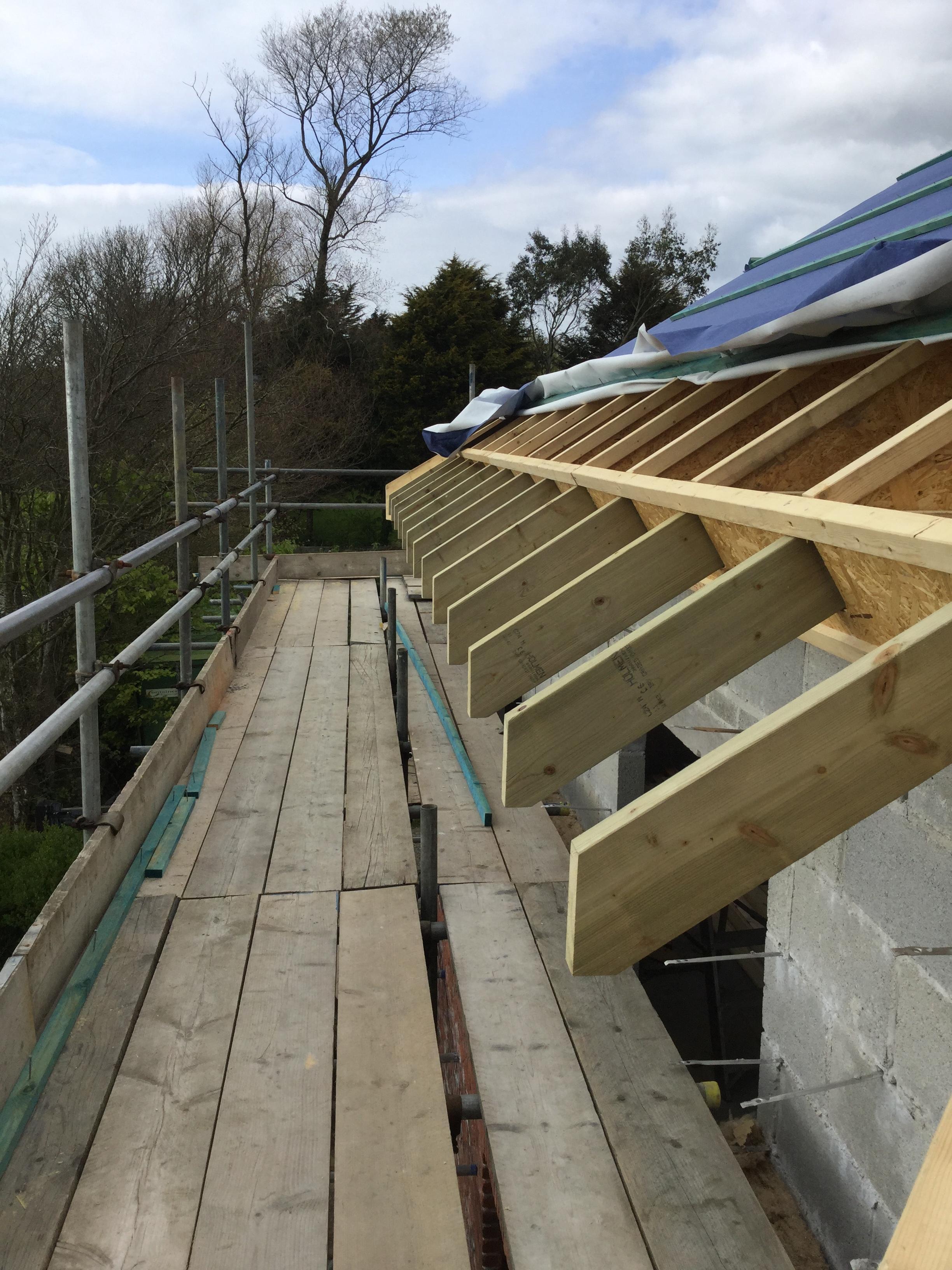

WWilts Posted January 19, 2022 Share Posted January 19, 2022 Is there a minimum height of rafter end required for fixing the fascia / gutter securely? Would 60mm do? (see pic) Objective is to get as much of an overhang as possible. Link to comment Share on other sites More sharing options...
markc Posted January 19, 2022 Share Posted January 19, 2022 (edited) Really depends on length of run to get the correct fall for gutters or you end up with an obvious taper line. Not as apparent with a deep facia. if you are wanting overhang you can extent the rafter or hang gutters on drop hangers Edited January 19, 2022 by markc 1 Link to comment Share on other sites More sharing options...
Russell griffiths Posted January 19, 2022 Share Posted January 19, 2022 You need to get a gutter bracket and roof tiles and work out if the bracket will fit on the facia, I have seen them in the past hanging off the bottom of the facia, this looks poo. 1 Link to comment Share on other sites More sharing options...
redtop Posted January 19, 2022 Share Posted January 19, 2022 8 minutes ago, markc said: Really depends on length of run to get the correct fall for gutters or you end up with an obvious taper line. Not as apparent with a deep facia. if you are wanting overhang you can extent the rafter or hang gutters on drop hangers We went with level gutters, I know ots not ideal but a bit of sitting water doesn't seem to do any harm and as the runs were over 8m having a fall would have looked rubbish 1 Link to comment Share on other sites More sharing options...
epsilonGreedy Posted January 19, 2022 Share Posted January 19, 2022 1 hour ago, WWilts said: Would 60mm do? (see pic) No. I found 120mm high fascias to be problematic. 150mm is smaller than average. You need to consider the following: The pitch and tile overhang dictates the top lip of the gutter and this will be lower than the fascia top. You need to factor in the extra height of the roof battens on top of the rafters. Some tiles/slates look better with a bit of upwards kick in the first eave course so the fascia top will be higher than that calculated for the batten allowance to support the kick.. Gutter systems have brackets have different heights and you want to make sure the bottom of a bracket does not droop below the fascia. The gutter will need a gradient so having calculated the minimum fascia height for the 4 points above, add the gradient. Finally if ground drainage requires a downpipe at a specific position then double check the wall plate is bang on level. In my case the wall plate was off 5mm the wrong way against the planned gutter gradient which caused some head scratching given my already slim 120mm fascia. A 372mm overhang is unusual but if you want that you will have to abandon the idea of resting the soffit on top of the last course of facing bricks and fit hangers that drop off the rafter tails to provide fixing points for the soffit. This assumes the masonry is complete. 1 Link to comment Share on other sites More sharing options...
bassanclan Posted January 19, 2022 Share Posted January 19, 2022 Fit your firring strips 60mm to 0mm 750mm long ontop of your rafters and you have a bit more meat 1 Link to comment Share on other sites More sharing options...
PeterW Posted January 19, 2022 Share Posted January 19, 2022 Fit 6x2 rafter tails to the existing and drop a row of bricks off to give you a decent soffit and fascia. 1 Link to comment Share on other sites More sharing options...
joe90 Posted January 19, 2022 Share Posted January 19, 2022 8 minutes ago, PeterW said: Fit 6x2 rafter tails to the existing and drop a row of bricks off to give you a decent soffit and fascia. I did similar, 6 x 2 rafter tails (bolted to my i joists) with tongue and groove above to look like an old roof structure, 150mm facia looks fine. 2 Link to comment Share on other sites More sharing options...
WWilts Posted January 22, 2022 Author Share Posted January 22, 2022 On 19/01/2022 at 22:01, PeterW said: drop a row of bricks off Only one row of bricks above lintels. Perhaps soffit at lintel level is ok for upstairs Link to comment Share on other sites More sharing options...
Russell griffiths Posted January 22, 2022 Share Posted January 22, 2022 Soffit at window head is a standard detail on a lot of single storey builds. 1 Link to comment Share on other sites More sharing options...
