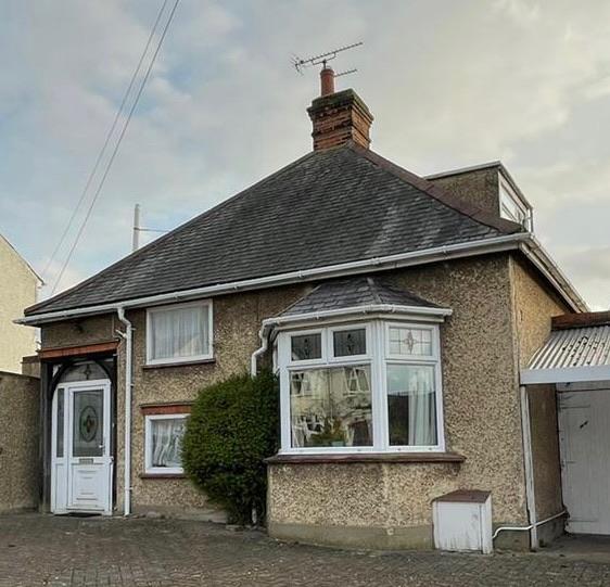

1920 1.5 storey bungalow/chalet. Looking at either second floor or rebuild.
Hi all,
Been lurking here for quite a while, and  thank you for all the help I’ve read already.
Last year we purchased a 1.5 storey chalet bungalow (not sure what’s it really called!), 14m x 45m plot. 160sq m currently. Main issue is that the 1st floor is within a tent roof (don’t know the right term, but all corners finish at a central chimney) so really affects the headroom.
We’re in the process of digging some holes around the existing foundations to see if a full 2nd storey plus roof will be possible. Really hope so, not sure we have the budget for a build as we could much more easily phase a renovation.
Will be asking for much help I’m sure, few things such as:
  • What order to appoint architect for the design / Structural engineer for the foundations or Builder for ideas of costs. In that how much does being RIBA matter for the architect as we’ve seen some significant developments on planning applications that aren’t from RIBA practices.
  • I understand that planning is granted for 3 years. But if you’re phasing the building of things that are in the submission, but quite easy to separate (eg adding a garage that might be a year after from initial build), is that still ok? Is there a timescale you have to hit the granted plan?
  • Where the best bits of a build are to save money (except labour).  Ie is it better to skimp on cheaper kitchen as you’ll replace in 10 years anyway? Where have major renovations had buyers remorse on more optional spend?
There’ll be many more hand will likely ask these in the right forums too), look forward to being part of the community

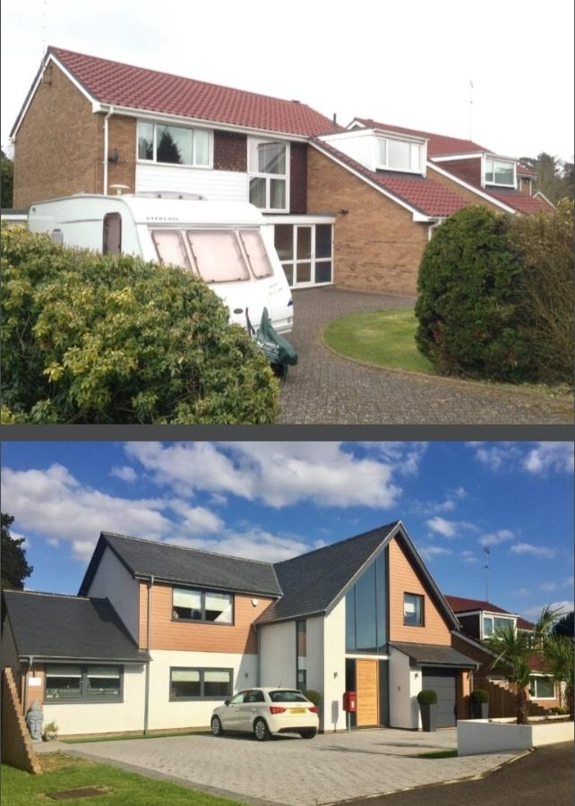

Hi. Just making it a bit visual using an example of renovation as to what could be done and the costing and value impact. Below is the picture of a refurbishment of a two story house (before and after) which was done to a very high standard with c40% extension. It costed between c300-400k in 2015. It recently sold generating c175k in profits. But the original house would also have increased in value by c150k in terms of just house price inflation. So not significant profit on refurbishment if you take the inflation out. May be a bit of loss in today's prices.
So if doing refurbishment to a high/decent standard it might not cost significantly less than new house build hence new build should be serious option. Plus for both either new build or refurbishment, possibility of generous profit if you are doing first project is quite small hence as others said simplicity and getting the design right is the key plus a state of mind that you are doing it to live in it rather than as a property developer would certainly help in terms of getting expectation realistic.
