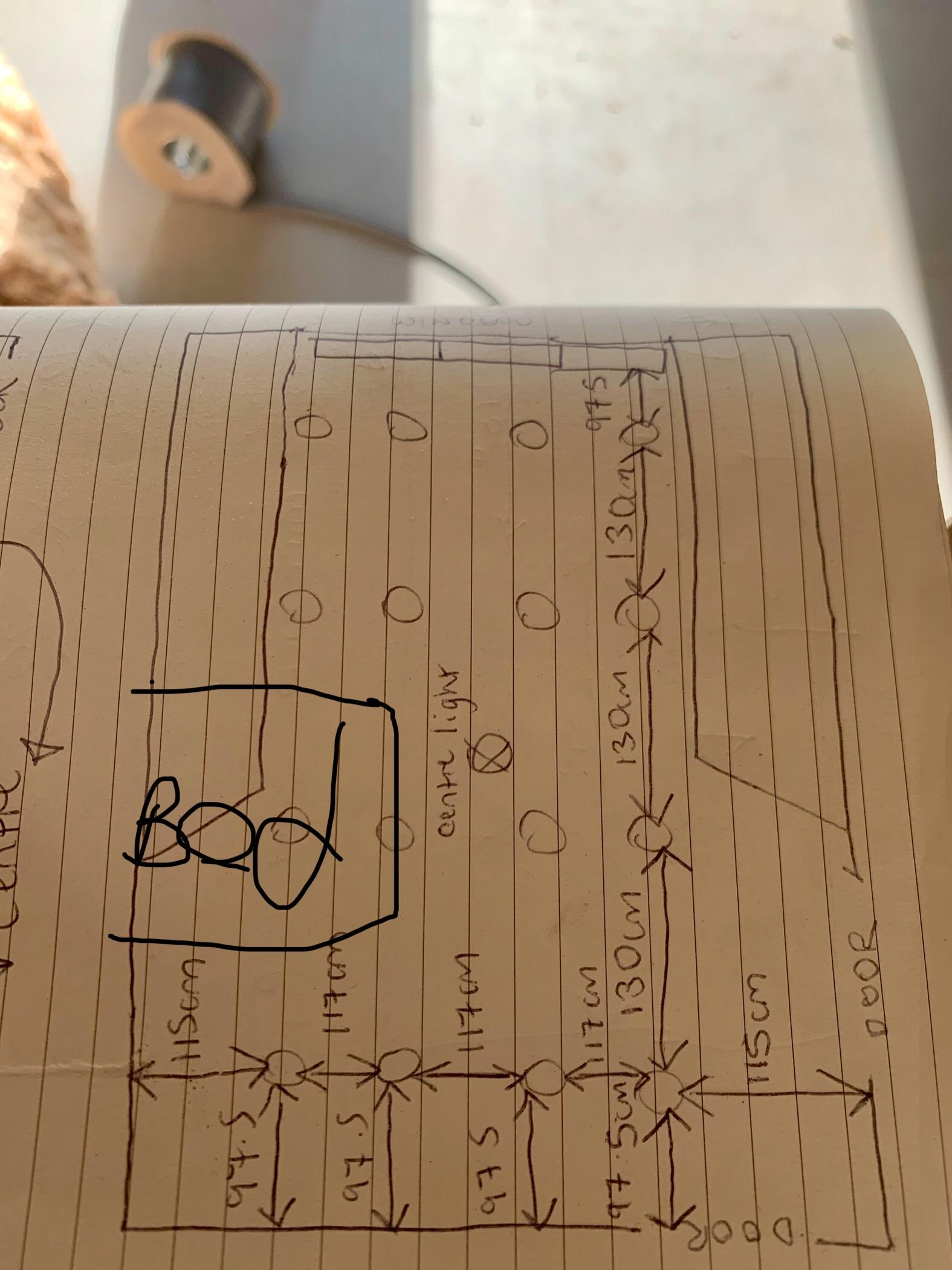

James94 Posted January 15, 2022 Share Posted January 15, 2022 Can anyone offer a better design on our bedroom lighting ,all lighting will be dimmable but I’m thinking we’ve over done it with spots. this pic shows a rough design and measurements of the room,each side has a sloping section of ceiling. Regards. James Link to comment Share on other sites More sharing options...
ProDave Posted January 15, 2022 Share Posted January 15, 2022 Personally I don't think a bedroom is the place for rows of downlighers, and I much prefer some nice central or pendant light, and a bedside light possibly wall mounted each side of the bed. 1 Link to comment Share on other sites More sharing options...
James94 Posted January 15, 2022 Author Share Posted January 15, 2022 (edited) This is a plan the electricians have come up with, featuring a center light and 2 bedside lamps on a 5amp lighting circuit. whilst we do want a good level of lighting I personally think there is too many spotlights. Im just not sure on how to space them out. My dad suggested maybe removing the 4 around center light, what do you think? James Edited January 15, 2022 by James94 Link to comment Share on other sites More sharing options...
Russell griffiths Posted January 15, 2022 Share Posted January 15, 2022 When thinking of mine I went and bought a couple of lights, got off cuts of plasterboard and mounted the lights in the ceiling and wired them to a plug then with various extension leads got them all working, I soon found out I needed half the light I thought I needed. Also good for working out warm white or cool white. Cool white is harsh in a bedroom. 1 Link to comment Share on other sites More sharing options...
Soulfish Posted January 15, 2022 Share Posted January 15, 2022 We've gone for a combination of led-profile coving uplighting, downlighters for when we want a lot of light in the room and pendant lights hanging over the bedside tables. Although we've got no where near that number of downlights for a similar sized room. We ended up with 6 GU10 downlights providing more than enough light when we need a lot of light. Link to comment Share on other sites More sharing options...

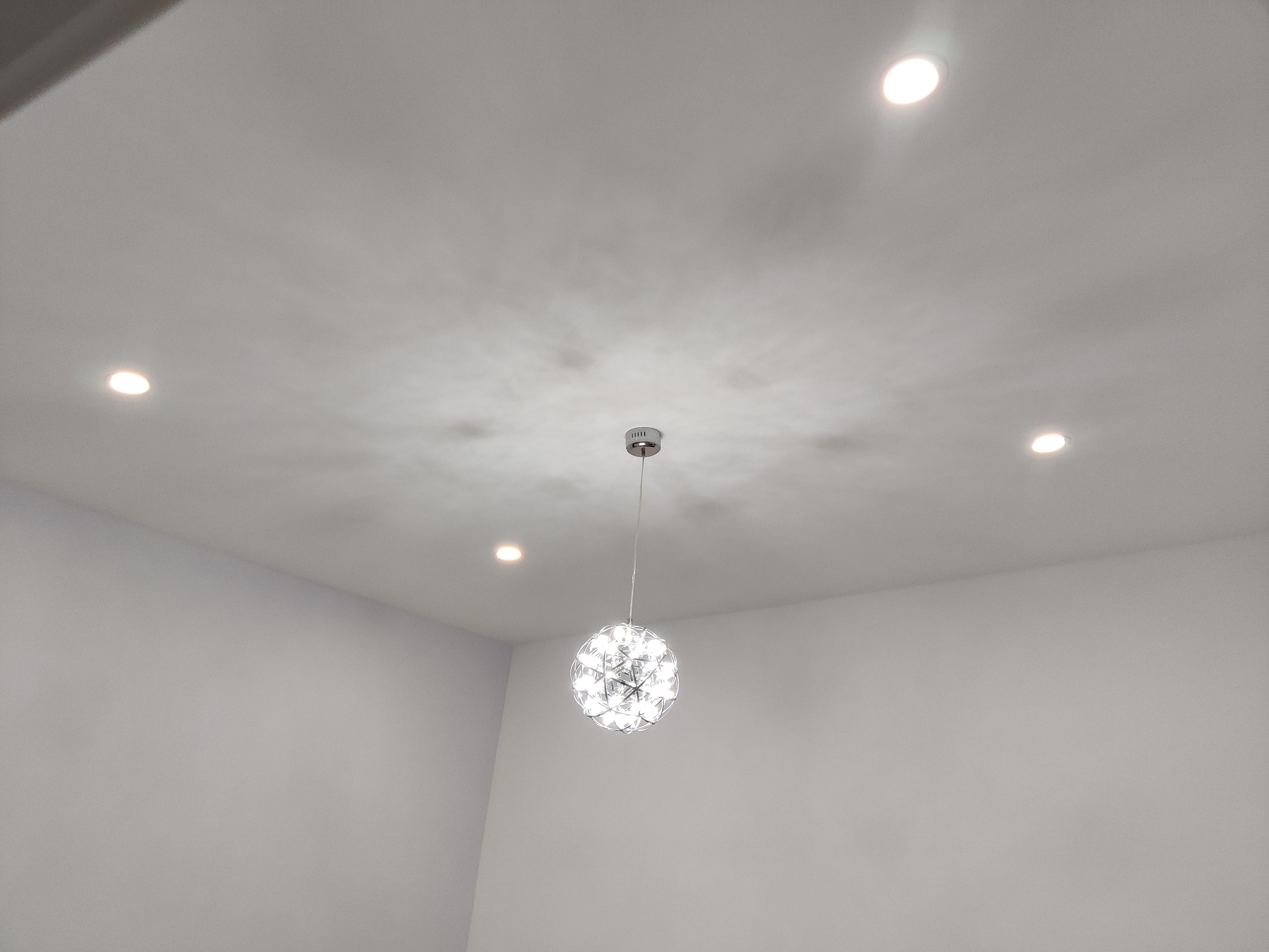

JohnMo Posted January 15, 2022 Share Posted January 15, 2022 Way too many lights, you'll need your sun glasses on before you go to bed. We have 4x shallow 80mm spots, a central pendant and 5A sockets by the bedroom Link to comment Share on other sites More sharing options...
James94 Posted January 15, 2022 Author Share Posted January 15, 2022 Thanks for all the advice, I’ll speak to the electrician Monday and see if we can maybe reduce the amount of spots. I think I’ll probably try having the 4 surrounding the centre light and just leave the wires there pinned up out way just in case. Regards James Link to comment Share on other sites More sharing options...
Conor Posted January 16, 2022 Share Posted January 16, 2022 Our bedroom is 4x5m and we have a central dimmable pendant plus two bedside wall mounted dimmable lights. We have spots in our current rental and hate them, even though they are dimmable. Link to comment Share on other sites More sharing options...
shuff27 Posted January 16, 2022 Share Posted January 16, 2022 I too dislike spots in bedrooms (& lounge) - in our current house we only use them when hoovering. In our new build master bedroom we'll be having a ceiling fan (with light) in the centre, 2 pendant lights (it's quite a large bedroom of 24sq.m.) & 2 bedside low level wall lights. Link to comment Share on other sites More sharing options...
