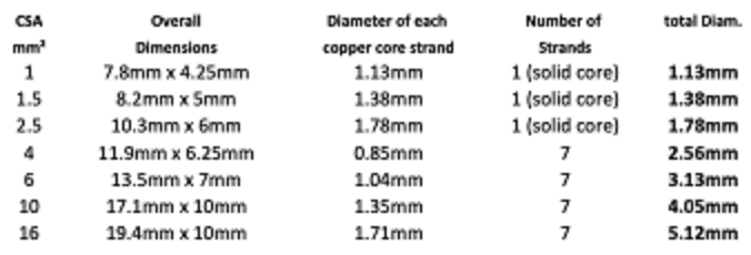

MortarThePoint Posted January 15, 2022 Share Posted January 15, 2022 We've a lot of blockwork walls which are to be wet plastered. This means we'll have lots of cables chased into the blockwork and then plastered over. As I understand it, there are two main reasons to using capping: Protection: to protect the wires from the plaster's trowel, won't protect against screws or nails Rewiring: you have a chance of pulling/pushing wires through and so don't need to disturb the plaster if rewiring. The alternative is to just chase and clip the wires to get plastered over. Chasing limits 1/3 width of blocks if vertical, 1/6 if horizontal. So for 100mm blocks that's 32mm and 16mm respectively. I'm inclined to use the oval conduit pictured below chased into the blockwork. The main benefit is the rewiring one as I see it, because chased wires should be protected enough against the plasterer. I'm doing the wiring myself so can take the time to include the conduit. I'd like it in 3m lengths (2.7m ceilings, 2m works well for 2.4m ceilings), but Screwfix don't carry that, though this page says it is made. The datasheet says it's 1 cm deep, but drawings of other brands suggest 11mm external, 9mm internal. I have read wires outside conduit dissipate heat better which makes sense. What did others do and how realistic is to to rewire through these? Falcon is another option and this supplier looks well priced: https://www.superlecdirect.com/p-oval20-falcon-20mm-pvc-oval-conduit/ TLC unbranded and expensive: Dimensions: External: 22.5mm x 11mm Internal: 20.0mm x 9.17mm : https://www.tlc-direct.co.uk/Products/MTOV20.html Dimensions: External: 29mm x 11mm Internal: 25.0mm x 9.90mm : https://www.tlc-direct.co.uk/Products/MTOV25.html Link to comment Share on other sites More sharing options...

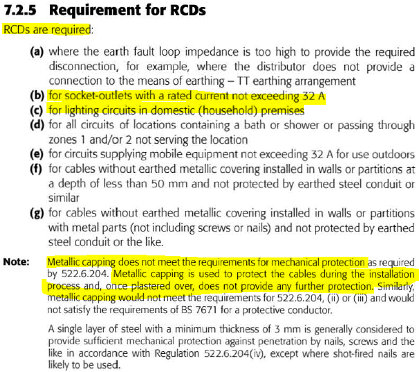

MortarThePoint Posted February 27, 2022 Author Share Posted February 27, 2022 (edited) There's been lots of planning and not much doing what with a pick up in day job demand. I'm starting to doubt the benefit of using conduit/capping at all for sockets. If chased into the wall, e.g. with a 15mm x 10mm chase. With a 10mm chase depth it would be an amazingly cack-handed plasterer who managed to damage a cable. Oval conduit is pretty cheap (£0.35/m) so it's not so much of a cost decision. As @PeterW say's, complete rewiring is likely far down the line, and how many modifications would actually be made easier by conduit. Adding a new socket might be midway between two existing sockets and so benefit from the conduit. I think I am already leaning towards an excessive number of sockets (four 2-gangs per bedroom) so it feels unlikely I'd want more. Maybe using conduit in selected rooms that are more likely to need changes, like the living room. Oval conduit in some ways feels a bit like insurance against making some mistakes. Conduit for wired data connections is a no brainer on the other hand. Edited February 27, 2022 by MortarThePoint Link to comment Share on other sites More sharing options...

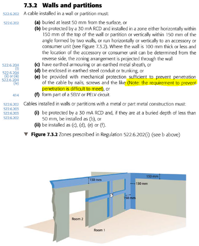

MortarThePoint Posted February 27, 2022 Author Share Posted February 27, 2022 Some relevant extracts from the Onsite Guide: ------ This is poorly written as everything I have seen suggests its (a) or (b) or (c) or (d) or (e) or (f) but there is no or at the end of (b) here. Link to comment Share on other sites More sharing options...
ProDave Posted February 27, 2022 Share Posted February 27, 2022 I would think you WOULD be using an RCD, unless you are for some reason trying to find a reason not to? Otherwise just fit them in safe zones is the only requirement. Link to comment Share on other sites More sharing options...
MortarThePoint Posted February 27, 2022 Author Share Posted February 27, 2022 Just now, ProDave said: I would think you WOULD be using an RCD, unless you are for some reason trying to find a reason not to? Otherwise just fit them in safe zones is the only requirement. One better, I'll be using RCBOs which is effectively an RCD for each circuit. I wanted something to highlight that capping / conduit is nothing to do with protecting cables beyond he plastering stage. Link to comment Share on other sites More sharing options...
