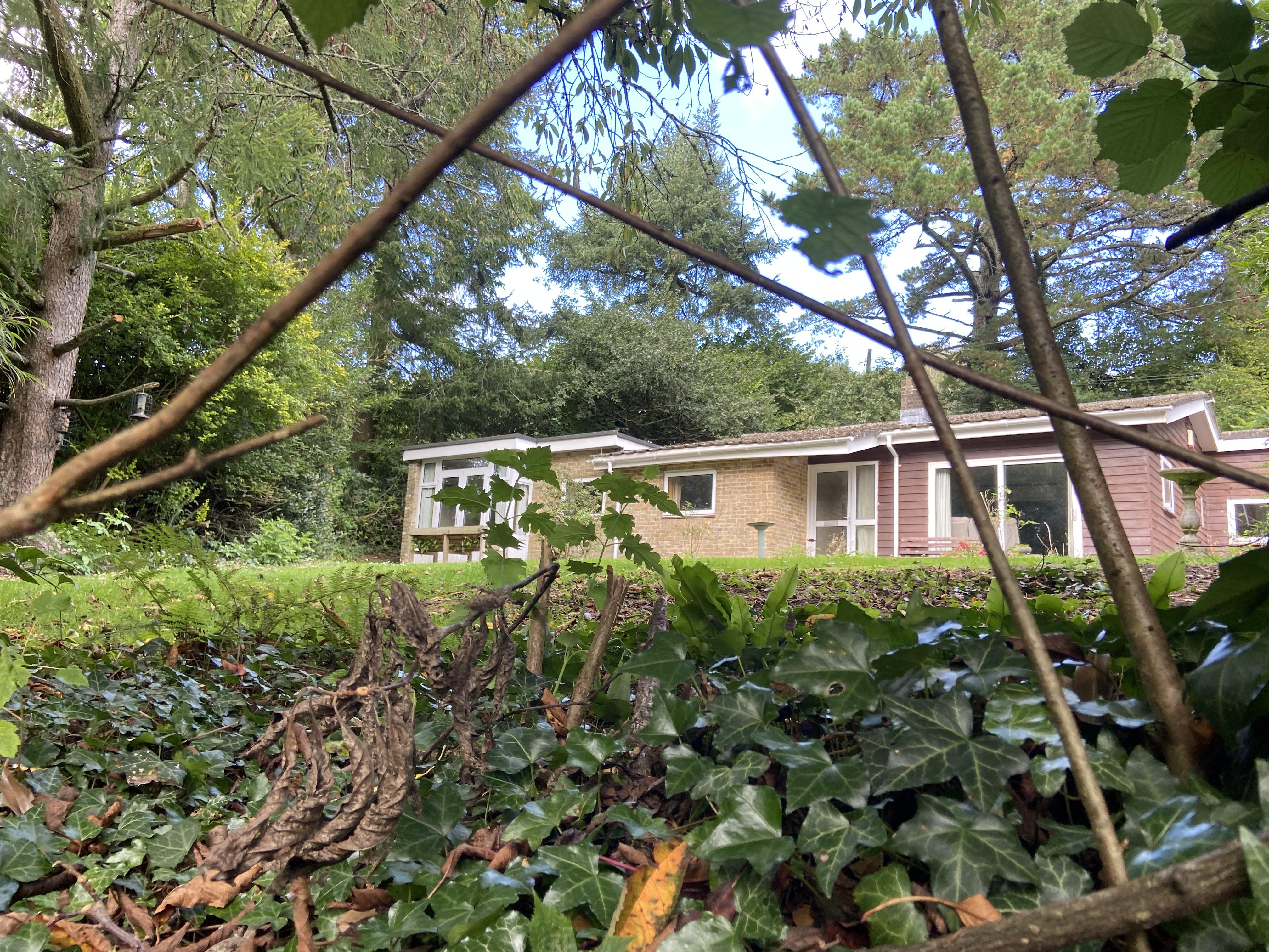

esalglop1945 Posted January 15, 2022 Posted January 15, 2022 Hello Budding Builders. I have recently bought a 1967 bungalow with 20* pitched roof in a rural location close to my home in Cornwall. It was inhabited by the builder and his family until he died last year with no alterations. Mainly brick facing, airgap, studs, timber cladding, airgap, plasterboard. Floor Concrete battens Chipboard. The loft, internal walls and external soffits display a myriad of cables, wiring, phone, Tv, security systems. I hope to raise the bungalow to close to Passivhaus standard. There is currently no sign of damp in the property. Prime question. Can I leave all external walls and plasterboard intact, erect a touching super-insulated studwork including all plumbing and electrics first fix?
Russell griffiths Posted January 15, 2022 Posted January 15, 2022 Why leave the plasterboard up, rip it all out to expose all the studwork, you will need to satisfy yourself that is sound first before you cover it up with extra stud walls. Then make a plan, I would probably build a stud wall internally like you say and insulate both walls. Then air barrier, batten for services and then re board.
Onoff Posted January 15, 2022 Posted January 15, 2022 43 minutes ago, esalglop1945 said: to raise the bungalow to ...the ground. Best bet! ? 1

Iceverge Posted January 16, 2022 Posted January 16, 2022 What a nice project. I'm optimistic about keeping it for 3 reasons. 1. It's pretty and appears to be well kept. 2. It was never altered meaning it must function well and also doesn't suffer from conflicting build methods of different eras. 3. The builder was unlikely to make a hash of their own house. Might you perhaps be able to sketch a cut through of the wall please with dimensions. 1

esalglop1945 Posted January 16, 2022 Author Posted January 16, 2022 14 hours ago, Iceverge said: What a nice project. I'm optimistic about keeping it for 3 reasons. 1. It's pretty and appears to be well kept. 2. It was never altered meaning it must function well and also doesn't suffer from conflicting build methods of different eras. 3. The builder was unlikely to make a hash of their own house. Might you perhaps be able to sketch a cut through of the wall please with dimensions. Thank you for those positive comments. I will explore the walls on Monday and post a sketch photo. 9/10th of walls are brick clad. 1/10 is timberclad as shown in photo. My previous knowledge is from renovating random rubble old Cornish buildings.
CharlieKLP Posted January 16, 2022 Posted January 16, 2022 I like your house too, looks like a nice spot. I wouldn’t demolish it. Are your ceilings vaulted? Agree with what people are saying here but there’s a few things you might be able to do, it depends on how much disruption you want to live with. Not sure how big the rooms are, could you live with dry lining ~50mm. Because you could just skin the walls and spend the rest of the money on new windows. Are you sure you don’t want to replace the weatherboarding, because I’d take that off and put a bit of quilting in there while I’m at it. You can’t do it to the brick, but I’m sure you would appreciate not having to maintain timber in future, I think that would make it look brand new too.

esalglop1945 Posted January 20, 2022 Author Posted January 20, 2022 The timber frame is as follows 4” brick 1” airgap and plastic membrane, 1” solid diagonal sheathing, 4” airgap, 1/2” plasterboard. I am hoping that the 4” airgap can be foamfilled even better if it can be achieved by Grant. The property qualifies as it is already EPC E and has Night Store Heaters.
Marvin Posted January 20, 2022 Posted January 20, 2022 4 minutes ago, esalglop1945 said: The timber frame is as follows 4” brick 1” airgap and plastic membrane, 1” solid diagonal sheathing, 4” airgap, 1/2” plasterboard. I am hoping that the 4” airgap can be foamfilled even better if it can be achieved by Grant. The property qualifies as it is already EPC E and has Night Store Heaters. This was our bungalow before we renovated it!

esalglop1945 Posted January 20, 2022 Author Posted January 20, 2022 2 minutes ago, Marvin said: This was our bungalow before we renovated it! Did you fill the 4” void?
Marvin Posted January 20, 2022 Posted January 20, 2022 Just now, esalglop1945 said: Did you fill the 4” void? Oh yes and covered it with 50 mm of celotex.
CharlieKLP Posted January 20, 2022 Posted January 20, 2022 (edited) I really wouldn’t fill the air gap in a timber framed building. You may get condensation and then it will rot. I would advise you to take advice from a timber frame specialist, not just a builder. Edited January 20, 2022 by CharlieKLP
Iceverge Posted January 22, 2022 Posted January 22, 2022 (edited) I've been thinking about this. I would foam fill the stud bays with a breathable open cell foam like isothane. Importantly don't do the ventilation cavity between the sheathing and the brick. ' I wouldn't put any vapour inboard (I know people will shout at me now!). Doing so would risk trapping moisture within the structure ( because of the plastic membrane outboard).It's only in theory anyway that perfect vapour barriers can be installed. The isothane will allow the wall to dry to the inside. Importantly, if you have a good installer it will provide a very high level of air sealing, ( this will take a diligent installer and maybe a DIY blower fan on site or else a call-back to fill any holes that were missed. Done well, this will prevent air movement through your walls. This is how almost all moisture gets into structures (not diffusion) so it a robust way of keeping your walls rot free. I suspect the membrane outboard is imperfect anyway so some drying can take place that direction. This approach will give an excellent level of airtightness, @Gone West got to PH levels, and good insulation. You will need a mechanical ventilation system of some kind. Maybe some constant volume fans or MVHR if you're enthuastic. A thin layer of pir under a timber floor will make underfoot comfortable. Pump the roof with 300mm of Cellulose. If you want to have very low heating costs an A2A unit mounted somewhere central will do the trick. If you fancy doing the windows I would say a set of white UPVC 3g with good seals ( pref PH certified) is a reasonable priced option. There after the gains made by chasing PH levels in a small house are very marginal. My mantra of thermal upgrades. 1. Airtightness + Mechanical ventilation. 2. Improving U values. ( including windows and thermal bridges) 3. Low energy use mechanicals. 4, Renewables. Good luck! Edited January 22, 2022 by Iceverge 1
