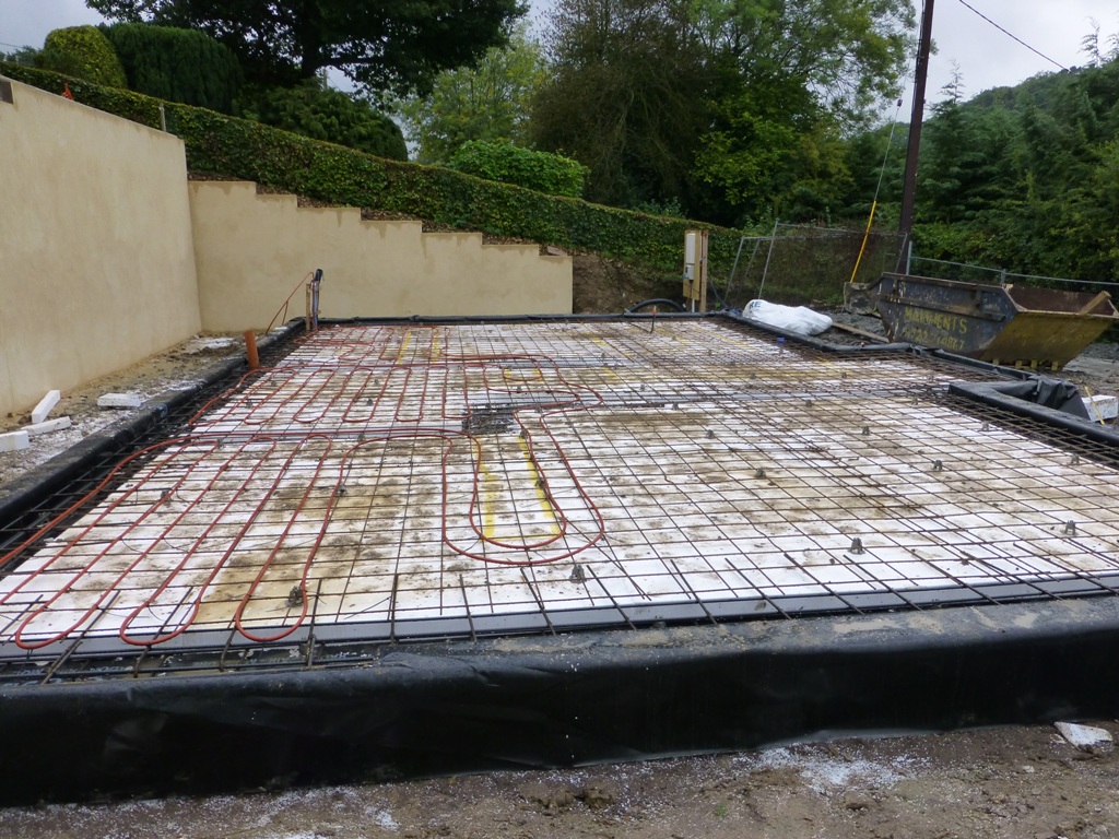

PeterW Posted April 25, 2017 Posted April 25, 2017 So I take it TW aren't letting you connect into that ..!! Is your build within 3m of the sewer then ..? You may want to consider a passive slab as the loading would be less although the SE would need to confirm the 45 degree angle with something like that.
Jeremy Harris Posted April 25, 2017 Posted April 25, 2017 (edited) I was thinking that a passive slab would be a very good potential solution, at a lower ground works cost, too. Well worth looking into, in my view. My other thoughts were with controlling heat loss and solar gain. Even if the house is only constructed to our (pretty dire) building regs performance requirements, I think those very large areas of glass are going to need some very careful detailing. These sort of windows worked very well to bring light into cold and draughty Georgian houses, but will be both a significant cause of heat loss in winter and a potentially very significant cause of overheating in summer in a house built to modern standards, unless mitigation measure are put in place. My experience is that few architects are really up to speed with this sort of detail, although those who do a fair bit of commercial work often seem to be. Edited April 25, 2017 by JSHarris

joe90 Posted April 25, 2017 Posted April 25, 2017 Yes, look at the Golcar passive house foundations. http://www.greenbuildingstore.co.uk/golcar-passivhaus-ground-floor-foundations/. This is what I copied, they are insulated but have strip foundations like you require and you don't have to pay circa £1000 for a structural engineer to design a passive slab for you.
Ferdinand Posted April 25, 2017 Posted April 25, 2017 (edited) On 25/04/2017 at 14:30, Adamantium said: I actually have no idea what a passive slab is, so any quick pointers would be greatly appreciated. I'm guessing its a floating slab of concrete that isn't anchored in deep foundations. This makes me concerned on the run adjacent the sewer as it really does require footings deep enough that the 45 degree load zone is safely beneath the sewer. Is it possible to build a slab that has a strip/trench as well in order to satisfy thames water? Once I'm outside the 3m zone, they care what the foundations do. Expand This is a passive slab, to be more exact @JSHarris' passive slab (sequence of photos). It is a concrete raft foundation (= less deep digging) incorporating about a foot of insulation such that, when combined with similar walls and roof, your heating bills are approximately zero. It is a shallow hole over the whole house footprint filled with hardcore and blinded (smooth layer on top to be less nobbly) with sand, and insulated under the concrete pour, perhaps with ufh and other bits and bobs poking out (soil pipes etc). Then the house is built on the layer of insulation usually as timber frame, with cladding. In the pic, all the black polythene round the edge is covering special insulation blocks that meet the insulation in the walls. A number of people here have used this (which is from a company called MBC) or similar systems. Edited April 25, 2017 by Ferdinand
