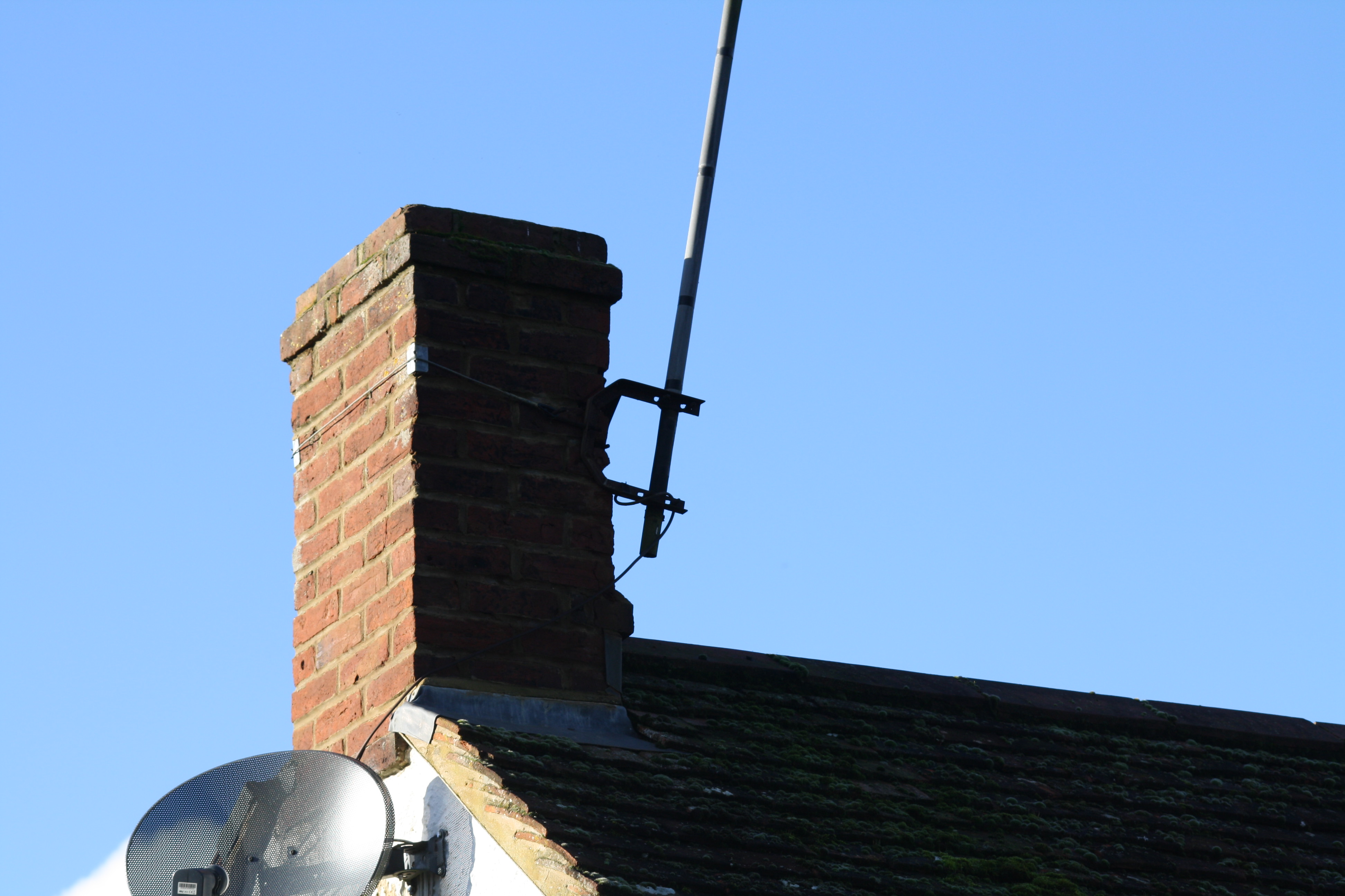

The wall / chimney breast in the upstairs room is a bit damp.
So i finally managed to get up there today and take a look. Basically, its just an open square hole. Can see all the way to the bottom, ie ground floor. So no surprise it gets damp as its raining inside the chimney.
There is a wood fired stove in the living room (that ive not used). This in front of the old chimney, with the flue going up and then into the chimney at 45 degrees. But it doesn't continue up through the chimney.
For now, im not bothered about the stove. But i do need to stop the water getting in. So i guess i need some sort of stainless cover with a pot on top. Much googling has revealed nothing i can buy / have made over here, though plenty in America :(
So what are the recommendations here. Trying get anyone to come and do this seems to be impossible, so im going to have to do it. :(:(:(
Ideally it would be something i can add a flue to later when i get round to sorting out the living room and installing an oil fired stove rather than the wood one and poison myself!
Piccy from the ground.

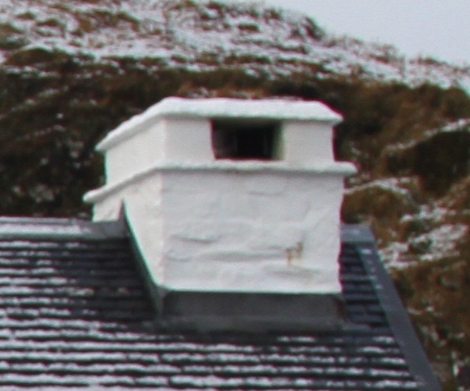

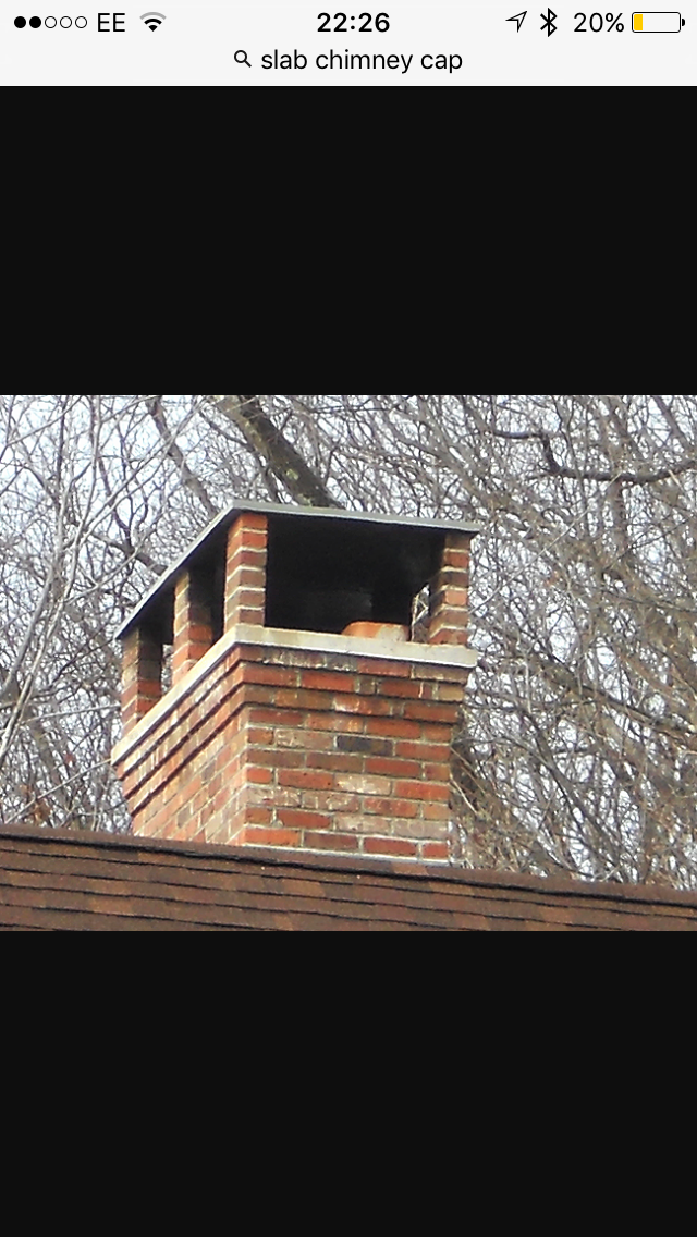

quickest way so you keep water out and still allow ventilation is to use a standard concrete council paver cut to the same size and set onto a brick at each corner. Still allows the stove to be used if you wanted.
you can buy precast tops tops ready for standard pots - mostly in Ireland for some reason ..!

Thanks Peter. The house, well this bit is about 200 years old, and as far as i can tell had its original open fires until 2006.
I had looked at that idea, but it looks a bit odd, certainly here. Next door have something similar to the pic ive posted. (its a semi)
Thinking it might be a good temporary fix until i can find some "proper" to do it, the flashing and a few other roofing jobs.

I had the same situation and used a paver on a few blocks, i also created a raised edge on the top and turfed it just for "why the hell not" i will one day get round to putting a propper top and pots on it but for the moment it works just great and the vegetation survives the random fires we have.......
