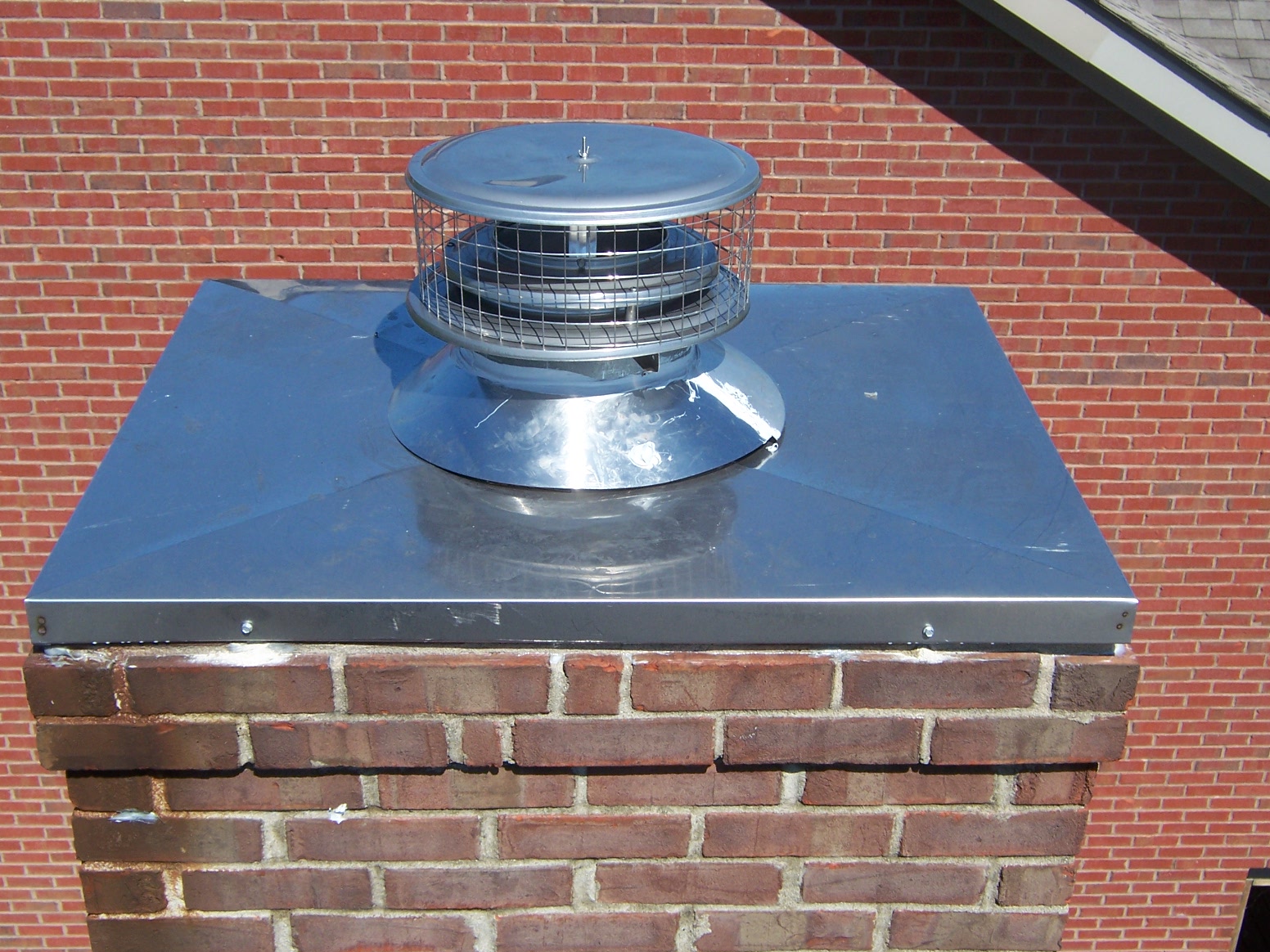

Sorry, maybe leading people astray here.
I will want to use the stove / a stove at some point, but need to stop the water ingress sort of now-ish. But dont want to have to do the job twice. So if i put a pot on it, i can install a flue later.
Equally, being an old house, capping it fully appears to be unwise, i need to keep airflow in there.
But there is no lead flasing tray at all. Nothing, just a big hole :(:(:(
But you have just me realise my plan is flawed, as once i install a flue, i'll have no ventilation in the stack. Hmmm......................................... Twin pot cap?

On 23 April 2017 at 22:14, Roger440 said:
Surely lead would need support??? was thinking something like this??
Go for this type of thing for the interim, cheap and not compo'd in :). Weathertight and ventilated ;)
In my mind im going round in curcles, but you are probably right, do this as a temp measure.
