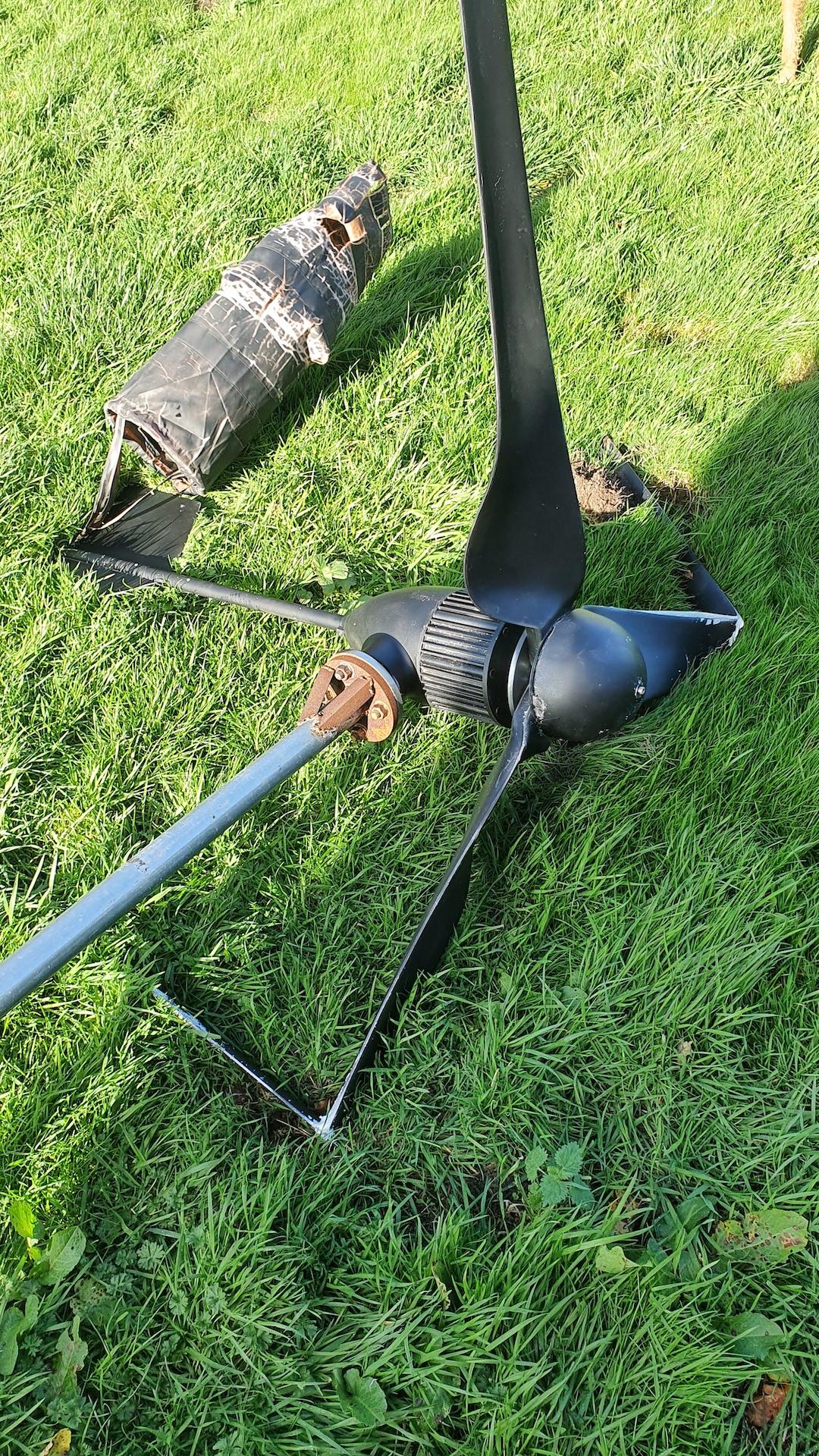

Wil Posted January 13, 2022 Share Posted January 13, 2022 I did have a self installed 1kW wind turbine... It died in a storm after about 9 months of generating very little. It was a total bodge job, but in comparison to my solar it did almost nothing... It was good to have and I miss it's minor contributions on overcast winter days and nights. 1 Link to comment Share on other sites More sharing options...
