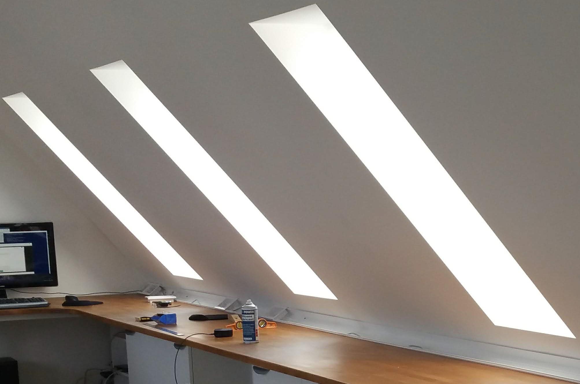

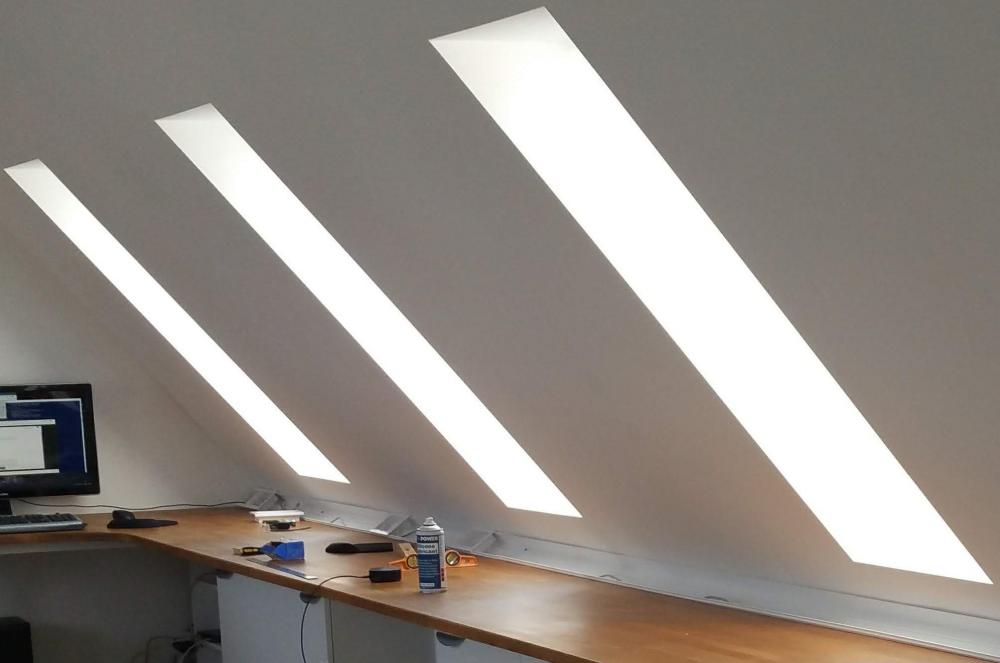

Radian Posted January 10, 2022 Posted January 10, 2022 How are you setting the top and bottom of the reveal? A pet peeve of mine is that it seems standard to set them perpendicular to the plane of the roof/window, like it might seem natural to a chippy to trim square between rafters. But, depending on height of window, when finished this can steal precious light as we found: I altered the top trimmers of the two leftmost windows to make them horizontal - compare with how it looks against the one on the right which was yet to be modified.

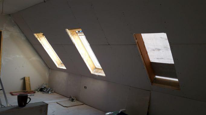

Simplysimon Posted January 20, 2022 Posted January 20, 2022 On 10/01/2022 at 09:21, Radian said: I altered the top trimmers of the two leftmost windows to make them horizontal and even better if the sides can be splayed as well
Cpd Posted January 21, 2022 Posted January 21, 2022 I have done both, one I created a shelf as this looked better and was more functional as the window is quite low down, the others I have done to maximise light as they are higher, not seen them with splayed sides….
Radian Posted January 21, 2022 Posted January 21, 2022 11 hours ago, Simplysimon said: and even better if the sides can be splayed as well Perfect for defensive balistraria ? 17 minutes ago, Cpd said: I have done both, one I created a shelf as this looked better and was more functional as the window is quite low down, the others I have done to maximise light as they are higher, not seen them with splayed sides…. Yes, the most natural light value is obtained from windows that are relatively low down but I cannot see any advantage in not always doing it this way. The velux installation guide shows the aperture trimmed both horizontally and vertically but I bet 9 out 10 builders don't take the hint.
eandg Posted January 21, 2022 Author Posted January 21, 2022 On 10/01/2022 at 09:21, Radian said: How are you setting the top and bottom of the reveal? A pet peeve of mine is that it seems standard to set them perpendicular to the plane of the roof/window, like it might seem natural to a chippy to trim square between rafters. But, depending on height of window, when finished this can steal precious light as we found: I altered the top trimmers of the two leftmost windows to make them horizontal - compare with how it looks against the one on the right which was yet to be modified. Thanks - a huge difference there.

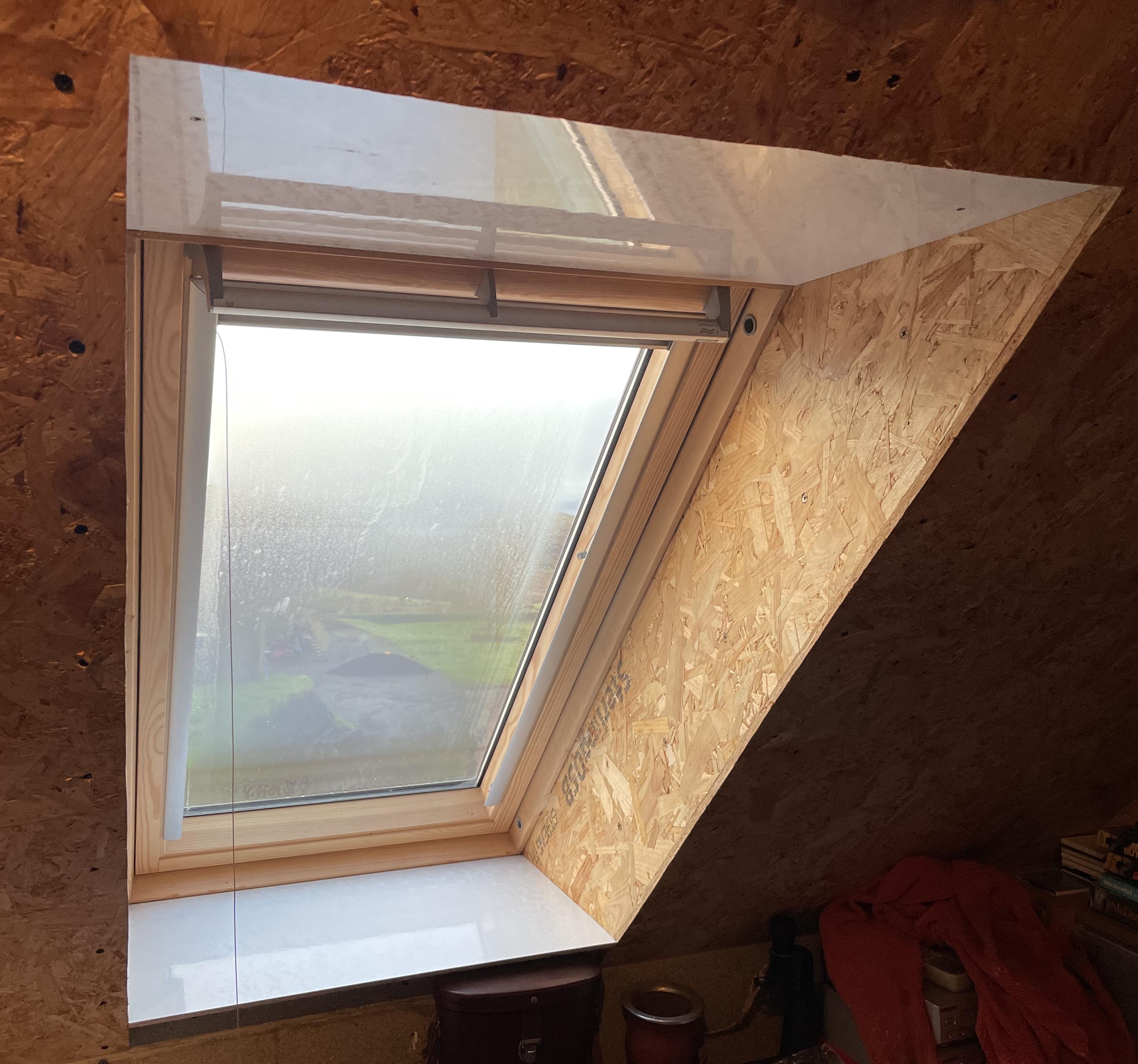

PeterW Posted January 21, 2022 Posted January 21, 2022 +1 to doing this - splaying top and bottom adds significant light into a room. The only difference when they are low in a roof is that I make the bottom level as a cill if it is usable or if it is to be used as a fire egress window.
Radian Posted January 21, 2022 Posted January 21, 2022 I would have actually liked to make the bottom vertical to continue the low wall below but I was installing perimeter trunking so left it perpendicular to match the plane of the sockets (yet to be fitted in this photo...) In an ideal world I would have liked another 100mm on the height of the windows to bring it all the way down but getting these kind of details right from the get-go is virtually impossible.

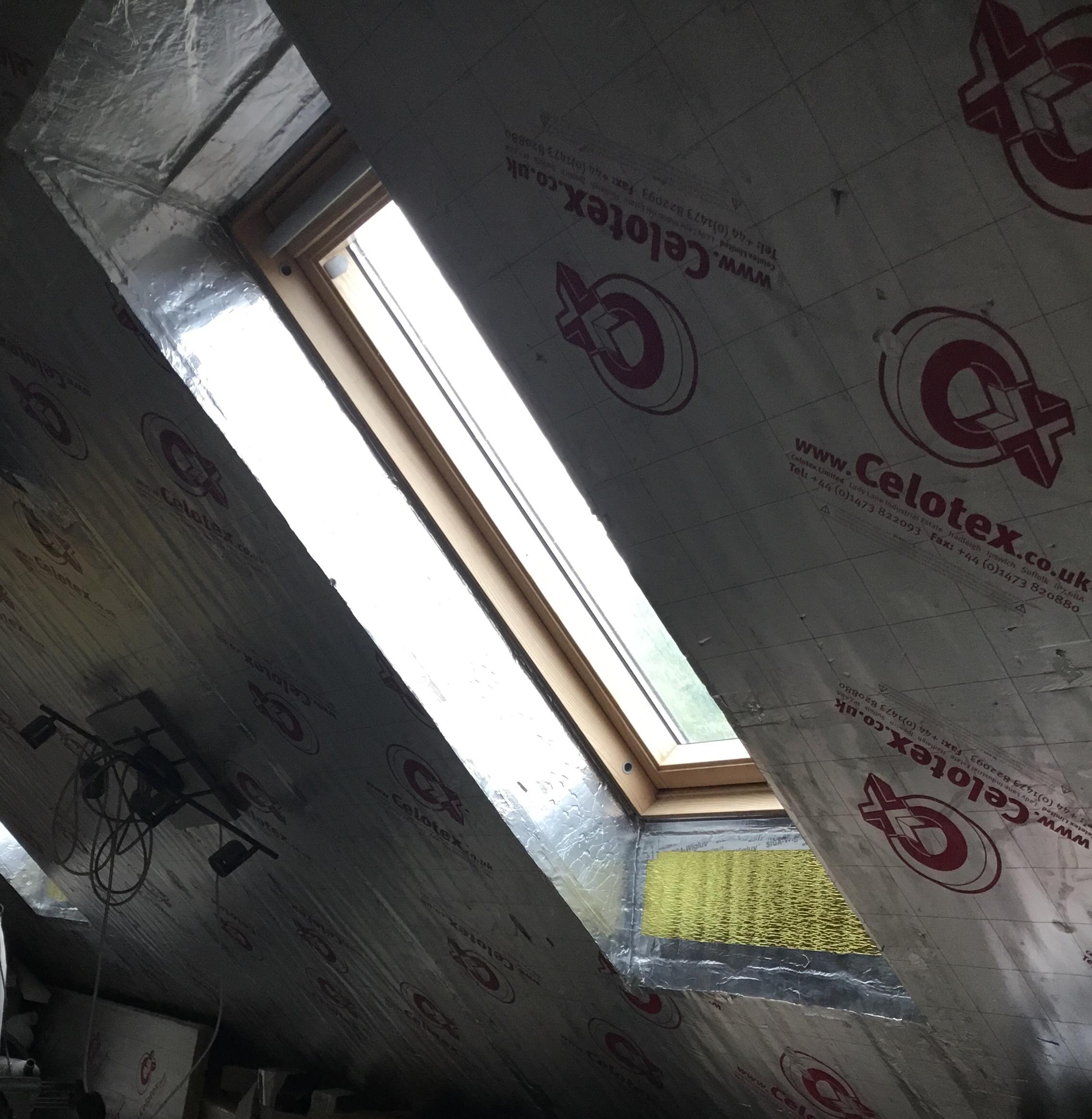

eandg Posted October 20, 2022 Author Posted October 20, 2022 On 10/01/2022 at 06:25, nod said: 10 mil is fine Do you have any advice on detailing install for airtightness, insulation etc? Joiners doing this rather than the window fitters who'll come later and I think I'll need to spoonfeed them.
Dave Jones Posted October 21, 2022 Posted October 21, 2022 if your making it a warm roof do not forget to seal it with a vapour control layer.
