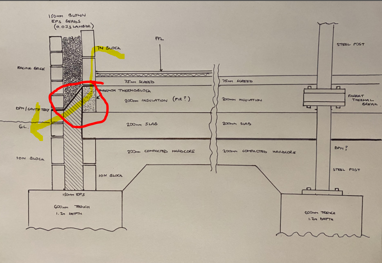

Iceverge Posted January 23, 2022 Share Posted January 23, 2022 Excellent effort. Only one thing I'd change. You will loose a lot of heat via the route of the yellow line. We took the EPS beads well below the DPC and dispensed with the cavity tray. Have a look at the below post about this. The second 2 diagrams tell a lot. Steel beams far from the perimeter of your slab might not benefit much from a thermal break as the path to loose heat to the outside will be so long. @OldSpot had some good insights RE insulation DPMS and UFH clips here. It might be worth considering. Link to comment Share on other sites More sharing options...

OldSpot Posted January 24, 2022 Share Posted January 24, 2022 EPS is fine to use below DPM whereas PIR isn't due to water ingress. PIR will give a better u-value for equal thickness but if you have the depth/space, EPS usually gives better bang for buck. There is also research to suggest that PIR degrades much more than EPS over time. With regard to the slab build up, a number of people here (not me) have done away with the reinforced slab and screed scenario and simply used a single reinforced slab. The slab can also contain UFH pipes. Build up would be, from bottom up - with DPM inserted either below or between insulation: hardcore insulation slab. If you search the forums it will throw up some debate on this build up. HTH! Link to comment Share on other sites More sharing options...

matthyde83 Posted April 5, 2022 Author Share Posted April 5, 2022 Just now, Buzz said: Did they give you any recommendations or alternative solutions Nope. Just demanded there be a cavity tray. We haven’t done interior block work so they suggested taking out the mortar 5mm or so at DPC and beading a tray in with silicone there then tape to interior block at a higher level. Link to comment Share on other sites More sharing options...
matthyde83 Posted April 5, 2022 Author Share Posted April 5, 2022 2 minutes ago, Buzz said: Did they give you any recommendations or alternative solutions My favourite bit however is that we need 2 DPM’s. Have one under the slab that we will lap up the outside of interior wall. They want another under screed that also laps up to cavity tray. We have a level threshold at back so our cavity tray will effectively be block and half above FFL inside. Link to comment Share on other sites More sharing options...

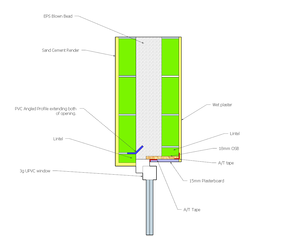

matthyde83 Posted April 6, 2022 Author Share Posted April 6, 2022 6 hours ago, Iceverge said: Oh dear. Well 2 things. First we've had some pretty savage driving rain but no issues without cavity trays. Second, there's always a solution. Can you provide a cross section diagram and a picture of the buildup as it currently stands? I drew this last night. This is what they’re asking for. Atm the cavity tray isn’t in, we’re up to plinth brick height on the exterior skin and have the Marmox blocks in on interior. Obviously no insulation and screed yet. This is a standard detail, at the back we’re level threshold so the garden will be two bricks higher, so there we’ve stepped the DPC up another two bricks so the cavity tray and DPM would effectively be two blocks higher than FFL Link to comment Share on other sites More sharing options...
matthyde83 Posted April 6, 2022 Author Share Posted April 6, 2022 The additional problem I have is how do I get the thermabeads injected in under the cavity tray without piercing the DPM. They’ll need to be injected from the outside so drilled through outside brick and the paving slab which I’m sure the installers are going to love me for! Link to comment Share on other sites More sharing options...
Miek Posted April 6, 2022 Share Posted April 6, 2022 2 hours ago, matthyde83 said: The additional problem I have is how do I get the thermabeads injected in under the cavity tray without piercing the DPM. They’ll need to be injected from the outside so drilled through outside brick and the paving slab which I’m sure the installers are going to love me for! Looking at your drawing it looks like you could drill from inside to blow the beads below the tray. Did BC want to see weeps at the bottom of the tray? Are you in a radon area? The DPM detailing needs to be continuous through the cavity tray as I understand it. The tray will be a fiddly thing to retrofit but if BC are happy with a 5mm chase ' bodge' then that's at least pragmatic of them. Link to comment Share on other sites More sharing options...
matthyde83 Posted April 6, 2022 Author Share Posted April 6, 2022 1 hour ago, Miek said: Looking at your drawing it looks like you could drill from inside to blow the beads below the tray. Did BC want to see weeps at the bottom of the tray? Are you in a radon area? The DPM detailing needs to be continuous through the cavity tray as I understand it. The tray will be a fiddly thing to retrofit but if BC are happy with a 5mm chase ' bodge' then that's at least pragmatic of them. problem is that would be drilling through the DPM that’s lapped up the outside of the inside leaf. made the call to remove the paving slabs on top of DPC, that way we have 50mm to join cavity tray to DPC then bed the slabs on top. Link to comment Share on other sites More sharing options...

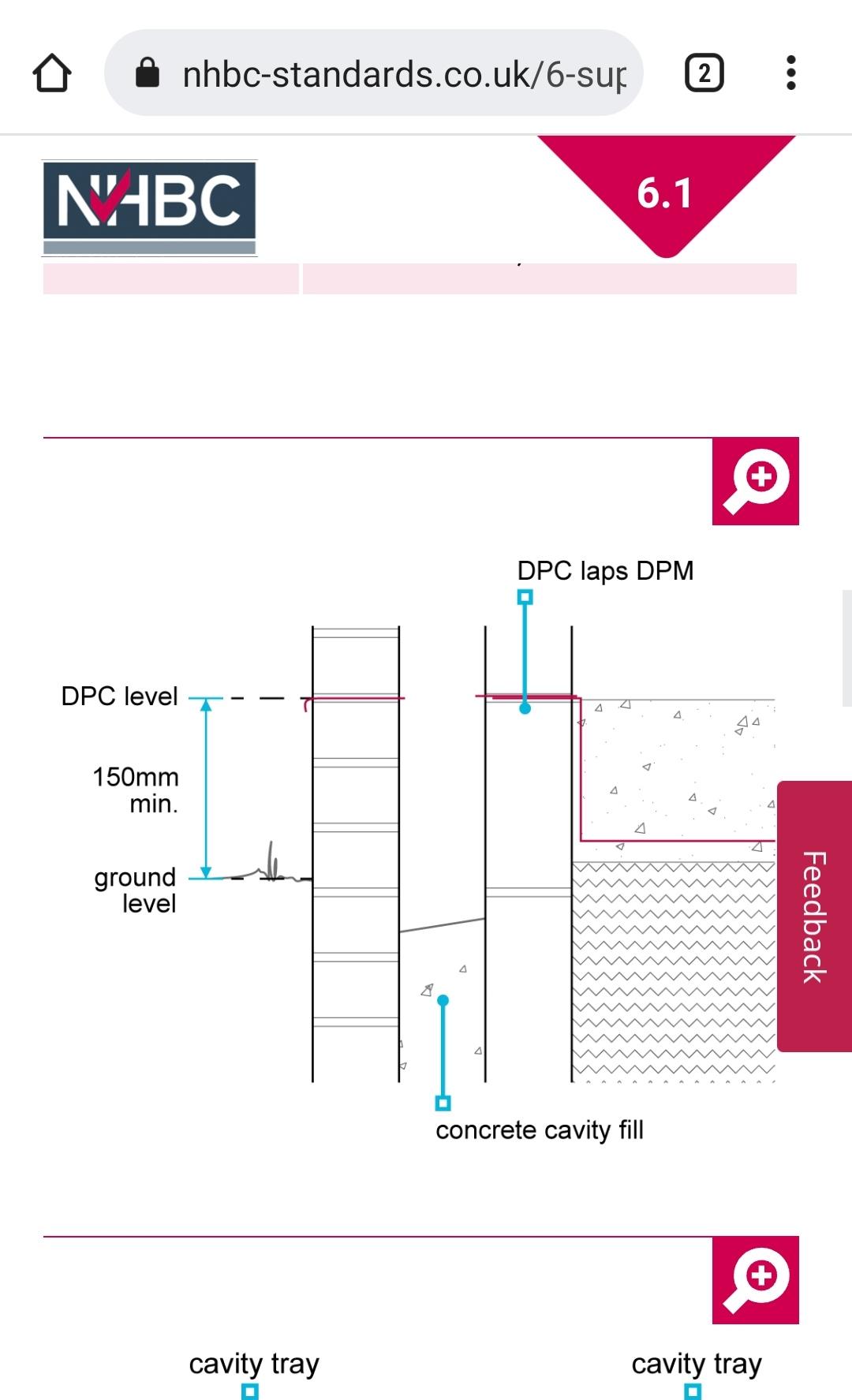

Iceverge Posted April 6, 2022 Share Posted April 6, 2022 What reference is your BC working to? A quick Google found this image on the NHBC website showing a non continious cavity tray. Link to comment Share on other sites More sharing options...
matthyde83 Posted April 6, 2022 Author Share Posted April 6, 2022 1 hour ago, Iceverge said: What reference is your BC working to? A quick Google found this image on the NHBC website showing a non continious cavity tray. Yep I found that. That’s the standard dealing with rising water. there’s then one below dealing with water ingress from outside Link to comment Share on other sites More sharing options...

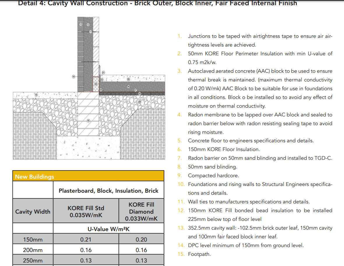

Iceverge Posted April 6, 2022 Share Posted April 6, 2022 I cannot see what that cavity tray achieves. Kore don't have it in their MI's https://www.kore-system.com/wp-content/uploads/2018/12/KORE_Fill_Cavity_Wall_Design_Guide_2018.pdf So much of building is based on " cause we always do it that way," with almost zero interrogation of why something is done. You need to achieve 2 things here. 1.Prevent any drips of moisture that may may be blown through the outer leaf (driven rain) or condense on the inner surface of the outer leaf from running down the wall and making their way in the tops of windows doors etc. The cavity tray needing to extend all the way across the cavity is nonsense in my opinion as by stating that, you've admitted than moisture will be against the outer face of the inner leaf and the battle is well and truly lost. In fact if I was to build a cavity wall house again ( unlikely! ) I would use angled PVC profiles as "drip catchers" rather than DPC plastic as cavity trays. They're always full of holes post build and often hold many KGs of mortar droppings often leading to moisture crossing the cavity. The underside is rarely correctly insulated giving rise to cold surfaces inside the house and more condensation. More negative than positive. Issue 2. You need to prevent ground moisture getting inside your floor. Imagine submersing your house to floor level in a huge tub of water. The DPM needs to prevent water getting in. A continuous DPM up the outer face of the inner leaf as shown (should not be breached by Cavity ties) achieves this. I would be very slow to put any DPM vertically on the outer leaf as it will prevent any moisture that gets into the cavity from draining to the outside. I would always include a French drain always if I had the opportunity. Lower than the bottom of the insulation and free draining to a lower plain. In effect it uses gravity as a DPM. Very reliable. Link to comment Share on other sites More sharing options...
