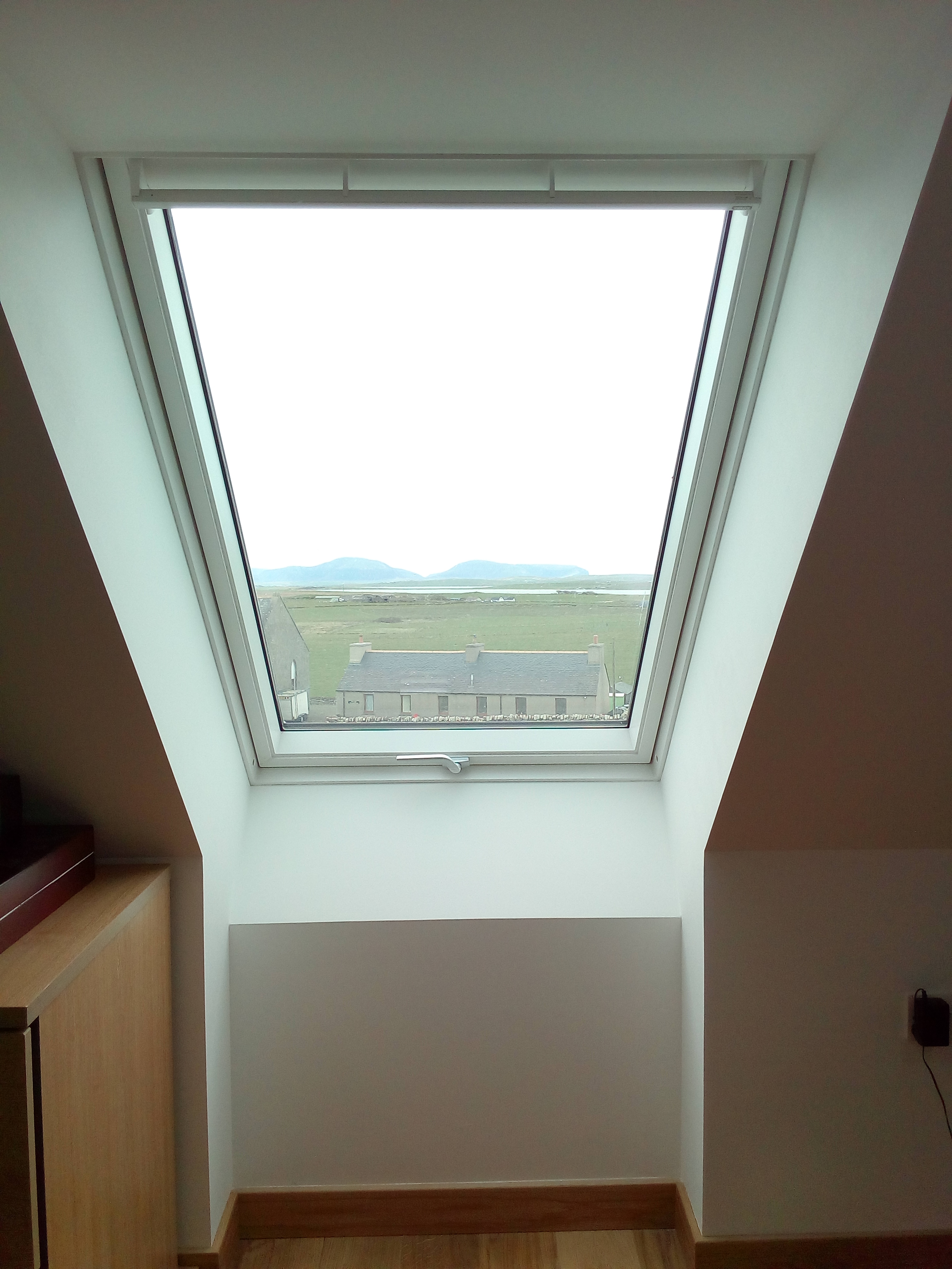

Coopers Posted April 22, 2017 Share Posted April 22, 2017 Hi folks. Sorry to use brand name, but that's why we are having. I've spent a week stressing over these veluxes being set too high. The position was agreed with the builder but of course we have to live with it if it's wrong. The other half tells me that they couldn't go any lower, but i am sure that they could have sat lower down , at the top of the wall. What do you think? It's a cut roof and i know it will take a lot of work to reconfigure 4 windows, but worth it, yes? Link to comment Share on other sites More sharing options...
PeterW Posted April 22, 2017 Share Posted April 22, 2017 Any chance of a slightly wider shot ..? Just looking at what appears to be four joists sistered up and can't see how the roof is made up. You could come below that wall if you really wanted to but you may need a toughened or laminated panel for BRegs. Are any of those means of escape windows ..? Link to comment Share on other sites More sharing options...
Stones Posted April 22, 2017 Share Posted April 22, 2017 What are you trying to achieve? We fitted ours so we could comfortably look out and take in the view when seated. In our case the bottom of the window is 800mm off the floor. 4 Link to comment Share on other sites More sharing options...

Coopers Posted April 22, 2017 Author Share Posted April 22, 2017 Another pic. What I'm thinking is that the window frame itself will make the sightline even higher. Link to comment Share on other sites More sharing options...
Coopers Posted April 22, 2017 Author Share Posted April 22, 2017 (edited) Bottom of opening is aporox 147cm . The handle will be about 210 cm from floor. Two windows in bathroom and the other on a study-landing. Edit and no they are not MOE Windows. Edited April 22, 2017 by Coopers Link to comment Share on other sites More sharing options...
ProDave Posted April 22, 2017 Share Posted April 22, 2017 At the very least, choose a window with the handle at the bottom, e.g a top swung Velux? The other issue with small (short) windows like that, is if you lower the bottom of the window, you might then bang your head on the top of the recess. Stones solved that by having nice tall windows so you get the view low down, but there is still head height clearance. At this stage, probably the easiest solution is replace the windows with taller ones. Then the top can stay where it is and the joiners just have to cut some of the rafters and re frame the bottom. A lot easier than keeping the same size and moving it down. Link to comment Share on other sites More sharing options...
Coopers Posted April 22, 2017 Author Share Posted April 22, 2017 Basically i want the whole thing lower. The question is really can it be done as i am being told no. The velux window is 98cm tall Link to comment Share on other sites More sharing options...

Coopers Posted April 22, 2017 Author Share Posted April 22, 2017 (edited) I'm told that it's structurally difficult, but it wasn't me that had the conversation with the builder. They are paid by the day so no issues there and I'm happy to pay to have it just right. This is the base of the window . If lowered it will sit just on the side wall. Astrium wall is that what they call it? Edited April 22, 2017 by Coopers Link to comment Share on other sites More sharing options...
Simplysimon Posted April 22, 2017 Share Posted April 22, 2017 i'm presuming the wall will be clad in ply? and therefore be structural. if so the calcs would be for that height which could make it more awkward. is there a reason not to run the rafters in one length rather than bolting short ones together? i see no reason why it shouldn't be lowered other than inconvenience to se and more expense! as with @ProDave, if the windows haven't yet been bought, go for longer ones. Link to comment Share on other sites More sharing options...

MikeSharp01 Posted April 22, 2017 Share Posted April 22, 2017 9 hours ago, Coopers said: If lowered it will sit just on the side wall. Astrium wall is that what they call it? Then it looks like it can go lower but the sill detail will change and you will, as others have said, need to sort the structural stuff around the move out with your SE. Link to comment Share on other sites More sharing options...
