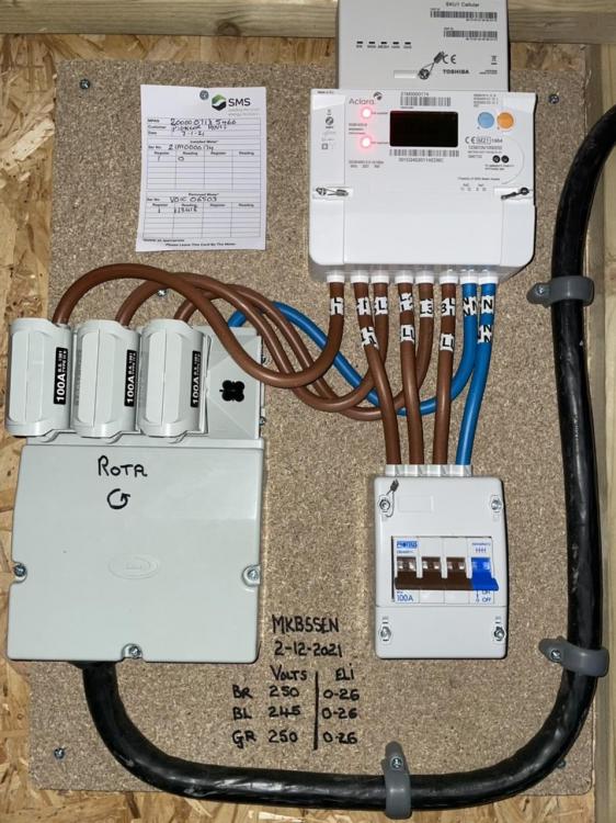

AliG Posted April 24, 2022 Share Posted April 24, 2022 Hi Mark, My installer was RB Grant https://www.rbgrant.co.uk They are an electrician which i felt more comfortable with than a fly by night PV installer who popped up to take advantage of short term demand. If you ask SP Networks for a price for three phase they will come back to you within a few days. If you have a three phase cable passing by, which you may well have it will not be expensive. Intelligent Octopus only requires taht you have a Tesla, MCS is required only if you want paid for export which is separate to this. The Tesla Energy Plan which includes a Tesla Powerwall needs an MCS install.However, the savings aren't that great over Intelligent Octopus that they would pay for the Powerwall cost plus there is a massive waiting list for Powerwalls. You would hardly every use 11-12kw of electricity at one time, so if you installed this on a non MCS system part of your capacity would provide absolutely no return. Link to comment Share on other sites More sharing options...
