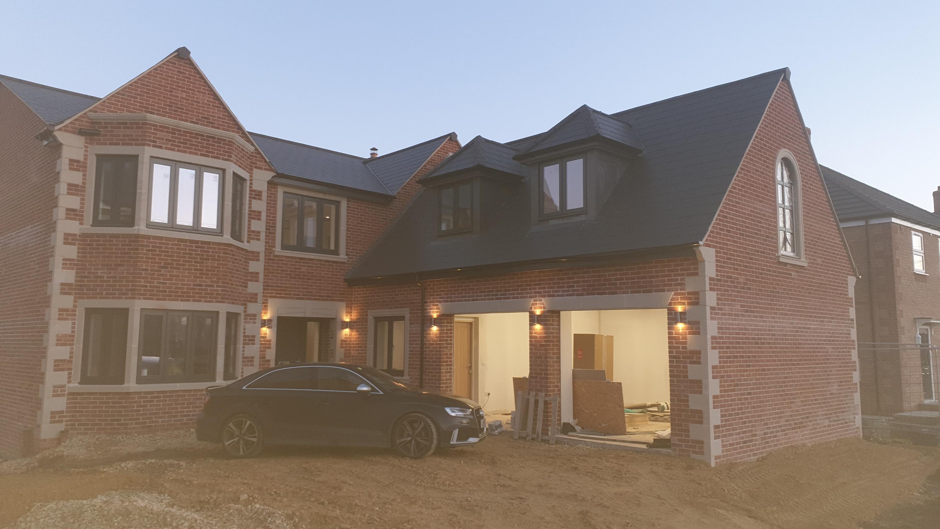

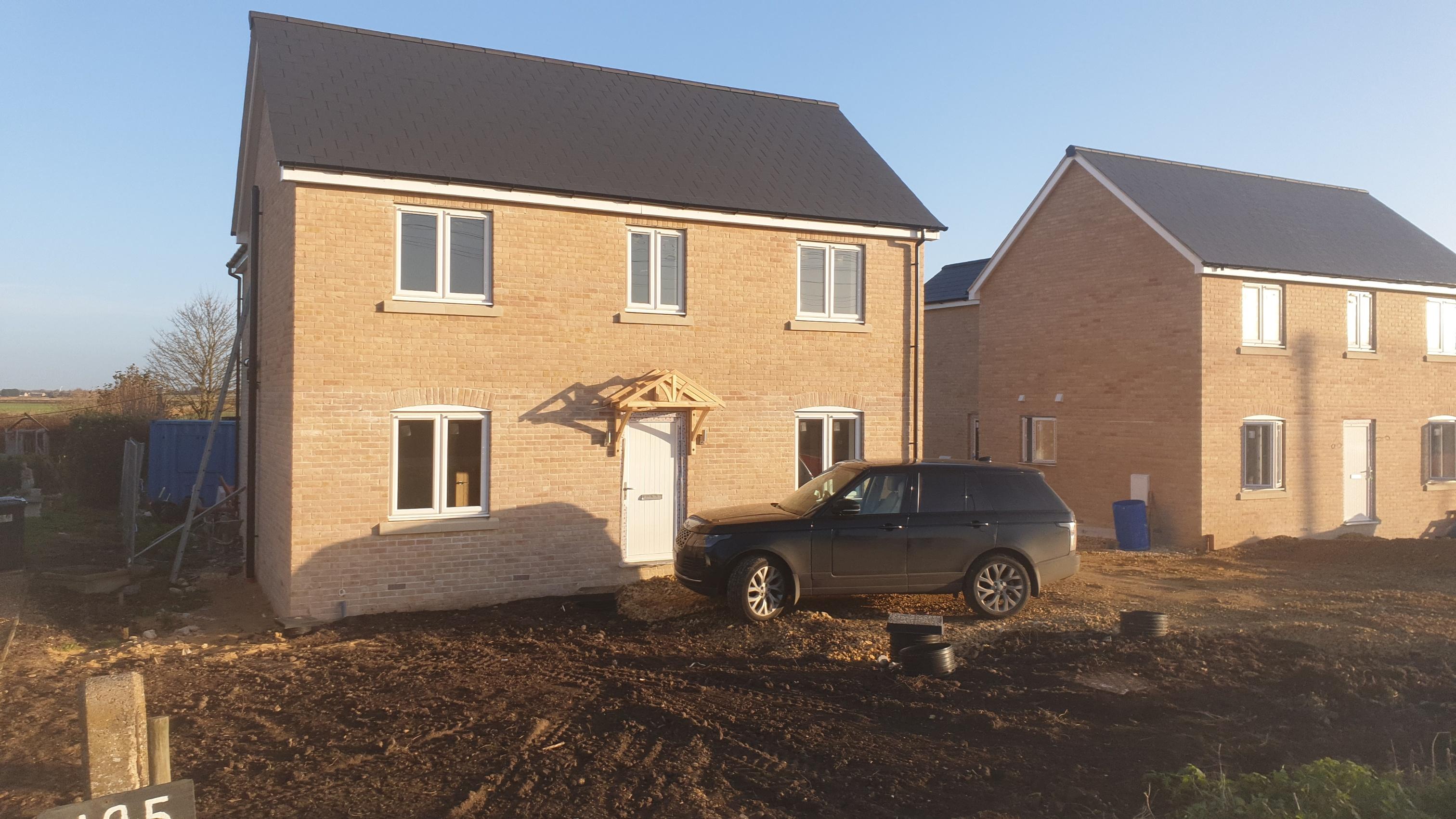

Renegade105 Posted December 13, 2021 Posted December 13, 2021 Hi guys, wondering on my options of grey tiles for our home. so far been looking at the cheaper Marley tiles vs the Spanish Slate. as you can see I don’t wish to spend a fortune but equally want it to work well. I think safer bet is the natural slate but I’m curious with peoples experience with these concrete/composite tiles from Marley etc. if anyone can shed some light this certainly would help. thanks All!
