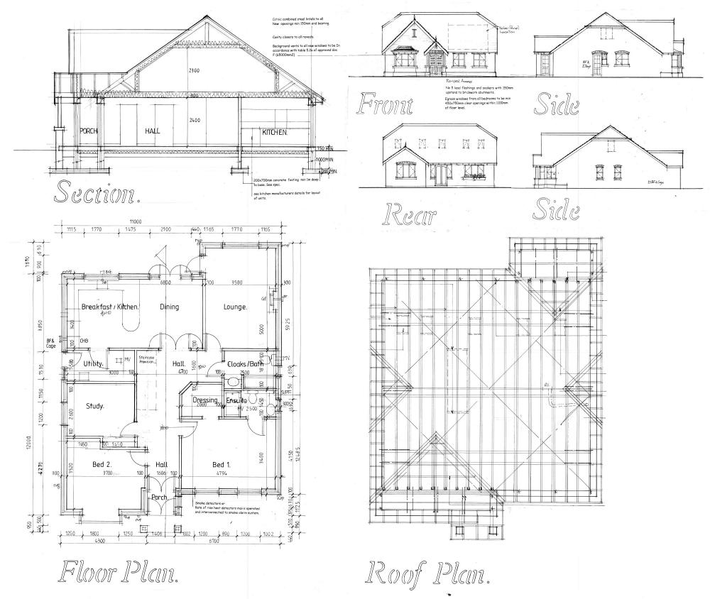

anna Posted November 30, 2021 Share Posted November 30, 2021 Hi, Could you please advise how to compare builder's quotes? Maybe you could share an example quote with descriptions, stages etc . (not figures), please. I'd like to be sure they all include the same things. Are the quotes usually labor only or including materials? Thank you Link to comment Share on other sites More sharing options...

anna Posted November 30, 2021 Author Share Posted November 30, 2021 I sent them detailed plans. I don't know how to compare their quotes. I'm looking for a template maybe with stages explained. Link to comment Share on other sites More sharing options...
markc Posted November 30, 2021 Share Posted November 30, 2021 4 minutes ago, anna said: I sent them detailed plans. I don't know how to compare their quotes. I'm looking for a template maybe with stages explained. Plans are open to interpretation, if you want to compare then a Bill of Quantities is required to enable all to quote based on the same amount of any item. also make a detailed explanation of what you are wanting them to quote on, level of finish, when the job will take place, where the site is, site conditions etc. even then you will get a wide range of prices back 1 Link to comment Share on other sites More sharing options...

anna Posted November 30, 2021 Author Share Posted November 30, 2021 It is a 4 bedroom bungalow. Link to comment Share on other sites More sharing options...
