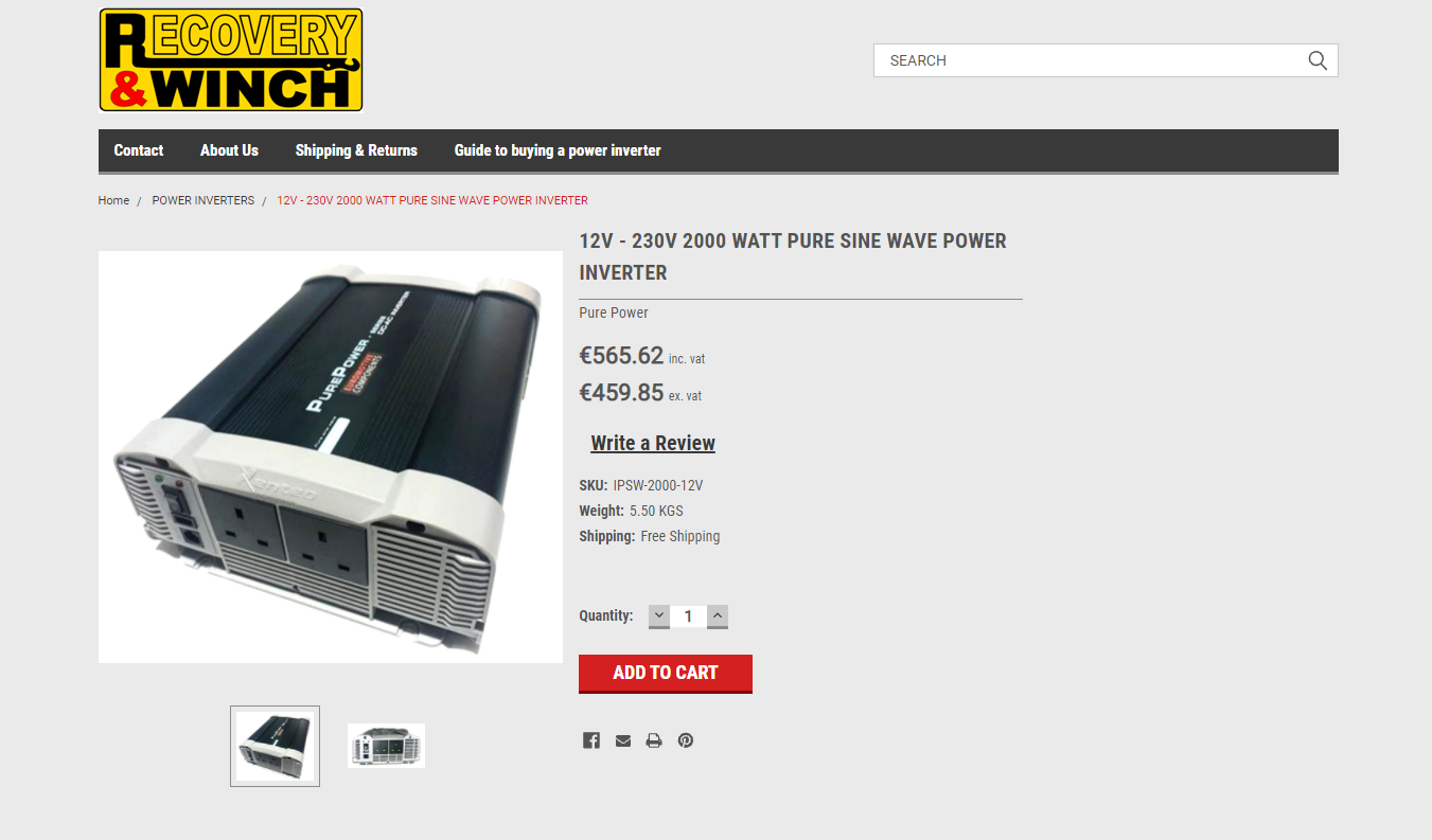

SteamyTea Posted December 7, 2021 Posted December 7, 2021 5 minutes ago, Iceverge said: I very much doubt it. Question: Is this pure or modified sine wave? Answer: Its modified sine wave. I had to return it as my microwave really didn't like the output By S R. on 07 July 2020
Iceverge Posted December 7, 2021 Posted December 7, 2021 Yes, it's like driving on square wheels I've seen in some comment somewhere.
markocosic Posted December 7, 2021 Posted December 7, 2021 Ouch! Dumb resistive loads? They're fine on anything. Incandescent lamps. Kettles. Switch mode power supplies? They're fine on anything. (Including DC!) Phone chargers. Computers. Inverter driven motors. That's new fridges for example. Most stuff that's rated for 110/230V is this type. Motors and transformers with lots of iron in them? They don't like modified sine wave (and will run hotter) but can survive. Basic microwaves in this category. Old school fridges included. Choppers? (stuff with semiconductors that switches frequently to control power) They won't like modified sine. Induction hob and speed controlled motors in this category. Chinesium power supplies? Iffy. Some particularly cheap kit uses things like capacitor resistor droppers that are highly sensitive to anything other than perfection. I hadn't imagined that you'd try to cook on an inverter. Waaay ambitious and over 1 kW. Camping stove for that. The backup power is really for lights, fridge, internets, compute, ventilation Cheap LEDs blowing up is a new one on me though. Apologies if this experiment just cost you some fixtures. These probably have "resistor capacitor dropper" power supplies in them. These act as filters to drop a pass a certain power at 50Hz frequency. At higher frequencies they pass more power. Square waves are made of frequencies from the base 50Hz up to "infinity". As you load up a cheapo inverter the waveform becomes more and more square as its power electronics and capacitors can't sustain the modified sine wave. (especially as the input voltage drops which it absolutely will with just 8mm cable at 12V) That'll push more power through these power supplies and overdrive your LEDs these will get dimmer and smellier as they heat up. Hopefully they're not terminally cooked! Suggest not going over 1 kW at 12V and if so only on a "2 kW" + rated inverter unless a decent brand. Xantrex are decent. These probably decent: https://midsummerenergy.co.uk/buy/sine-wave-inverters Haven't tried anything like this but as a charger and a potential PV input device for a shed / outbuilding they may make some sense: https://www.photonicuniverse.com/en/catalog/full/452-Iconica-1000W-12V-hybrid-pure-sine-wave-inverter-with-40A-MPPT-solar-controller-and-20A-mains-charger.html
