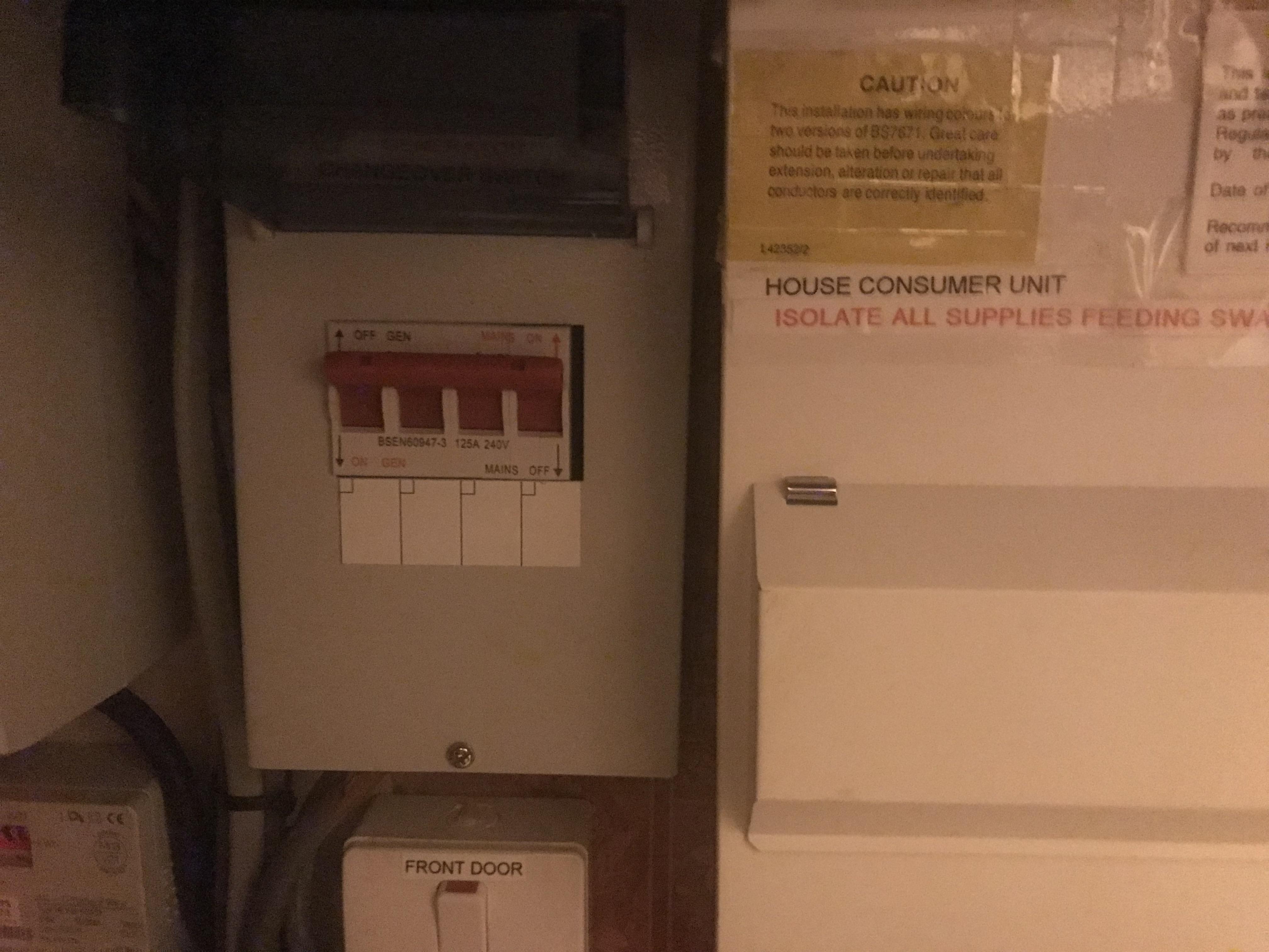

TonyT Posted November 30, 2021 Posted November 30, 2021 Get a generator changeover switch and install next to consumer unit. I have a TLC single phase unit rated at 125 amps so can switch the main house current then wire it to a commando plug in the garage/outbuilding , mine is run in 4mm2 swa /t&e in the house and external. when the power goes off, plug the generator in start and switch the changeover unit. I have a 2kW inverter generator that runs the lights, fridge freezer, heating etc, no loads like ovens, or immersions but thats fine for me.
SteamyTea Posted November 30, 2021 Posted November 30, 2021 3 minutes ago, TonyT said: no loads like ovens, or immersions but thats fine for me Worth remembering that this are sometimes on timers. I would have to split my supply as I am on E7, not hard, but worth remembering. We were discussing the resent power cuts (BiL's parents had no power for 2 days). I said I use my camping stove, BiL said that was what his parents do. My Mother croaked up that there is a stove in the garage, there is, and a full gas bottle. The 1960s have a lot to answer for.
TonyT Posted November 30, 2021 Posted November 30, 2021 mine next to house consumer units. 25mm tails go in feeding switch, 25mm tails go out feeding consumer unit. 4mm cable from generator also provides the feed for the generator supply, only used when there is a power failure. you could get this done as part of the house wiring and buy the generator later..

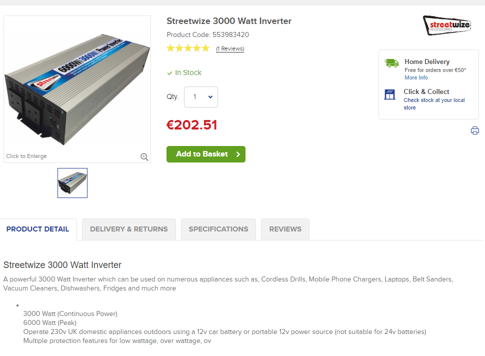

Iceverge Posted December 6, 2021 Posted December 6, 2021 @markocosic I'm intrigued by this idea as I've destroyed two cheap Chinese generators already on the build They certainly don't match what they say on the tin. However I don't want to destroy the 180A alternator in the car. What will prevent the big ball of smoke if someone flicks on the 6kw immersion? We already have a generator change over switch and a 32A input socket in the garage so your plan would work perfectly.
TonyT Posted December 6, 2021 Posted December 6, 2021 The inverter would trip out if you turned a 6kW immersion on. You need to manage high power loads, ie turn them off!
Nickfromwales Posted December 6, 2021 Posted December 6, 2021 53 minutes ago, TonyT said: You need to manage high power loads Deffo. Switching off the breakers in the CU which feed any 'danger' loads is necessary diligence to prevent inadvertent switch-ons, by a 3rd party for eg.
markocosic Posted December 6, 2021 Posted December 6, 2021 Do go overboard on his thick three inverter cables to battery are (your main risk is due from sustained high currents and cheap cable/connector). If you draw to much you'll soon flatten the battery. I wouldn't go above 1 kW sustained draw / 3 kW peak on a 12V system. The alternator is unlikely to give full rated output at idle speed. (usually above 2000 rpm engine speed is full output) Fit say a 10A Type B MCB to the inverter output of you're paranoid. Most inverters will trip long before the MCB does. Melting cables between inverter and battery is main risk.
Iceverge Posted December 7, 2021 Posted December 7, 2021 (edited) Right in anticipation of powercuts today I went and picked up a cheap 3000w continuous/6000w max inverter this morning. It came with nice thick 8mm core copper cables. I bolted it directly on to the battery of my car and backed my car into the garage beside the 32A generator input plug and changeover switch. I connected a normal 13a 3-pin plug to a 32A socket with a 2.5mm2 cable and plugged it in. Then I turned off everything at the CU which wasn't necessary. Immersion, Oven, biocycle unit and isolated the washing machine and dryer. I began experimenting in the house. Two LED bulbs were flickering, others were ok and the few Incandescent ones were all good too. The TV, the MVHR, laptops and fridge freezer were all good as was the water pump in our borehole. I tried the induction hob. It turned on and appeared to be working OK but was buzzing so I abandoned that. Then being an optimist I tried the kettle. To my amazement it began to boil as normal. However the 2 LED's that were previously flickering dimmed almost to nothing and in short order started to smell like burning. I abandoned my endeavours and shortly afterwards the smoke alarm sounded. Que running around the house pressing the silent button on each alarm until I found the offending room, I think it was another LED bulb in a desk light making the smell in there but not certain. I've been monitoring it but the smell hasn't returned. Anyway, I turned the mains back on and even thought there's a storm passing our power has stayed on so I can't add any more for now. What I can't figure is that only 2 pendant light LED's and one plug in LED lamp were misbehaving. The others were fine. Any insights? Edited December 7, 2021 by Iceverge
SteamyTea Posted December 7, 2021 Posted December 7, 2021 37 minutes ago, Iceverge said: Any insights Is this inverter you bought a pure sine wave one. Just taking stab in the dark, if it is not, and the lights/induction hob also 'chop' the power, rather than do it properly then there may be times when all the peaks line up and a higher voltages is achieved. Then there will be times when one is on the way up, and another is on the wat down, which may draw more current than designed. I only have basic understanding of power electronics, not as simple as text books make out.
Iceverge Posted December 7, 2021 Posted December 7, 2021 I very much doubt it. That makes sense. Maybe I'll return it and invest in a better unit now that the concept has been proven. Either that or offload it on my parents with their ancient electronics.
