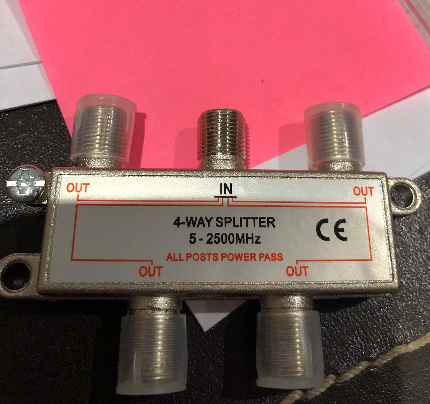

Pocster Posted November 27, 2021 Posted November 27, 2021 I have a TV amp that outputs to a female standard coaxial connector i.e. you you plug the tv aerial into. I wish though to have it plug into the IN on the splitter - but can't work out what fittings/converters I need. Then I need fittings for each output that allow a male standard TV aerial to plug into each of them. I'm getting confused between F connectors/coaxial/BNC etc. etc. Guidance appreciated!
joth Posted November 27, 2021 Posted November 27, 2021 (edited) They look like F-types, same as sky/virgin use. A photo looking in the end of the connector would help. Generally the modern standard is to use F-type everywhere and just convert to UHF coaxial plug on the flylead going to the back of the set itself. You might want to save some bother and buy a dedicated distribution amplifier which had multiple F-type outlets built in. Your existing amplifier maybe more of a mast head booster than a distribution amp, they have different purposes. E.g. https://www.amazon.co.uk/Labgear-LDA2061LR-Way-Distribution-Amplifier/dp/B00J623O88/ref=asc_df_B00J623O88/ Edited November 27, 2021 by joth 1
ProDave Posted November 27, 2021 Posted November 27, 2021 Yes standard F pugs on the splitter. But rather than use that splitter, replace your simple 1 in 1 out amplifier with a "distribution amplifier" that has 1 input and typically 4 or 8 separate outputs all individually boosted. Edit: post crossed with @joth who said much the same thing. 1 1
Pocster Posted November 27, 2021 Author Posted November 27, 2021 (edited) 11 minutes ago, joth said: They look like F-types, same as sky/virgin use. A photo looking in the end of the connector would help. Generally the modern standard is to use F-type everywhere and just convert to UHF coaxial plug on the flylead going to the back of the set itself. You might want to save some bother and buy a dedicated distribution amplifier which had multiple F-type outlets built in. Your existing amplifier maybe more of a mast head booster than a distribution amp, they have different purposes. E.g. https://www.amazon.co.uk/Labgear-LDA2061LR-Way-Distribution-Amplifier/dp/B00J623O88/ref=asc_df_B00J623O88/ The tv Aerial is boosted yes . But if I get the distribution box as you list is better I’ll order that and drop the booster yes ? . So if I order this - do I need any other connectors / converters for the 1 input and multiple tv outputs ??? Edited November 27, 2021 by pocster

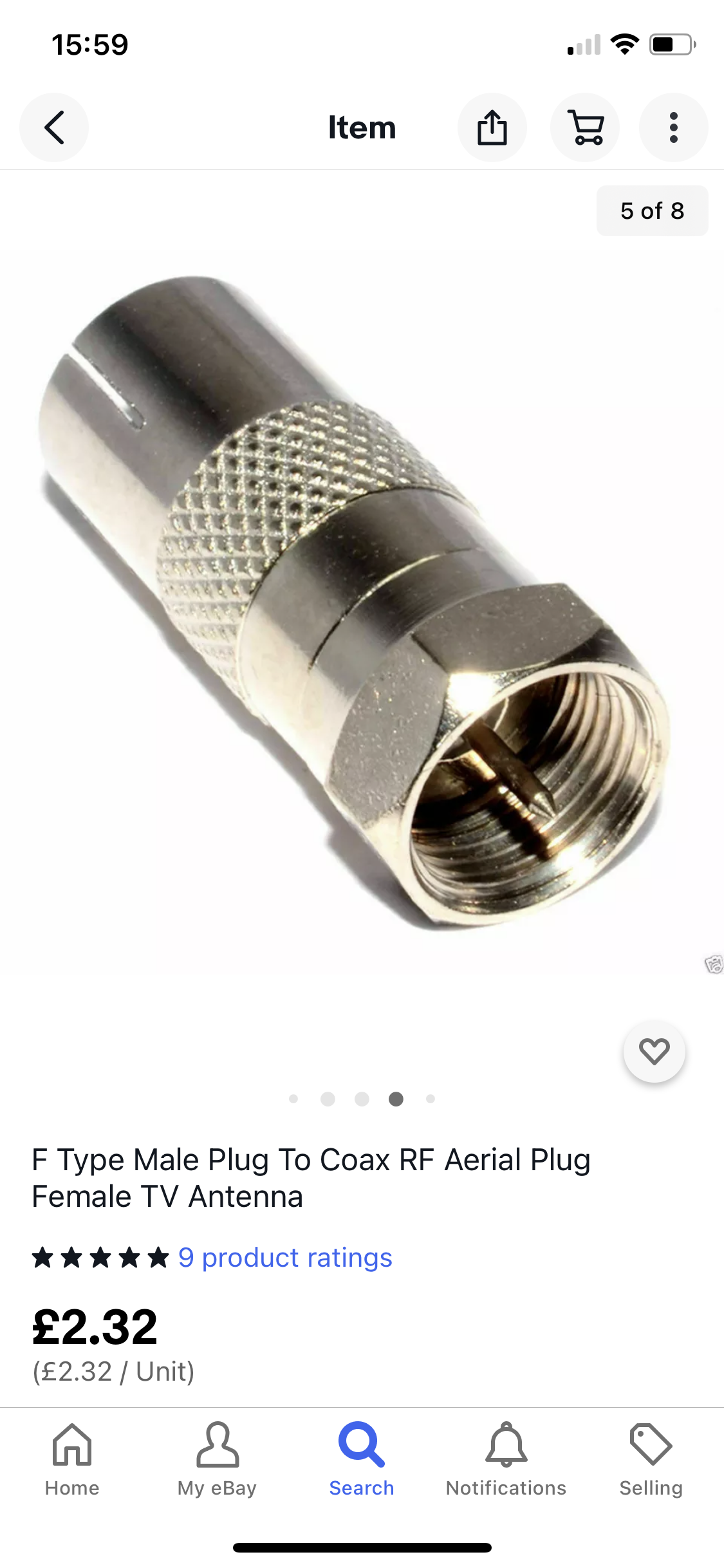

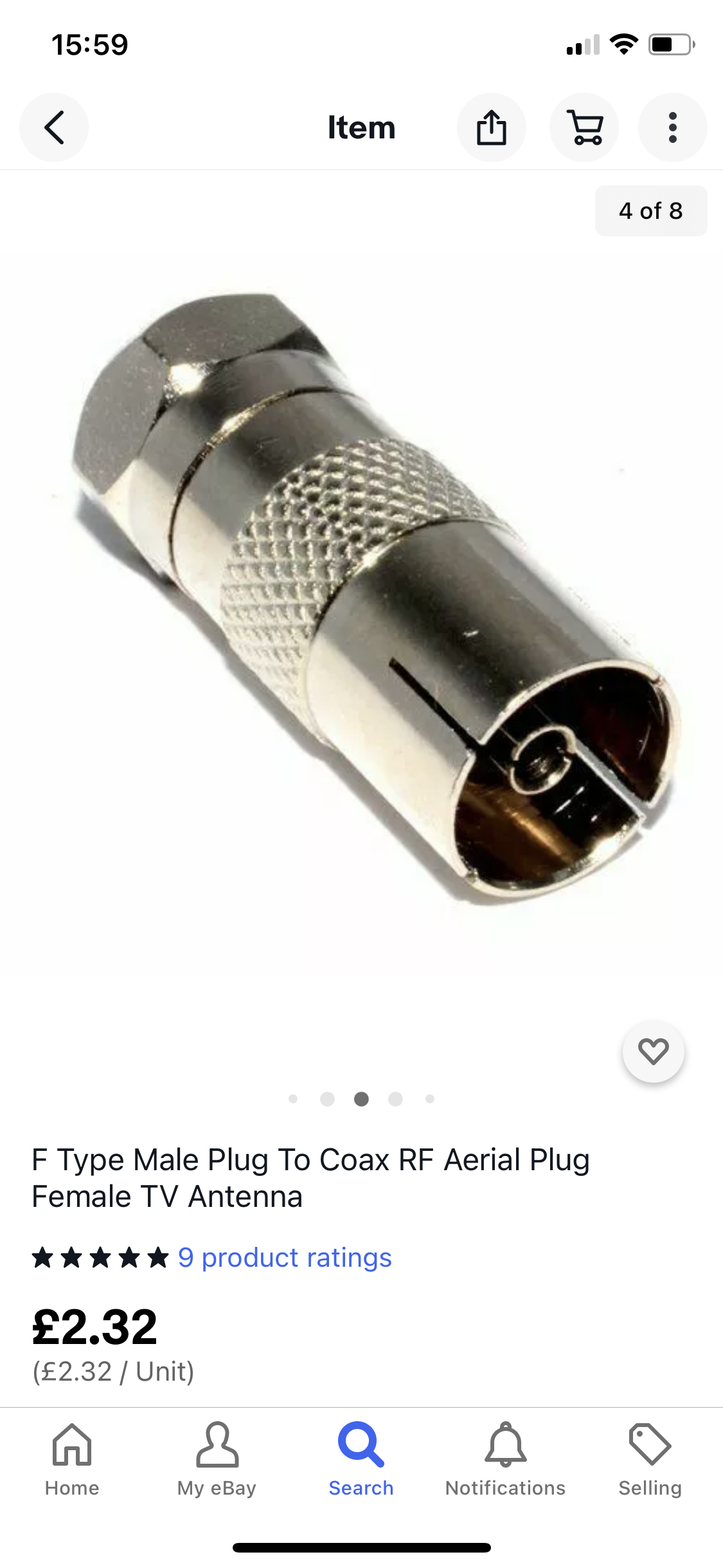

Pocster Posted November 27, 2021 Author Posted November 27, 2021 I need these ?? For the output to male Rf leads ??
joth Posted November 27, 2021 Posted November 27, 2021 (edited) 11 minutes ago, pocster said: I need these ?? For the output to male Rf leads ?? Yes they can work: installed on the female F-type on the amplifier or wall plate, and then use a traditional UHF flylead. Alternatively you can get the opposite gender adapter to get directly in the back of the set, female F-type and male uhf Edited November 27, 2021 by joth 1

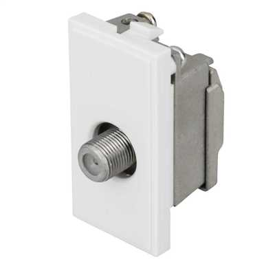

Dan F Posted November 27, 2021 Posted November 27, 2021 (edited) I'm just sorting out connectors for tv/satellite so this is interesting. What is best choice for in-wall connectors: - co-ax female or f-type male? - isolated or non-isolated? Edited November 27, 2021 by Dan F
joth Posted November 28, 2021 Posted November 28, 2021 8 hours ago, Dan F said: I'm just sorting out connectors for tv/satellite so this is interesting. What is best choice for in-wall connectors: - co-ax female or f-type male? - isolated or non-isolated? The wall plate should be F-type female. The pin of the male connector is effectively sacrificial (it's just the inner core of the solid core cable) and will need replacing after so many insertions and removals, so always put the male connector on the easy to replace fly lead. I'd stick with non-isolated unless you're doing an elaborate multiroom distribution which calls for something else

TonyT Posted December 2, 2021 Posted December 2, 2021 You can use them for both if you want. f connectors on tv are good as the connection doesn’t pull out! is that a MK Module? 1
Dan F Posted December 2, 2021 Posted December 2, 2021 12 minutes ago, TonyT said: is that a MK Module? Hager apparently. We're not using these, that's just image I found online. We're using hamilton stuff in matt black.
