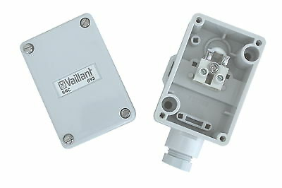

Dreadnaught Posted November 24, 2021 Posted November 24, 2021 Next I will be putting on the external cladding of my timber frame (Cedral Lap planks). Beforehand I am looking at all the penetrations through the exterior wall. One penetration is the wire for the ASHP controller's weather-compensation sensor (see image below of the sensor). The manual says "Connection wire is 2 x 0.75 mm²".Google says this is "2192Y" wire, which seems to be a common type cheaply available from Screwfix, etc. Should I … just buy a roll of that wire? install it through the wall with a loop outside and a longer loop inside? Should I use a cover plate (see below in orange)? Or instead just slope the penetration downwards and back fill with silicon? This is my first bit of "wiring" so would appreciate any advice and suggestions.
markc Posted November 24, 2021 Posted November 24, 2021 (edited) Cheap as chips at SF and comes in handy for lighting. slope hole downhill towards outside and form a drip loop unless going downhill once outside. wouldn't bother with the cover Edited November 24, 2021 by markc
ProDave Posted November 24, 2021 Posted November 24, 2021 I would drill a small hole in the back of the box and place it directly over the cable exit so there is no visible loop. A squirt of your favourite sealant to seal the hole. And a blank in the bottom in place of the stuffing gland. 1

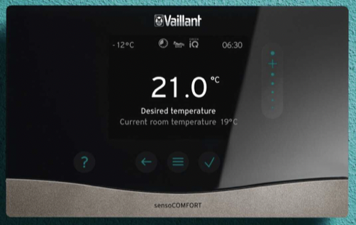

Dreadnaught Posted November 24, 2021 Author Posted November 24, 2021 I don't have any details about the weather compensation, other than: "sensoCOMFORT comes with an outdoor sensor which provides an understanding of the thermal behaviour in and around the property and adjusts the flow temperatures to ensure optimal efficiency". Oh, and it has a pretty LCD screen so it so it must be good. 2
J1mbo Posted November 24, 2021 Posted November 24, 2021 It works a treat. Takes a while to get get the curve and offset really dialled in in my experience. 1
Nickfromwales Posted November 24, 2021 Posted November 24, 2021 2 minutes ago, J1mbo said: It works a treat. Takes a while to get get the curve and offset really dialled in in my experience. Yup. I spent 2 days back and forth ( at my expense ) trying to get the curve right. Vaillants own tech guy just told me to ramp it up and walk away or I’d be there forever…… OK if it’s your own system and you can give up the time necessary. I still doubt it’ll make a hot of difference in a well insulated / high performing dwelling. Definitely a place for it in lesser energy efficient builds / commercial, but when a property loses 2oC over 24 hours then you have to ask why you bothered…..
Dreadnaught Posted November 24, 2021 Author Posted November 24, 2021 39 minutes ago, Nickfromwales said: OK if it’s your own system and you can give up the time necessary. Yes, I would be happy to tinker over weeks or months. 37 minutes ago, Nickfromwales said: I still doubt it’ll make a hot of difference in a well insulated / high performing dwelling. What is the alternative? I wonder how else one could attempt to put the right amount of energy in to the house over a 24h period to maintain the temperature at an approximately constant level while the weather varies? I think @TerryE has a custom computer algorithm to do it linked to a weather forecast. But that's the only alternative I can recall.

J1mbo Posted November 25, 2021 Posted November 25, 2021 @Dreadnaught the Vaillant controller is more than just a thermostat - it also applies the internal room temperature to the flow temperature target calculation (when set to do so) and can self-learn to an extent the heating curve. The room temperature based adjustment shifts the configured curve up and down as a whole. Basically you want this in the coolest place of the house to provide the most responsive system. Ambisense can be added to it to have additional sensors and electronic TRVs around the place, but regardless of the inputs from those other sensors the control panel sensor will be used for flow temperature adjustment. Tuning the curve does however take ages and it is quite surprising in my case the result. 1970s house, CWI and double-glazed with radiators sized for 50°C flow. Five persons and to be fair quite high electrical load, 8MWh pa (computers!). But the curve has ended up being 0.65 with a floor of 28°C. It has taken a full year to dial this in. Based on my models the HP should be within 15% of rated SCOP this year. Since it has both 4-pipe buffer tank and a heat exchanger, I'm quite happy with that. Mid-season, the heat pump modulation ratios aren't as much as it appears because it recovers so much from outside. i.e. 30% compressor still gives maybe 60% rated output when it's about 12°C outside. So it will overshoot then shutdown then repeat; a lot of water is needed to slow this down. @ProDave To get anywhere close to the rated SCOP, the weather compensation is definitely required. Perhaps with UFH where the design flow is 35°C it is less important though. 1 1

Dreadnaught Posted November 25, 2021 Author Posted November 25, 2021 (edited) Thanks @J1mbo. Your experience of living with the system is very helpful and encouraging. 26 minutes ago, J1mbo said: Basically you want this in the coolest place of the house to provide the most responsive system. That's interesting. In my case, that the coldest room in the house will be the Utility Room. We have laid the UFH so that the supply runs that traverse under the Utility Room are insulated. The Utility Room will only receive heating from the (depleted) UFH pipes that return from the large main Living / Dining / Kitchen area. Mine will be a pretty well-insulated and airtight house with MVHR so I expect that all rooms within the thermal envelope will be similar in temperature. Would the Utility Room be a good location for the Vaillant controller? It was actually where I was planning to put it anyway, to hide all such gubbins. Edited November 25, 2021 by Dreadnaught

J1mbo Posted November 25, 2021 Posted November 25, 2021 @Dreadnaught If you're running wires for this, I would consider giving yourself a couple of options for the controller. I started with the controller in the utility but later moved it to the lounge as it happens. It connects over eBus and needs to be cited clear of thermal influence such as direct sun, heat from the ASHP system itself, and so on. The outdoor sensor needs to connect to the heat-pump interface (the brains of the whole system, and also the wiring centre for the 3-port valve, sensors, eBus etc), as does the VF1 buffer tank sensor and the DHW cylinder sensor, if you are having one. On that, the ASHP will be cheaper to run than using E7 and resistive heating for DHW. You can of course use the ASHP on E7 to heat the cylinder really hot at a COP of >1. I get about 2, heating it to 65°C. It can achieve much more at lower set points, the issue being that it needs to stop heating the house to heat the water so I 'charge up' the tank overnight to avoid it doing DHW in the day. With the thermal mass of UFH, that probably is much less noticeable. Re zones. Bear in mind that the system needs a lot of water circulating to avoid overshoot. In other words the more zoning in place the larger the buffer tank needed. Different rooms obviously have different external thermal influences (e.g. sunshine, cooking, electronic equipment, log burners even) so it's always going to be something of a compromise between adequate heat, lowest running cost, and quickest response. Incidentally I added Ambisense mainly for the data (VR920 internet gateway and the app gives hours insight of energy consumption, environmental yield etc) as well as push alerts to any system issues. It also provides eTRVs which I have just three of to enable 'steering' of heat between parts of the house as the sun moves around basically.

TonyT Posted November 26, 2021 Posted November 26, 2021 Very difficult to retro fit an external air sensor, so I would throw in a cable even if it want needed, small junction box to make it look good, and cable marked up at boiler. 1 1
