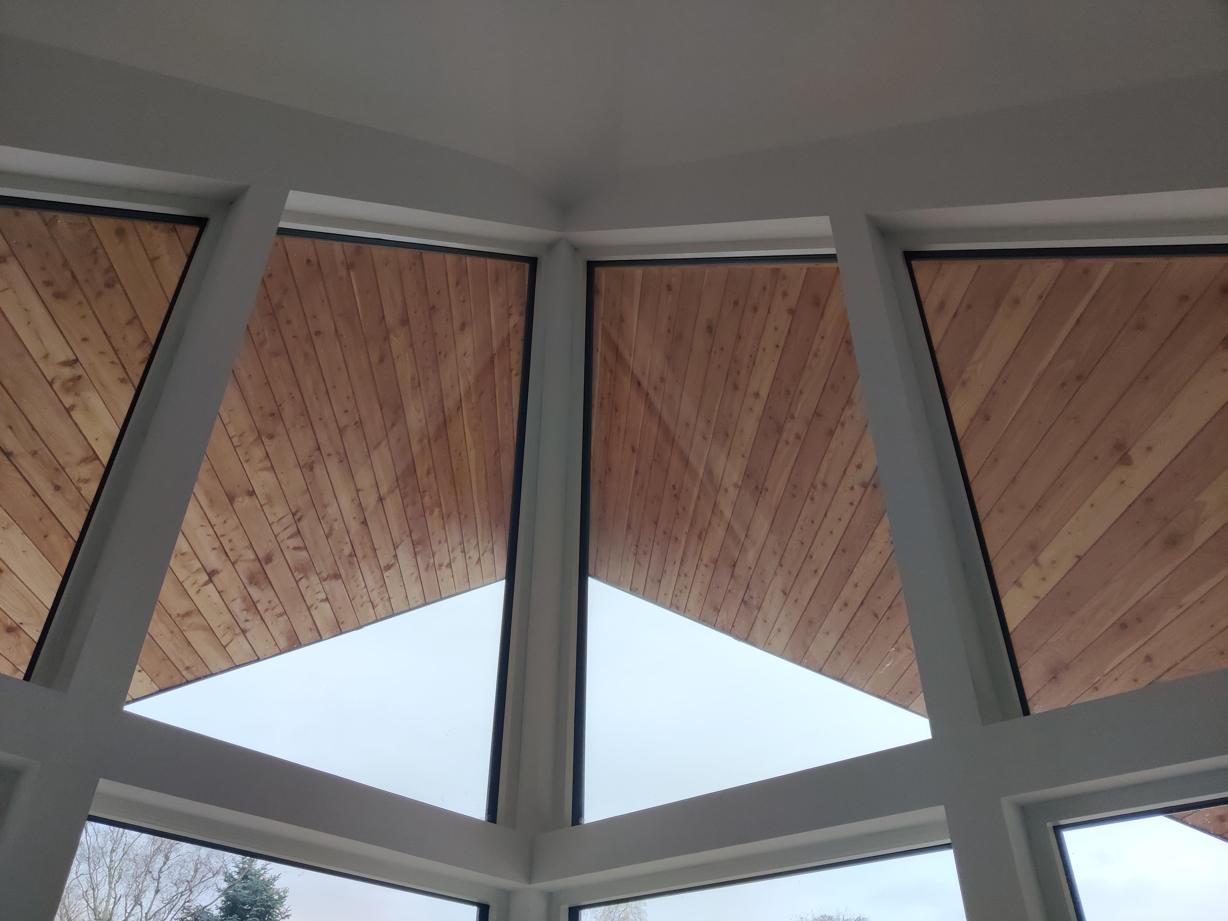

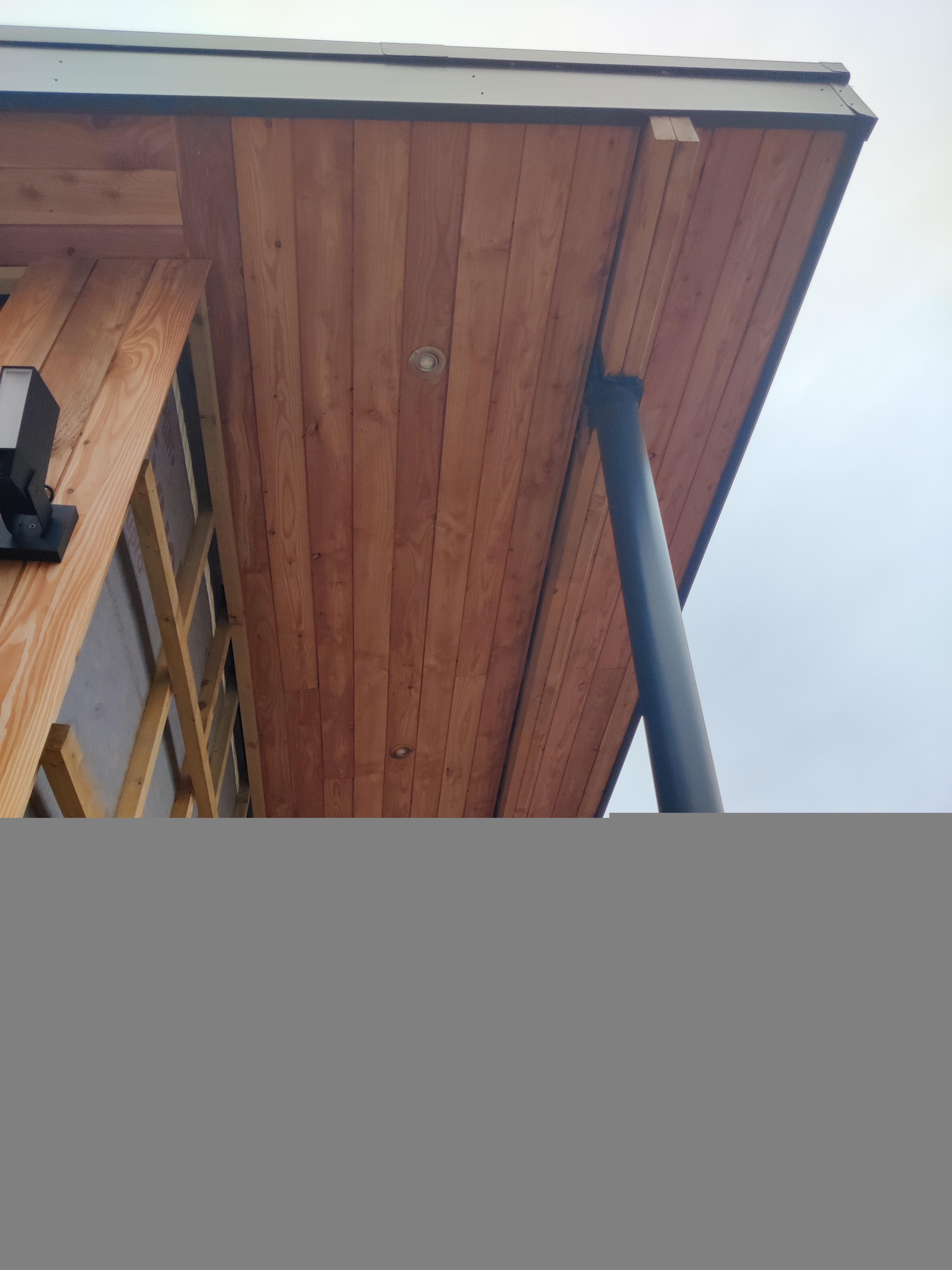

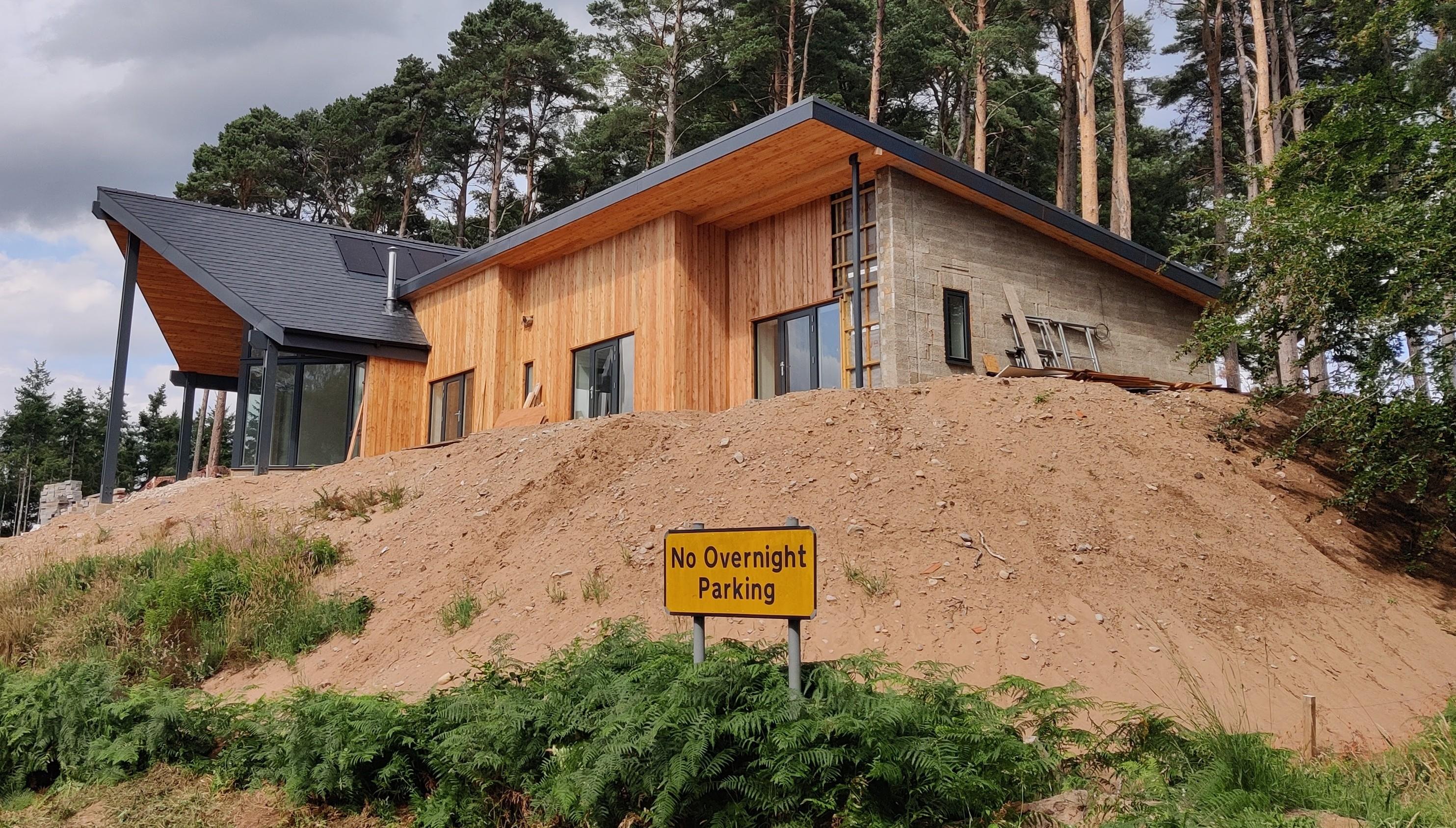

SuperJohnG Posted November 12, 2021 Author Posted November 12, 2021 2 hours ago, JohnMo said: Why not Scottish larch, lower shipping costs, buy straight from the mill, much more stable prices. @JohnMo I think I had bypassed as it was all rough sawn more suited to board on board wall cladding, but I do actually prefer that colour as its closer to the red cedar look I wanted..I also notice you have it in your canopy, do you have any pictures of that? Also where did you get yours?
saveasteading Posted November 12, 2021 Posted November 12, 2021 2 hours ago, JohnMo said: Why not Scottish larch Because they are charging what they can, quite reasonably. I went to a small mill and they gave me a m3 price, but fairly said I would get standard timber cheaper at the merchants. JohnMo, that is beautiful. Are you letting it fade to dull grey, or staining it to keep the colour?
JohnMo Posted November 12, 2021 Posted November 12, 2021 Going to be doing a UV protection to keep colour. Just need to find the time
JohnMo Posted November 13, 2021 Posted November 13, 2021 14 hours ago, SuperJohnG said: @JohnMo I think I had bypassed as it was all rough sawn more suited to board on board wall cladding, but I do actually prefer that colour as its closer to the red cedar look I wanted..I also notice you have it in your canopy, do you have any pictures of that? Also where did you get yours? 1
SuperJohnG Posted November 13, 2021 Author Posted November 13, 2021 3 hours ago, JohnMo said: Looks good. Is it tongue tongue groove V joint? I just always assumed scottish larchnfor soe reason was just boards.

saveasteading Posted November 13, 2021 Posted November 13, 2021 19 hours ago, JohnMo said: a UV protection to keep colour Do it soon as fading starts immediately. At least the south facing as a priority. I would give it a month of dry weather to move and shrink, otherwise there will be some gaps at joints. I'm assuming this is straight from the mill and not kiln dried, and even that shrinks in my experience. I didn't get any suggestion of any discount from that supplier, but their usp is any timber size to order.
JohnMo Posted November 13, 2021 Posted November 13, 2021 Not greyed so far, overhangs were mostly completed in March, the rest finished in August, will get the last bits completed in the next couple of weeks. It wasn't kiln dried.
