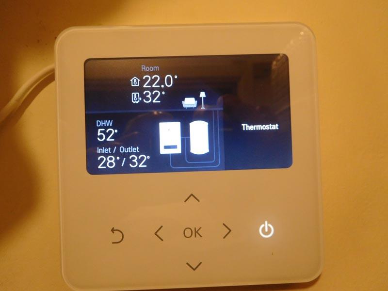

The display appears to indicate that the system is working with 32°C flow (and 28°C return). This would tend to suggest that weather compensation is enabled and, given the difference across the heat pump, that the radiator circuit pump speed is perhaps a little low as the difference of 4K (assuming the radiator circuit is balanced) would be more when the radiators are hotter (i.e. when it's colder). The display also shows room temperature of 22°C. Some controllers will use this additional data point to further adjust the flow temperature, which increases comfort by reducing overshoot, reduces cost by further reducing flow temperature when possible to do so, and increases system responsiveness by increasing flow temperature when there is a large difference between the current and target room air temperatures.

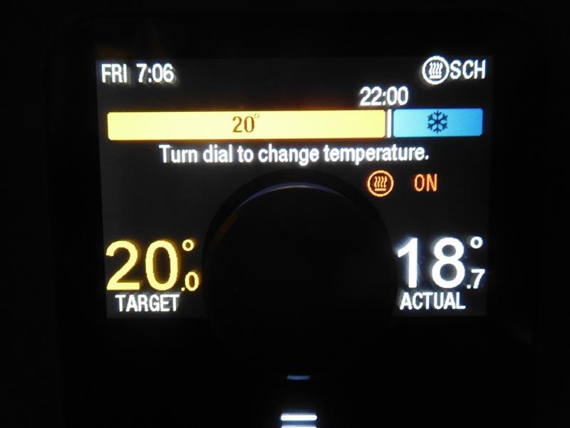

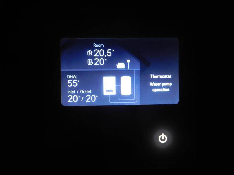

Here are images of the LG 'remote controller' and the Hive thermostat at start-up this morning.

ProDave: I am not fussed by the temperature of the radiators; it is the overall ambient temperature in the house that interests me. My only way currently of assessing this is to note the temperature recorded on the Hive thermostat.

J1mbo - after several readings I feel I have a slightly better grasp on some of what you have written. [Slow learner here etc.] I already have something called 'The Owner's and Installation Manual' which bears little relation to the manual whose link you sent. The latter looks much more like 'the bizniz.' My 'manual' consists of 16 pages of English text repeated [presumably] 34 other foreign languages, including some I have never heard of. Hands up who speaks Srpski [is this Serbian?] or Shqip ! Anyway, thanks for the grown-up's manual most of which is beyond my comprehension.
The next problem is the password for the LG Remote Controller. In my case it is not 1001 nor any other obvious possibility so I have contacted the installer for my password.
See here at 1m34s - LG Therma V R32 Monobloc Heat pump | Installer Setting Guide - YouTube Could still be the software version number.

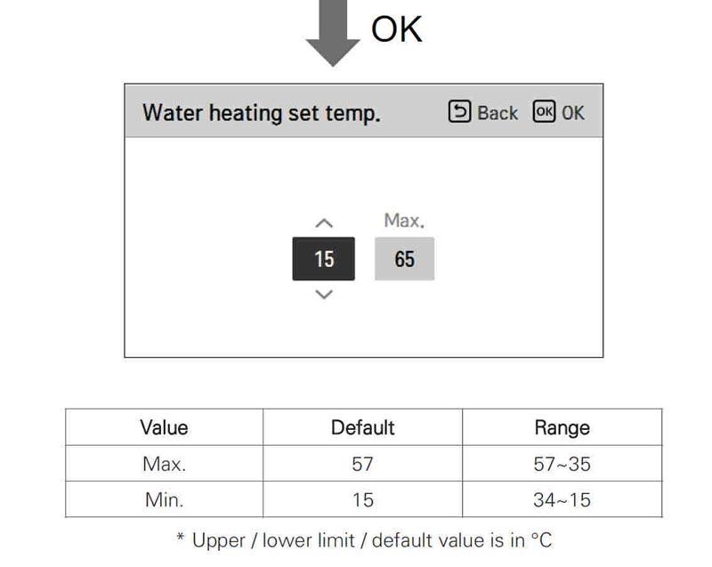

Take a look at page 99, water heating temperatures. Maybe that's all that needs to be adjusted (min/max).
Brilliant! Many thanks J1mbo. Password is the default software number displayed bottom right. [I suppose I might as well let the installer know while I'm at it!] I'll have a good old rummage and see what is what and take note, as you suggested, of anything I change.

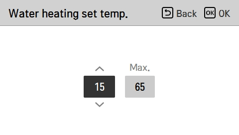

Your brought my attention in particular to page 99 [INSTALLER > Water Heating set temp] as being possibly relevant to my problem. Page 99 has an image of the LG Control panel with min/max temperatures below in a table.
How is the max temperature of 65 set in the image whereas the range is stated as 57~35?

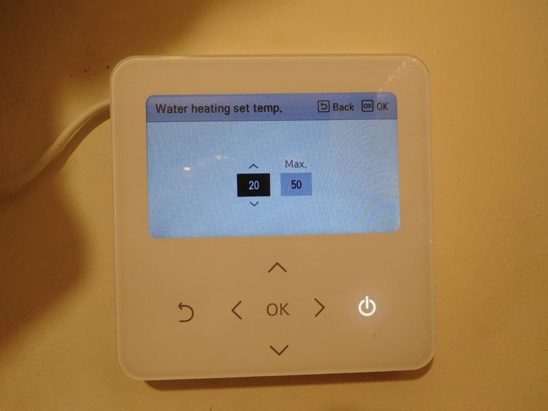

Great. Can you post what is currently listed for:
  • Temp. sensor selection
  • Pump frequency setting(RPM)
  • Heating only mode
  • Seasonal auto temp:
    • Outdoor 1, Heat
    • Outdoor 2, Heat
Re DHW: is the immersion is even connected to the heat pump? Or just straight to a switch in the usual way.
Based on my own system I'd be inclined to set min/max to 28°/55° but it's not clear to me how these settings interact with the seasonal auto-temp settings. Does 'Set Point 1' through 'Set Point 8' appear anywhere in the controller under/near seasonal settings?

My Installer settings differ somewhat from those in the manual you sent. For example the Pump Frequency settings (RPM) does not appear at all as  far as I can see on my control panel whereas in the manual it is immediately after CN_CC. So apart from confirming that the Temp. sensor selection = WATER I don't seem to have any of the info you request. Here, in case it helps, are the menu entries from my controller.

 I see nothing about seasonal settings anywhere, nor any ref to set points. As for your question about the immersion heater, how can I tell? [I am not a plumber ! which may or may not be reassuring.] But I have an image of the tank which may or may not enlighten you.
Let me know if you need another or different shot. Many thanks for your help thus far.
@Hogboon - I've looked at some older threads and I think figured out the weather compensation settings. See here.
  • Outdoor temp for auto mode - this defines the ends of the slope. Set min to -1°C and max to 12°C.
  • LWT for auto mode - this defines the leaving water temperature, i.e. flow temperature, targets at the outside temperature points set above. Set min to 34°C and max to 55°C.
The logic is:
  • at or above the max outdoor temp of 12°C, the heat pump will use a target flow temperature of 34°C. This may be too high and could result in overshoot, but start here.
  • at or below the min outdoor temp of -1°C (usually the point at which the property heat loss will be calculated in the UK), the heat pump will use a target flow temperature of 55°C.
  • In between (i.e. -1°C to 12°C), the heat pump will chose a flow temperature between 34°C and 55°C based on a straight-line between the two points.
The question is then how to activate this automatic mode, if @ReedRichards is still reading this forum perhaps he/she might be able to comment. I think the internal controller should be put in 'auto' mode and the desired temperature range configured in 'Indoor temp for auto mode' - probably min 18°C max 24°C or something like that. I suspect that this range is then used to control the offset that can be configured in the controller, in my example it would allow -3°C to +3°C, corresponding to room temperature targets of 18 to 24.
Based on the photo of the controller earlier, you should be able to see pretty quickly what impact changes have. Inlet/Outlet were 28°C/32°C with a target (top of screen) of 32°C. That target, and after some time the outlet, should change according to what's been set and the outdoor temperature.
The final consideration is the Hive controller. I suspect this is a big part of the problem. Anything with a TPI program is unsuitable for a heat pump with weather compensation as the TPI program will introduce short-cycling by design, which is the worst possible operating condition for a heat pump. My advice would be to replace it with LG's native controls. However, for now, just set it to something really high like 30°C all the time which will effectively eliminate the TPI as the room temperature will be so far from the target and let the heat pump weather compensation control the living space.
I really hope this helps. Please do let me know how you get on.
Many thanks J1mbo for the homework and advice. I have every hope that tomorrow some of it will make sense! but right now I am the wrong side of a bottle to make head or tail of anything much. One thing I find very perplexing is just how complicated and poorly understood [or in my case not understood at all] is the efficient configuration and running of heatpumps. And yet they are going to be needed literally in their millions. Surely manufacturers have a duty to get the job right? and make what is required and what these machines are actually doing more transparent. Shan't drone on now, but thanks again and I'll let you know what if any progress I make.
