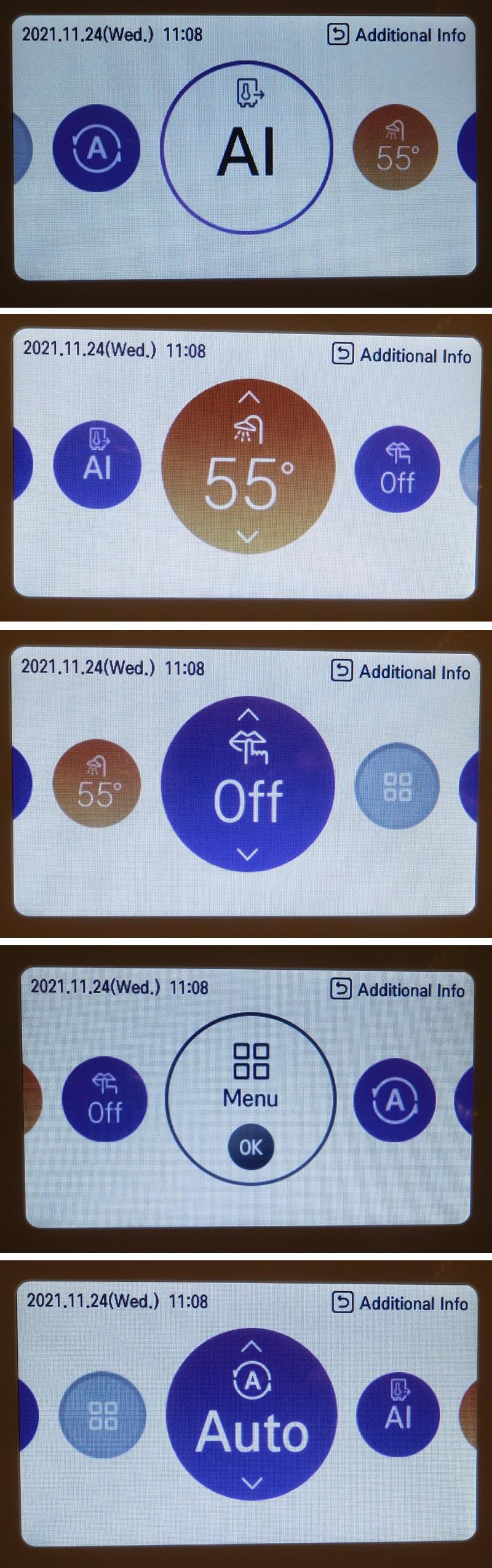

Re the performance. The controller needs to be in 'auto' mode and it should say auto on the screen I think, in order to use the configured automatic weather curve.
Cor blimey ! if that is allowed these p.c. days. It wasn't on 'auto' but now [09:00] is, and icons etc have gone a rather fetching purple which would impress my grand-daughter as it is currently her favourite colour. All other settings remain as before. Thanks for that J1mbo.

As mentioned previously, the menu options on my controller do not include one for 'Energy.' It sounds exactly the sort of thing that is needed so why it is not included on my controller when it is clearly described in the User's Manual is beyond me - like almost everything to do with heatpumps!  The only Menu options on my Controller are for Setting, Schedule, Lock and Timer. The Controller's 'Home' page [if that is what it is called] currently looks like the image below. Should anything there be tweaked? 'Intuitive' is clearly not in the South Korean lexicon.

I have only just found this thread but see here:
for how the Auto/AI mode works.  In my case (all radiators) the settings (as recommended to the installer) are:
Outdoor Temp for Auto Mode:  Min 5  Max 19
LWT for Auto Mode:                    Min 34 Max 50
So if the outdoor temperature is 5 C or less then the Auto mode does not operate and the leaving water temperature target will be 50 C.
By the way, my system has two pumps, one inside the Therma V and another for the central heating inside the airing cupboard.  The latter is not at its maximum output speed.
I had to tell my central heating controller that my heat pump was a oil boiler in order to prevent it from short-cycling.
