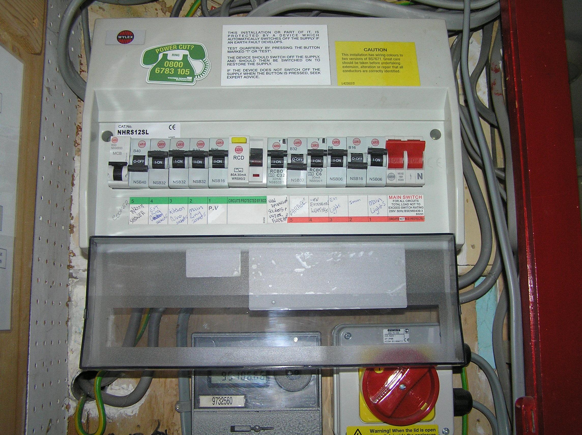

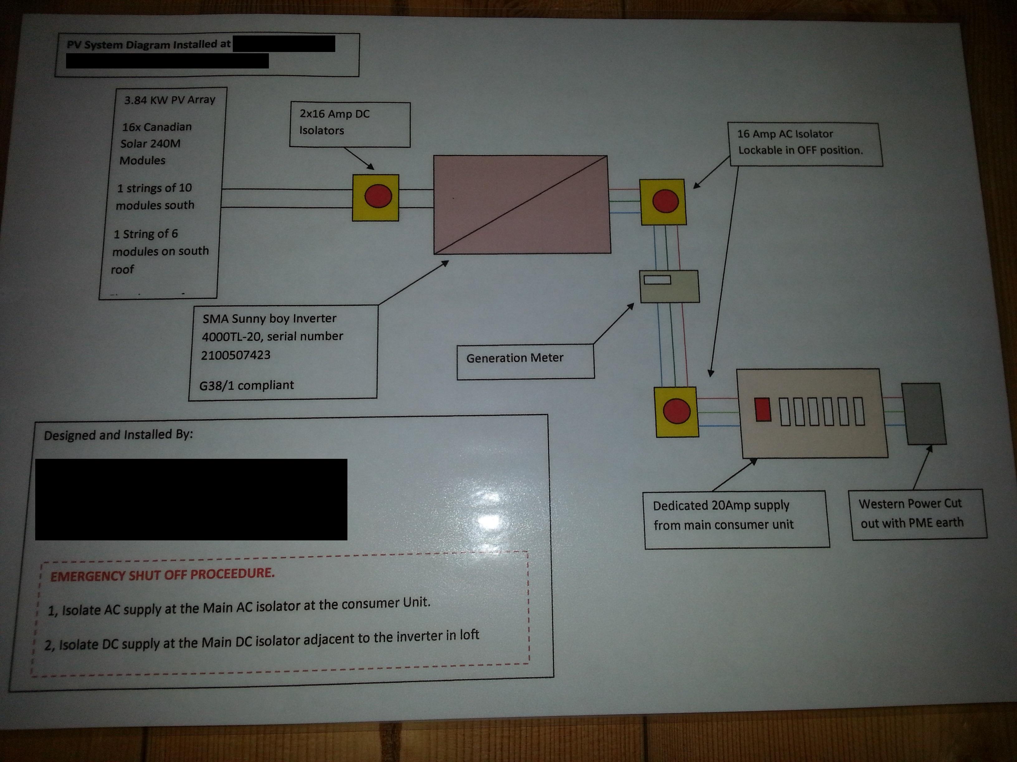

Gone West Posted November 2, 2021 Share Posted November 2, 2021 I've got a PV array on the roof, installed in 2012, and there is a 16A MCB in the CU labelled PV. Is it normal to have this arrangement and does it mean that only what is connected to that MCB can use power from the PVs and that if nothing is connected all the PV output goes to the grid. The PV diagram shows a dedicated PV circuit. Link to comment Share on other sites More sharing options...
Roys Posted November 2, 2021 Share Posted November 2, 2021 Couple of points from what I can see: Drawing says 20A supply yet your PV is on a 16A MCB, no big deal just a point. Not a fan on the PV being connected onto an RCD that feeds other circuits, as in my mind it will effect the disconnection times of the RCD in the event of a fault, you are not alone in the installation being done this way, it appeared to be a common way of doing it, I personally just don’t like it. Regards to what you are asking in your post, if you are using less energy than you are generating then the excess will go to grid. In my case the base load of my house without putting anything extra on is about 200W (router, digital clocks etc.) last week at any moment in time I was hardly generating more than 100W as it was so dull, so at no point was my generation greater than my usage. I have fitted a solar diverter so that if my generation is greater than usage the surplus goes to a heater in a north facing always cold room and not to grid. 1 Link to comment Share on other sites More sharing options...
Gone West Posted November 2, 2021 Author Share Posted November 2, 2021 1 hour ago, Roys said: Regards to what you are asking in your post, if you are using less energy than you are generating then the excess will go to grid. In my case the base load of my house without putting anything extra on is about 200W (router, digital clocks etc.) last week at any moment in time I was hardly generating more than 100W as it was so dull, so at no point was my generation greater than my usage. So I have to find what is at the other end of the PV MCB circuit, if anything, and then that will be solely using PV output I guess. If there is nothing connected to the PV MCB circuit how does the PV ouput get used by other stuff on other circuits. How is your solar diverter wired up. Link to comment Share on other sites More sharing options...
ProDave Posted November 2, 2021 Share Posted November 2, 2021 2 minutes ago, Gone West said: So I have to find what is at the other end of the PV MCB circuit, if anything, and then that will be solely using PV output I guess. If there is nothing connected to the PV MCB circuit how does the PV ouput get used by other stuff on other circuits. How is your solar diverter wired up. No it does not matter what circuit is drawing the load. It all gets sorted out by your electricity meter. That measures what enters (import) or what leaves (export) your house. So if the PV is generating more than the entire load in the house at any instance, then some will be exported. If the house is using more than the PV is generating at any instant, then some will be imported. The best way to self use as much as you can is use the large appliances (washing machine etc) in the middle of the day. Solar pv diverters automatically monitor import and export and send any surplus power to a dump load, typically your immersion heater to help with self usage. 1 Link to comment Share on other sites More sharing options...
Gone West Posted November 2, 2021 Author Share Posted November 2, 2021 2 minutes ago, ProDave said: No it does not matter what circuit is drawing the load. So how is the PV MCB circuit wired, is it only supplied by the PVs and therefore when they aren't producing there wouldn't be any power on that circuit? Link to comment Share on other sites More sharing options...
ProDave Posted November 2, 2021 Share Posted November 2, 2021 1 minute ago, Gone West said: So how is the PV MCB circuit wired, is it only supplied by the PVs and therefore when they aren't producing there wouldn't be any power on that circuit? Okay think of it as water. People find water easier to understand. So your PV is like a borehole, it is producing some water. All your "circuits" in the house are each using some water. You have mains water connected as well If your borehole (PV) is producing more water than all the circuits in the house are using, then you will export water to the mains. If your borehole (PV) is only producing a little bit of water, and the rest of the house is using lots of water you will import water from the mains. Link to comment Share on other sites More sharing options...
Gone West Posted November 2, 2021 Author Share Posted November 2, 2021 1 minute ago, ProDave said: People find water easier to understand. I'm not understanding, but is that because it's not really a dedicated PV circuit as stated on the drawing. I get what you're saying about the two supplies being lumped together but the drawing says it's a dedicated circuit which to me means a separate circuit isolated from the mains. I hope it's not really a dedicated PV circuit. Link to comment Share on other sites More sharing options...
ProDave Posted November 2, 2021 Share Posted November 2, 2021 No it's just another circuit, like lights are on one circuit, sockets on another etc but all connect to the same mains supply. Link to comment Share on other sites More sharing options...

billt Posted November 2, 2021 Share Posted November 2, 2021 1 hour ago, Gone West said: So how is the PV MCB circuit wired, is it only supplied by the PVs and therefore when they aren't producing there wouldn't be any power on that circuit? There will always be voltage on that circuit when the grid is connected and the breakers are closed, but no power will flow if the panels aren't producing (and there's nothing else connected). You're making the assumption that because it's called a circuit it is completely separate from the other circuits. It isn't. When all the breakers are on all the circuits are connected together, there is no electrical separation between them. The breakers are there for protecting individual circuits in the event of a fault and convenience for modifications/fault finding etc. 1 1 Link to comment Share on other sites More sharing options...

Gone West Posted November 3, 2021 Author Share Posted November 3, 2021 12 hours ago, joe90 said: Pete, my electrician is Solar qualified, does a lot round our area, can get you his number if you need it ? Thanks John, it's good to have recommended local trades. We're ok at the moment, I was just interested in why there was supposedly a dedicated PV circuit in the CU and apparently it isn't dedicated. 1 Link to comment Share on other sites More sharing options...
billt Posted November 3, 2021 Share Posted November 3, 2021 But it is dedicated. That circuit is intended for the connection of the PV inverter only, hence dedicated to the PV system. It's not electrically separate but it is functionally separate. 1 Link to comment Share on other sites More sharing options...
Gone West Posted November 3, 2021 Author Share Posted November 3, 2021 13 minutes ago, billt said: But it is dedicated. That circuit is intended for the connection of the PV inverter only, hence dedicated to the PV system. It's not electrically separate but it is functionally separate. Thanks, yes I understand that, it was the wording that I found confusing. The 'Dedicated 20A supply from main consumer unit' wording, as it said from CU not to CU. Link to comment Share on other sites More sharing options...
Wil Posted November 3, 2021 Share Posted November 3, 2021 The protective device (MCB in the CU) is protecting that dedicated cable and the inverter in the case of fault. Hence the supply is FROM the CU to the PV isolator whichever way the electrons are flowing. Think of it as all roads lead from London, despite being able to drive the other way and get there. When my PV isn't generating I see a tiny (2W) demand on my PV circuit which may just be noise or could be considered the parasitic load of the inverter. Hence when the PV is not producing power, that dedicated circuit is consuming a tiny amount of power from the mains. The 'dedicated' in solar circuits means 'only for the PV connection' not 'electrically separate' as others have explained above. You definitely still get first dibs on the energy produced before the excess gets exported. Now sit back and be smug about your FIT, some of us aren't so lucky! ? 1 Link to comment Share on other sites More sharing options...
