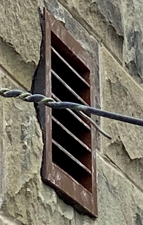

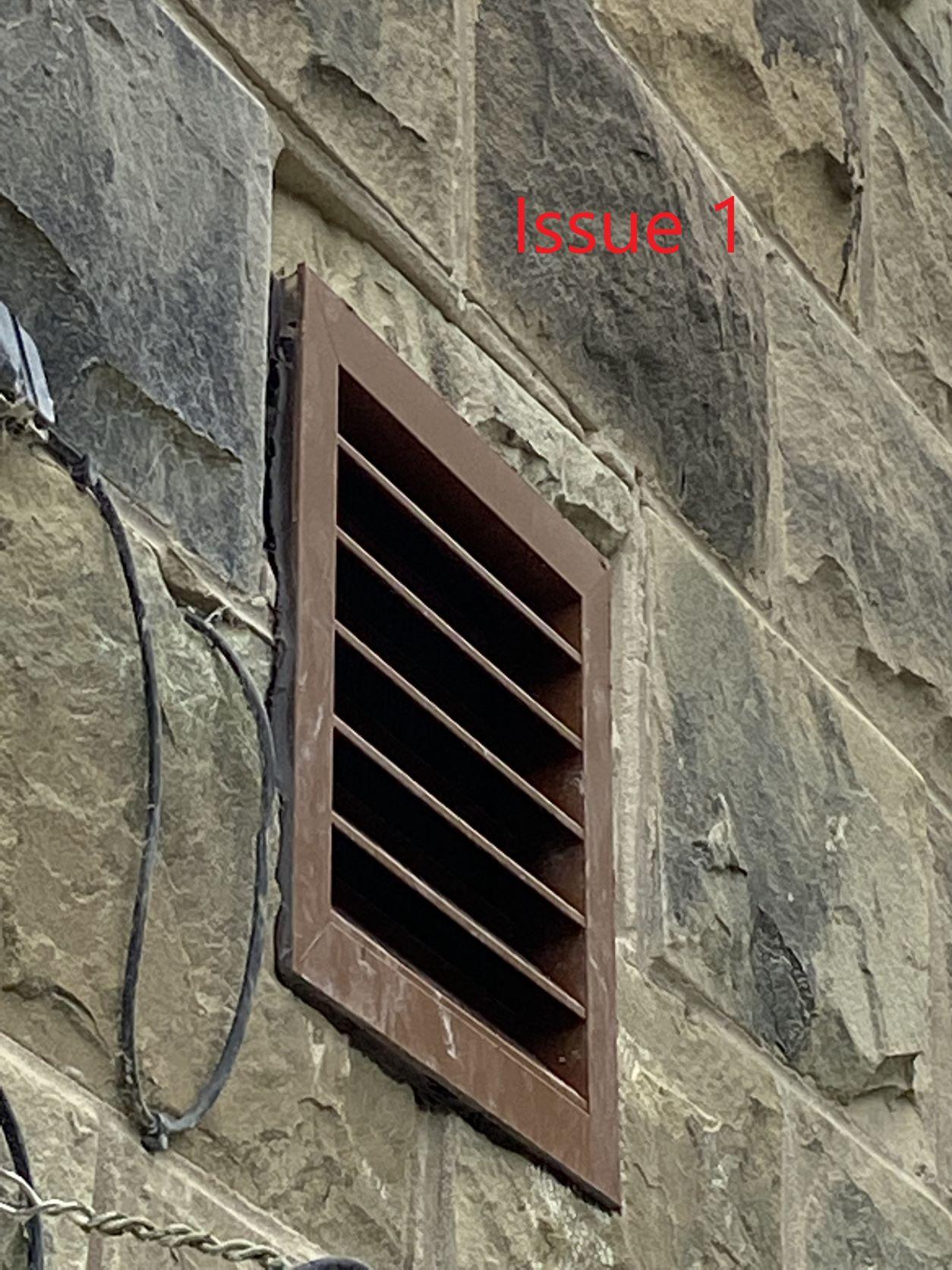

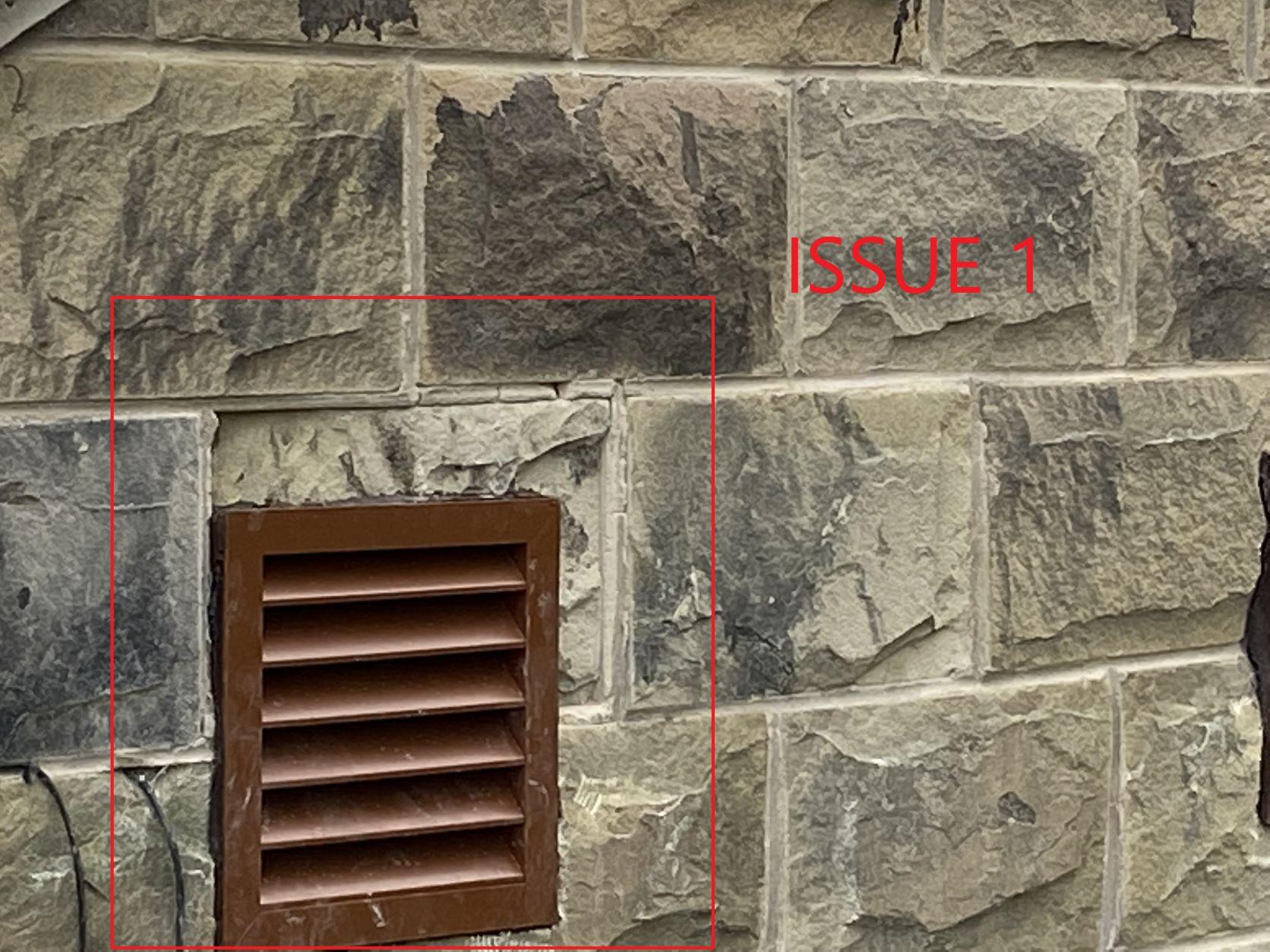

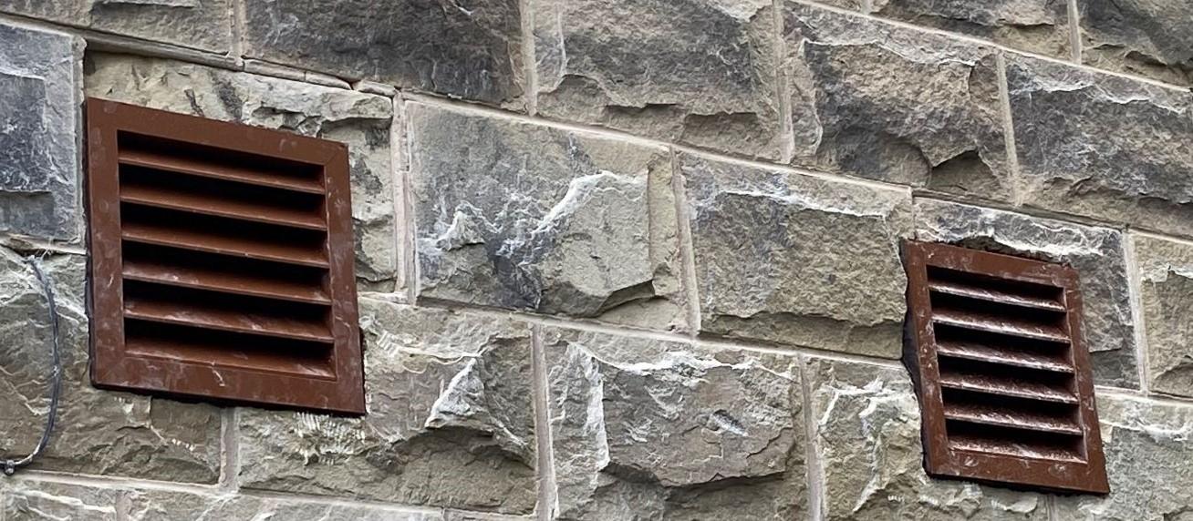

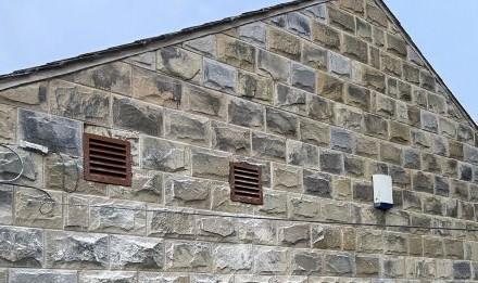

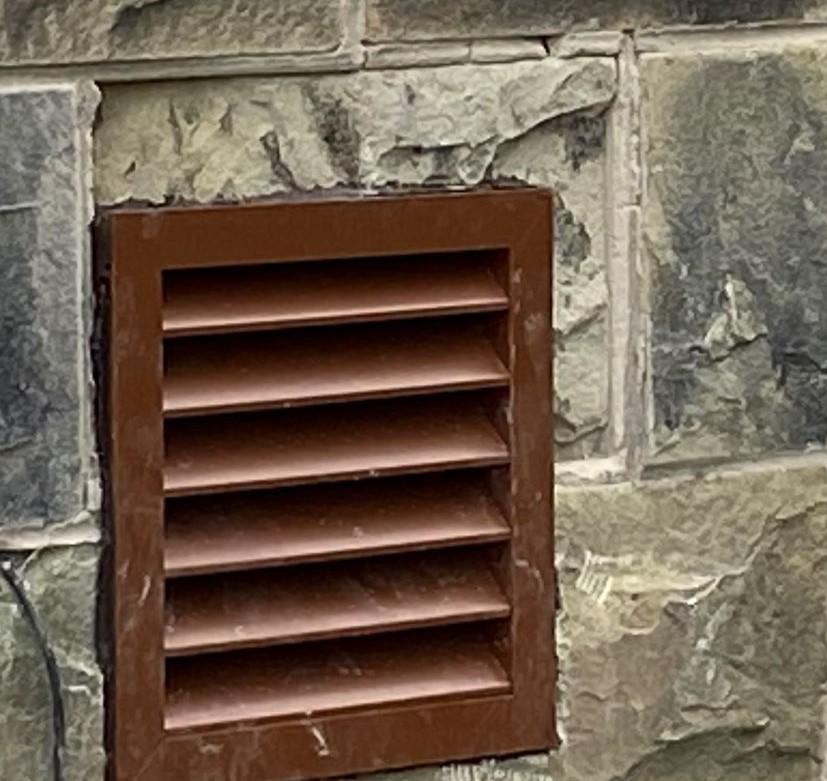

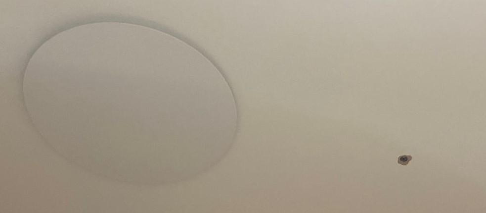

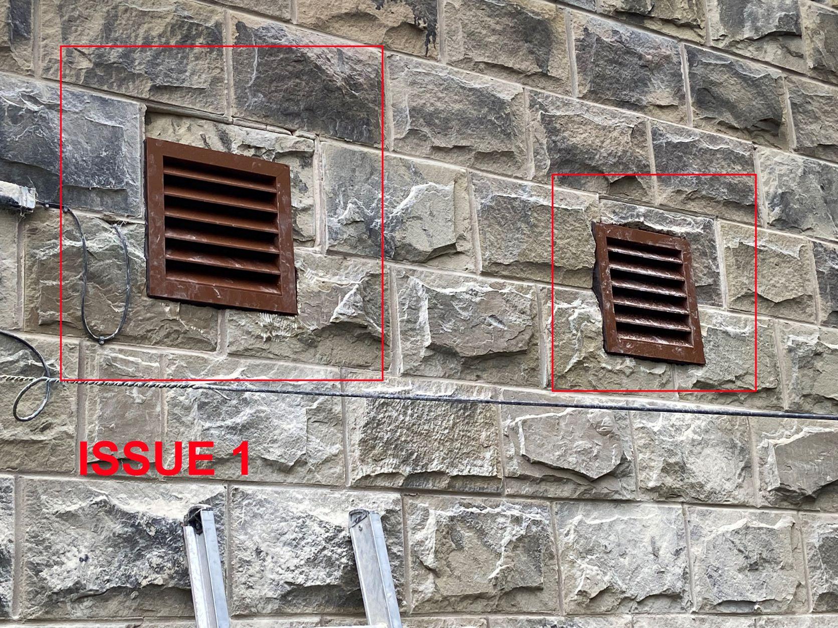

  1. Supply\Exhaust Vent boxes - The installers have damaged my Gable wall brick work whilst stitch drilling the stone for the vent boxes. Please refer to the "Issues 1" pictures below, you can see that above one vent too much has been taken off the stone and it is now holding water. The silicone seal has collapsed on both vent boxes.IMG_1423.thumb.JPG.abd5cab86393dd0c5c8ce09e14797d47.JPGIMG_1448.thumb.JPG.cf1f2f4e06108e422ae0e05fe55d9dc1.JPGIMG_1452.thumb.JPG.fbd00d62a7abe195af9d7f9d9b424103.JPG
  2. Ceiling plenum Installation - The ceiling plenums have not been fixed at both sides in the loft space, loose bits of wood have been wedged underneath adding weight on top of the boards. Please refer to "Issue 2" pictures below - the added weight has popped a screw and damaged my decorating in my bedroom.Capture.thumb.JPG.2f69851e23f0a0570609ab6b06bbe123.JPG

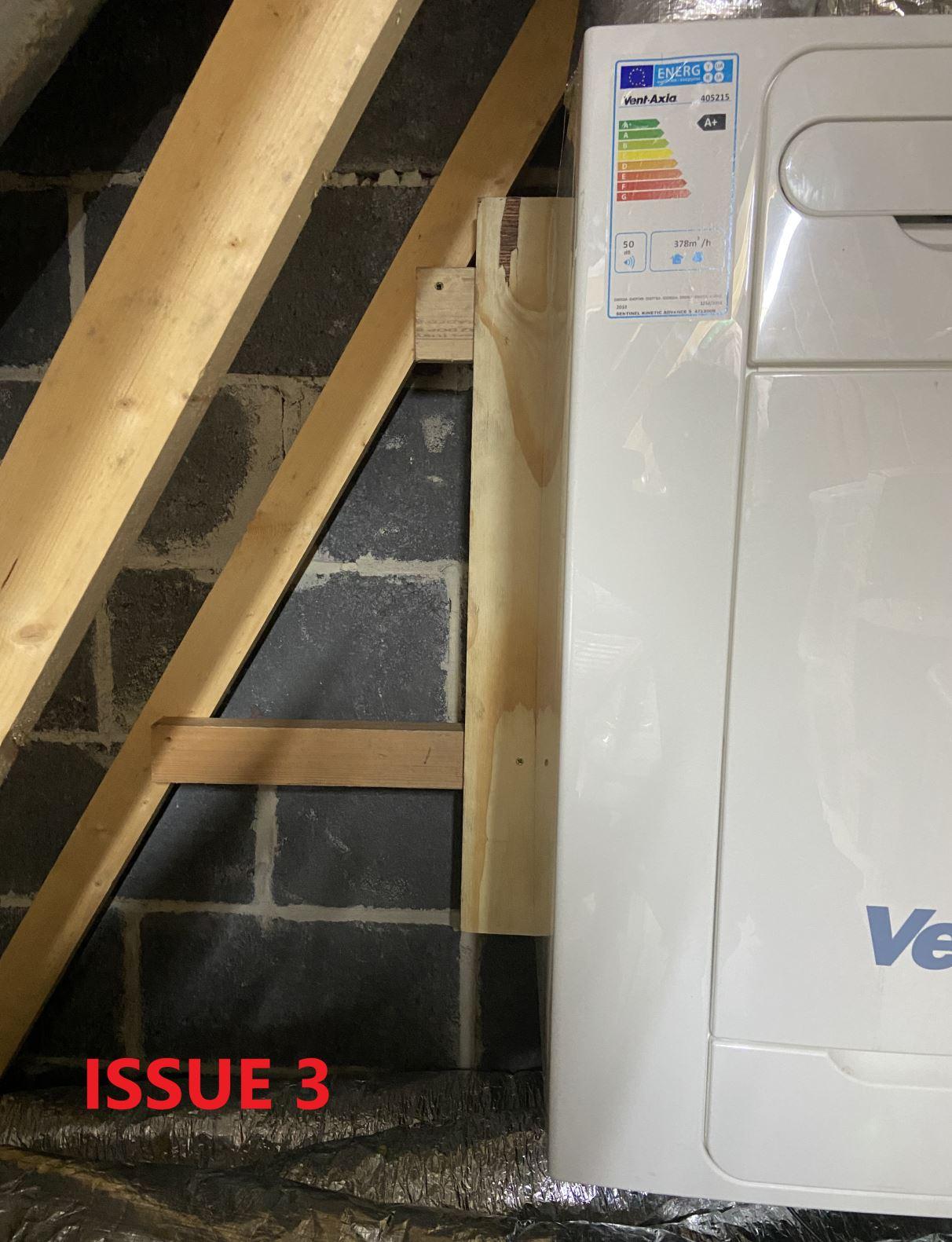

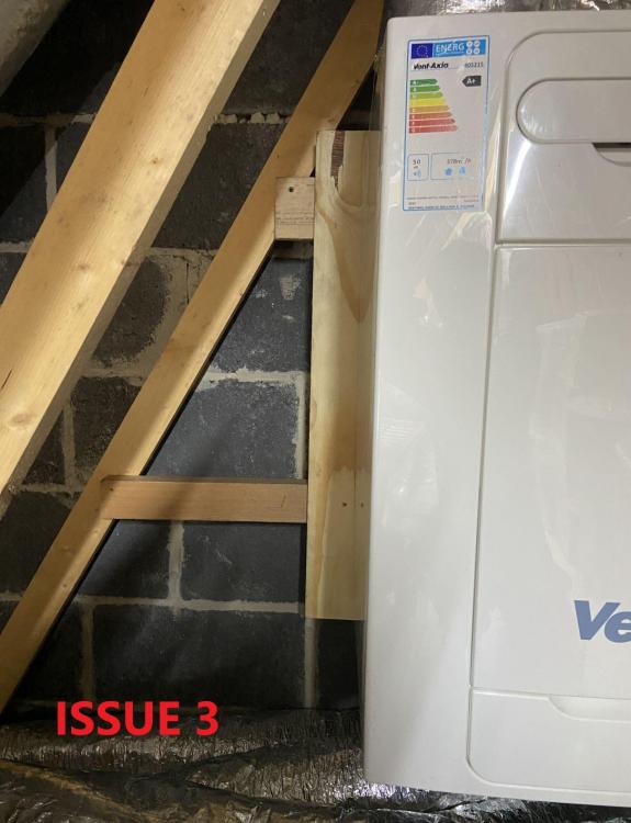

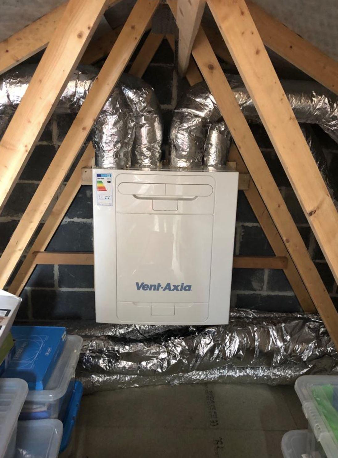

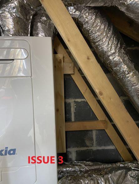

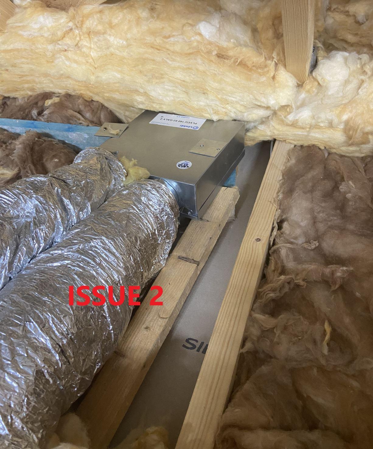

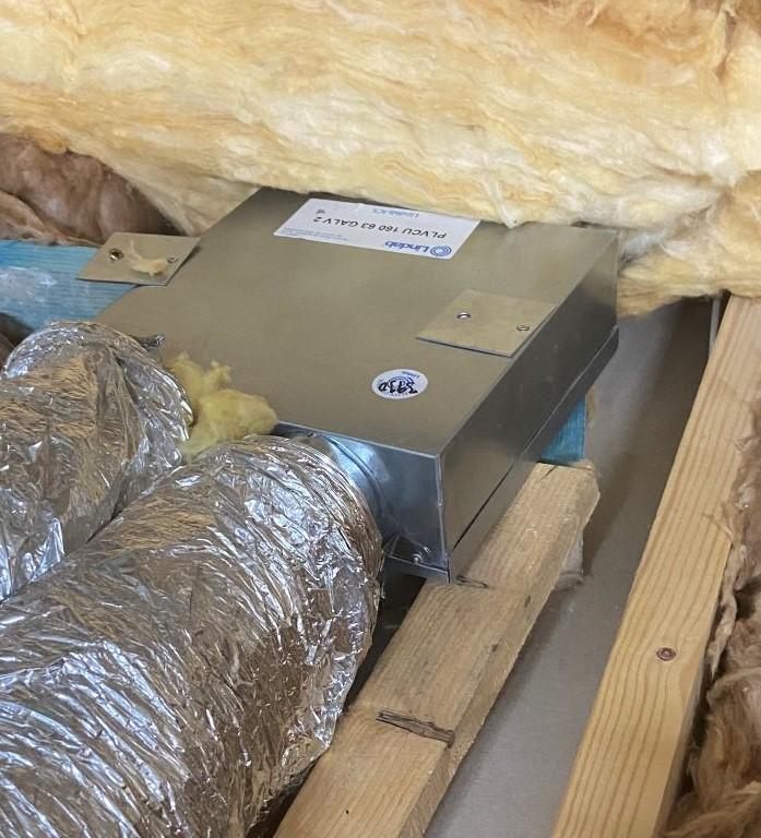

  3. MVHR System Unit Mounting - The MVHR unit itself has been mounted on my trusses. Please refer to "Issue 3" pictures below. The wood used seems to be too short with only one screw in each. I would of thought that high duty plywood board should be used and screwed multiple times to each trusses to reduce resonance. Capture3.thumb.JPG.bcfc126a3237c06ba413309ef6992349.JPGCapture99.JPG.eab66f83d59b39292e950184e1dace10.JPG
I have not yet paid for the installation and I would just like to seek help and advice from the experts to understand if my highlighted issues have substance and how they would compare to other professional installations. Since this is my first MVHR experience, I have no other situation to compare to nor do I have a view of the professional standards for a MVHR installation.

The installation issues look like fairly typical 'poor attention to detail' that go with many a tradesman that don't take pride in their work. It's the sort of thing that'd disappoint me but also the sort of thing that doesn't surprise me anymore (and what pushes me towards DIY).
Something to note is that if you fitted MVHR to help in the summer then I fear you'll be disappointed. That's not what it's for, and the low capacity of air coupled with relatively flow rates mean that it won't have much of a cooling effect. It can help with stuffiness though, and can help psychologically if you imagine it pumping in fresh air on hot still nights!
Edited by MJNewton
Poor job. As above, its the sort of job that makes you wish you'd had a crack at it yourself.  I'd have a chat with them and discuss your concerns; they're all valid.  I'd also want more separation between the vents - can't remember what the recommendation is, but worth checking before you part with any money. (And the plenum should be covered in insulation when they've finished).
Hi Nick, and welcome.
All the points you have made are valid. The only one they could argue is the 3rd. While the fixings do not look substantial enough, it hasn't failed (yet). But I wouldn't be happy with it.

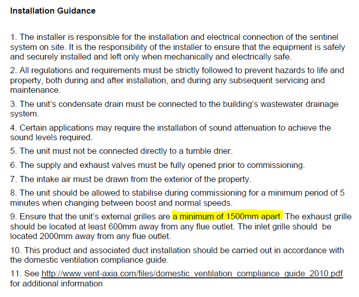

I have my exhaust and air inlet protruding out and not flush with the wall in my mvhr system.  Firstly, because of external wall insulation I have fitted and secondly, to ensure a proper seal against the brickwork.
Also, as mentioned up above, there is meant to be a minimum spacing between air in and exhaust out (1.5m) and also, I have mine at different elevations too.  You may have that spacing as its difficult to gauge on the photograph.
On the whole, it looks pretty shoddy to me and in particular that damage to the stonework.  If it was me - get them to extend it out further and then you would have had no stone damage.  The mvhr unit internally looks poorly installed too.  UK is getting worse for tradesman, so it is.

@IanR - thanks for the information, really useful. I have just measured the distance between the exhaust and intake vents and it is 0.9m, also the straight length ducting connected to the machine is 0.2m (see picture below).  :(

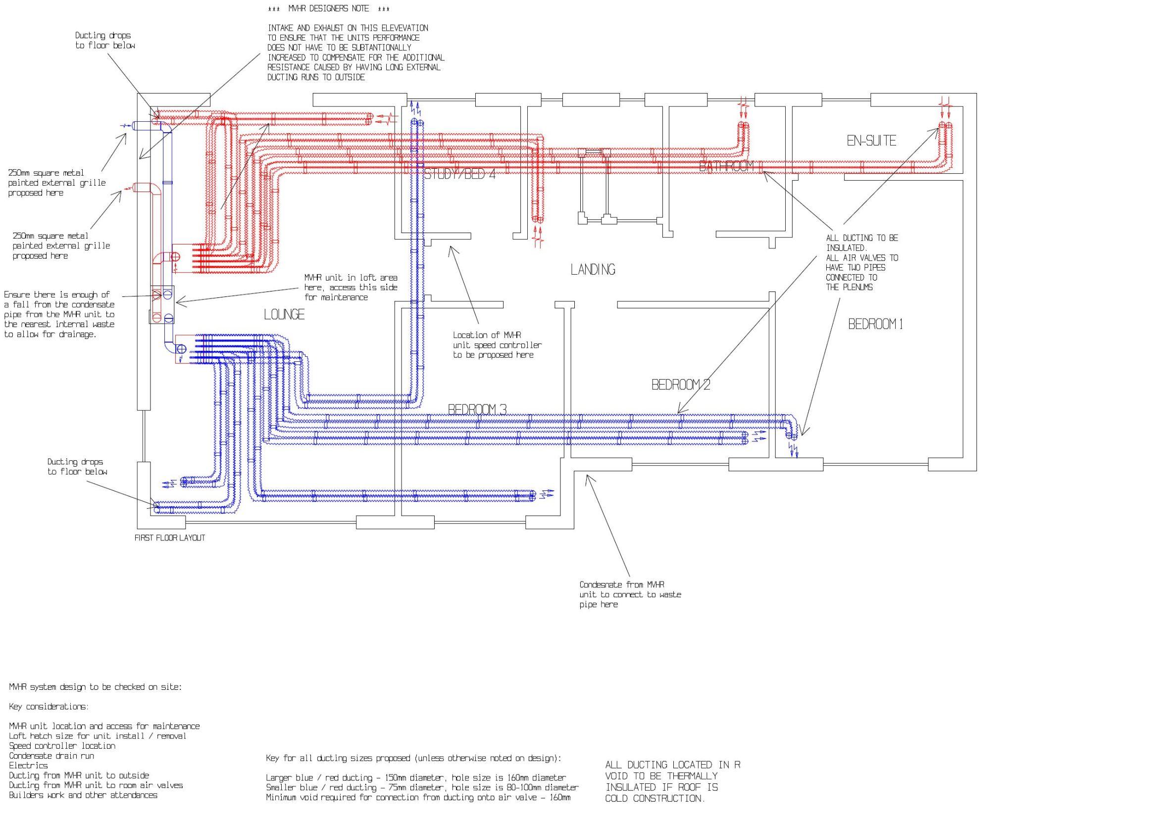

Sorry you've got these problems, but it looks like they need to start again really, as the warranty won't be valid if its not installed correctly.  Have they used that silver flexi duct throughout? Rigid or semi-rigid would be more usual.

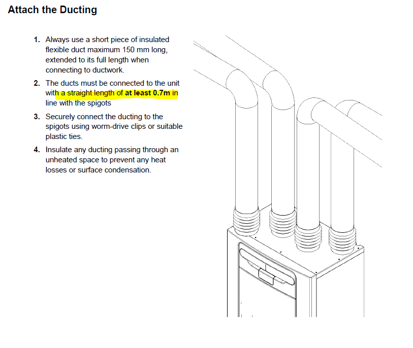

@Roundtuit - there is a mixture of ducting to be honest, all fully insulated. Let me share the design that the company did below; that being said it has not been followed to a tee.
Edited by Nickw1982

I would like thank everybody for your help and supporting comments. Based on your feedback, I sent the MVHR company the below email and attachments on the 25th October 2021. Today, 17 days later, I received their response and I will post a sanitised version below this post and would appreciate once again your valuable feedback :) ..... I don't think its much to ask for things to be done correctly by the professionals :(
---------- Email Start-----------
I would like to make you aware of my disappointment and dissatisfaction regarding the installation of a MVHR system at my property by XXXXXX which took place over the 19th & 20th of October 2021. Due to the long lead time on materials and prior site visits, I would have expected that there was enough time to thoroughly plan my installation to ensure a high quality installation. However, there are multiple major issues and I have now had the time to seek independent advice to which I would request your written response on the points raised below. I have attached a copy of the Vent-Axia Sentinal Kinetic Advance Installation and commissioning manual for your reference.
1.      Supply\Exhaust External Grille boxes (see attached pictures with prefix 1)
                             i.           The installers have damaged my gable wall work whilst stitch drilling and chiselling the stone. The stone has been over chiselled above one box exposing the inner and creating an area that will hold water. This will accelerate weathering and the wall area will weaken over time. My builder has advised that this stone needs replacing as soon as possible. There is also cracking around both grille box areas and the silicone used to seal both grilles has collapsed allowing water to penetrate.
                            ii.           The grille boxes are not installed as per the manufacturer’s installation and commissioning manual which clearly stipulates on page 3, point 9 that the external grille boxes should be a minimum of 1500mm apart. I have measured mine and they are 900mm apart.
2.      MVHR System Unit Mounting (see attached pictures with prefix 2)
                             i.           The MVHR unit has not been mounted as per the manufacturer’s installation and commissioning manual which clearly stipulates page 16, point 2 that there should be a minimum of at least 0.7m of straight pipe in line with the spigots. I have measured mine and there is 0.2m of straight pipe connected to the unit. There is also 0.6m space underneath the unit.
                            ii.           The unit has not been mounted as per our agreement using the plywood board. It still exists on the short wood with single screws.

I couldn't resist reading the compliance guide, and am not really seeing much relevance in it to be honest so it'll be interesting to see what bits they going to be relying on.
Indeed, the only relevant bit I did spot was a piece of rope which might end up being used to hang them:
Regarding location of exhaust vents, Table 7.0 Section 5c says 'The location of the external discharge terminal should ensure that the potential for recirculation of extract air through the supply air inlet is minimised.' and that is surely exactly why Vent Axia suggest a minimum separation of 1500mm (if not, what is the reason for it?).
Yes @Nickw1982 the external stone is a great shame and needs sorting but not before altering the distance between the inlet and outlet.
Got a bit bored reading their response tbh.  Looks like a 'holding' position whilst they decide what to do, with nothing of substance.  They are
probably just buying some time trying to find a way to get their ass off the line.  The installation problems aren't going to go away on their own and aren't really subjective, so I think you're in a strong position to get it sorted.  It'll be interesting to see what Vent Axia say.
Appreciate your response and reading - I was also drawn to the same table, i believe they have used this document to highlight the associated Supplementary Information in this table 7.0 Section 5c. Where it states that a minimum of 300mm horizontal distance is required.
That said, I have requested that they seek a formal response\statement from the Vent Axia business for the points raised. Let's see what they come back with ?
I would look at it that the install needs to meet both the 10 year old HM Government guide AND the manufacturer's installation requirements.
If one is stating a minimum 300mm separation, and another stating a minimum 1.5m separation, then the install must have 1.5m Min separation to meet all requirements.
