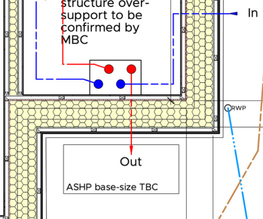

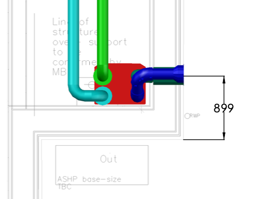

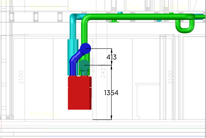

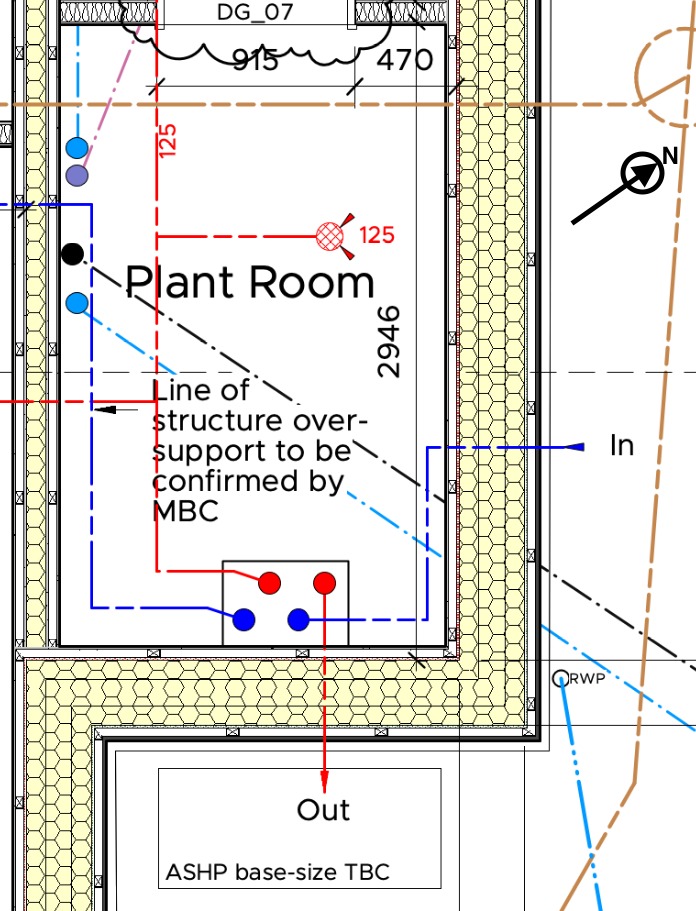

zzPaulzz Posted January 7 Posted January 7 I hope people don't mind if I resurrect this thread? I'm advised by a well-known MVHR supplier to place my intake and extract pipes vertically aligned with a 413mm separation, and to use the vent grill louvres to separate the airflows. I don't have a space problem as you can see blow. The Zehnder ComfoAir installation guide recommends a minimum of separation of 1.5m so I had intended to separate the vents using the corner of my plant room, and extract over the ASHP to gain a little efficiency from the slightly warmer air. Any thoughts on the merits of the vertical layout? My original plan MVHR designer's recommendation
FarmerN Posted January 7 Posted January 7 On 07/01/2025 at 09:20, zzPaulzz said: I I had intended to separate the vents using the corner of my plant room, and extract over the ASHP to gain a little efficiency from the slightly warmer air. Any thoughts on the merits of the vertical layout? Expand As stated in earlier posts, I thought there was some merit in having them on the same facade so as to avoid wind pressure differences between intake and exhaust . I’m certainly no expert.

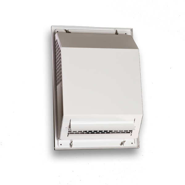

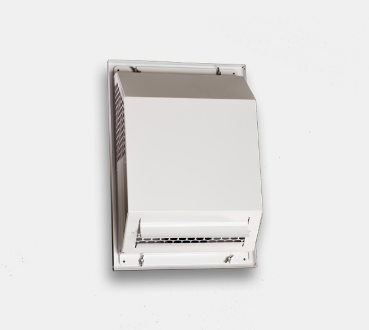

JohnMo Posted January 7 Posted January 7 I just use a combined inlet outlet grill, so inlet and out are separated by about 50mm. Works great no min spacing required. Various sizes available https://www.paulheatrecovery.co.uk/product/directional-external-combi-grille-for-mvhr/
Tony L Posted January 7 Posted January 7 On 07/01/2025 at 09:52, FarmerN said: As stated in earlier posts, I thought there was some merit in having them on the same facade so as to avoid wind pressure differences between intake and exhaust . I’m certainly no expert. Expand Ah right. Thanks for answering the question I had in my mind since reading the first post, above. That's given me something to think about. I was planning for my inlet to come through my west facing wall, which will always be in the shade & will be close to the main MVHR unit, & I was going to route my outlet through 5-6 metres of ceiling then down the south facing wall & out, level with the back of the ASHP. Now I'm wondering how much sub-optimal performance I might notice. Both south & west walls are well sheltered by trees and a tall boundary fence, so unless somebody manages to persuade me I've got this badly wrong, I think I'm going to stick with this plan & I'll monitor the system on windy days.
Nickfromwales Posted January 7 Posted January 7 On 07/01/2025 at 09:52, FarmerN said: As stated in earlier posts, I thought there was some merit in having them on the same facade so as to avoid wind pressure differences between intake and exhaust . I’m certainly no expert. Expand Plus one for that. TBH there is zero benefit in facing the extract, as it would need to be ducted to the ASHP inlet to have any effect. That tiny bit of heat energy will be lost to atmosphere the second it hits outdoor air temps. Keep them on the same elevation for sure
