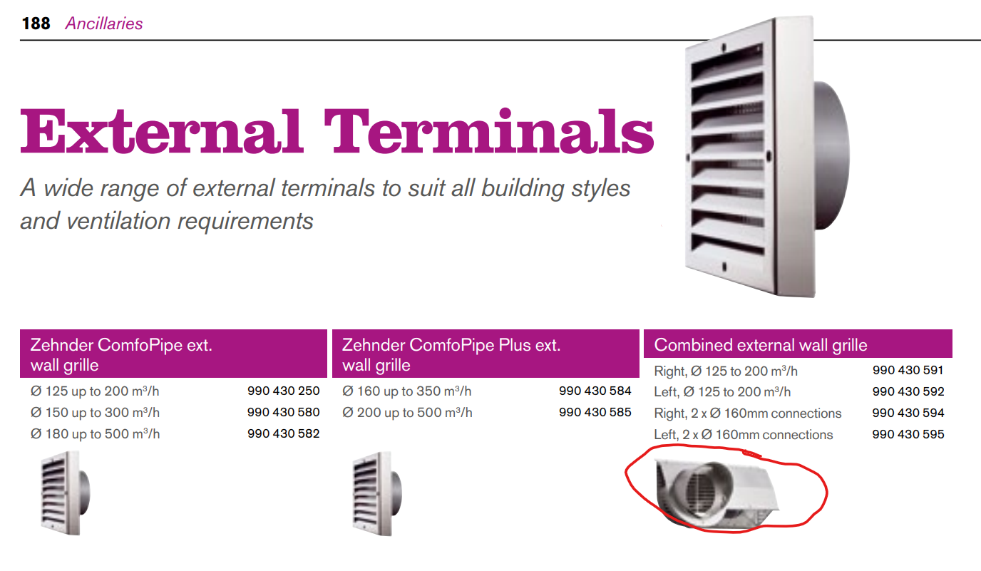

  2. I dont fully understand your issue but things to note, For vertical separation, exhaust wants to be above FAI (fresh air intake) to reduce the chance of recirculation. Horizontal separation, if I remember correctly, the minimum recommended separation is 1.5mtr. Try and avoid having the FAI n a area where pollutants will be absorbed into the building, and also avoid area where any external 'hot-sports' of air may be brought into the building, eg intake within the recess of the south facing roof may lead to hot air being drawn into the building. Zehnder make an approved external combined stainless steel intake & exhaust terminal that allows both to be routed out the building directly adjacent, well below the 1.5mtr minimum separation.
